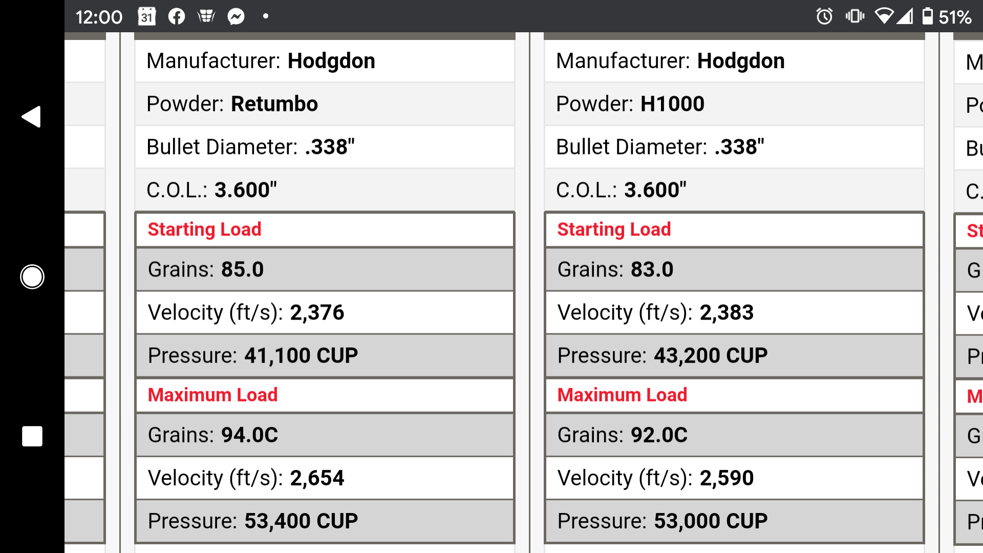

Ok thanks. The Hornady book has a charge of 72.2.... 80.8....84.3....87.8....89.6 for the h-1000 89.6 listed as max per the book. If I start at the .020 off the lands, then begin with the 72.2 or even lower?? These loads were at 3.665 per the book. The 72.2 seems really low per all the interweb info I have seen. Just want to not waste components but remain safe.

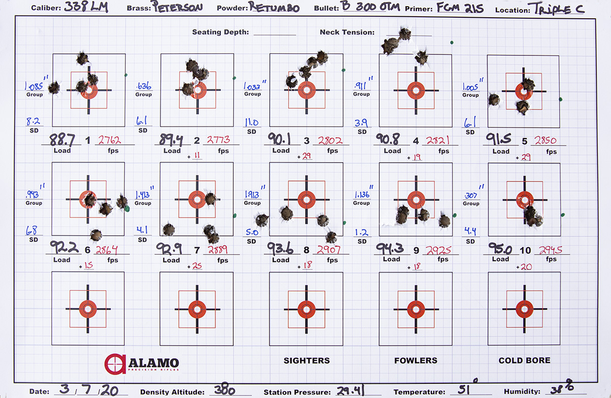

Hoping for a little guidance with my 338LM. This is the 3rd barrel I have put on this rifle, the other 2 shot great, but not this one. Is it possible this barrel just doesn't like the Bergers I have been using in the past?
Info on my rifle.
30" Bartlein Heavy Varmit
Standard JGS SAAMI reamer
Terminator T4 Brake
300G Berger OTM
RETUMBO Powder
The other 2 barrels (identical to above) shot really well. Both of them had a great accuracy node at around 92g to 92.5g. They were running about 2850 fps. There was another node at 89g running at 2770 fps - but slower than I wanted to use for competition.
This barrel however, there is no node to be found until I get up to 95g, and running 2950fps. That is about 2 full grains into signs of pressure. I tested powder charges from 88g to 96g. I tried seating depths at .005 apart from the Lands out to .100.
Strangely enough, it has incredible low ES and SD's, but about 1" groups is the best it will shoot until 95g.
Is it possible this barrel just doesn't like the Bergers? Or the RETUMBO? I have considered trying the new Hornady A Tips first... then trying some H1000.
Any advise from some seasoned shooters with 338LM experience would be greatly appreciated.
@jeffmedlin Can you post a pic of your groups? Is it mostly side to side variation of group size?...or Vertical?...or a shot gun pattern?
That powder with 300gr Berger OTM should run great....especially since you have experience on two prior barrels.
How many rounds do you have down this barrel now?
Did the same gunsmith spin this up for you?...using the same reamer?
Reactions: jeffmedlin
Added the target to my post.... the barrel has 350 rounds down it now. Same gunsmith. I just don't think this barrel likes the combination that has worked so well for me in the past. Until , I get to 95g. But I am afraid it is too hot, and could be problematic in competition.
Have you bore scoped the barrel, cleaned it absolutely spotless and verified with the bore scope, then fouled it and shot another ladder test? Potential carbon ring? I would agree 92-92.5 is always a node with retumbo. Try 91.5-93.5 in .2gr increments after cleaning and fouling and see what it shows. Have you tried shooting this setup at 300-500yds and seen how it grouped?
Barrel is spotless. Bore scoped to verify. That is the 2nd powder charge test. Unfortunately, at my range we only have 100 yards of paper. After that is is all steel, and it is too shot up to be useful. We are unable to go downrange and paint.
Dang...may be time to try another bullet. While not the highest BC, Lapua scenars tend to shoot well in most rifles and may be an easy way of testing for improvement over the bergers. They should like the same powder window.

What percentage of capacity is 92gr of retumbo with 300gr berger , when berger data shows 89.5gr as a max load of 107% capacity. Can u use redding competition dies for over 100%?

berger states 85.2gr is 104% case capacity with h1000 and 300gr otm and as a max load. Is berger load data underpowered on max loads then? And how much case capacity is to much .And are redding competition dies able to load compressed loads. cant see why not for the price.

I stopped at 92 gr H1000 and at 94 gr Retumbo because I hit the high velocity node which was the accuracy I was looking for.
