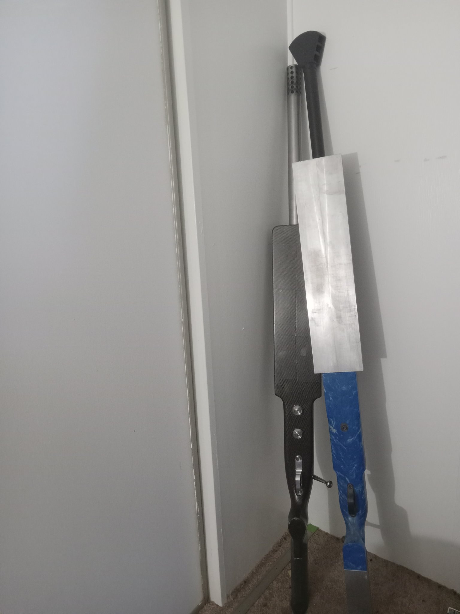

The blue gun in the picture is Lynns 375/50BMG in a McMillan super benchrest stock. His load is around 206 grains of VV20N29 with a 400 grain bullet and it has won a ELR match in Nevada so it does shoot accurately but barrel life is around 350-400 rounds.

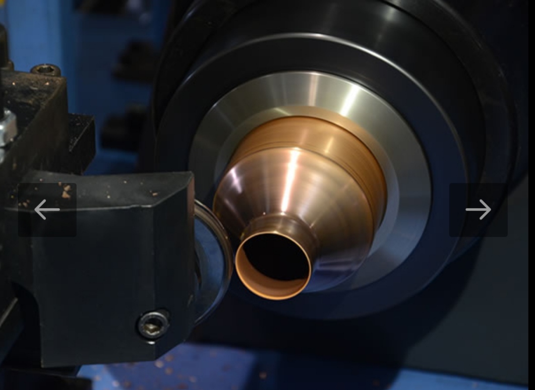

Yes, we all know the titans of CNC, but even they can't make cases just by turning. As has been discussed, the neck and shoulder section has to be roll formed. Yes, that is done on a (CNC) lathe, but roll forming/spin forming and turning are not the same thing.
So what does roll forming/ spin forming look like on a lathe? Could that be added to a machine like that?
Besides @badassgunworks said this above "All i will say is that its all turned on a lathe inside and out body, inside and outside including shoulder and neck."
I was illustrating a type of machine that could do all that work. There are single spindle type Swiss lathe that could do the same thing just would take a little longer. Cartridge cases don't have to be made from just brass as well. Those materials might not be as conducive to roll forming.
Edit: Not many people understand machining technology and what is or is not possible with what machines. Not everybody has the same knowledge or understanding as you might.

Many materials can be spin formed. Even pipes made of steel. I agree, brass is not as conductive as copper but annealing makes it possible. I think badassgunworks had better speak for himself. The information I have is not from him. I say the base brass cylinder is turned and reamed on a lathe, and the shoulder/neck section gets annealed and formed by spin forming.
I believe 100% that you can attach rollers tools to a lathe. 15 minutes youtube search and you will find it. Search the words "spin forming lathe", "roll forming lathe".
