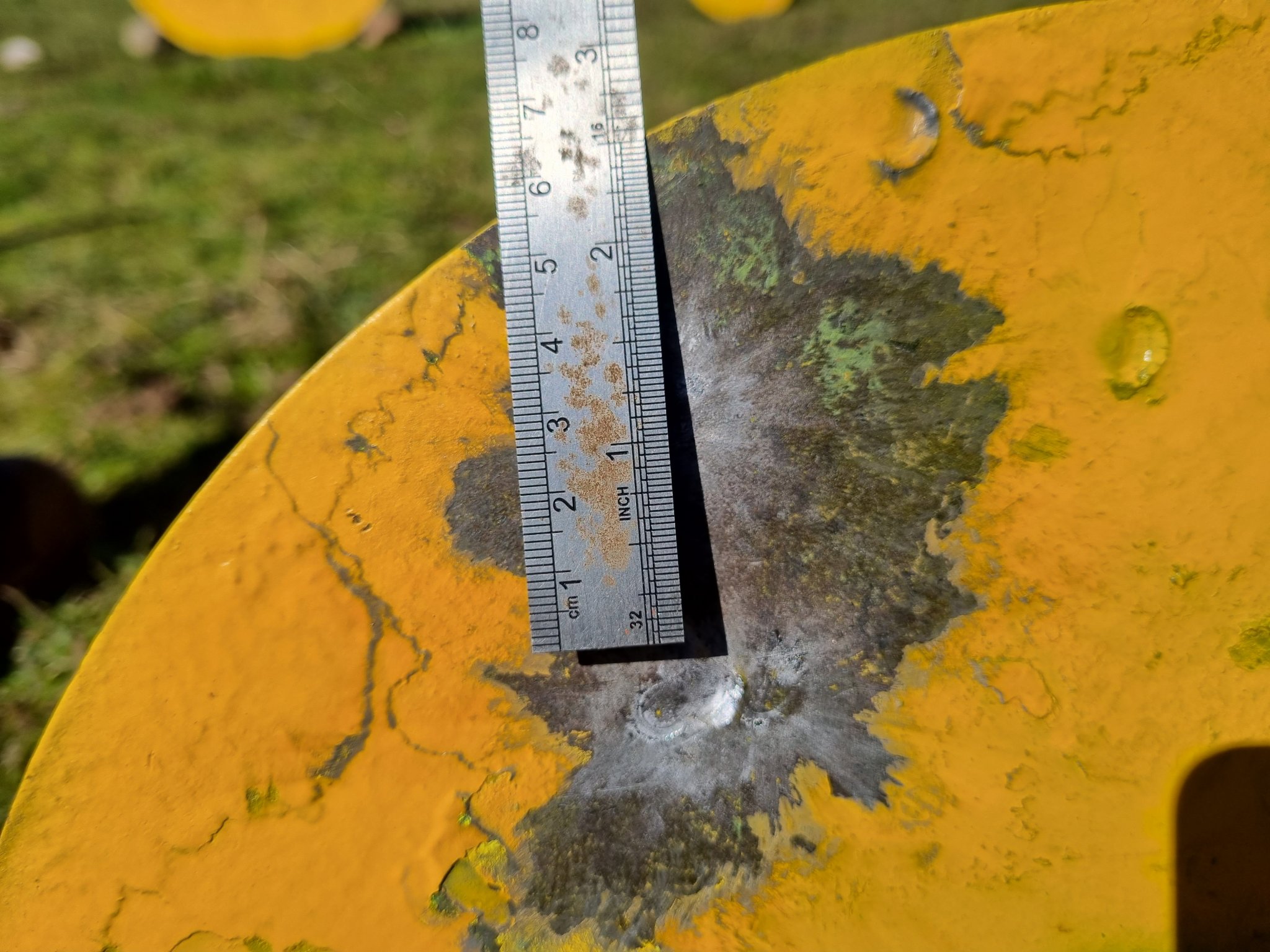

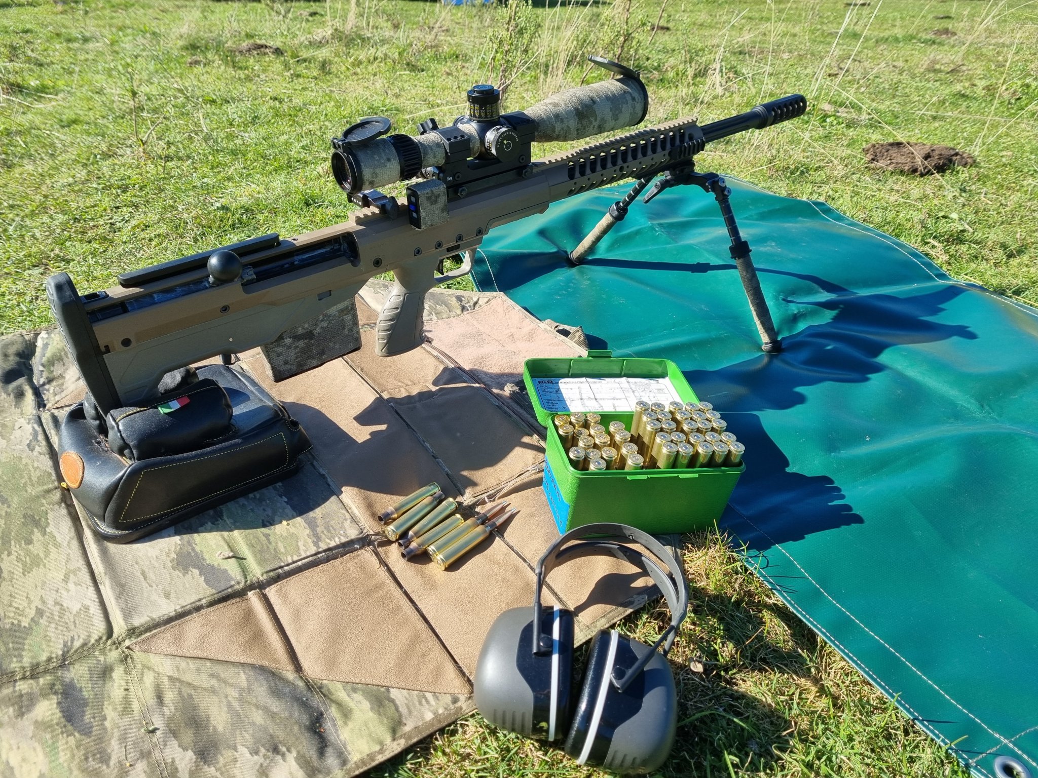

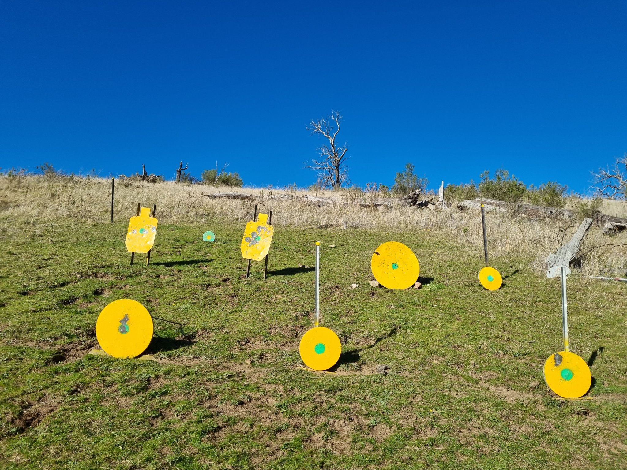

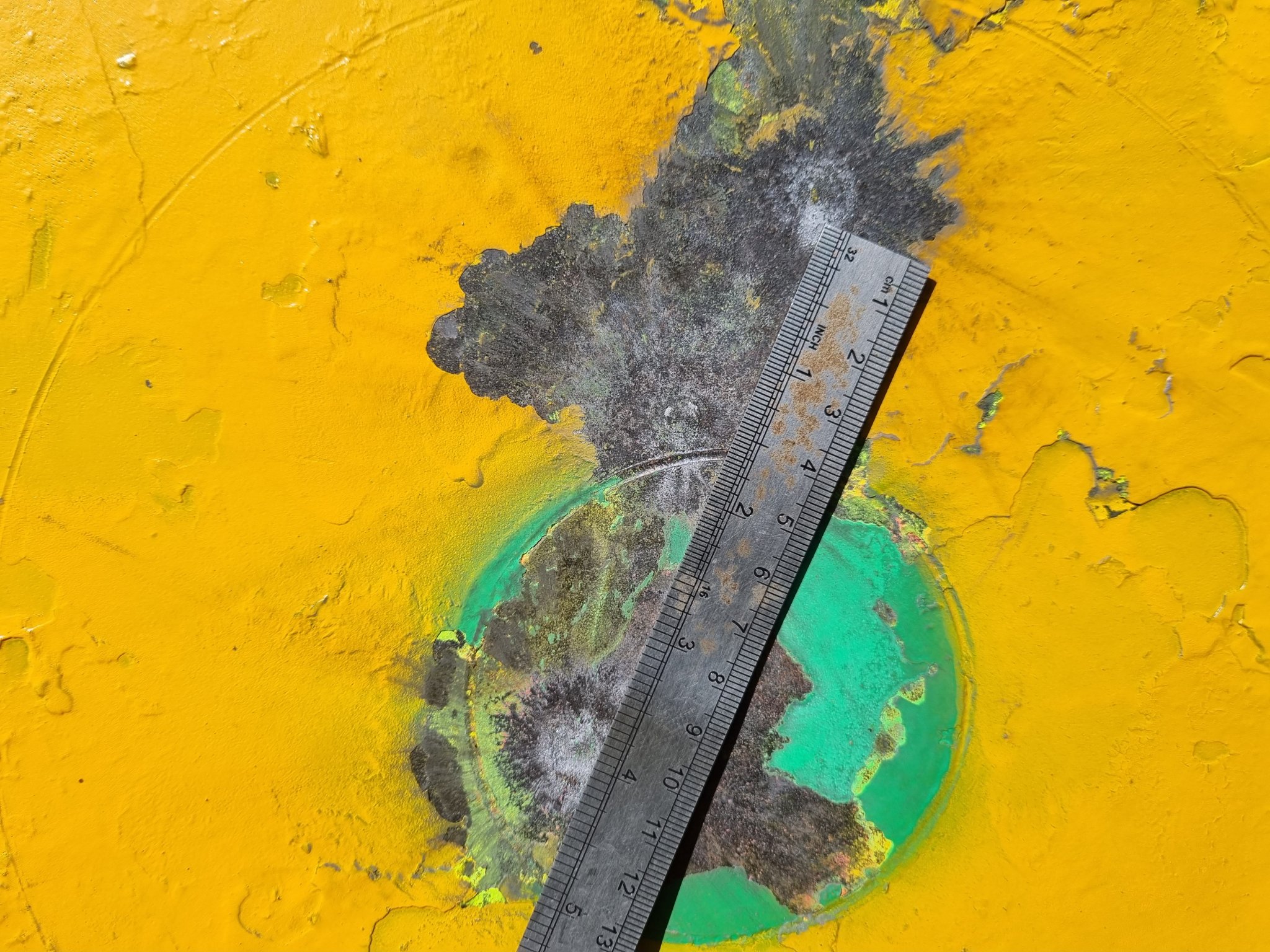

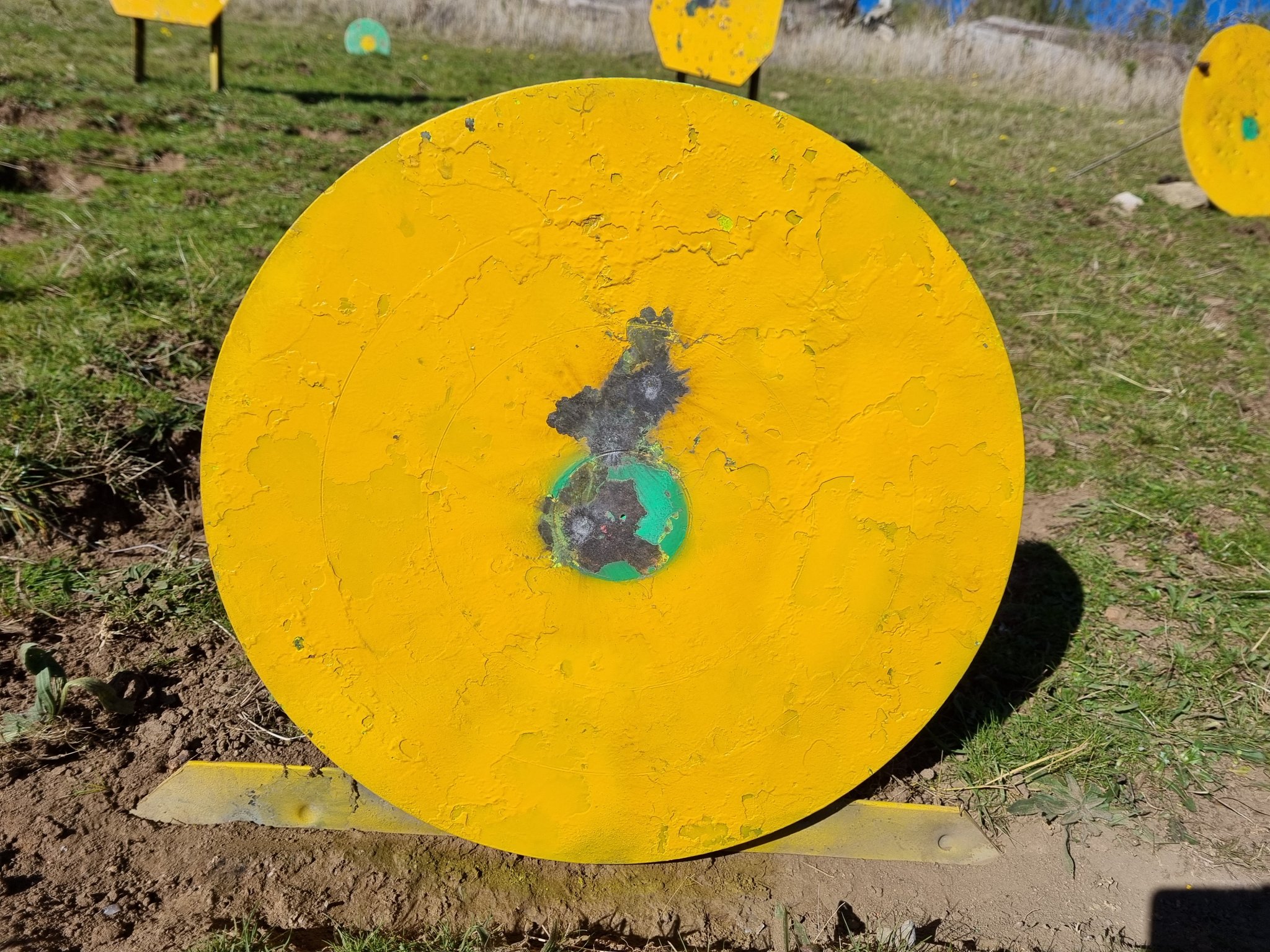

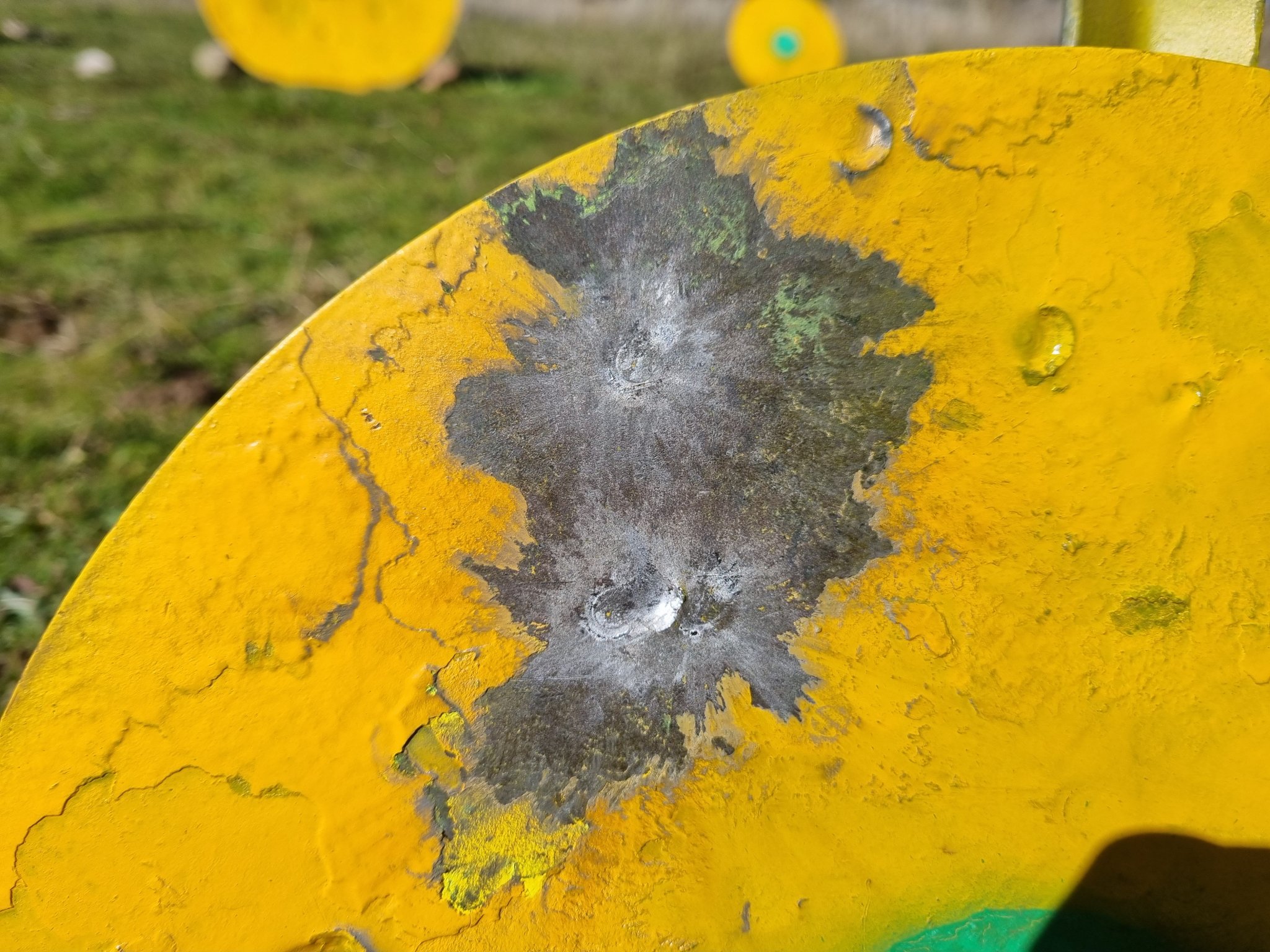

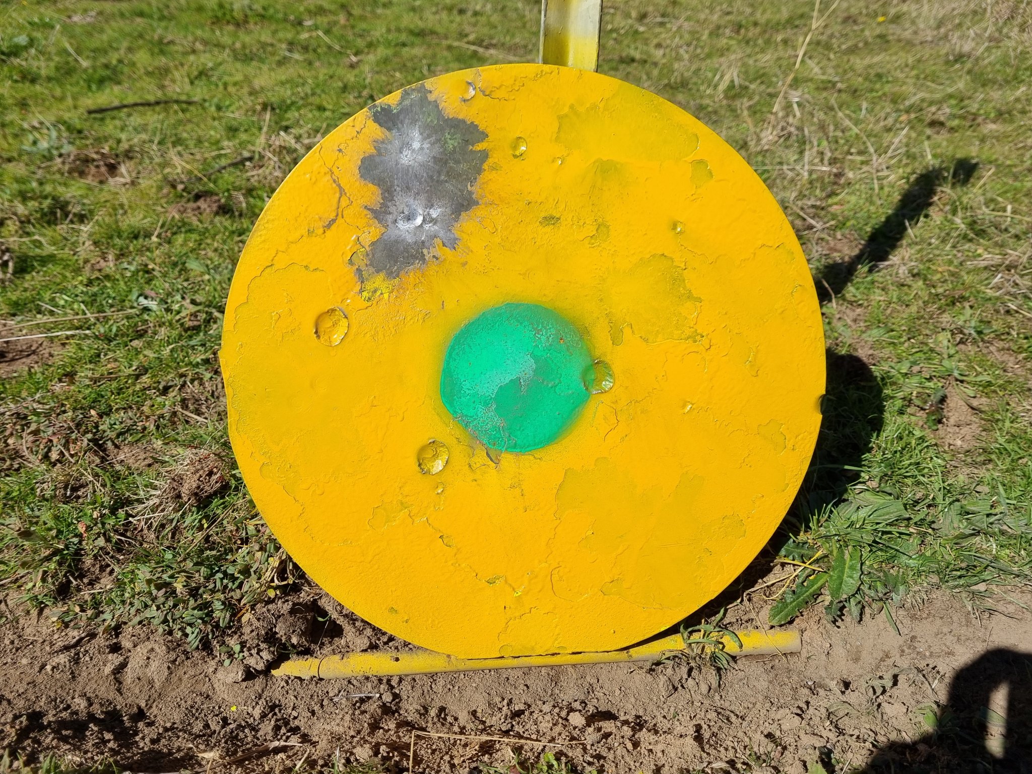

390 grain Hornady A-Tip load development 375 Cheytac
1200mtrs today...
133gr AR2218 (H50bmg)
Bertram Brass.
"3" shot.. 4" Group '3' shot.. 1 3/4" Group...

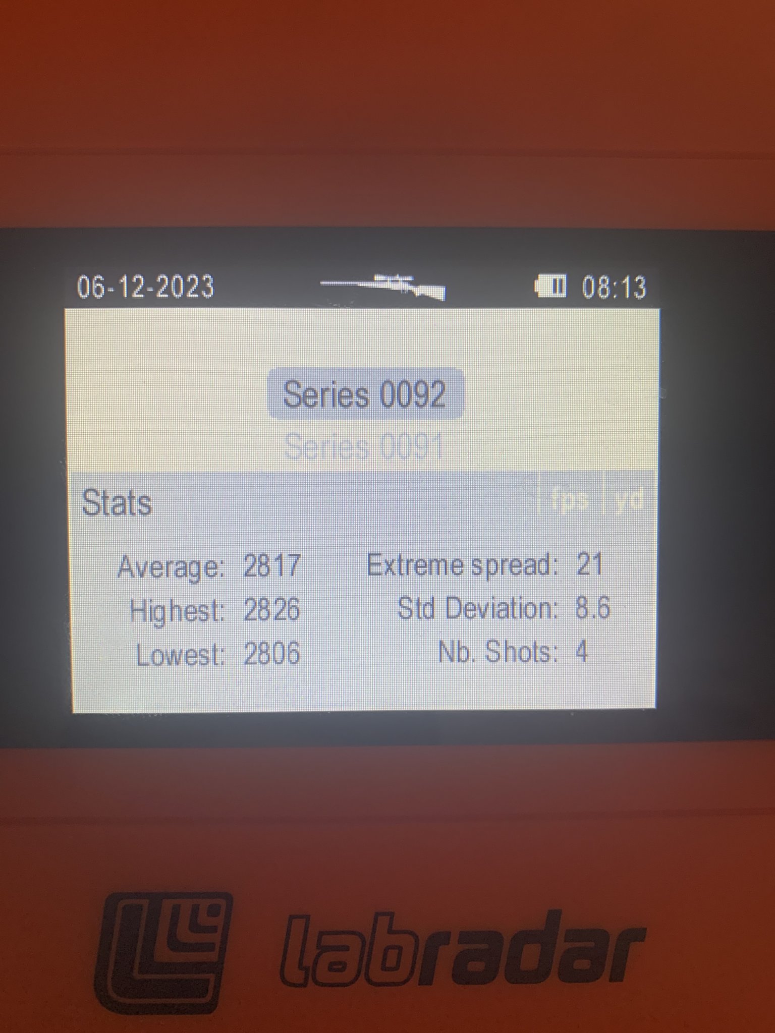

Velocity is circa 2900fps..with 133gr

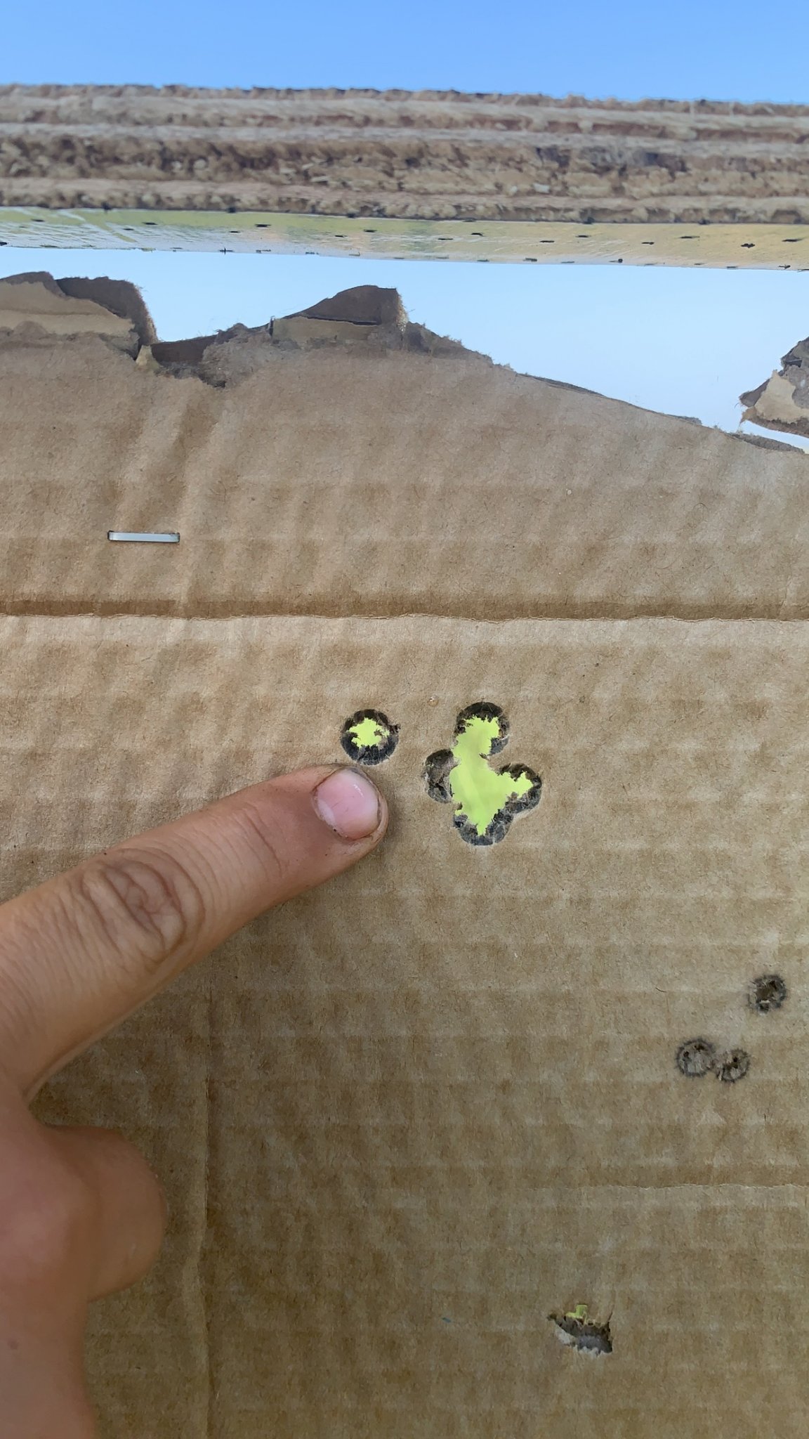

My 11 year old son just shot this 5 shot group at 100 with that same load and the HTI. Its only 2729 fps though

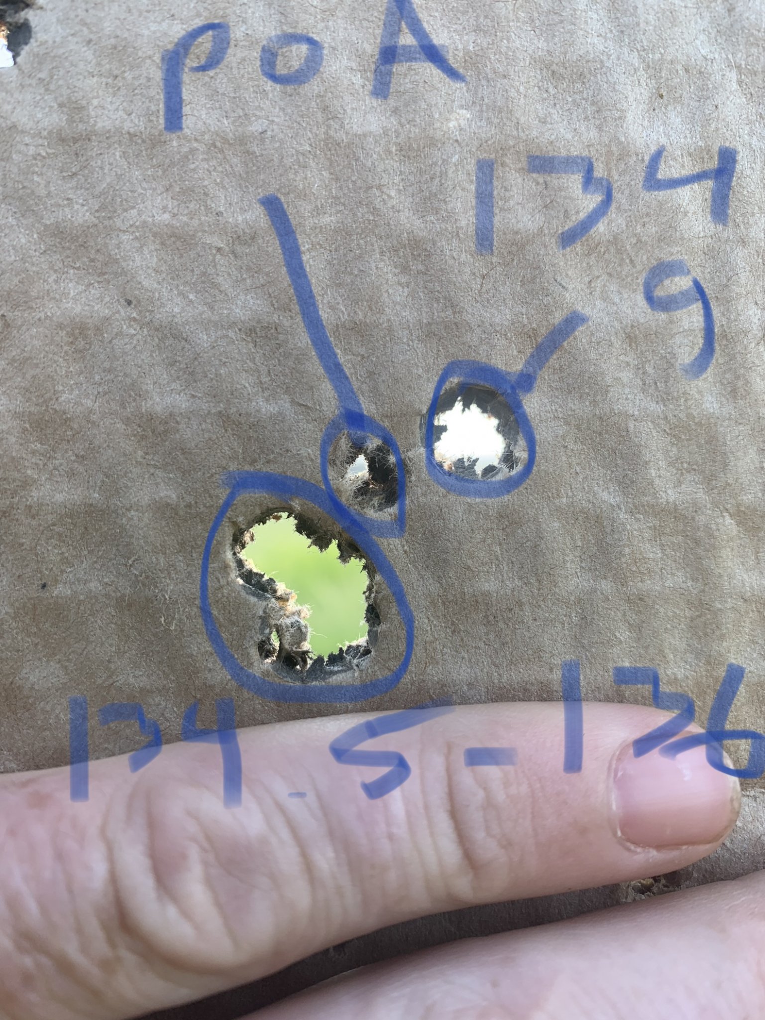

Ran a 5 shot ladder from 134,134.5,135,135.5 and 136 grains. 134g was 2780fps and out of the group but the 4 others went into same hole with an sd of 8.6 and es of 21 Kind of a crazy big node. What would you guys do? Take a charge weight in the middle and run with it? Or chase more speed.

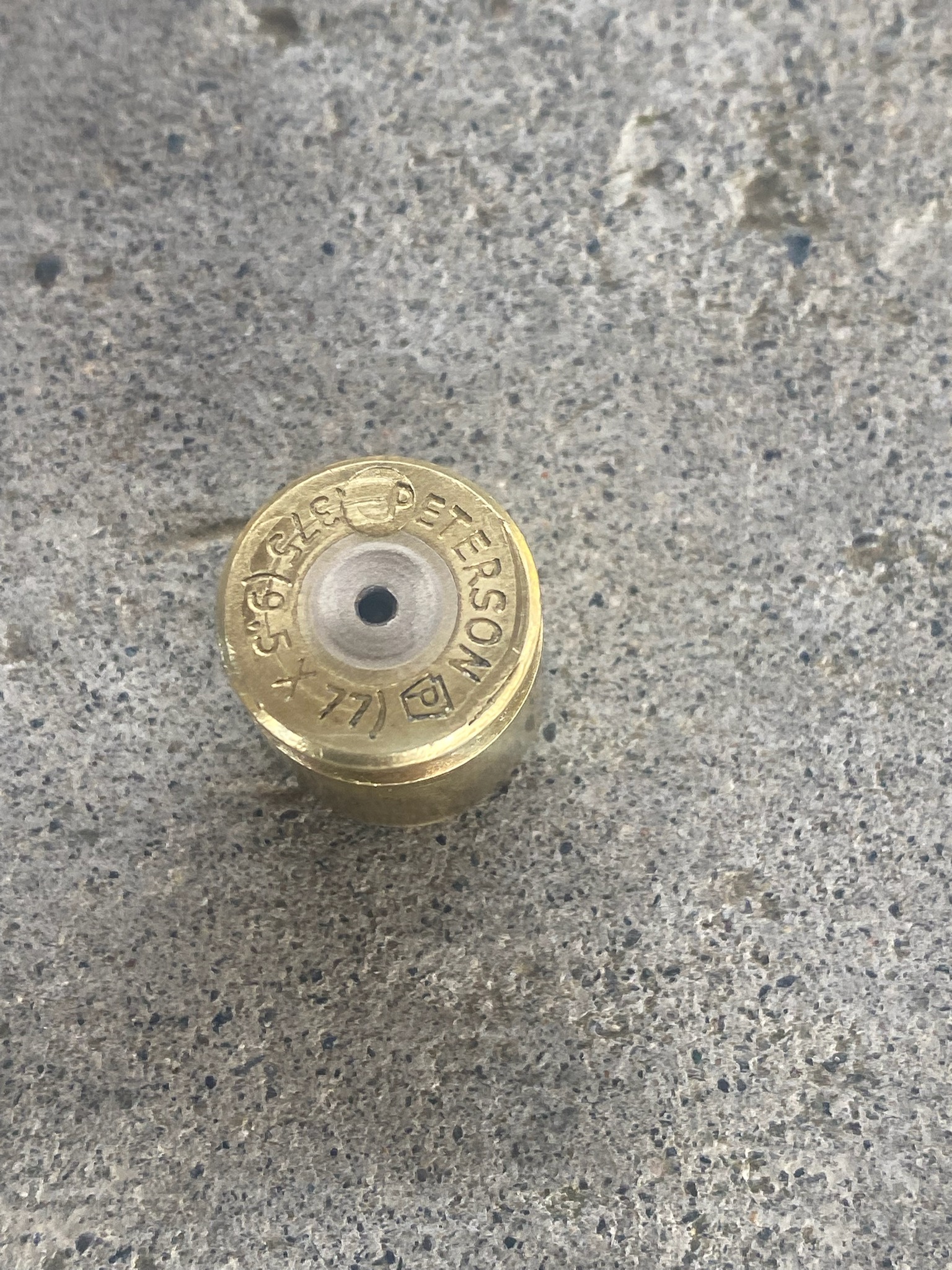

The photo shows too much pressure
Not only too much pressure, waaaaaaay too much pressure, a place where I would never find myself except by accident

The Bertram case is weak and the primer pockets don't handle pressure well so more case capacity doesn't really matter as your not utilizing what you already have.
The cases in the photo are 338 Snipetac taken when it first came out and the reason it never succeeded was due to the lack of good brass back then.
If you look at the picture that is Bertram brass so when I post it isn't from crazy emotion about too much pressure only gotten by accident it's by real world experience with those actual components.

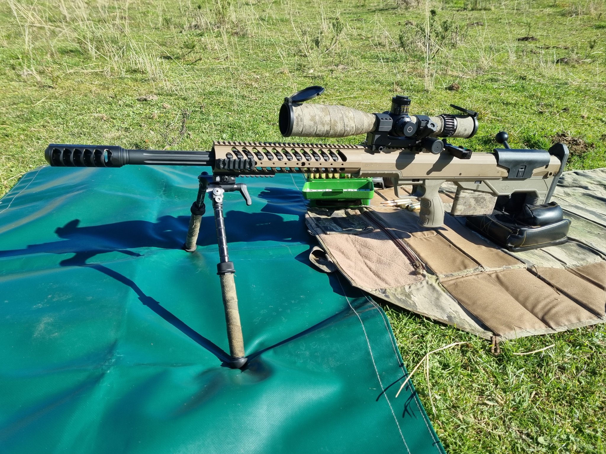

The pictures show 2 of my cheytacs.

With two factory HTI barrels and Peterson Brass 133-134 grains of H50BMG has yielded me 2900-2915 FPS and no pressure.
When the third one gets here I’ll post results.
That is pretty wild. Im at 135 grains of h50 with my factory dt barrel and only gettin 2800 fps with the 390 atip. But its super accurate.
You are right there with the gun I shot today. Indeed, I found him this gun for sale by a DT employee, new, and unfired about five or six years ago. I set it up for him and then shipped it to his FFL. It’s a good shooter, and the other load that it likes is 134 or 135 of N570 pushing a 350 grain sierra match king at about 3100 to 3125. For whatever reason, it prefers my original load with RL 50 for the 390. Granted, we did not shoot a big enough sample size to discern the difference today but the speed was the clincher.
We should talk about these velocity discrepancies. Humidity? Temperature? Velocity estimation techniques? Barrel round count?
Charge weight 133-134 grains, velocity was 2900-2915
Humidity 8-12%
Temp 50-78 degrees
Altitude 5400 ASL
Round count 1st barrel 2-300 rounds
Round count 2nd barrel 30 rounds
Velocity readings from Magnetospeed.
