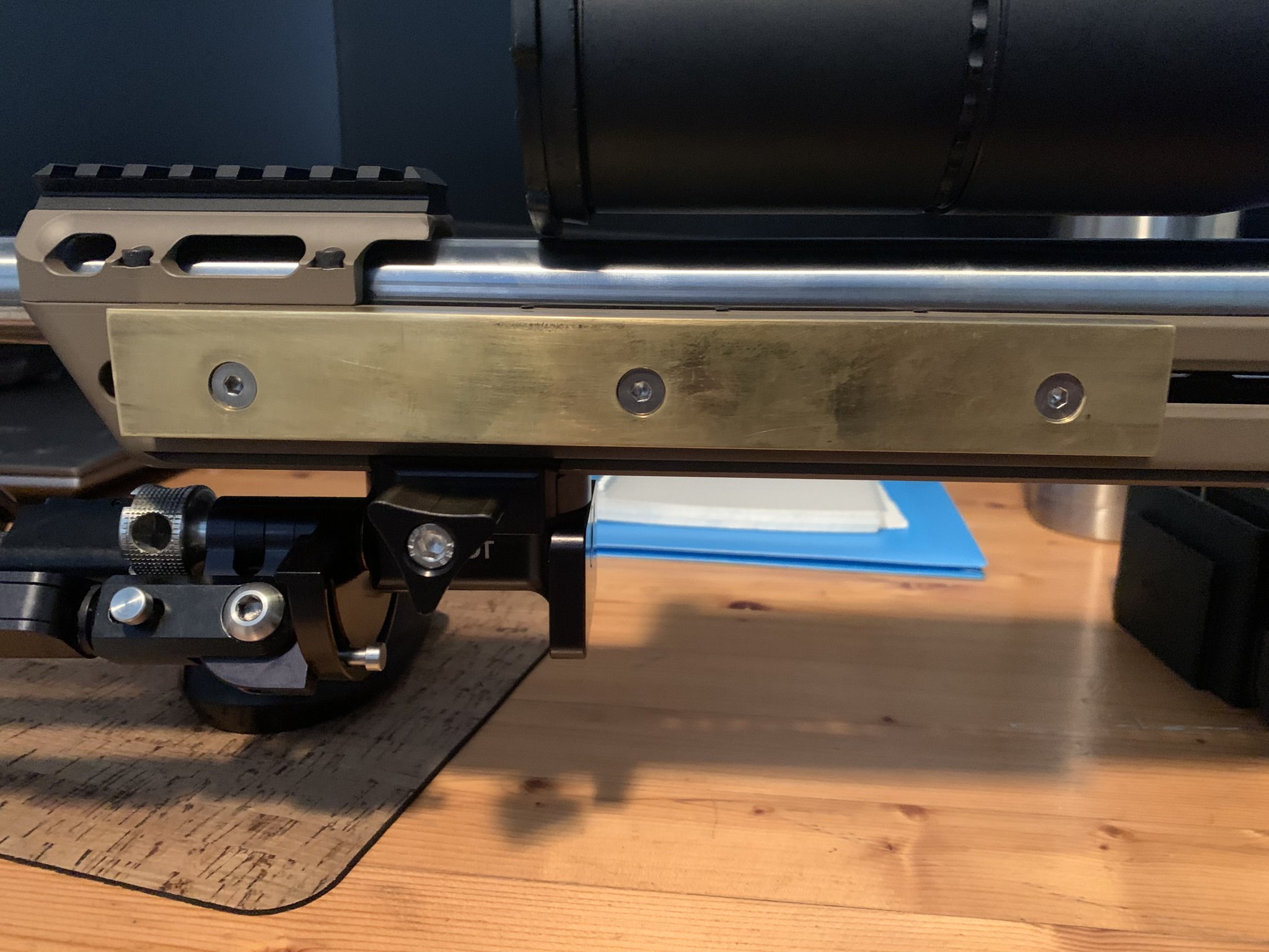

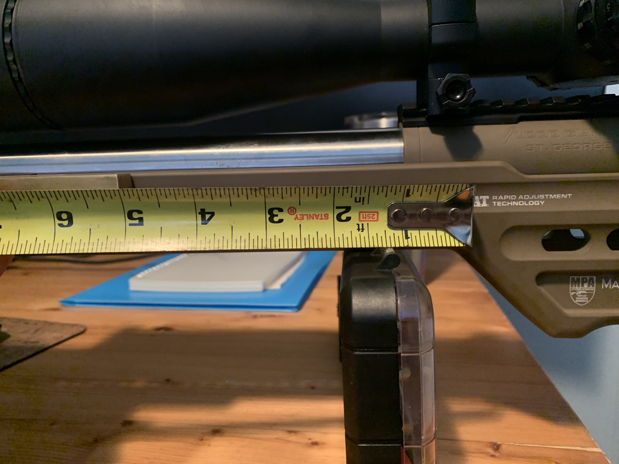

I should have prefaced this with a photo as I have added brass weights and the rifle balances quite well.

Regarding balance, the balance point should be at the center of your support bag. So if you're using something like a shmedium, then you want that balance point at 4".
It'll take you strapping a brick to the end of a Matrix to get that :). This isn't to discourage you from shooting, just saying...
