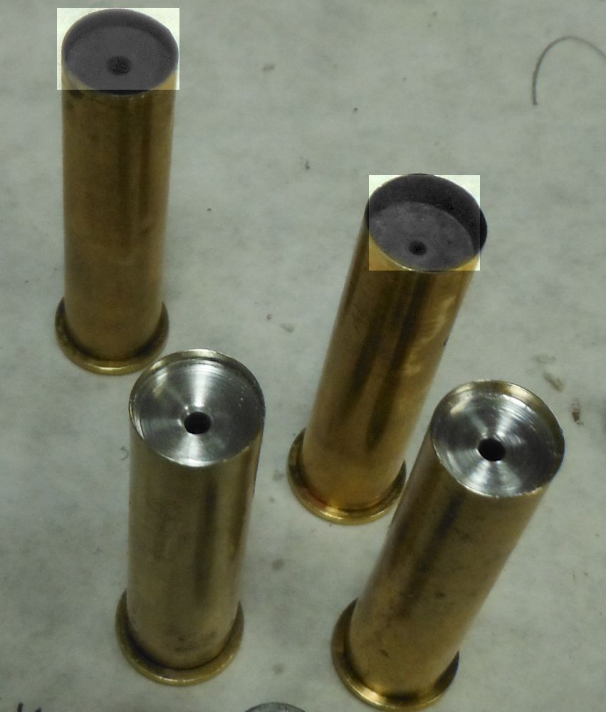

45-70 handi rifle Steel insert case filler with primer hole 155 gr .458 RB cast bullet 400 fps B.jpgProduced two 45 70 filled cartridges today, the second one was 30 minutes, I know I can do 20 mi.jpg
If the case has a metal filler, 1 gr of pistol powder can move a 155 gr bullet at 400 fps. That will stop a 20 pound coon with a body shot and sound like a BB gun. Even if it is legal to shoot at your house, if you start shooting at coons coming out of your hen house at midnight, the neighbors will not like it if they can hear it.
While you can kill a coon with a 22 CB short that sounds like a BB gun, that has to be brain shot. You can do that if they hold real still in a tree. But running out of the hen house, a body shot is all you get.
Without the metal filler, you would need several grains of powder to get 400 fps, and that will make gas with more than one atmosphere of pressure above ambient at the muzzle, causing super sonic gas escapement, and a loud bang. When the gas slows down to sub sonic, a wave propagates of amplitude 2 atmospheres trough zero atmospheres, the threshold of cavitation. That is much noise as a gun can make. The bigger the gas ball at transition, the more lower frequency. That is why big guns sound deeper... bigger supersonic gas ball.
You can't just push the bullet down in the case to get higher expansion ratio. The jump to lands is too far and accuracy will be lost. The high velocity and low noise can be attained that way, but only good for short range low accuracy.

View attachment 47054View attachment 47055
