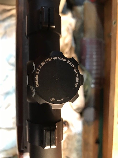

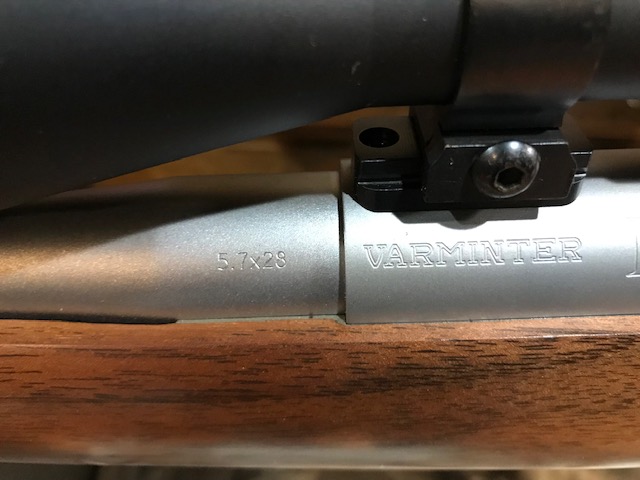

24" barrel - even worse than I remembered on the speed - only 2150 fps on the velocity. But it is a fun - no recoil- minimal noise cartridge.

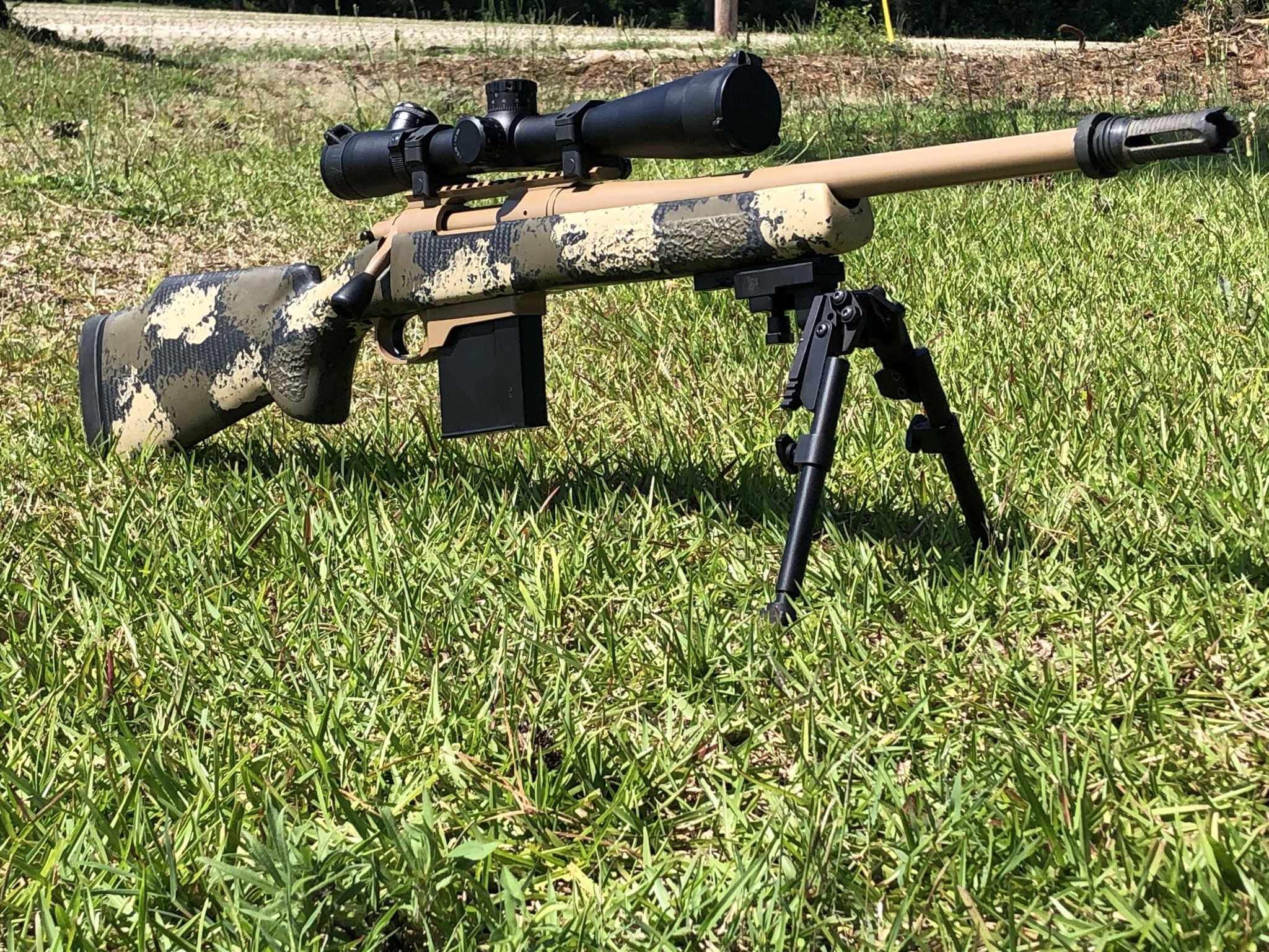

This is the 5.7x28. She has gone through a few changes, but mostly cosmetic.

This is the 5.7x28. She has gone through a few changes, but mostly cosmetic. View attachment 8452094

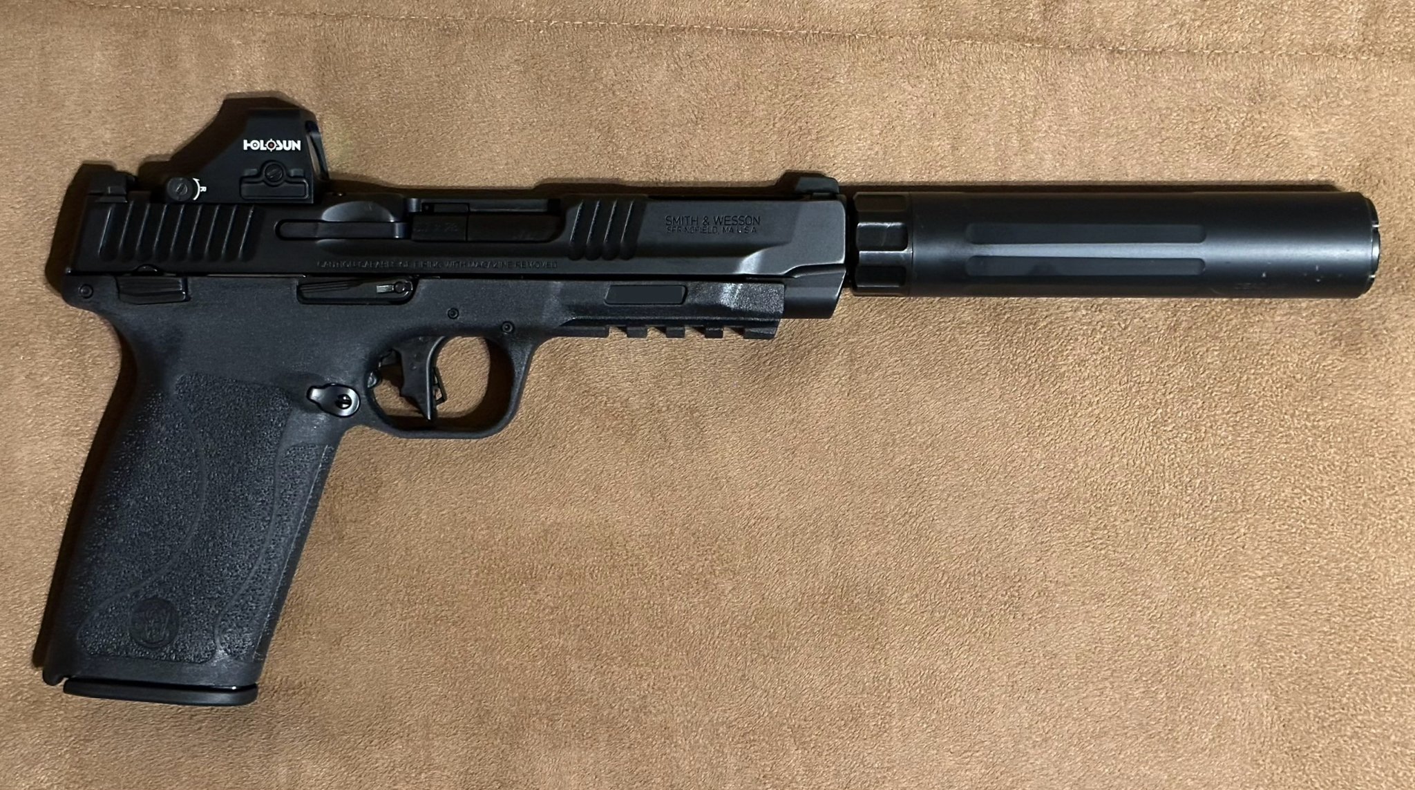

Also really enjoying my new toy… The radial delayed blowback design of the M&P 5.7 pistol is pretty genius. Recoil is very mild and the impulse is smooth. Pretty damn accurate, too. Hitting 5” gongs @ 50 yards with ease once I got the 507K dialed in. Haven’t tried it @ 100 yet. Might do that this weekend.

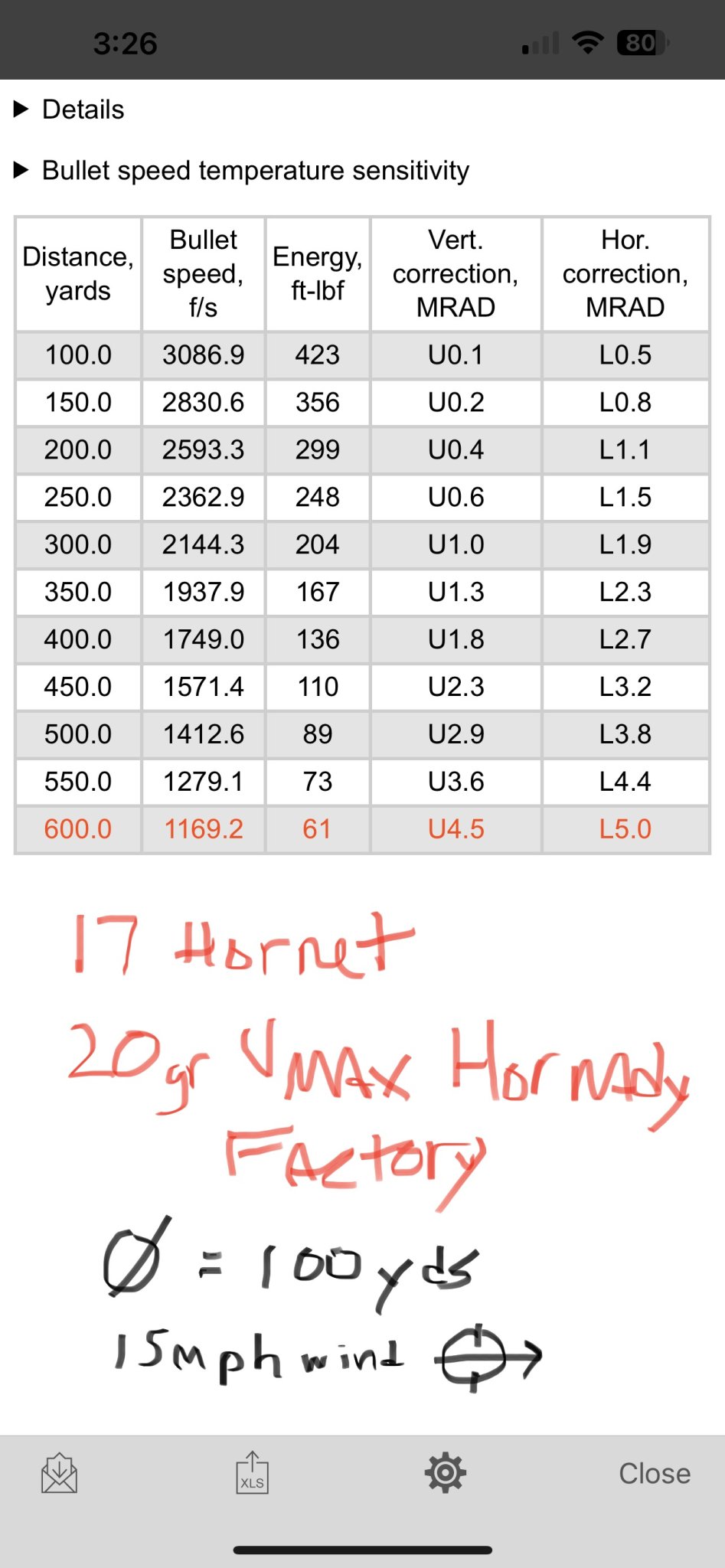

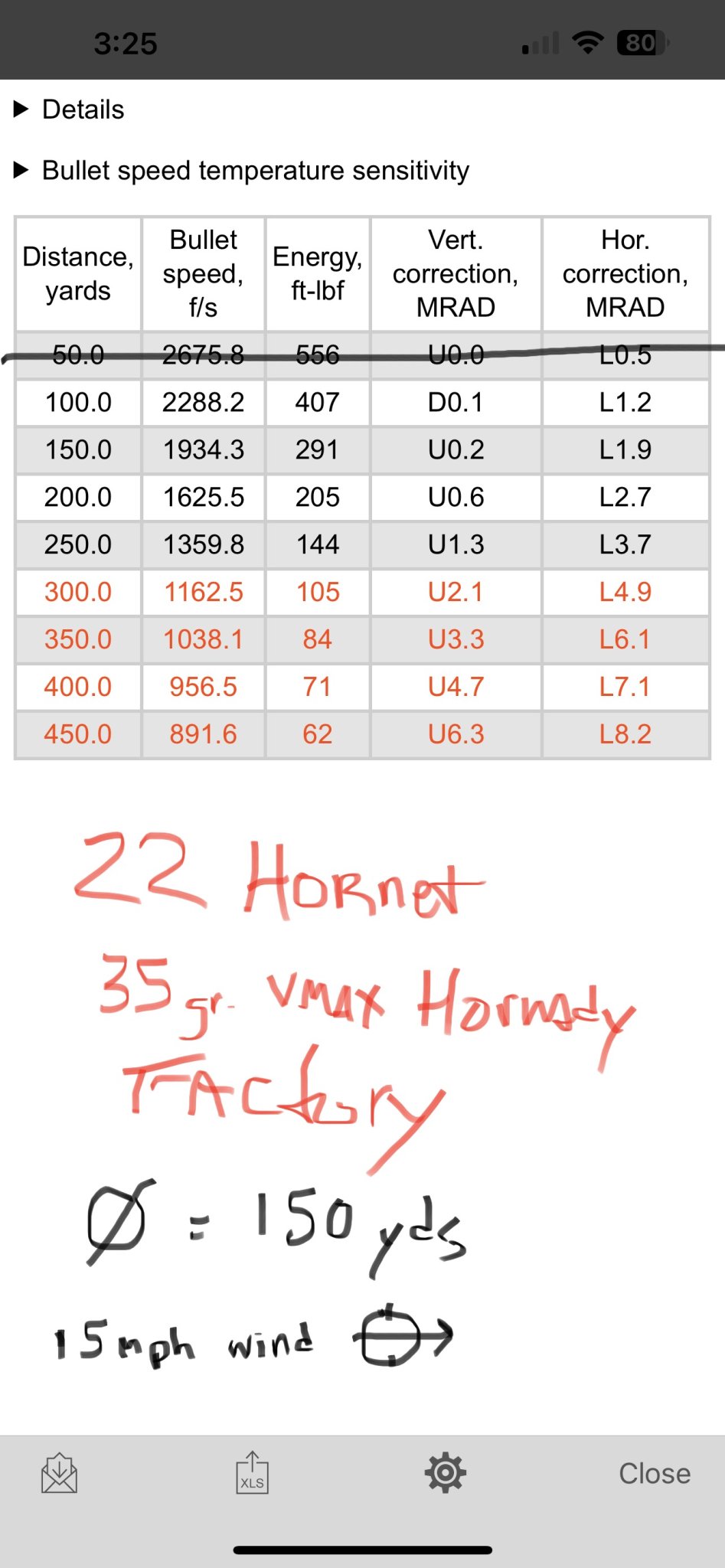

I’ve attached Strelok ballistic outputs for both. Ignore the drop as the guns were zeroed differently in the past and I didn’t notice when taking screengrabs (have moved to all 100yd zeros for my CF guns).
The “Add vertical deflection of crosswind to results” is enabled, so that’s why even at the zero, there’s still a vertical deflection.
