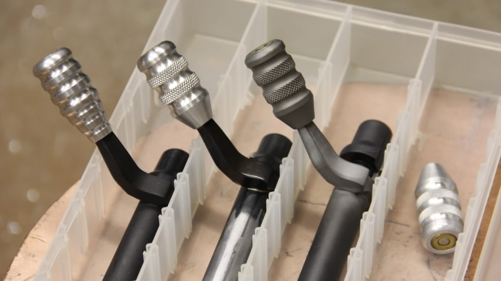

The skinny handle this robust rifle does look odd, I have done a few mods on them .
el gordo2....I sent you a PM (a couple of times) but it doesnt show up in my PM sent box for some reason. Not sure if you got it (them) or not....but have some questions.
You've made a few of these knobs and handles....do you sell them? I'd be more interested in that than JB weld.
He does. I just ordered one! He answered my PM right away. I'd say try it again.

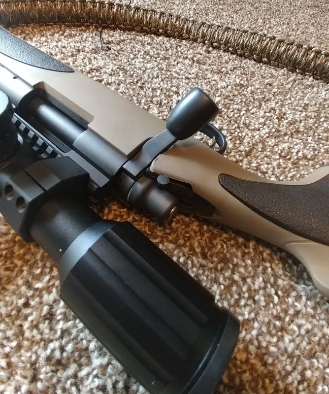

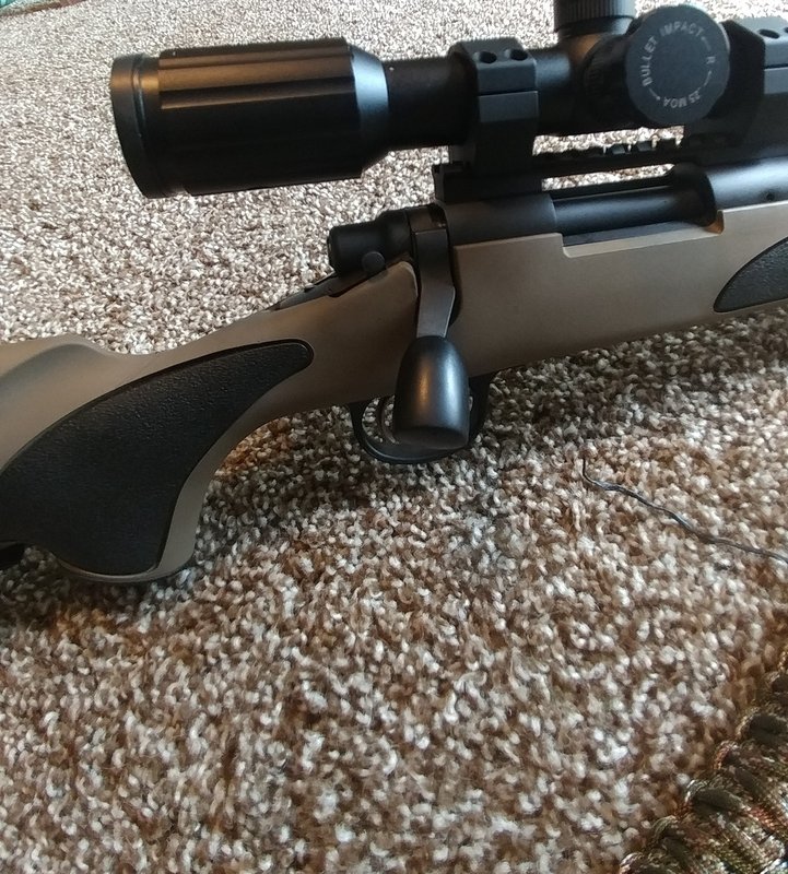

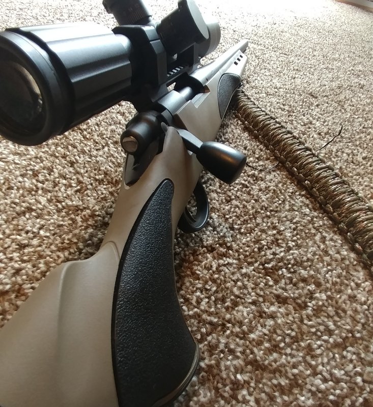

My little brother inherited an older Rem 700 in .270 from his father in law. He wanted it upgraded on the cheap so guess who got to work on it! :)
Thanks to this thread, I was able to get him a 'tactical' (I'd say practical) bolt knob for $6 (damn inflation!)
Initial progress...
Then glob some more on:
I rough shaped with every home gunsmith's favorite tool, THE DREMEL!
Then sanded with 220, then 400 or 600, then final buff with 1000.
Then tape off, brake clean it, and painted with Rustoleum Engine Enamel (black) ~4 coats.
Another angle.
Hope he likes it!

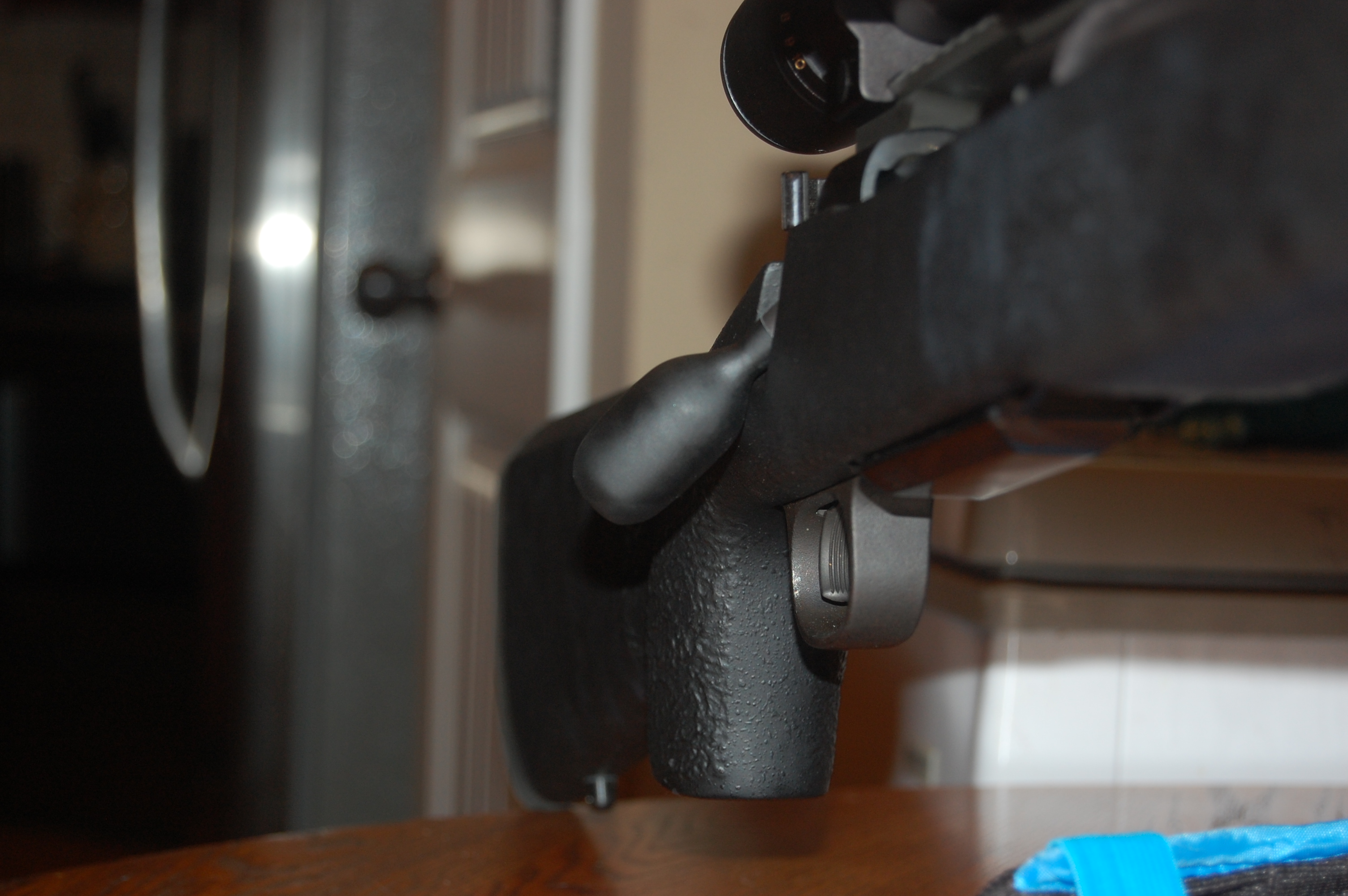

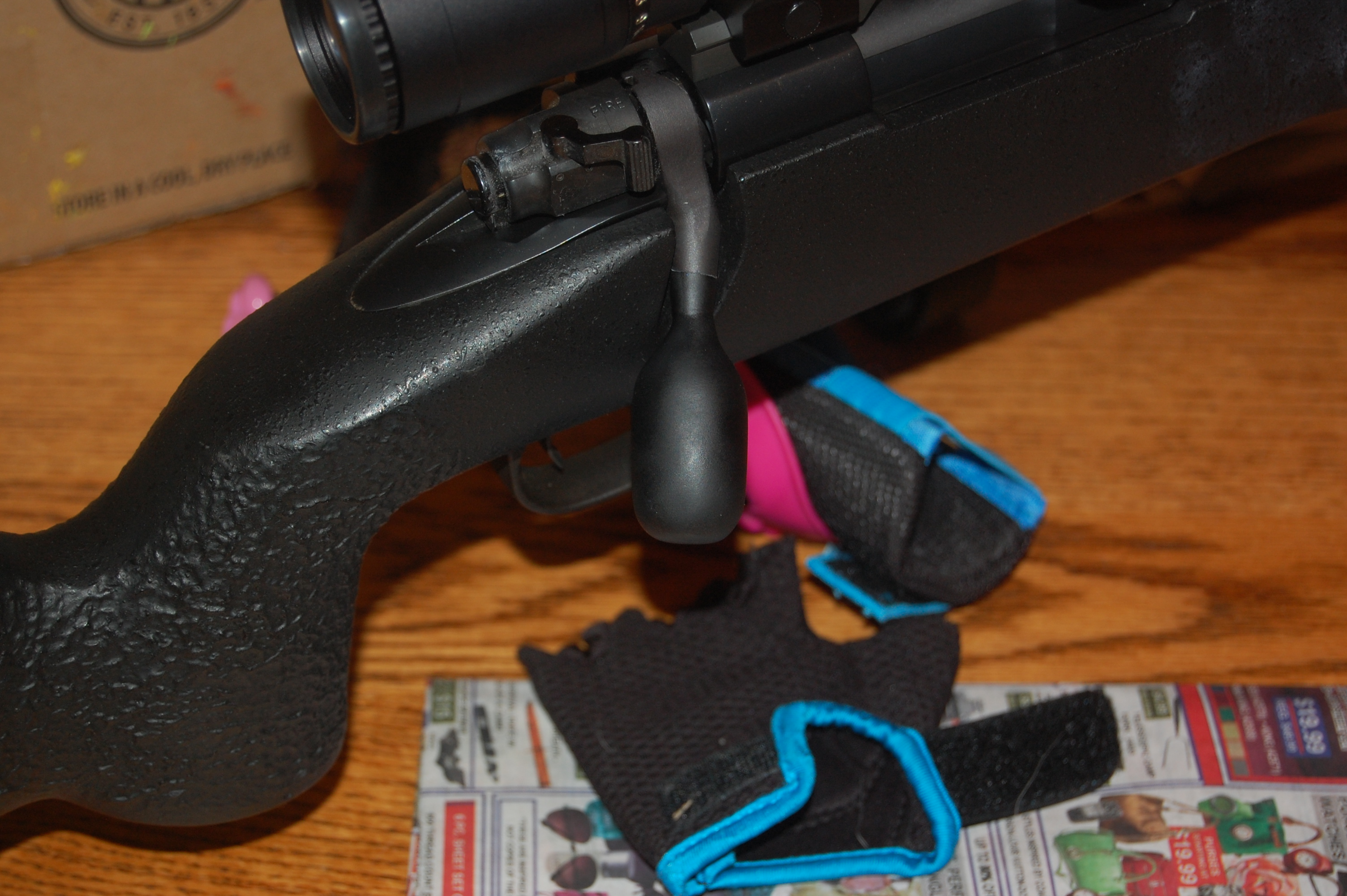

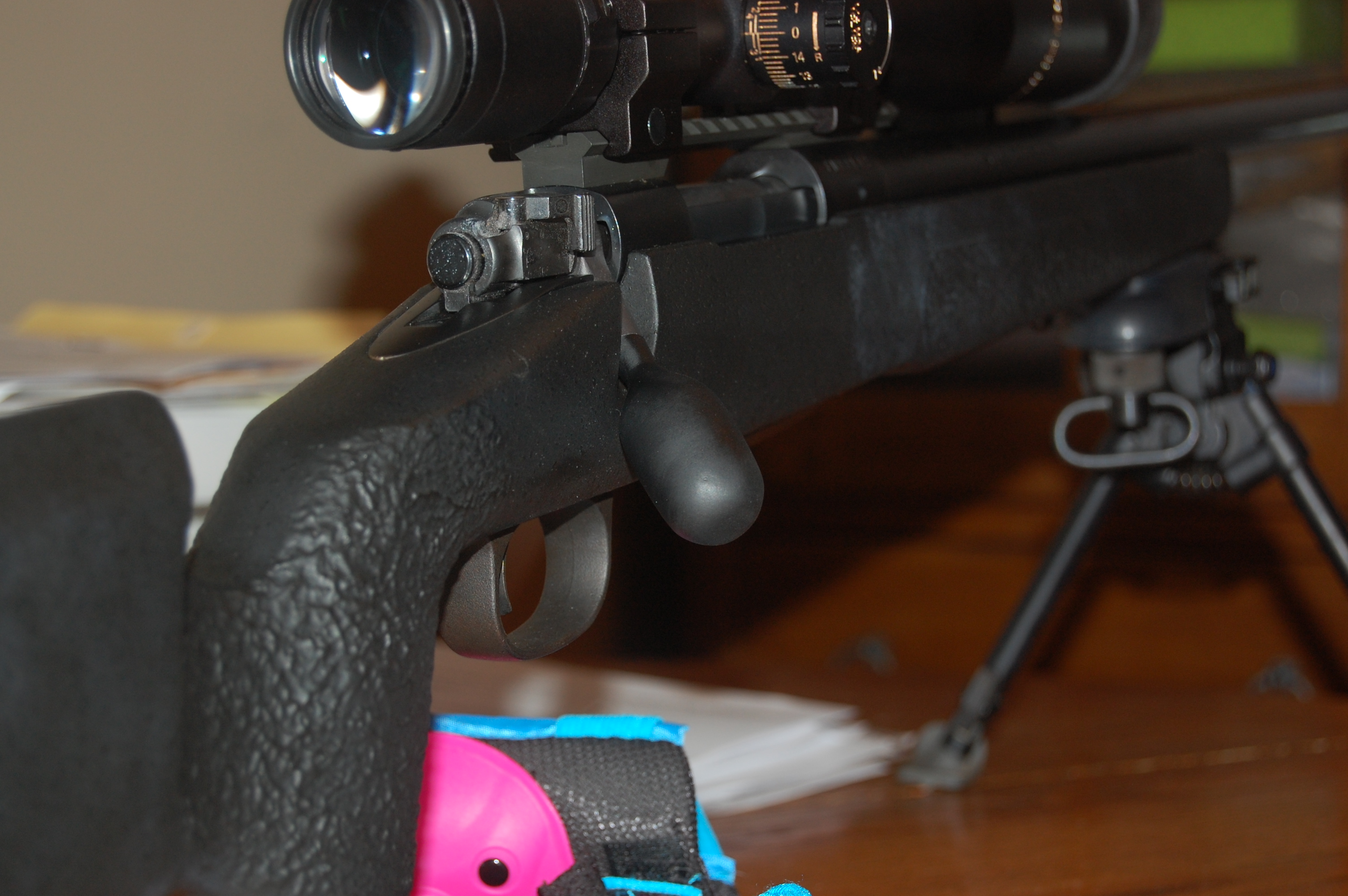

well i got the jb stick today and this is how it turned out.
let me know what you guy's think. also i used a dewalt da sander with 100 grit, put it on my bench and rotated while sanding, flattened the end then ran it around till it looked ok to me. primed, then krylon flat black camo painted. much cheaper then sending out for bolt knob mod :D
kenny

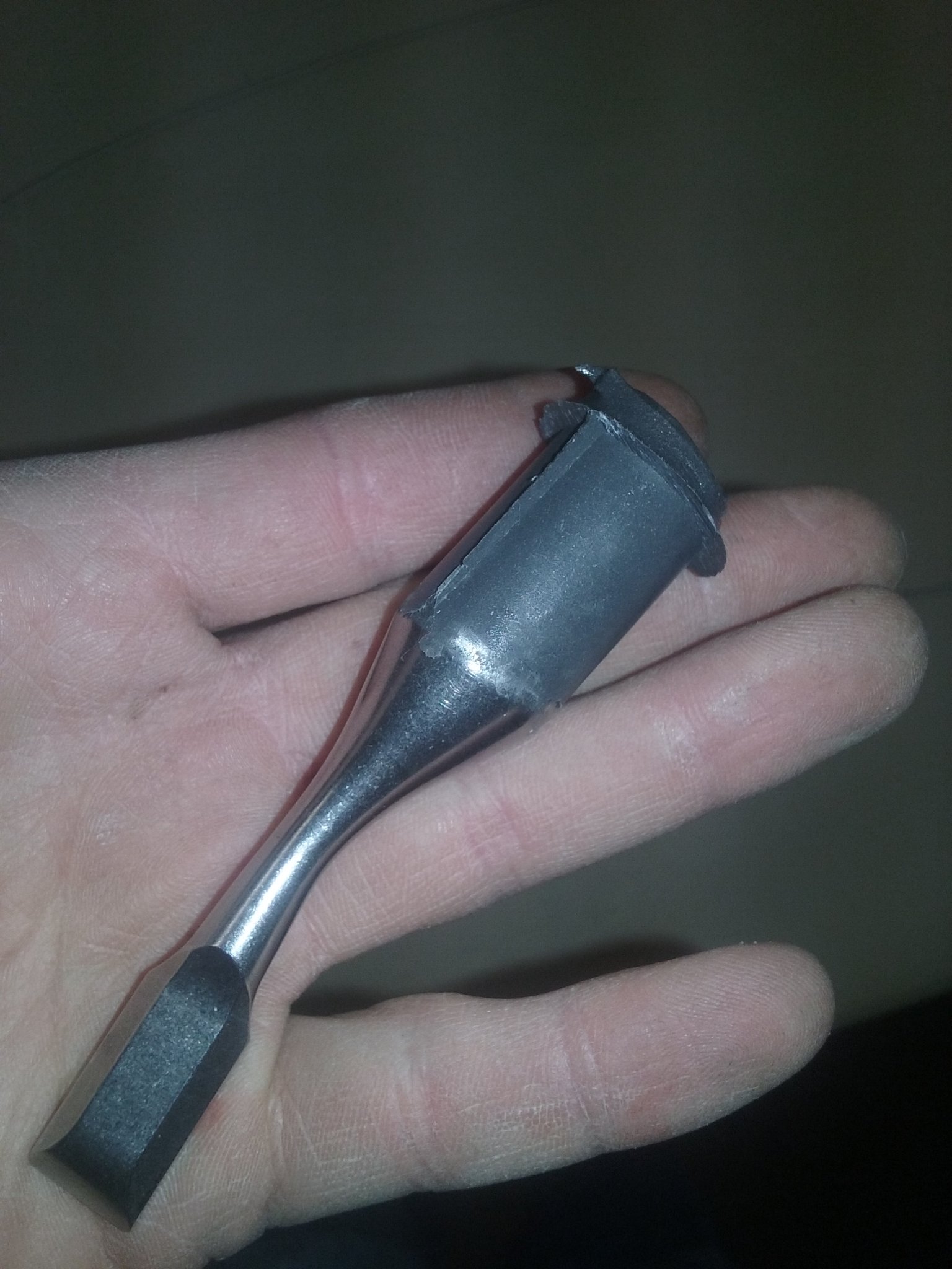

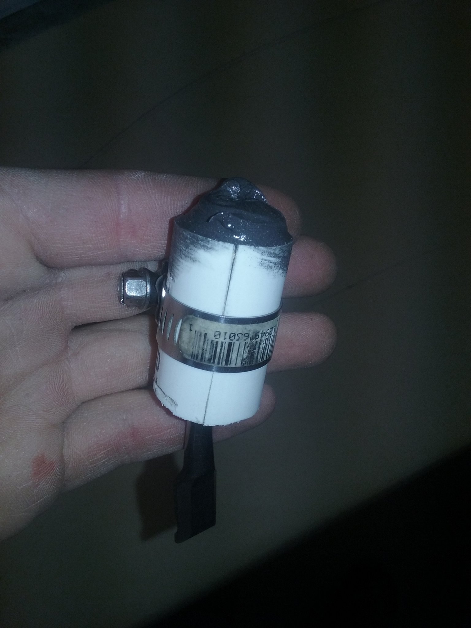

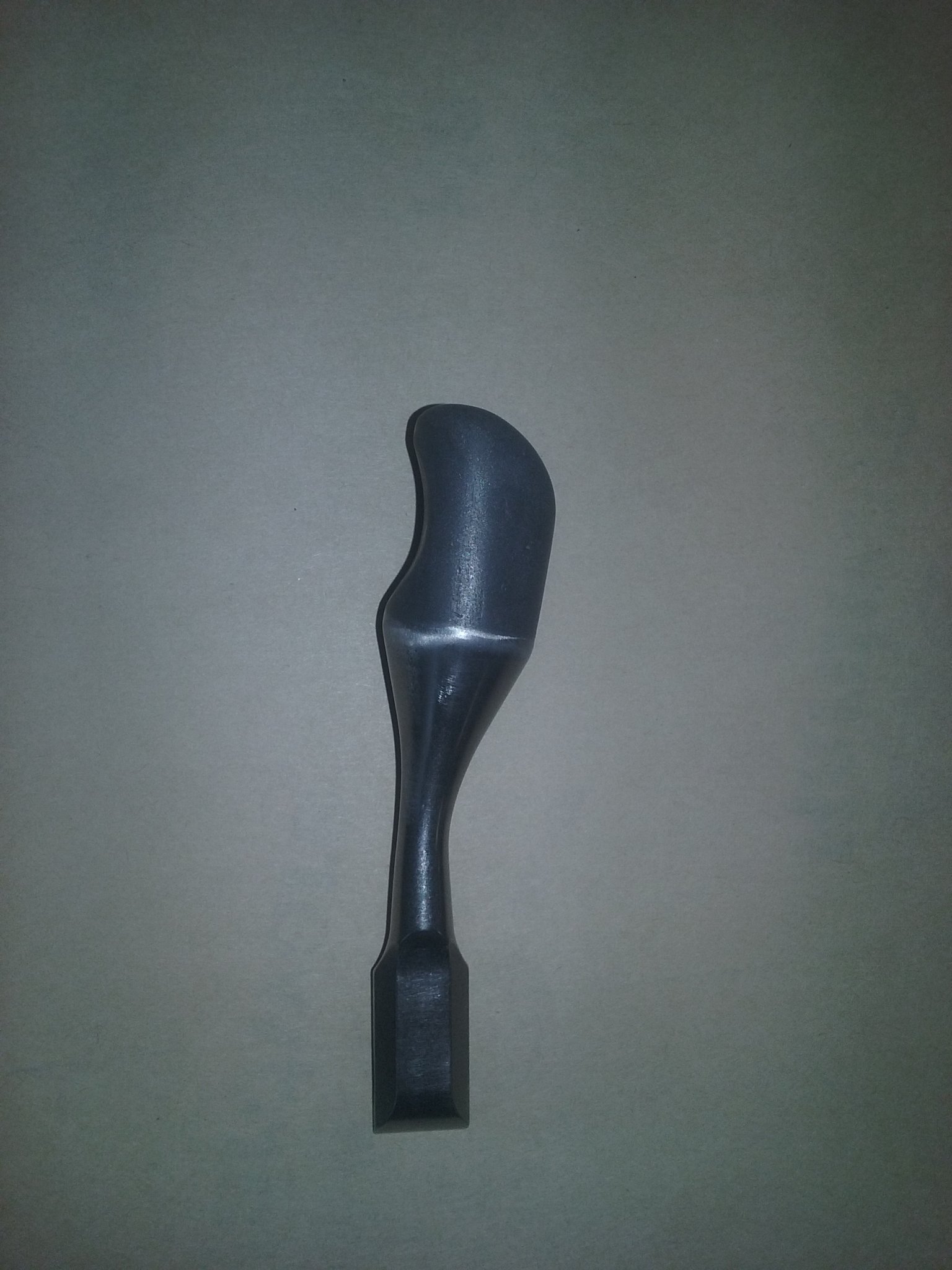

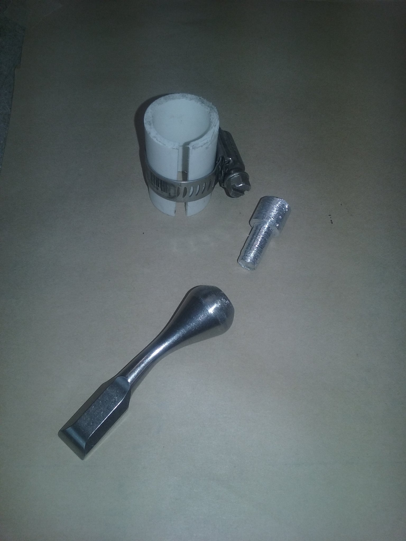

Split piece of pic with a pipe clamp might help you get a nicer start. here's how I've Done my tikkas for a while.
Can I see a picture with the bolt on the rifle? Thanks. I like the contour, cause lifting the bolt its often just the side of my finger, and that looks like the purpose of the knob.
