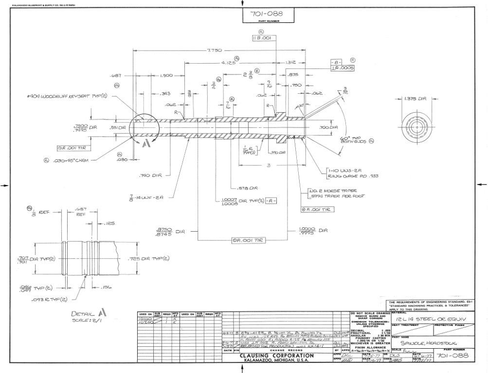

TLDR warning. I'm attempting to make this spindle from something other than 12L14 leaded steel.
I don't have access to 50 BMG barrel drawings atm. (I have them somewhere or could find them again).
Max ID is .578" and Min ID is .531" so the example I'm looking for can be well and truly shot out.
If anyone wants to take the time to look the drawing over and see if there is enough material in the breach end to make this spindle, do please have at it !

I have enough lathe to make the part (not this little 6" toy) but drilling/boring that half inch hole would suck.
