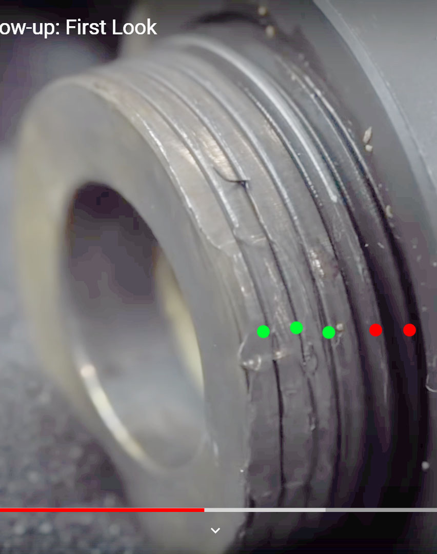

You are phrasing it as if the cap failing alone should not cause damage to other parts. The cap failing is what caused the chain reaction of everything else that became damaged. The chamber is in one piece. The poor design is why it had an unintended rapid disassembly when the cap was shot backwards.
If that chamber was grenaded, maybe the argument could be made that the round alone would have destroyed any other rifle.
I'm not convinced the round alone is to blame for this. It's just as plausible that certain rifle parts became fatigued from normal use, it so happens that a slap round was shot when it failed, which directs most attention to itself being the cause.
Is it possible the cap was say a 1/4 turn short of being fully tightened thereby causing excessive headspace or are the ears so tight a fit that that is not possible? And would that scenario cause this level of failure?
The two "supports" that sheared off behind the cap are supposed to prevent this from happening. They claim the rifle can't be closed into battery unless the cap is all the way forward. But maybe it had enough slop that this is exactly the cause. Possibly a bit of debris got on the cap surface, so when threaded on there was a gap.

I took a screenshot and brightened it up. Looks like only 3.5~ threads were holding the cap?
