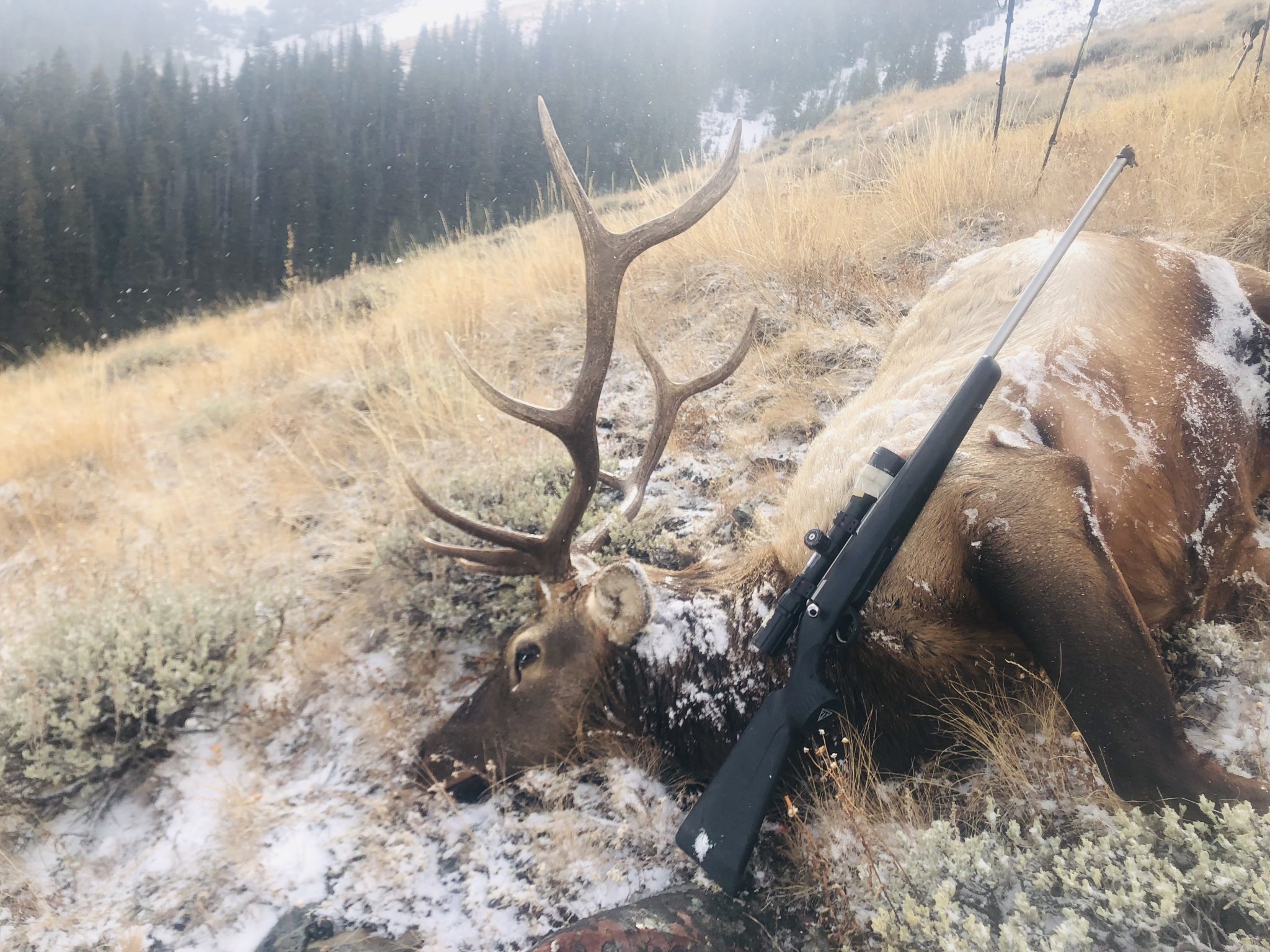

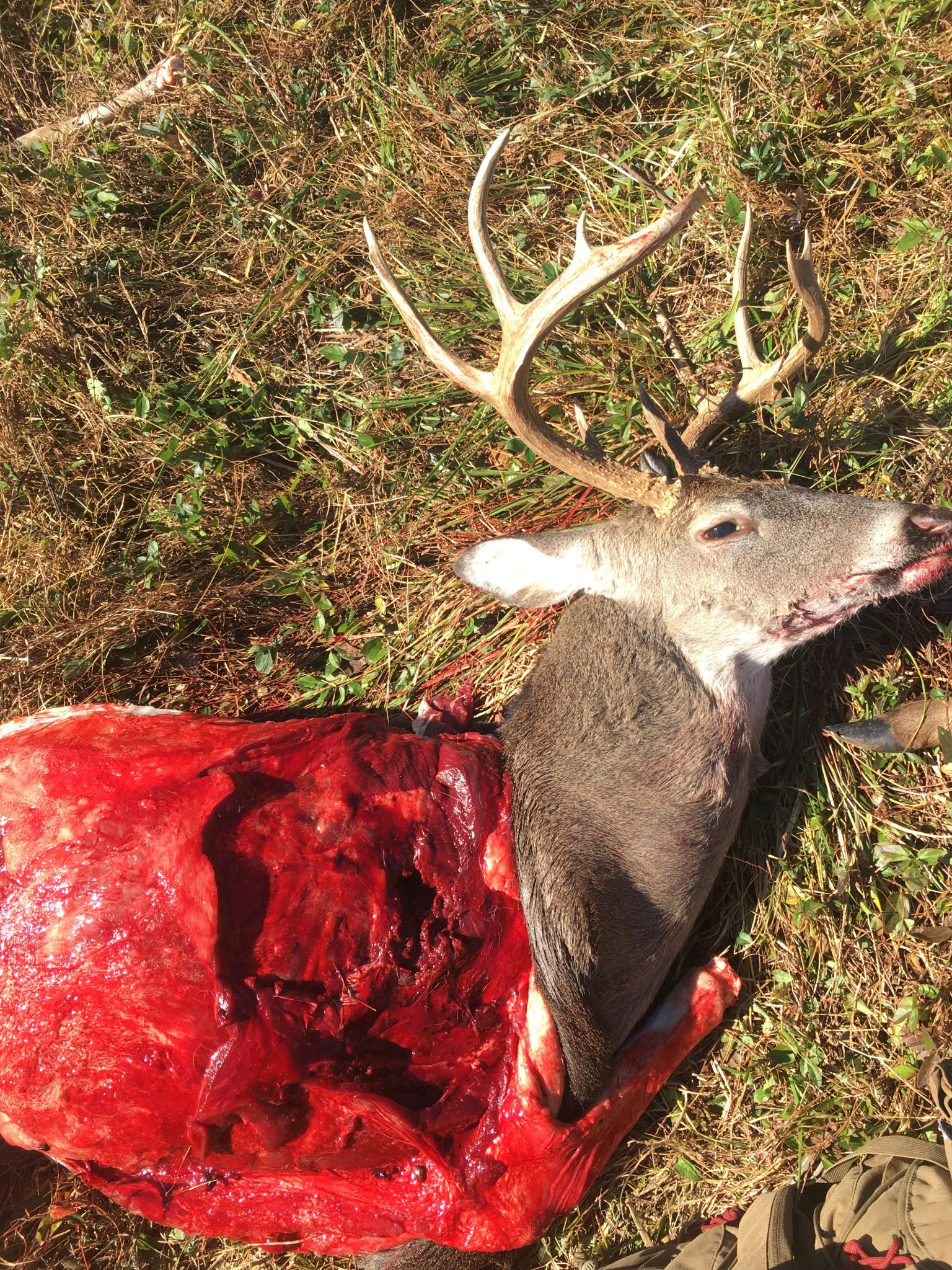

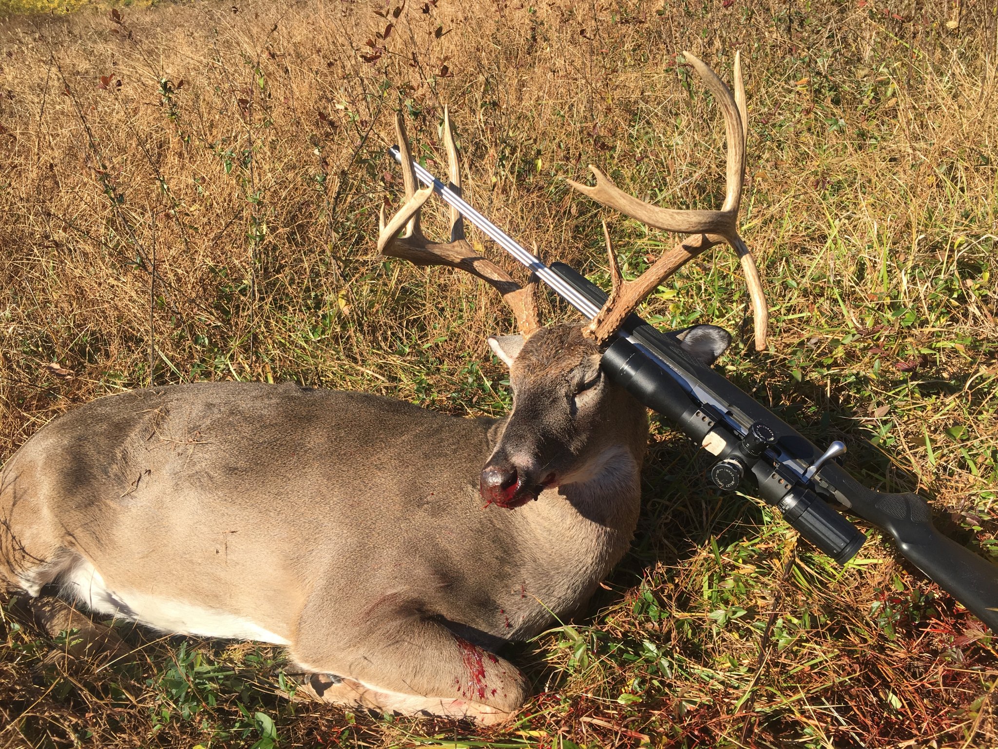

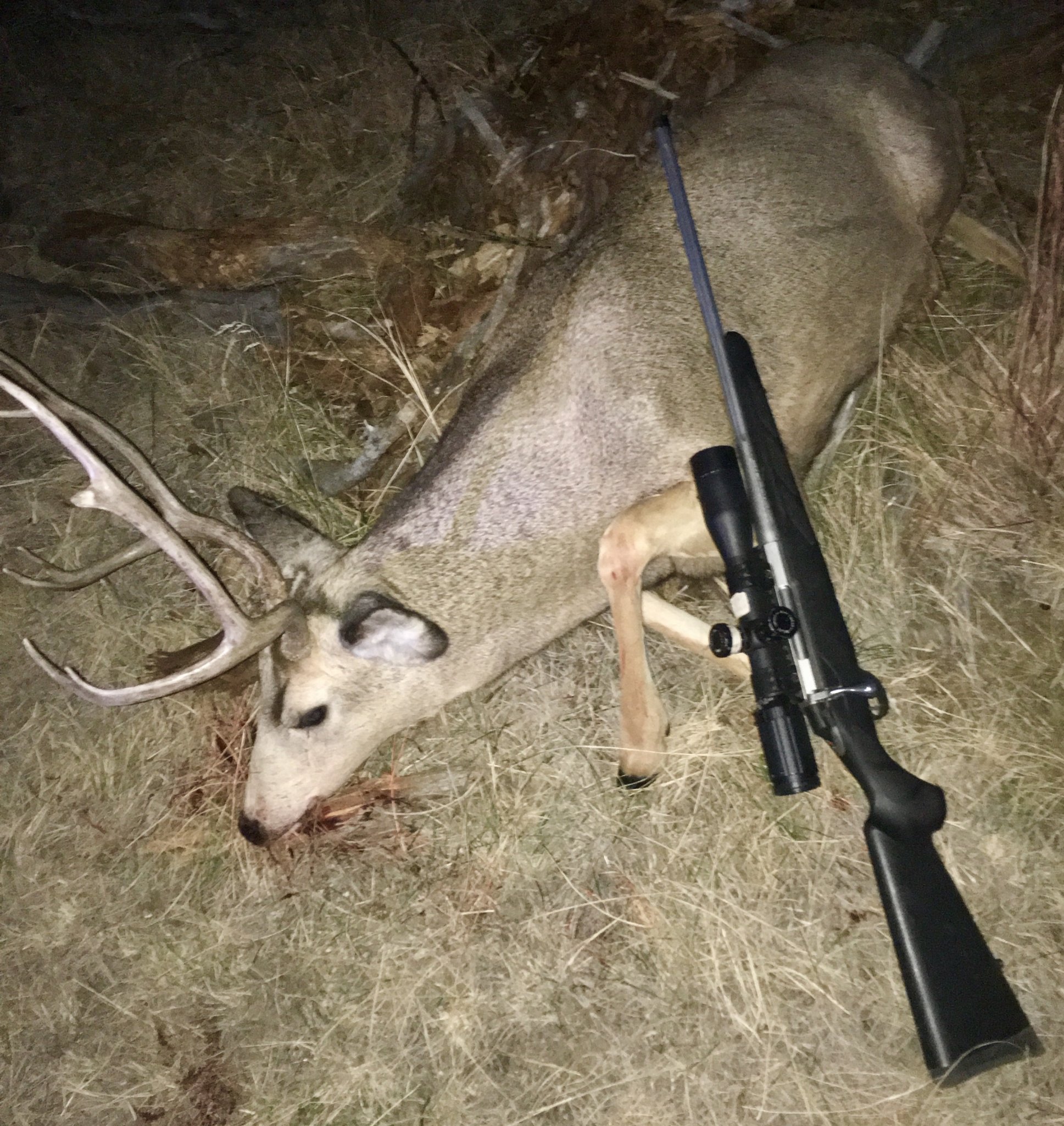

I don’t recommend.223 for everyone, but after over 100 big game animals (including elk and bear) my statements aren’t opinions.
I’ve given you the measurements. Now it’s up to you to explain why it takes a magnum to punch through ONE INCH of animal with a little energy left over.

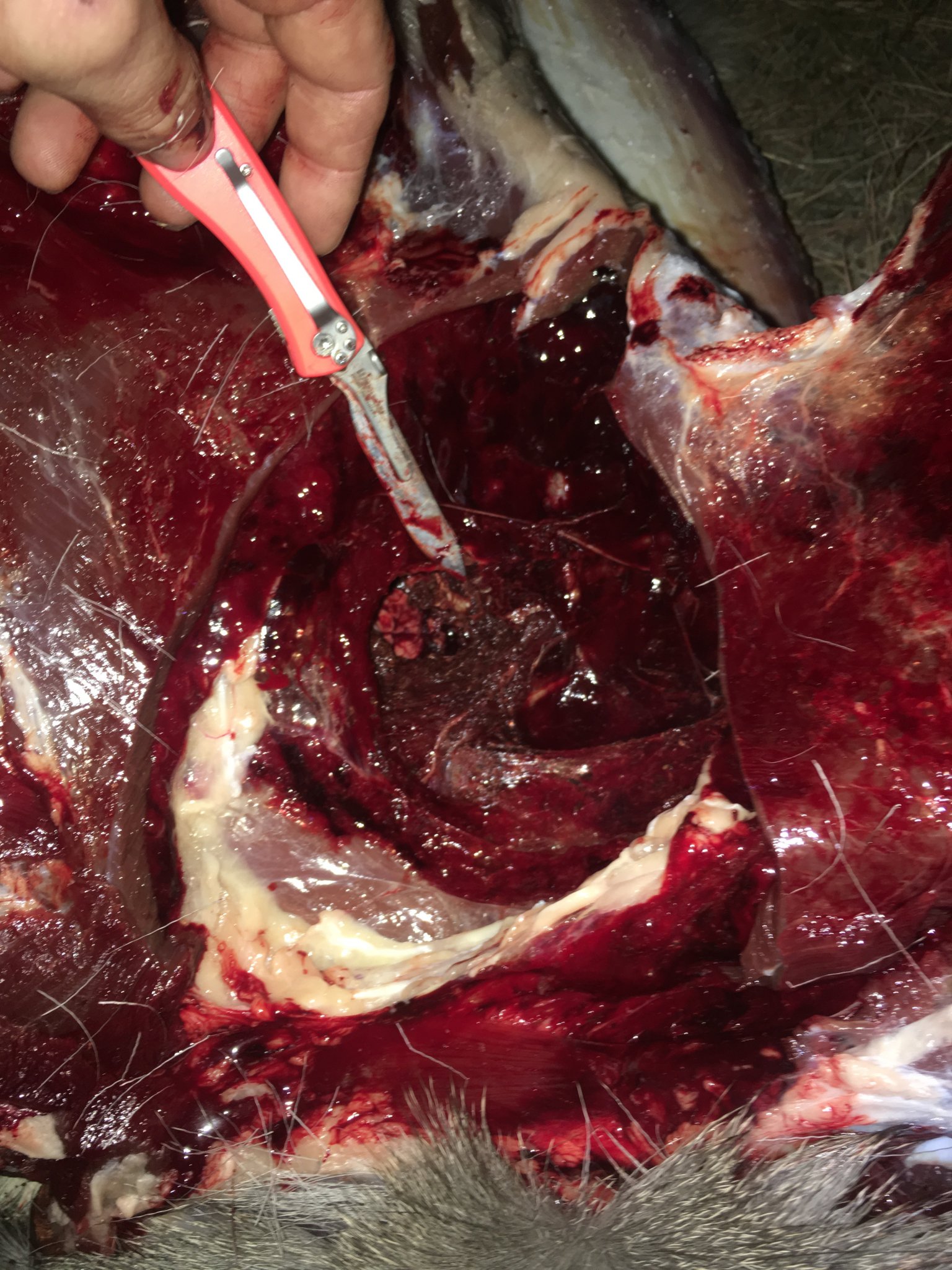

Actually, yes. Measured. ONE INCH and then you’re inside the chest cavity and the nose of the bullet is touching lungs. Obviously you need a little left over energy to damage vitals (very little, lungs are extremely fragile).
I have photos somewhere with a measuring tape. There’s a chance I can dig them up.

BTW, odd anecdote, a double lung shot with 60 grain v-max will usually pass entirely through and exit the elk. DRT. If the bullet strikes the heart it will turn it to jelly and then stop. Also DRT.

When striking the vitals, there is literally 1 inch (ONE) of hide, and rib or muscle before the bullet is inside the vital organs. I’ve measured.

Ironically, my first experience with a .223 on elk was the result of a hunter with a belted magnum injuring a bull without creating a fatal wound. The bull was about to enter heavy timber in very steep terrain, and none of the magnum’s follow up shots were hitting the bull. There was nothing to lose from trying. The results were what you’d expect if you understand anatomy and terminal ballistics.

Yes, that’s been my go to round for a while. Absolutely devastating.
That’s the bullet that dropped both of the elk pictured previously.
People can’t grasp what that bullet does to tissue.

We've killed 8 Elk so far this year since the beginning of July. Last year was at 30, year before that over 20. The FIRST question I ask my hunters, is what Cartridge / Cal. are you shooting? Facts are most don't shoot like you guys here do, which is why I make them shoot, to not only verify zero, but to verify they can actually shoot. I could tell you a few horror stories that would make you cringe, not a good deal.
I've killed Elk with a 338NM, 300WM, 7mm, 260, and Bow. From experience and seeing how other people operate I don't trust small calibers, nothing against those who are proficient with them, but I have yet to see someone out of 100's that I would personally trust with a cartridge that doesn't have the energy to break bone, and kill a 700-1200 lb animal with a mildly misplaced shot. I'm in a different, more unique situation, which is why I scrutinize who comes in a little more than most.
Here's a pic of the 6.5 PRC I got finished up a few months ago!
