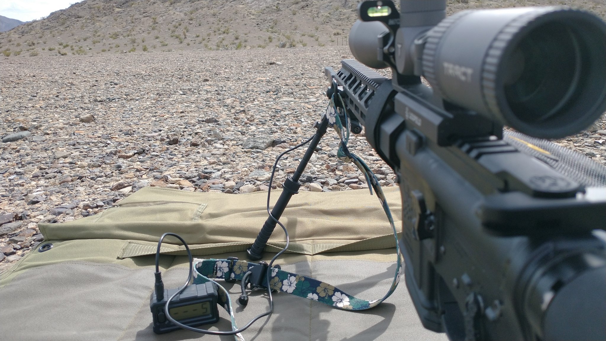

Today i loaded up a a seating depth test and shot 36 rounds with 25.2 based on the ladder test. At 72 degrees. About 2\3 of the cases I could just barely find the ejector swipe if carefully rotated in the sun. At home I couldn't even find any swipes up to 26 gr under bright light in the reloading room. 2.245 oal 3 shot group .4 moa was the best of the day. Tested in .003 increments down to 2.215. No groups over moa. Found another node around 2.230 worth investigating with groups around .6 moa.
Upper is a ruger mpr with a linear comp on it. Always been impressed with the accuracy for what it is, but the barrel fouls and is like sand paper compared to my woa. Can't even remember all the details of my lower build lol. Let's go Brandon lower with triggertech trigger set at i think 2.5 or 3 lb. Seekins lpk. Magpul prs lite stock. Put a ares btr gen 2 4.5-27x50 on it for accuracy testing. Normally wears a 2-10x40 tract for song dogs
