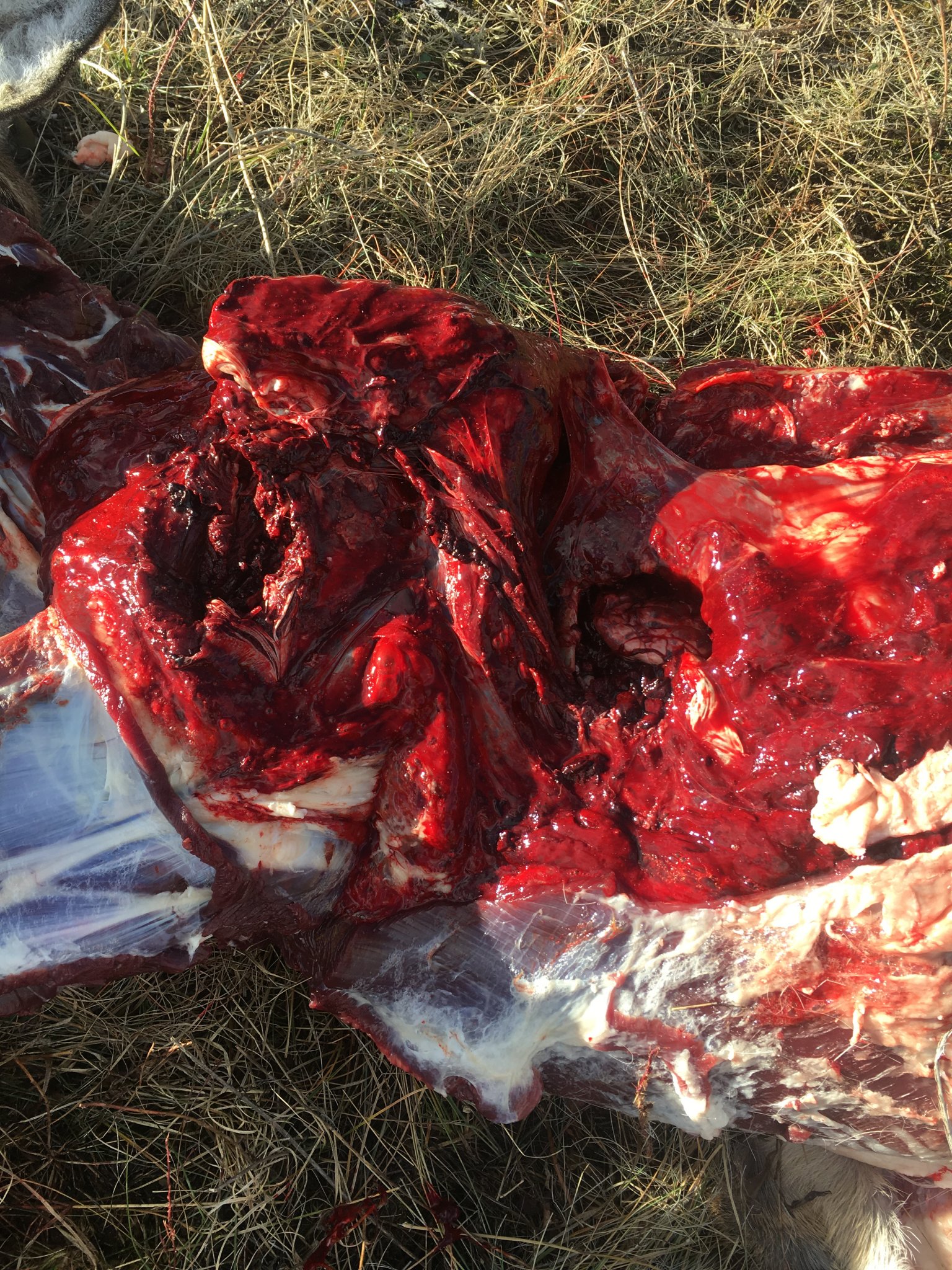

This is the result of a 147 ELDm on a 250yd Whitetail buck. Leaving the muzzle at 2950. It hit him like a sledgehammer!

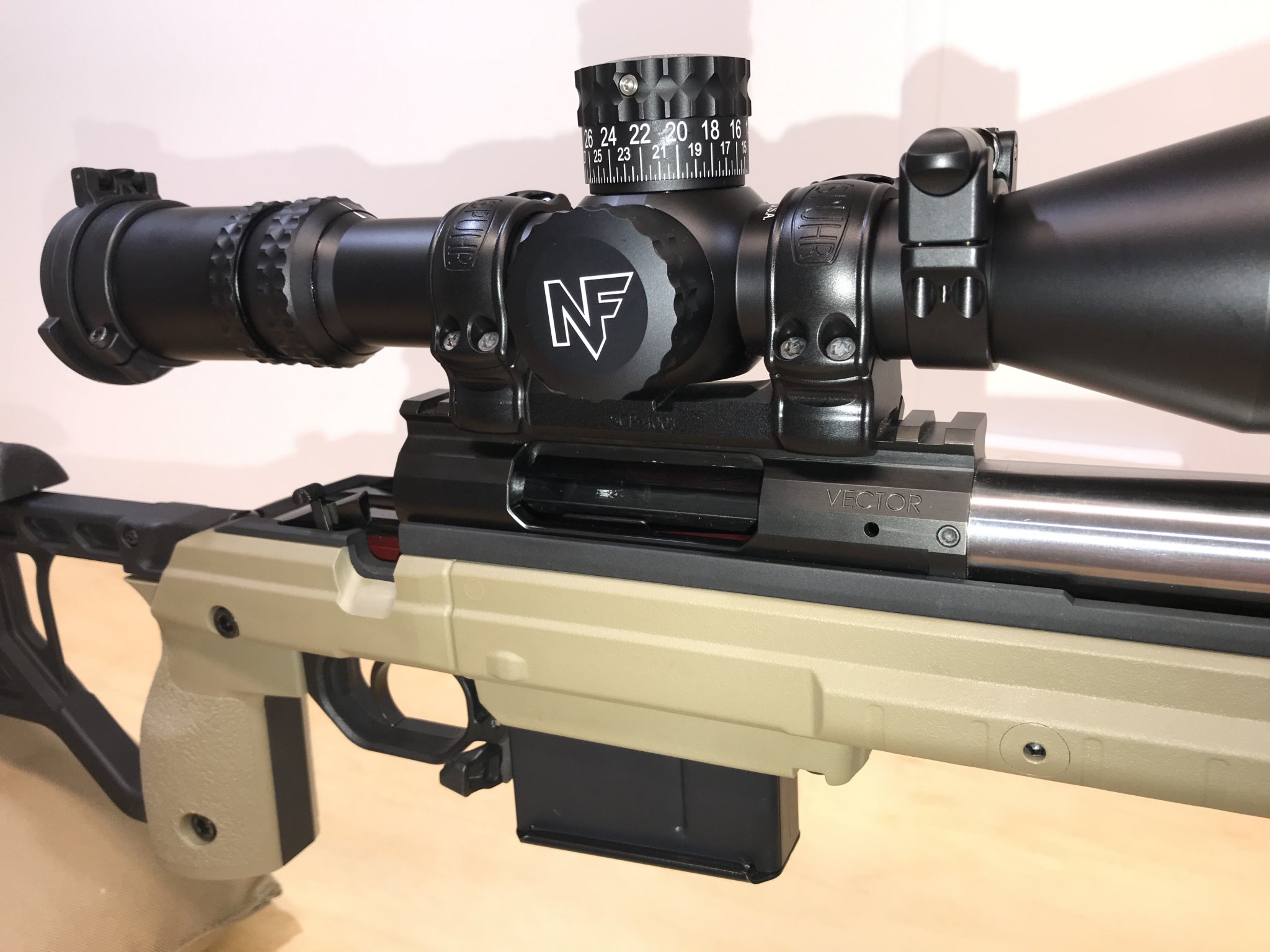

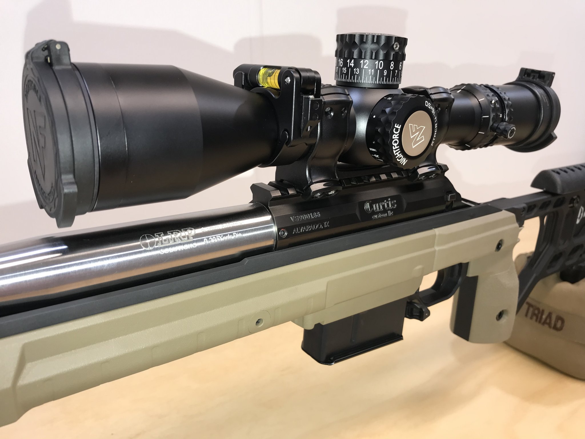

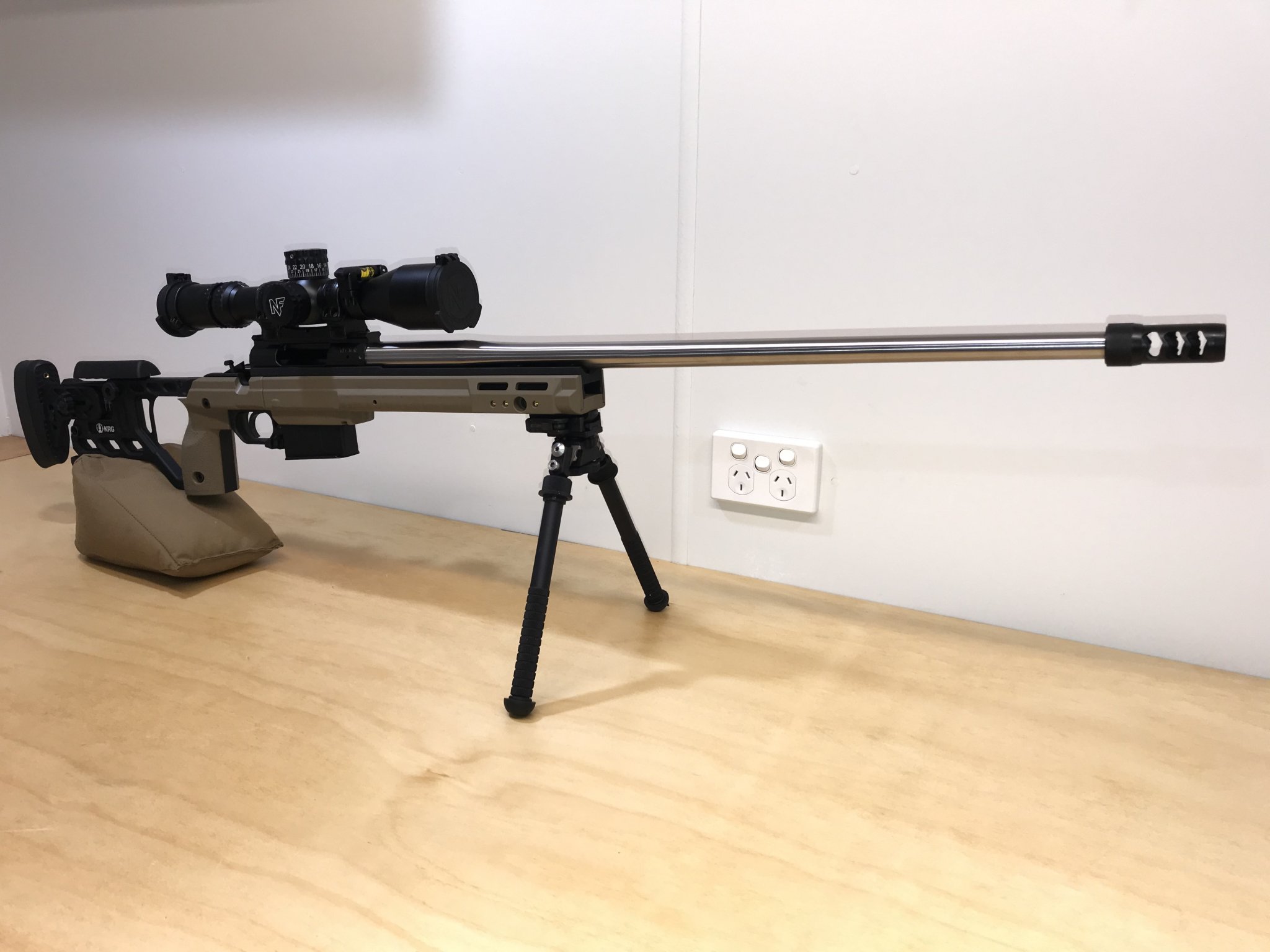

I finally have my new rifle chambered in 6.5 Addiction up and running:
- Curtis Custom Vector short action
- TT Diamond trigger
- KRG W3 G6 chassis (my first chassis)
- Bartlein light bull barrel 1:7.5 twist @ 26", with a 5" breach
- NF ATACR F2 4-16
- Area 419 brake

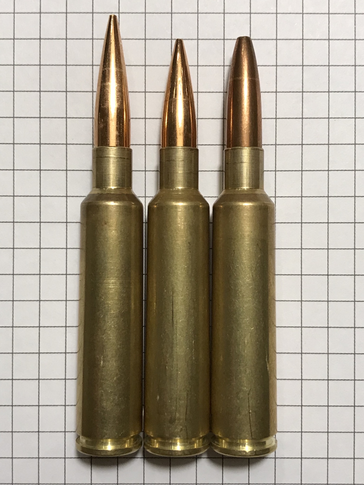

i'm currently fire forming brass with 140 gr Berger target hybrids and 47 gr AR2213SC/H4831. My first attempt with different projectiles to magazine length didn't go so well (66% ignition failure), but now I am jamming I'm getting lovely small groups.
Rightly or wrongly, I throated the chamber to best suit a 140 gr Berger positioned in the optimum position, ignoring magazine length, with the intention of shooting 140 gr Woodleigh PP SN and 130 gr Berger AR Hybrids from the magazine (generally for hunting) and single feeding the 140s (and anything heavier) for longer hunting and target shots. I plan to stick with AR2213SC/H4831, because in here in Australia the supply is more consistent (but not great) than Reloader. I hope this approach will work, but time will tell.
I'm looking forward to load development and getting shooting!

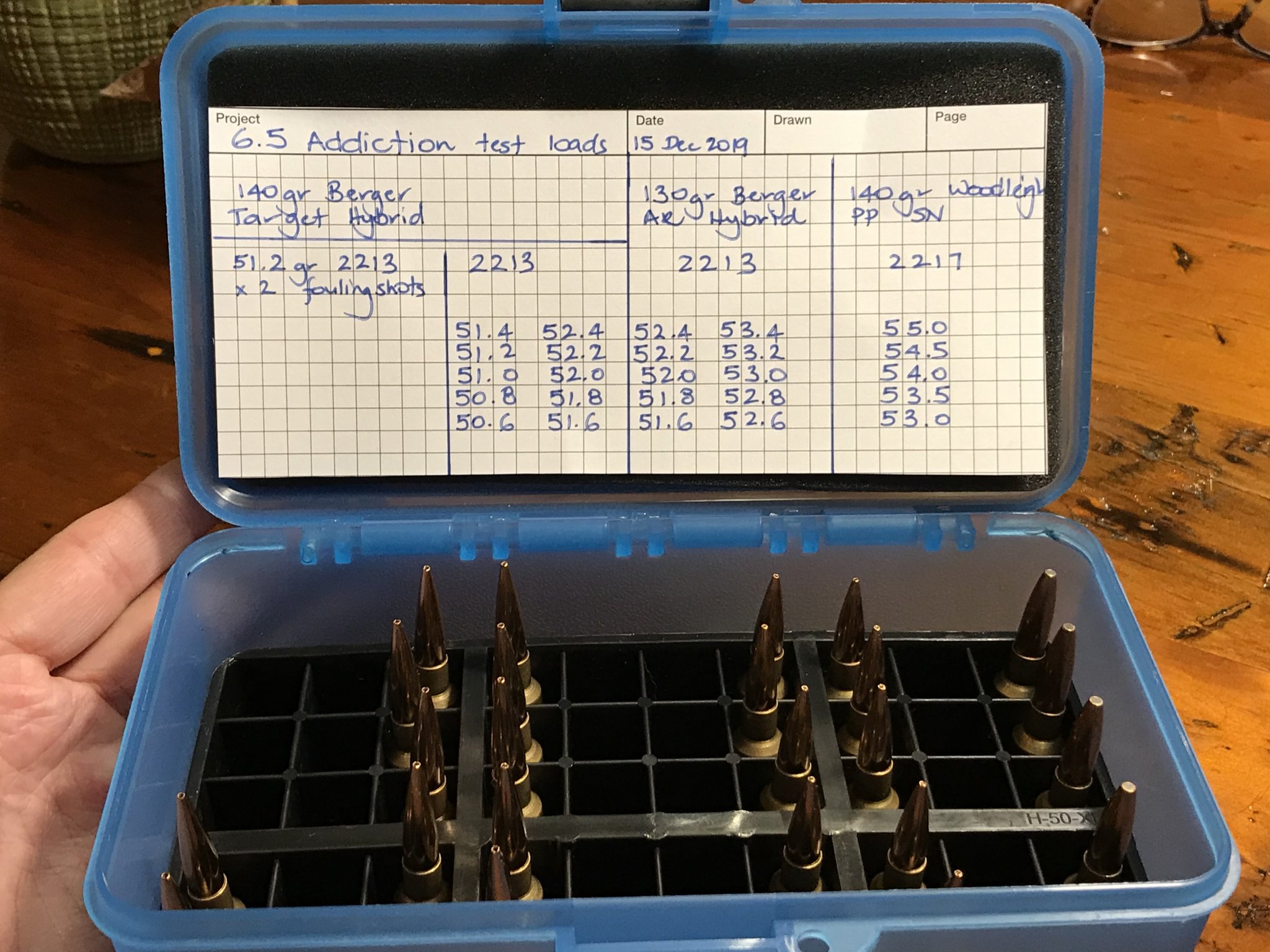

Okay, I finally have 100 pieces of fire formed brass, so its time for load development. I have:
- powders H4831, plus H4350 and H1000;
- projectiles for ARC mag length 130 gr Berger AR Hybrids and 140 gr Woodleigh PP SN (which has a long bearing surface); and
- 140 gr Berger hybrids for single feeding (my barrel is throated for these).
My barrel is 26" with a 1:7.5 twist.
For hunting and general plinking loads (not hot strings), I plan to start with:
- 140 gr Bergers with H4831, below 51.2 gr and work up. I would be happy with something around 3,030 fps or so.
- 130 gr Bergers with H4831 at magazine length. Any suggestions for a starting load?
- 140 gr Woodleighs with H4831 or H1000 at magazine length. Again, any suggestions for a starting load?
Thanks.
For the 130s, I would look at some of the information for the GWI or contact Kelbys. One of their shooters was on a thread that mentioned using 130s in the GWI, I think he was shooting H4350.
Thanks.

Cases prep’ed and test loads ready. I will shoot Friday afternoon, can’t wait.
