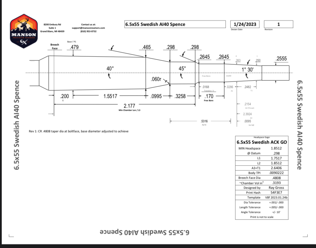

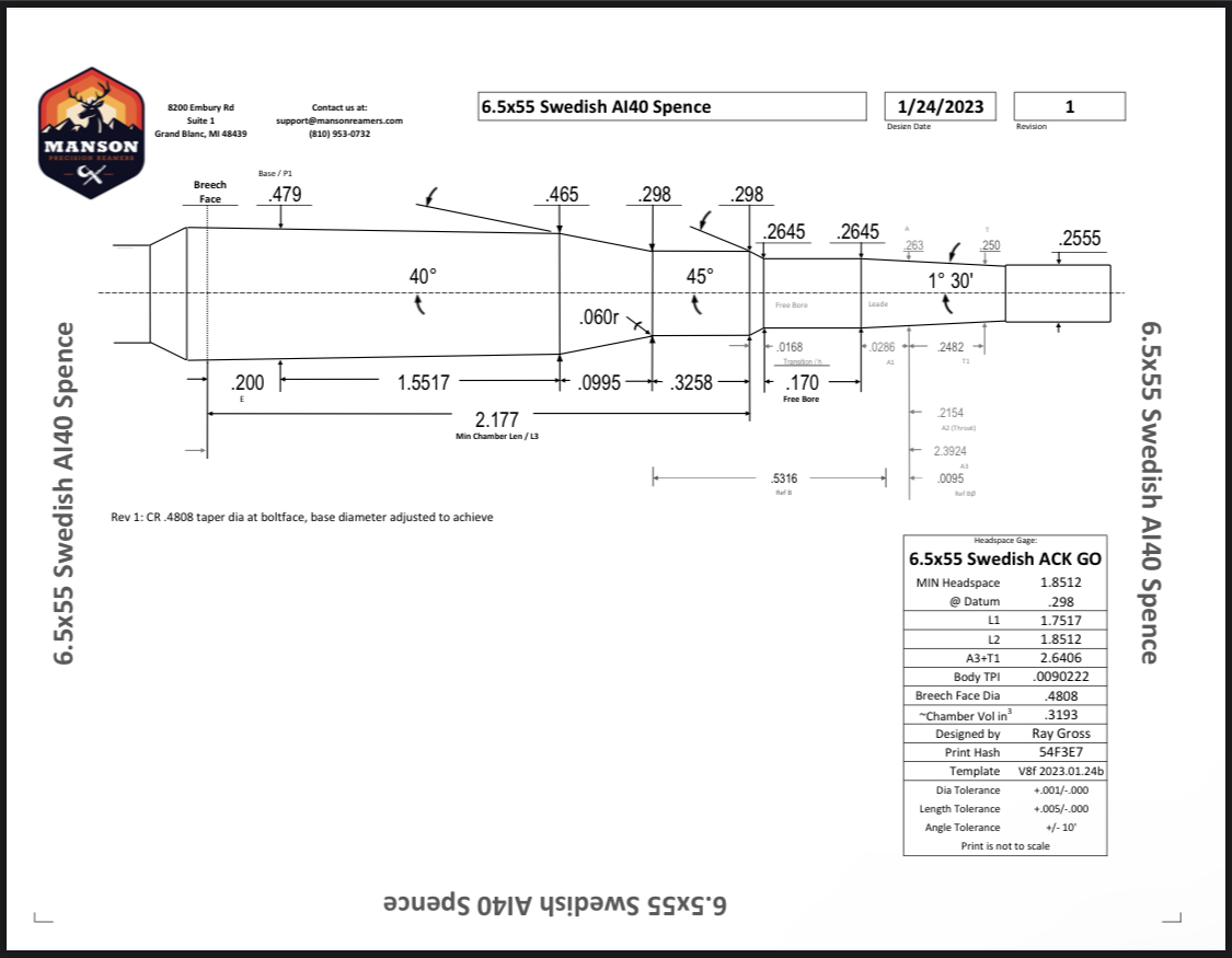

Today I was scheming on assembling my newest rifle for which I have 1 action (SHORT ACTION) and will have several different barrels. I want a 6.5 addiction which is based on the 6.5x55 case. The Addiction for those who don't know is designed to use 140gr berger Hybrids in a short action with a COAL of 2.945.
I was curious since I can get pre-fit barrels from Proof, whether or not, I could just have a 6.5 CM reamed to the 6.5 Addiction. In order to figure out if it was possible I found the reamer prints and this led me down a rabbit hole of designing and 3d modeling different cartridges based off of reamer prints.
The findings are as follows:
NO You cannot ream out a 6.5CM to a 6.5 addiction. You can, however, ream a 6.5x47 Lapua chamber to 6.5 Addiction.
-You can also ream 6.5x47 Lapua out to 6.5 BJAI/6.5x55 40* improved and 6.5 GWI.
-You can ream 6.5 CM to 6.5 BJAI/6.5x55 40* improved but NOT 6.5 GWI
-IF you just had to have your 6.5 CM set back and wanted to run 6.5 Addiction you'd have to take a minimum of 0.78" off of the chamber end to run the reamer far enough to clean up the 6.5 CM as the 6.5 CM body has far less taper than the Addiction.
When changing Opacity of each cartridge and overlaying the 6.5x55 swede improved cases I don't see much reason other than MAGAZINE LENGTH and FREEBORE holding one back from loading up to a 140gr bullet in a short action like the 6.5 Addiction Short action does. I've had Berger Hybrids do quite well at even 0.250" jump and have heard people REALLY jumping them, like 0.500" yes, half an inch.
Freebore is as follows:
6.5 Addiction SHORT ACTION 0.010"
6.5 Addiction LONG ACTION 0.120"-0.188"
6.5x55 BJAI 0.188"
6.5x55 GWI 0.191"
In conclusion:
To summarize I would say that if one wanted to magazine feed any of the above 6.5x55 improved cartridges in a short action it appears possible so long as you have a magazine capable of feeding a cartridge with an overall length of 2.945". I personally have ran Berger 156 EOL in my 260 rem built on a Gunwerks GRB short action in MDT magazines without the binder plate at 2.975 and there is still some room... little
but enough: and I haven't had a problem feeding them.
I hope this helps anyone who finds themselves relentlessly searching the internet for answers.
REAMER PRINTS USED:
BJAI- PTG (6.5x55 swed. mauser ack improved)
GWI- PTG (6.5x55 GW imp)
ADDICTION- PTG (6.5 addiction Short action)
Reactions: MTSLW

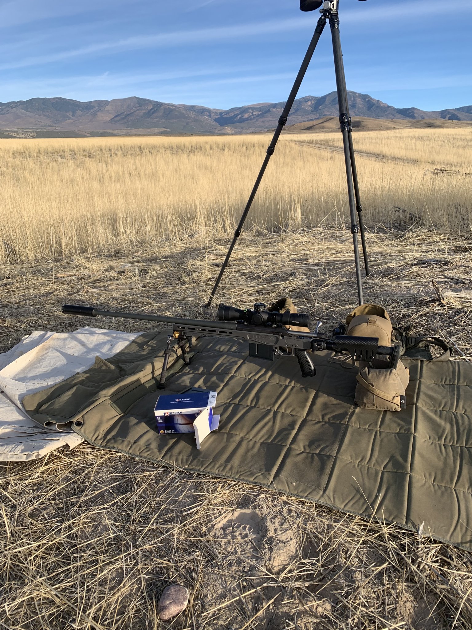

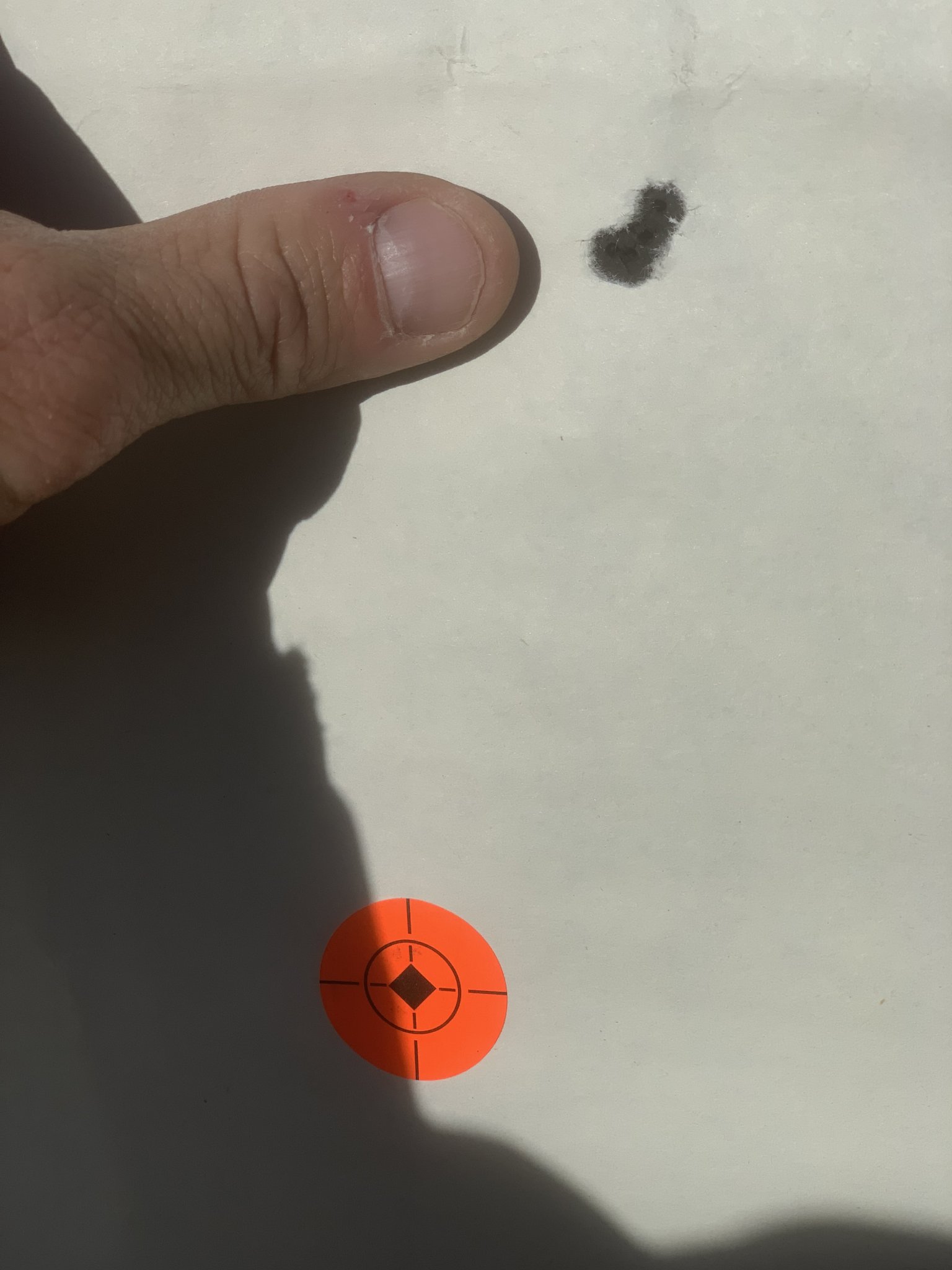

Fireforming brass the other day. The Lapua 120gr factory ammo shoots great out of my 6.5x55AI.
