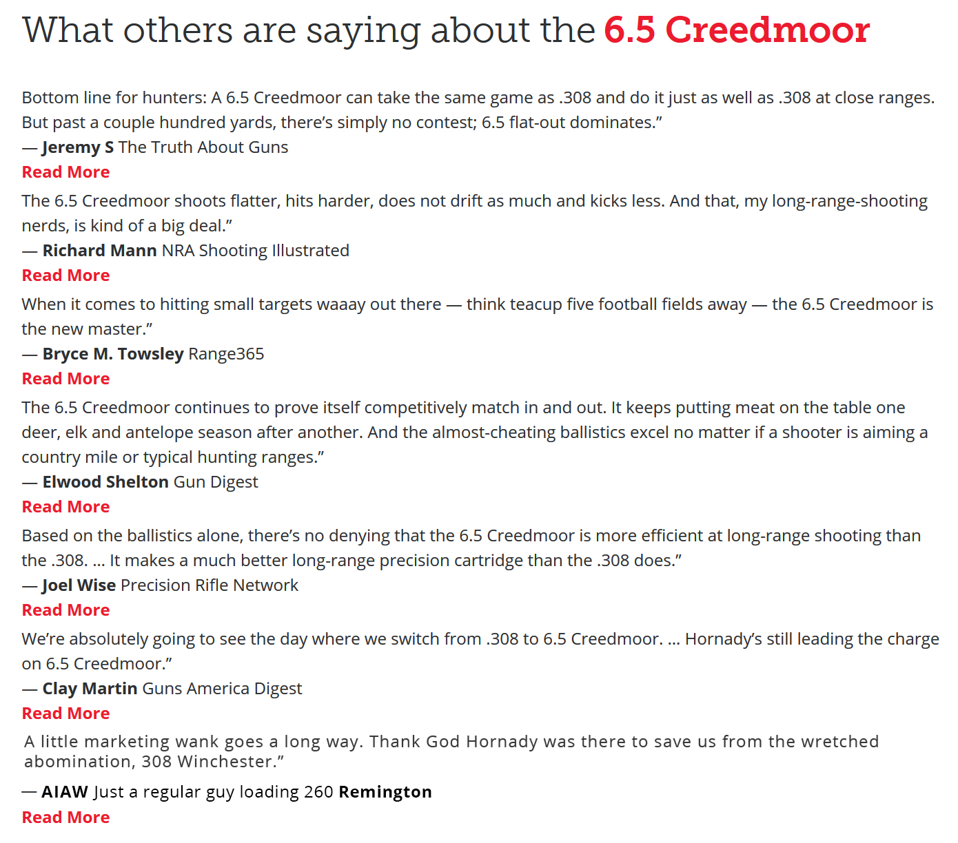

After the last decade, I am surprised and reassured that this is still a debate. I chose .260 Remington early in and after some time I began to think I bet on the loser. It works fine for me, but like the .244 Remington versus the .243 Winchester back in the 1960s, I thought it would not make it this far. It reassures me that there are still ardent .260 Remington shooters and fans.
It's easy. I can use two words to sum up the entire .260 REM vs 6.5 CM debacle:
Hornady Marketing
AIAW is right on the money.
The question between the two is not based on performance, at least not much performance. Initially I saw just as many .260s as I did 6.5CMs. This was because both calibers were relatively new to long range shooting. How Hornady handled the 6.5 Creedmoor lead to it being a clear choice in the market today. Don't confuse this as the .260 Remington being not able to ballistically compete with a 6.5, because they are very, very similar. They both launch the same weight bullets at very similar velocities. Even in this thread, users are giving a slight, but real, ballistic advantage to the .260 Remington. It is all about how the two were supported in the market.
