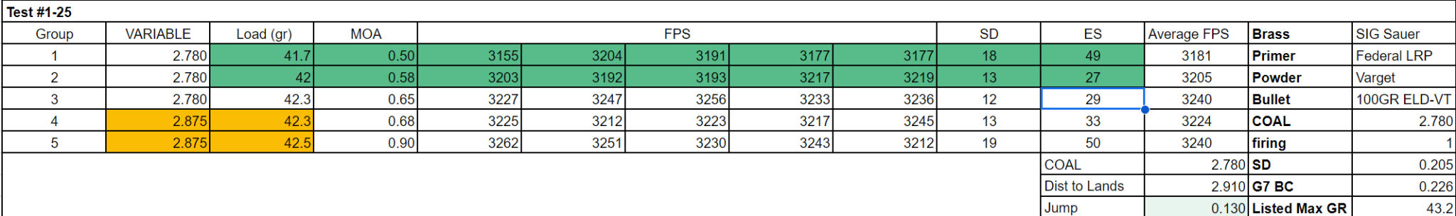

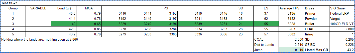

Below is my initial loadings. The Hornady load data suggested 2.775 COAL. I started with 2.800.
It was hot and there was some mirage.
Although the general accuracy was good. I am not happy with the SD's This isn't to blame the bullet or anything in particular. I'm theorizing that either the bullet needs to be slightly deeper closer to Hornady spec. OR possibly the jump is to far. I am willing to dedicate 25 more shots to this combination because the accuracy is already quite good.

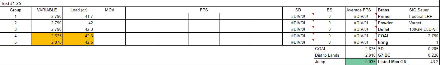

Subsequent loadings will be:
I like being 20-40 thou off the lands. I find that to provide good results most of the time. My issue is that there's not much bullet actually in the case with this length... Hence my additional 3 loads will be 2.790. slightly shorter.
Overall the bullet seems to be pretty good.

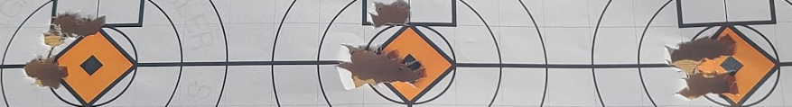

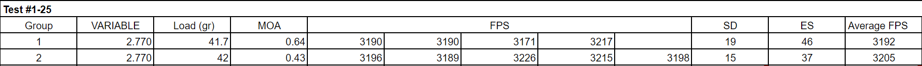

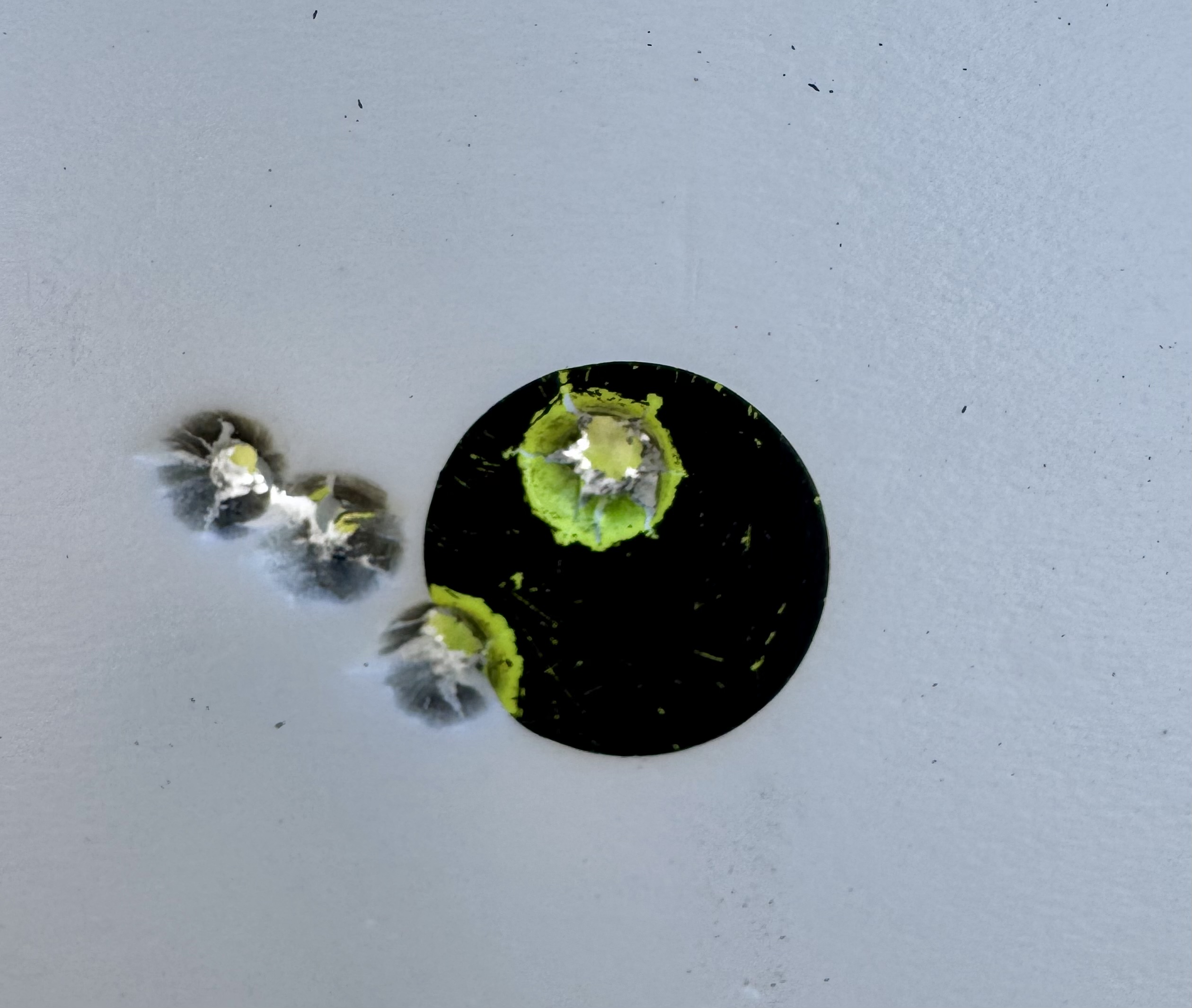

This weekends results:
So shorter COAL did lead to better SD's. I'm pretty happy with mid teen SD's.
hard part is deciding what final load to use. I am leaning towards 42.1gr @2.780

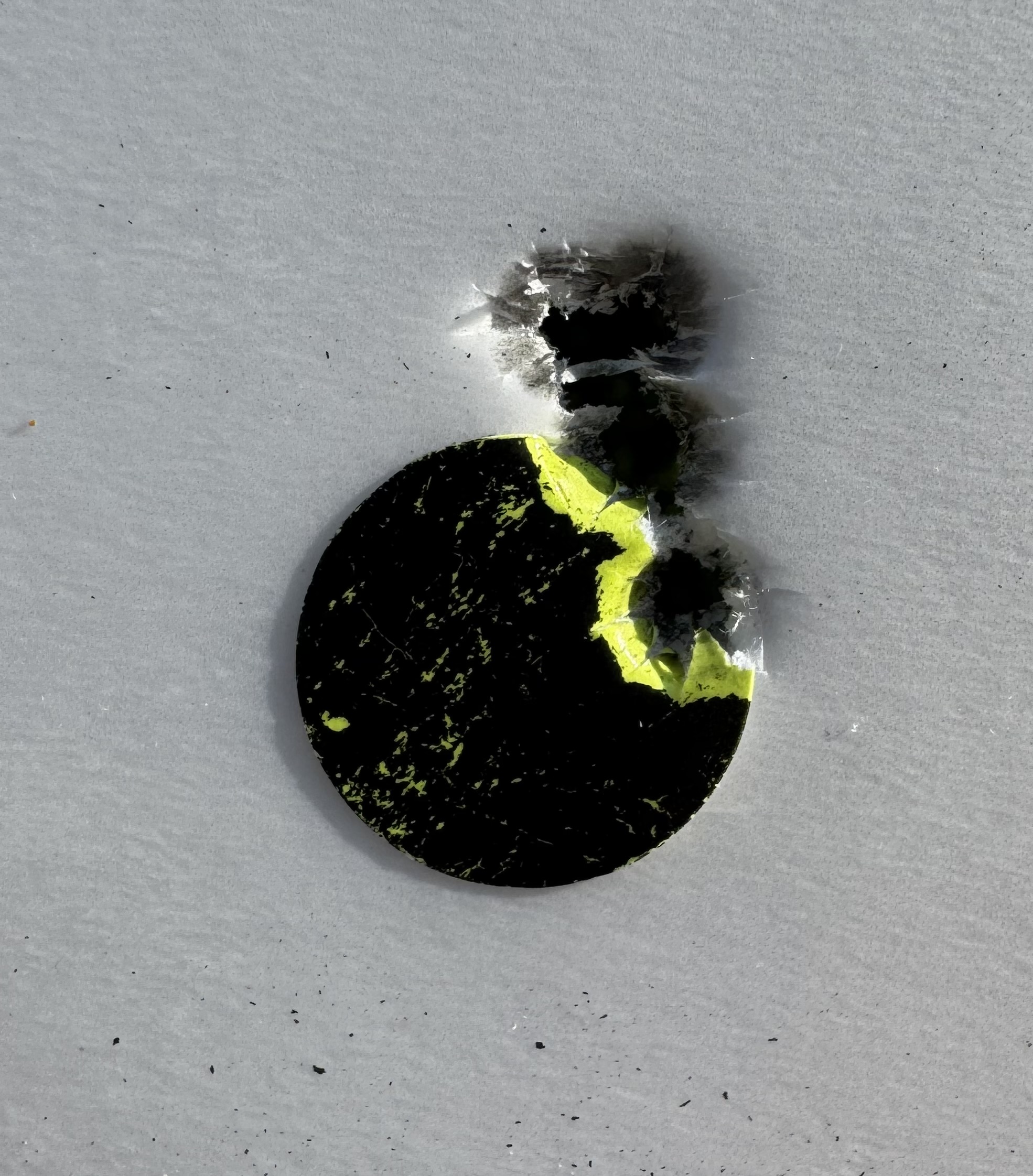

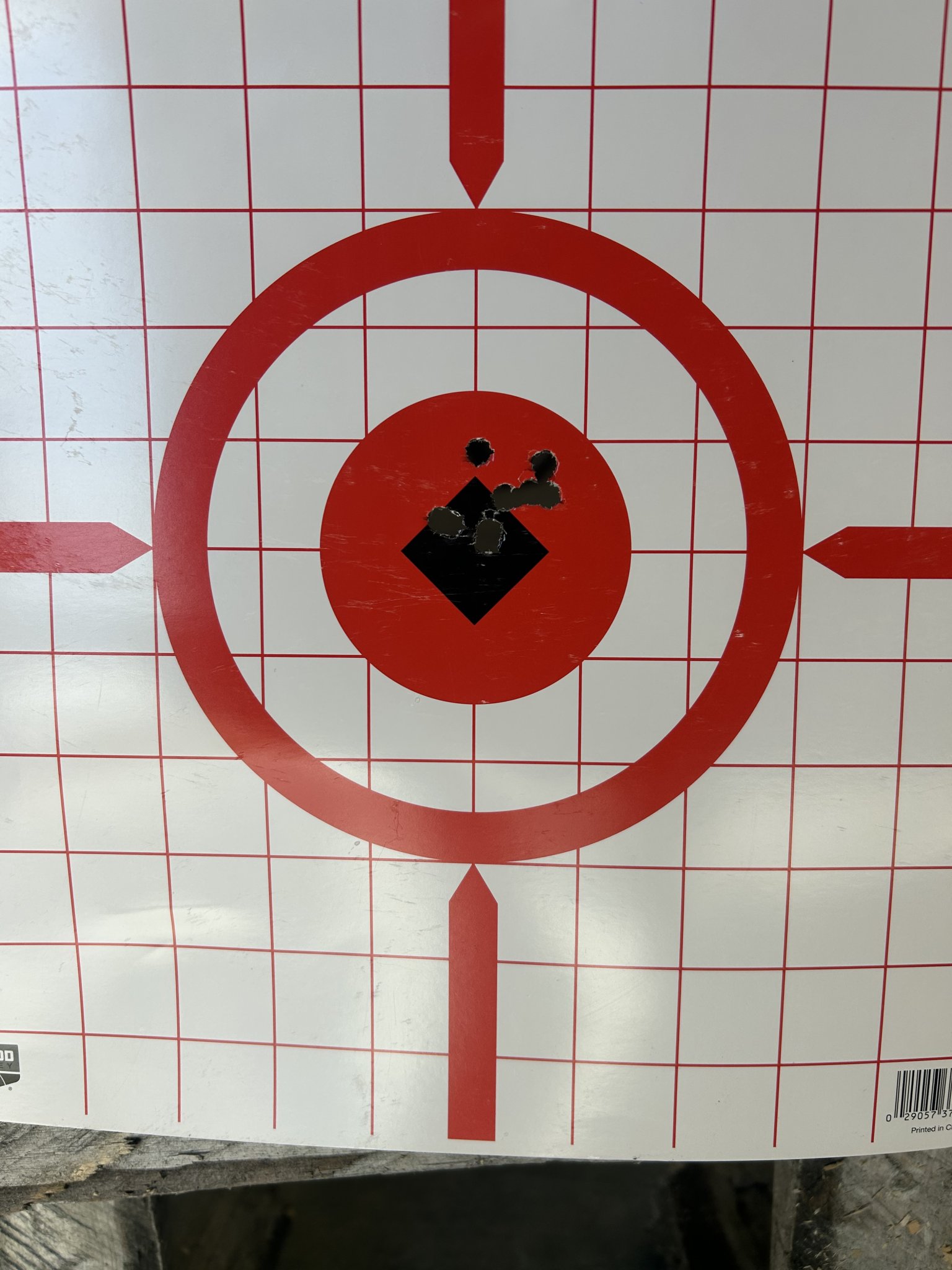

Edit: Added some of the groups. 2x .6's and a 0.4 MOA group.
I would like to touch on the accuracy overall. I reload to a goal. Which in this case was decent SD and sub moa. I achieved it. When I keep tuning and tuning I find it very easy to get lost in the noise. If you shoot the same load into 20x 5 shot groups. You know the group size will vary... Just because the last group went into 0.4 doesn't mean it will always do that. Given the mirage and scope (Bushnell nitro SFP junk) I can't even say I could shoot much better with a perfectly accurate rifle.

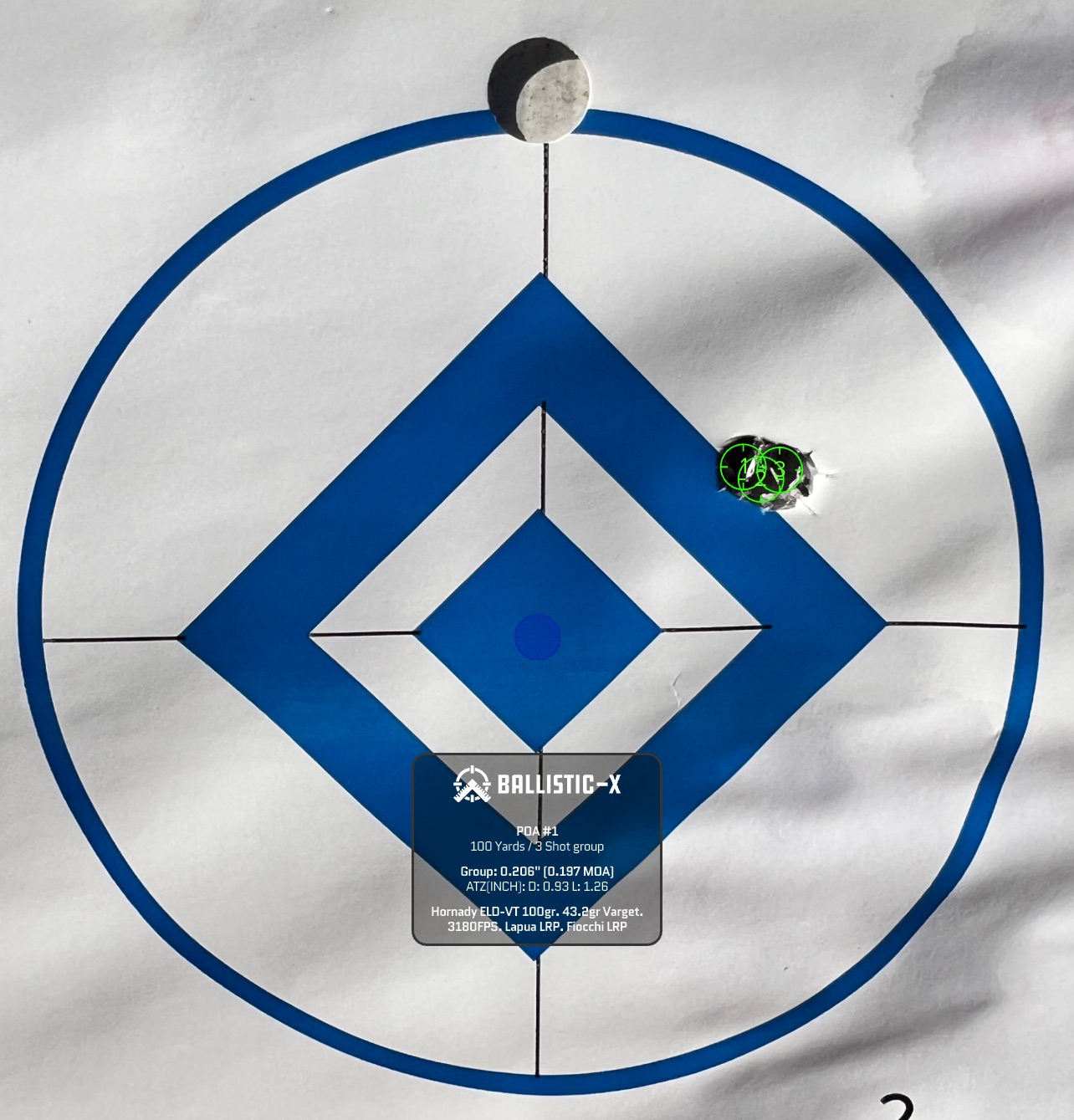

I’m seating these .020 off the lands and had fantastic results. I don’t have my book in front of me but I think it’s around 2.217 base to ogive. Loaded with 43.2 gr of Varget out of an 18” Benchmark. Results were 3192 fps at .373 moa with 4.1 SD. I do lube all my case necks prior to searing. That was on my very first load development trip and I didn’t mess with it again after that. For hunting that’s more than good enough for me. Now I just need to test out the killing capability with these bullets to figure out if I want to stick with them or switch back to the Vmax.

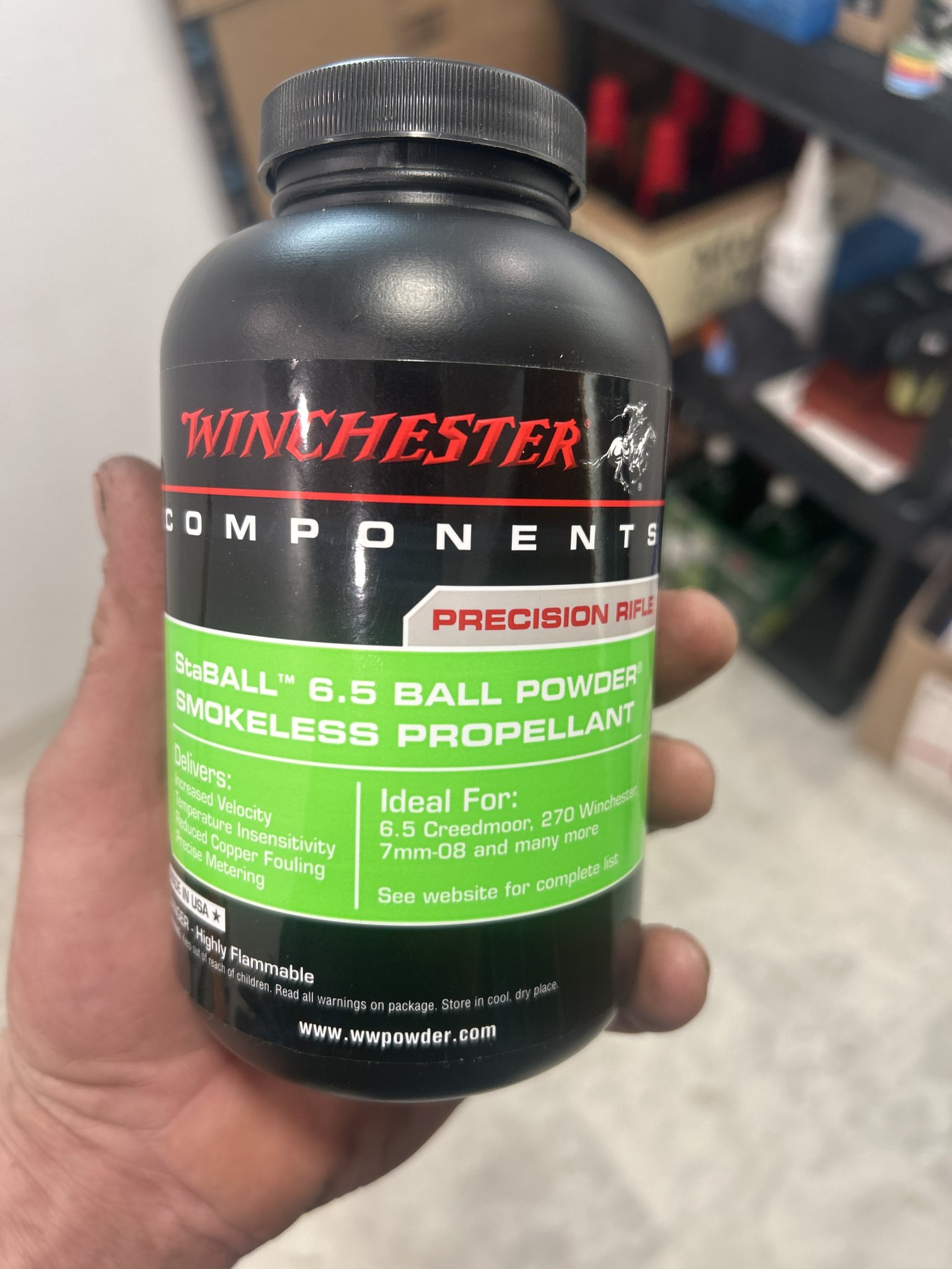

Couldn’t find match locally but I got staball 6.5, ultimateadvertiser did a video with it and got good results so I’m gonna try it. 3300 seems to be the sweet spot in my rifle and the hold is only 6.2mil to 1000 yards so I’m gonna just attempt to replicate that velocity and accuracy so I can load on my Dillon.

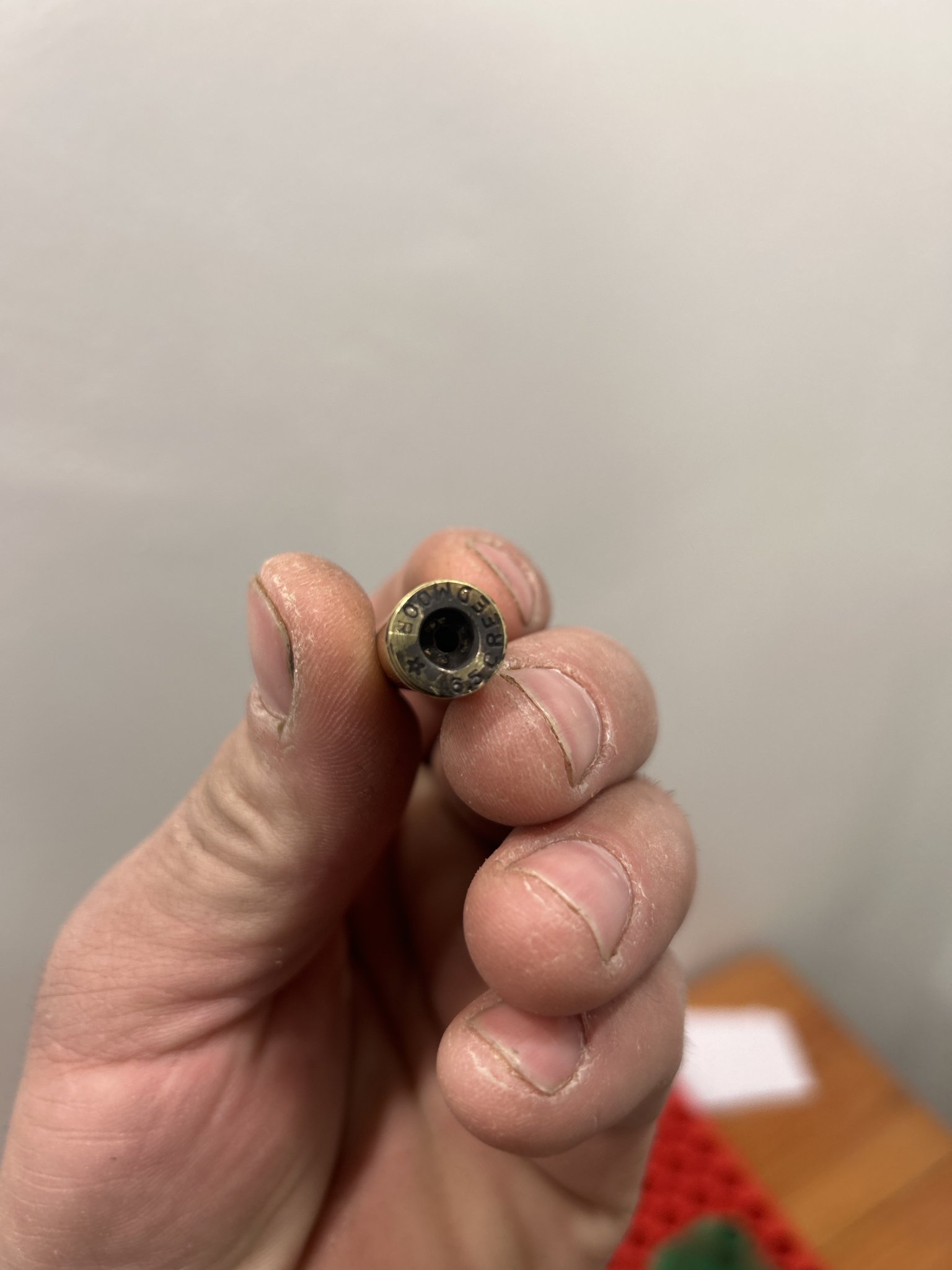

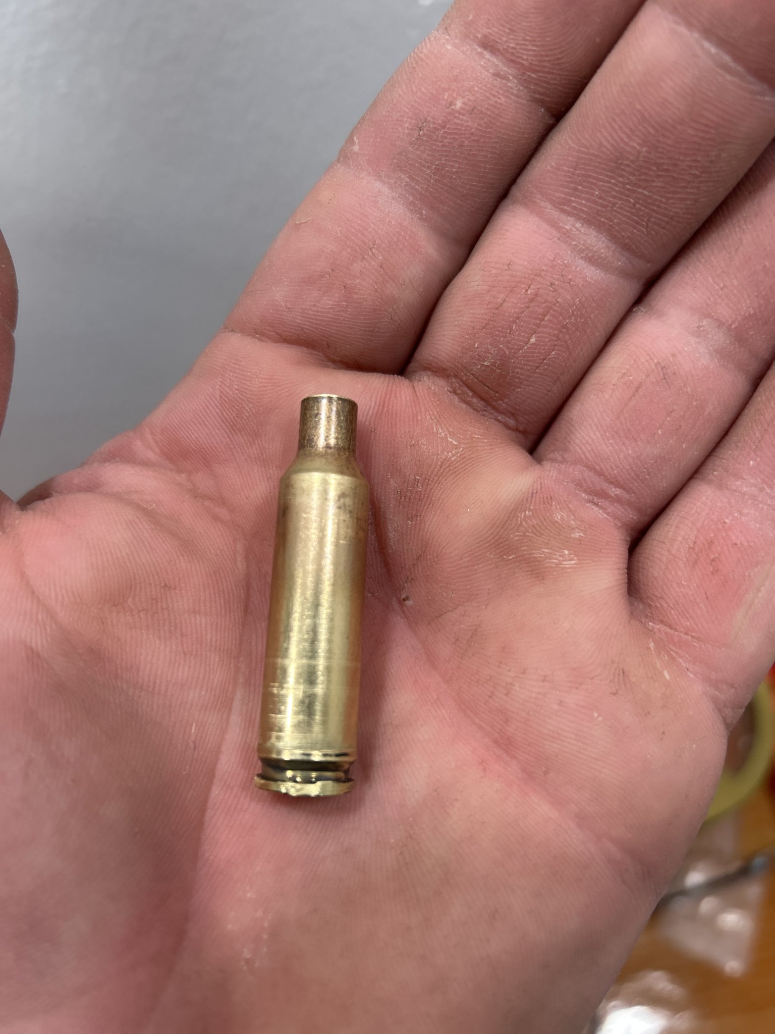

I tried the 6.5 staball powder with poor results.
100grain eld vt
47.0 grains Winchester 6.5 staball powder
Fed 210 primer
Star line brass. New
2.800 oal
Es70 sd 19 low 3042. High 3112 av 3075
Ruger American predator 6.5 creedmoor
Fired 9 shots. Bolt very hard to lift. Had a primer come out at about shot 5. Should have stopped. The 9th shot the bolt got stuck and I gave it some force to eject it. Broke the extractor and the primer had also been blown completely out once the bolt opened

I don't know if you can exclusively blame the powder, yours loads are way, way, way too hot. I have never seen good accuracy or ES/SD from primer blowing hot loads. I mean it literally broke your rifle.
I do agree on the results being odd, Staball 6.5 isn't that fast burning of a powder, and the velocity is low compared to that charge and burn rate. I got similar velocities using a moderate load of 8208 XBR, which should be all accounts generate similar pressure to your what your load was likely predicted to be (IE NOT primer blowing hot)

100% agree it was too hot but I’m just not sure why. 46.6 starting load and 49.9c according to what I found on hodgens website. Still confused on this
