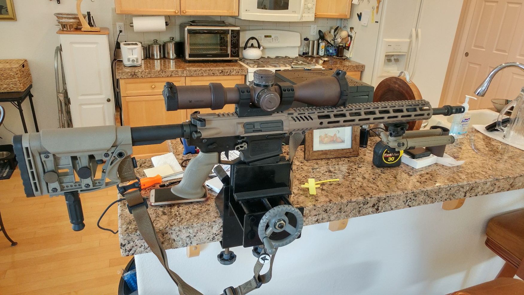

Here's my reloading 6.5 Creedmoor report for my 18" piston gun.
So, took my ladder of 10 steps of 5 rounds each, COL of 2.820, BR2 primers, Hornady 1x fired brass, 140 ELD-M's, spaced at .3 grains of StaBall 6.5 loaded from Max of 44.0 down to 41.3 grains to the range today, along with 4 steps of 5 rounds, same as above but with COL of 2.800, grains from Max of 43.7 to 42.8. I also shot 5 2020 factory Hornady Match 140's that give me both pressure and early extraction signs, and Hornady confirmed they were loaded with RL16.
No pressure or early extraction signs on my reloads. Maybe thanks to Clint at heavybuffers.com for the 8.5 oz weight and stiff spring.
This is from an 18" barrel on an Adams Arms P2 that's Omega 300 suppressed and slightly customized.
Also had some issues with the used Magnetospeed Pro that Scheels sold me as new. That's going back to them tomorrow. So, not all shots were recorded.
So....4,640' altitude, average 56 degrees.
Factory Hornady, 2662 avg, ES=9, SD=4.0, COL was 2.814
COL 2.820, 41.3 grs, 2543 avg, ES=68, SD ??
COL 2.820, 41.6 grs, 2536 avg, ES=23, SD=9.4
COL 2.820, 41.9 grs, 2550 avg, ES=16, SD=7.5
COL 2.820, 42.2 grs, 2567 avg, ES=11, SD=5.0
COL 2.820, 42.5 grs, 2574 avg, ES=38, SD=15.2
COL 2.820, 42.8 grs, 2615 avg, ES=37, SD=16.8
COL 2.820, 43.1 grs, 2605 avg, ES=38, SD=18.8
COL 2.820, 43.4 grs, 2634 avg, ES=52, SD=21.4
*** COL 2.820, 43.7 grs, 2683 avg, ES=52, SD=21.4
COL 2.820, 44.0 grs, 2675 avg, ES=48, SD=20.7
COL 2.800, 42.8 grs, 2626 avg, ES=42, SD=29.6
COL 2.800, 43.1 grs, 2643 avg, ES=53 (2 shots, 2669 & 2617)
COL 2.800, 43.4 grs, 2651 avg, ES=55, SD=20.0
*** COL 2.800, 43.7 grs, 2673 avg, ES=6, SD=2.8
All shot okay groups at 100, but frankly I was so pissed at the Magnetospeed that I wasn't really trying so only shot sub MOA on the two 43.7 grain loads. Those were the ones I liked best so I'll load that and test COL differences another day. I don't trust some of the SD numbers it spit out either.
Peace. 👍🪖😎🤠

My AA P2 stabilized them fine with factory Hornady at 1,000 yards in it's 1 in8 twist 18" barrel. According to the target computer thingey it was impacting about 15 fps slower than the 140's and no wobble, etc. I've read on some forums that 147 is about the top weight for 1/8 but others disagree. My mileage was fine.
New Lapua SRP 6.5 cm brass
CCI450 Primers
StaBall 43.7 grains
Hornady 140 gr ELD-M
COAL of 2.800 (Best in my gun)
Shooting Adams Arms P2 with 18" barrel
Getting 2683 avg at 4,640' altitude, 80 degrees temp. 15.6 SD
But, I need to drop that max charge as I'm seeing high pressure signs. How much do y'all think I should drop it by? 0.3 ?, 0.5 ? Let me know.
FYI, I wasn't trying for group all that hard.

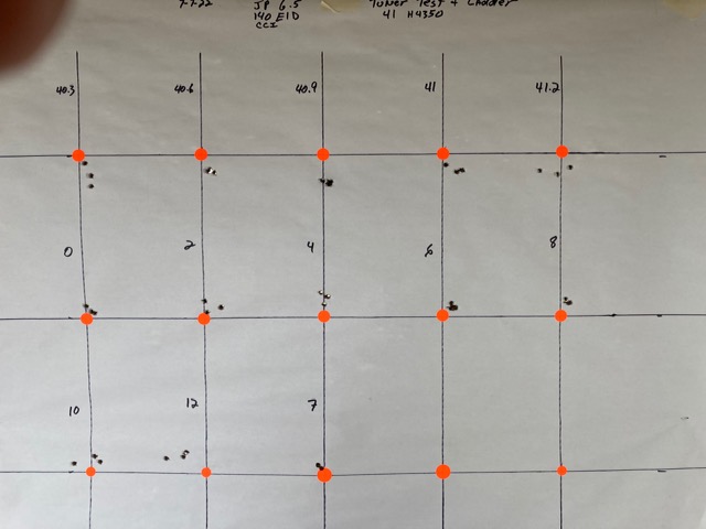

A couple of months ago I bought a JP LRI20 in 6.5 and did the load development for it but I wasn't happy with 3/4 MOA groups and the occasional 1/2 moa group. This being my first AR10 I knew going in that I was limited for seating depth by the magazine, so I decided to try a tuner. I bought an EC tuner/brake and turned a 3/4 moa gun into a 1/4 moa gun. I think a tuner break combination is a perfect fit for the AR platform. Here is a picture of the different tune settings. The top row was a quick powder charge test. As you can see it tuned in between 6-8 settings.

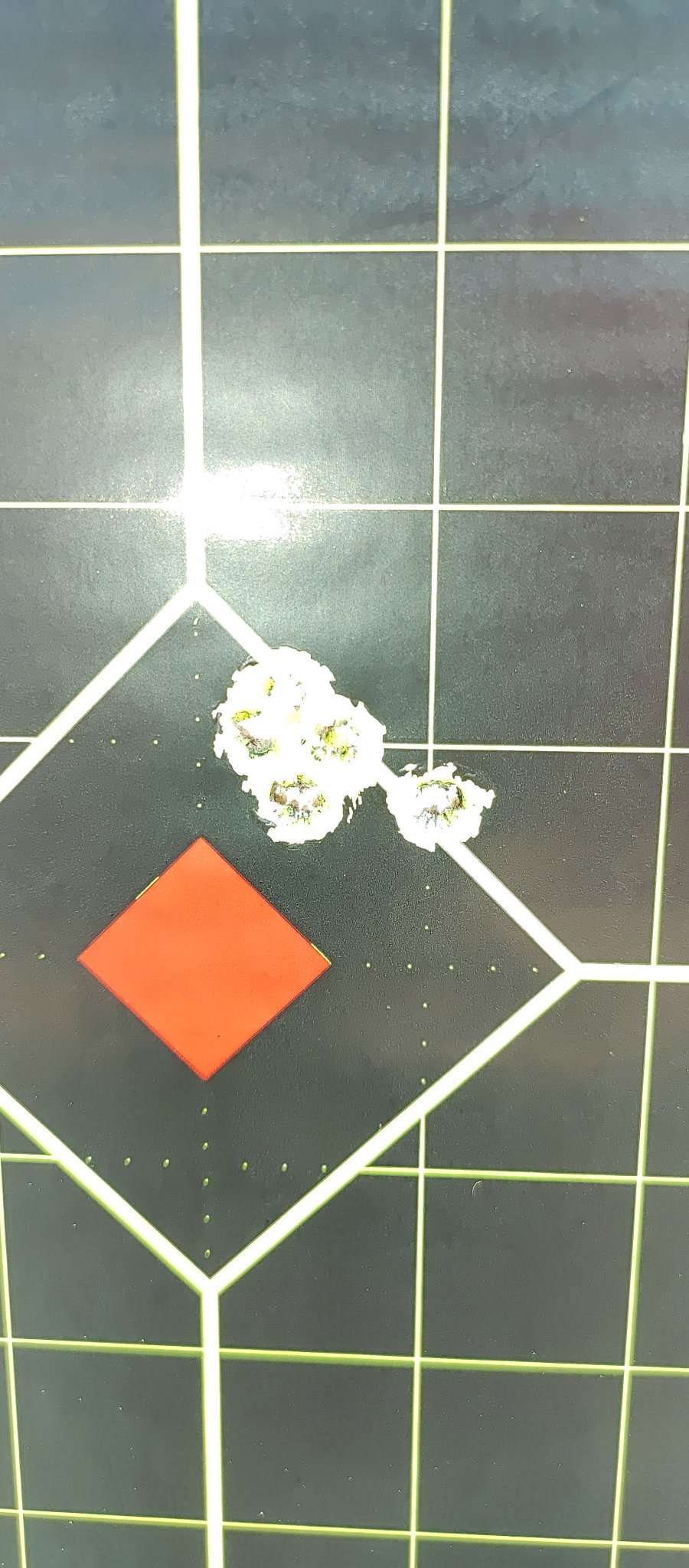

I am having the hardest time getting Staball and 130gr Golden Targets to shoot better than a minute from an Aero build (18" BA barrel). I have tried multiple charges from 42 to 43.5gr and lengths from 2.78 to 2.805. Any thoughts or just one of those combos that doesn't work. I have some Accurate 4350 to try next.
43.6 gr of StaBall 6.5 is shooting a bit better than an inch at 100 yards and velocity is 2585 with 140 gr Barnes match burner. 16” Wilson combat barrel.
Yeah, that might have a bit too warm. Damn shame because it shot well.
I’ll probably rework starting from low 41’s to mid 42’s
