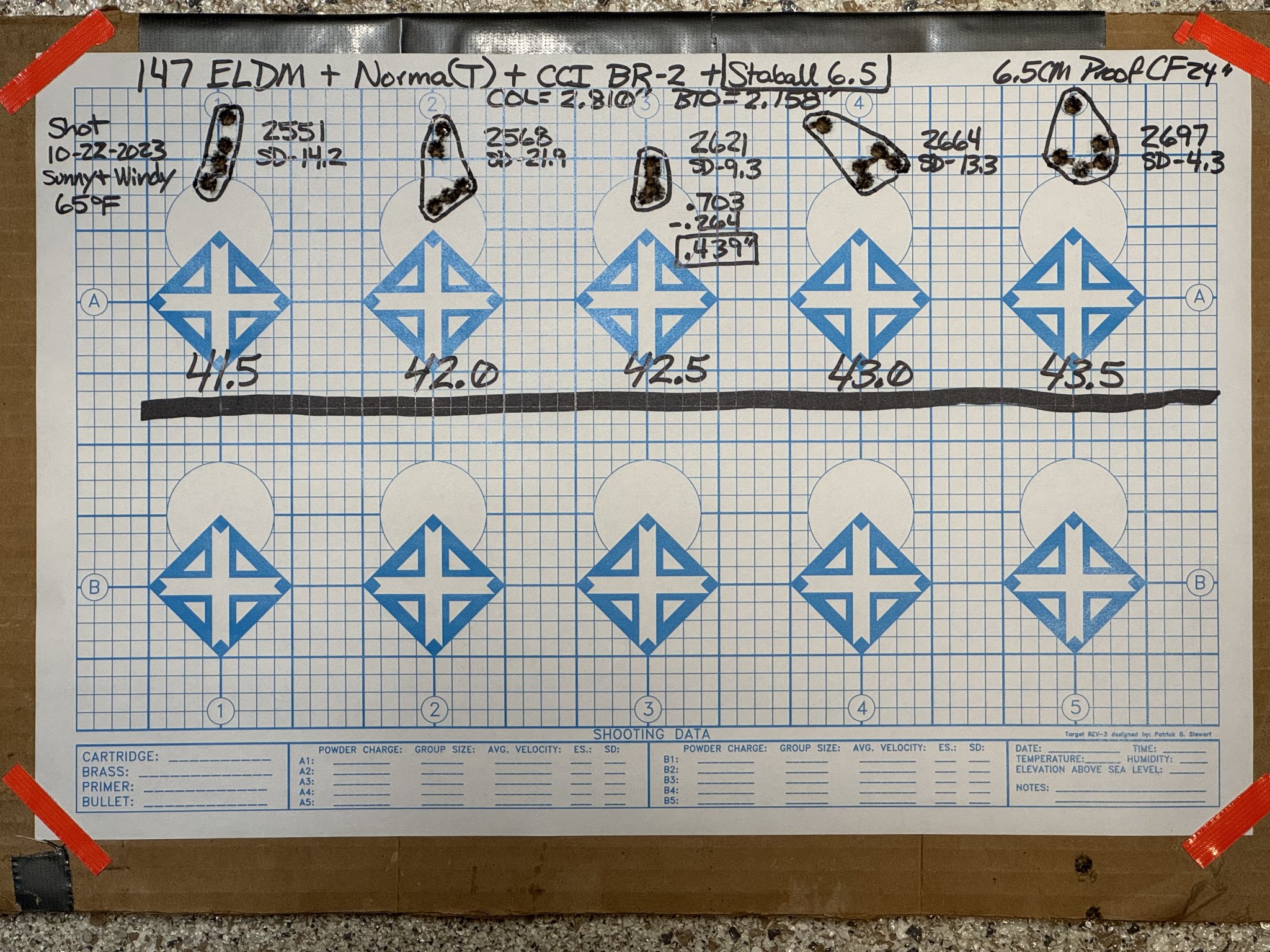

From this past weekend…
Not any real signs of pressure all the way up to the 44 gr. load. I think I'm going to tinker with seating depth at 44 gr. and see if the groups shrink up any.

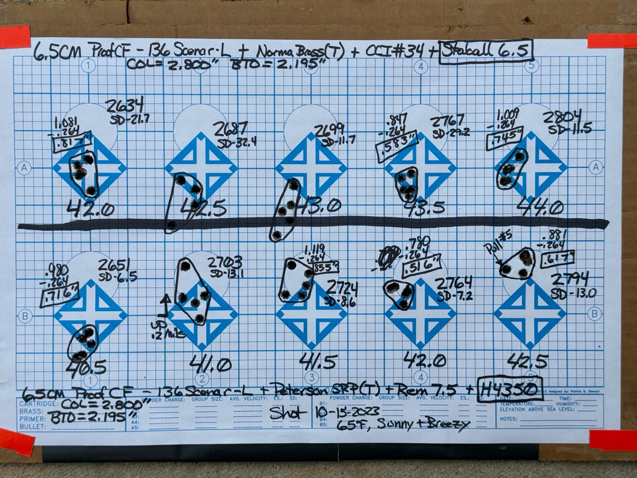

Got two ladders of the Lapua 136 Scenar-L bullets ready to go for my next range trip. Using Staball 6.5 in Norma brass with CCI #34‘s in one ladder and H4350 with Peterson SP brass and REM 7.5‘s in the other!
I’ve got CCI BR, Win LR and the #34’s…
Here are todays results:
Oddly enough, the velocities lined up almost exact with the powder charges I chose!
BTW, these were shot in my 24” Proof 6.5CM Carbon fiber AR barrel. This rifle might be the most accurate I own.
Confirmation on the Lapua Scenar-L 136 in Peterson brass with H4350. 42.0 gr is the ticket
Need to do some more work on those 130 OTM’s, I know they can do better.
Oh yea.. 147 ELDM for your viewing pleasure….

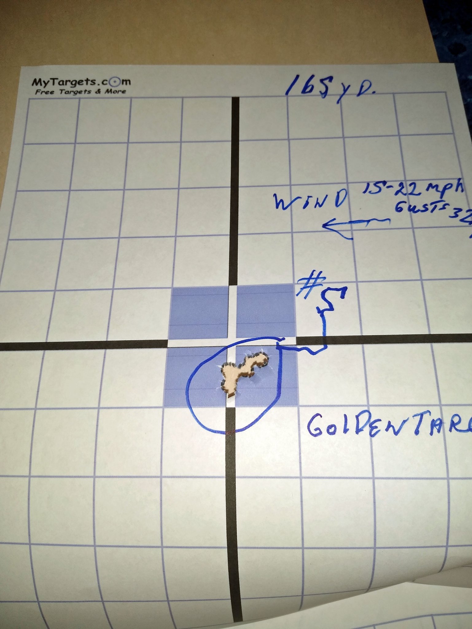

When I recover ,I'll resume running more Golden Target loads past the LR ,so as to get a baseline established .
Then will proceed to reload Norma cases ,as I needed cases to start with , I figured for $23.50 a box of GT Norma cheaper in the long run than purchasing brass. So far happy with accuracy ,just Not function on a few powders I did reload . MY closest Rifle or big bore pistol Target shed is *165 Yd. *,278,*340,*635, 16" and 12" Steel at 1044-1177 . Fyi in case you're wondering what a target shed is ,see photo . Yardages explained ,MY Range is over undulated terrain ,as across the face of a hill side . So there's canyons ,draws washes or Arroyo's traversing the range . Necessary to place Sheds on higher points as canyons are significant in depth thus blind . Gets Breezy around here and as real wind doping as one could imagine . Flying across no less than #6 washes & canyons past 635 Yd. hence NO sheds .
What grain is the GT? I have some Norma factory 6.5prc that's 143gr.
Factory were 143 gr. . I ran 120 gr. bullets as they're match ,after prepping spent cases . I also have 123,129, 130 ,143 and 147 gr. bullets ,as I began purchasing prior to the plandemic ,so as to stockpile provisions ,so too speak .

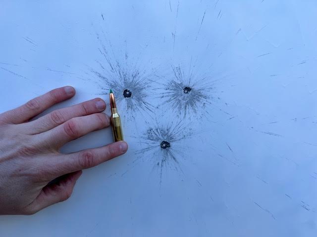

Anyone mess around with Sierra 130 game changers? Going to load some up with either h4350 or staball 6.5.
I have had extremely good luck with them in both bolt and gas rifles. The photo below was at 1160 yards with a 20" proof barrel 6.5cm (gasser). This is running varget, which I know most folks are using other powders. The varget does not always work well with gassers, but for some reason mine loves it. I will say the game changers seem to like too be pushed to the edge in terms of MV, I have shot them in quite a few rifles now and am currently working on a 20" 6.5 PRC bolt rifle.

142gr SMK: 43.0gr 2571fps SD 13 (29 shot string) .5 MOA
130gr ELDM: 44.5gr 2824fps SD 6.6 (10 shots)
.62 MOA
H4350
142gr SMK: 41.3gr 552 SD 4.6 (10 shot) .6 MOA
130gr SMK: 42.8gr 2702 FPS SD 4.4 (10 shot) .68 MOA
123gr SMK: 45.2gr 2866 fps SD 4.0 (10 shot) .45 MOA
140 Berger Hybrid Target: 40.5gr (2500fps SD 3.5 (10 shot) .56 MOA
130 Berger AR Hybrid: 42.2gr 2650fps SD 8 (2.675 COAL) .58 MOA
120 ELDM: 43.1 2757 fps SD 8.8 (10 shot) .45 MOA group
Couldn’t get my 135 A Tips to shoot well out of the AR10, if anyone has any loads for them I’d love to try them again (they look cool). Staball is not consistent velocity wise if it’s above 100 or it has been sitting in the sun on a hot (above 90 degree) day. I had some crazy velocity jumps with my ball powders (100-200 degrees) shooting last weekend and basically ruined my 6ARC brass doing it. So now I know to bump the loads down by about .5-1 grain with staball if I’m gonna shoot it in hot weather. Still works great accuracy wise but I see why H4350 is the king of consistency. Also I didn’t anneal until the 7th firing and I noticed a return to small groups where almost all bullets are touching with a random flier or two. My criterion has been rode hard and put away wet with almost 3k rounds down the tube so I suspect it’ll be opening up soon. Also it’s hard as hell to shoot good groups prone in Texas during the summer with all the insects trying to eat you, mirage, the sun beating down, etc. as my range is just outside no buildings. But it is for sure a shooter.
