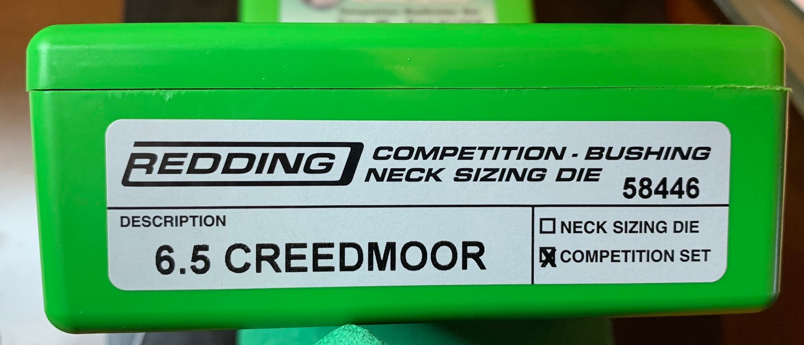

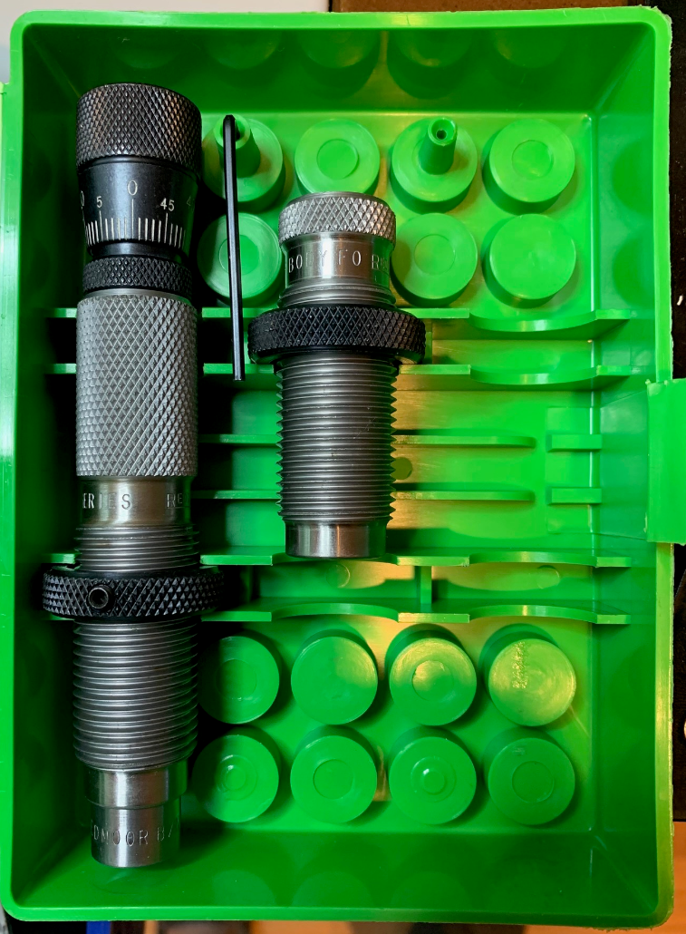

I have a "Used a Couple of Times" Redding Competition set ... minus the Bullet Seating Die ... but the Micrometer Neck-Sizer and Body-Die are available. Photos below. If interested, PM me with an offer. They're just accumulating dust in my "Not Using" bin. You'd still need to find a Seating Die, but at least you'd be 2/3 there

careful you can get banned for this lowlight put the warning out that any sale outside of the px will get you banned. Im not trying to start shit I just didn't know if you where aware.

Yup ... exactly what I figured out "after" I got this full set. Hence the Neck and Body dies just laying there in my "Shouldn't have bought it" bin.
Well they're not really a waste. You can still make good ammunition with those dies. Seating the bullet straight into the case is a high priority, and you have that covered if you have the micrometer seating die with the sleeve.
Yeah, but I wanted to cut a step so I got the Redding Type-S Full Body Sizing Die ... so the Neck and Body size dies in this set are useless to me. Basically ... a door-stop.
