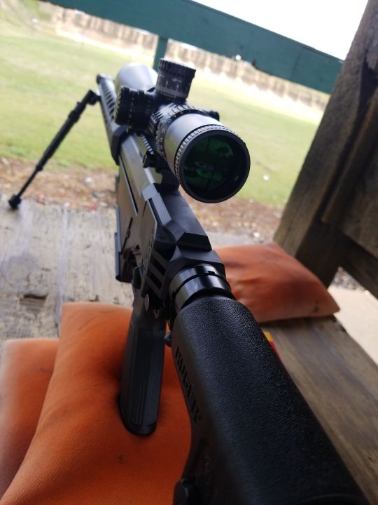

.338 Lapua is a funny animal; I shoot mine out of a Cadex Kraken (multi caliber) which weighs somewhere in between a shitload and a fuck ton. Recoil. Near zero. If you’re planning to reload, the Lapua is fun to shoot and fun to reload.
P.s. I also shoot 6.5CM, .308 Winchester and .300 Win Mag out of it, I honestly see no difference in felt recoil between all those calibers.

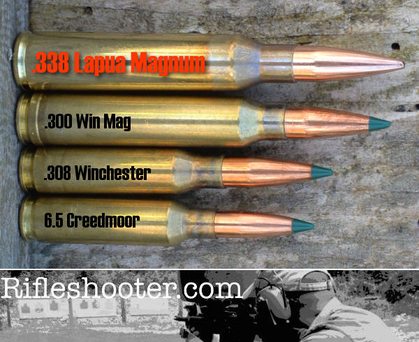

6.5 vs 338 is like comparing a baseball or a softball being pitched by Verlander at your shoulder at the same speed. Or maybe apple vs watermelon...
Either way, the 6.5 will do what your asking for cheaper and more enjoyable.

6.5 CM is roughly $1 a round.
338 LM is roughly $5 a round.
Sig makes a piston operated 6.5 CM.
Recoil, the 6.5 CM is light. The 338 hits hard depending on the weight of the rifle. Being an AR, may not be enjoyable.
Just google 6.5CM vs 338LM and look at images. All that powder and heavier round translates to recoil.

I had an rpr in 6.5. Now have one in 338. Huge difference in recoil even with a heavy rifle.
338 is very expensive to feed. S&B 250 match gives me sub .5 moa at only $3 a shot. $7+ a round are out there. I reload, but it's still a buck plus and a lot of testing.

6.5 Creed $1.20 each or $24/20
308 win $1.15 each or $22.89/20
300 win mag $1.55 each or $31/20
338 lapua $3.47 each or $70/20
Costs of gun parts for upgrading go up greatly for bigger items.
Barrel cost for rpr barrels from LRI (quick search) 675 for 6.5 Creed. 750 for 338 lapua.
