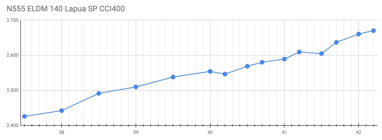

Making some ladders with a 26" Proof Carbon 1:7.5T. I'm somewhat surprised by the low speeds. The barrel is brand new (these are my first 75 shots). Speeds are measured with magnetospeed v3. Unfortunately some speeds have not been picked up (so that's why some have no SD data)
VV N555, Lapua SP, CCI400, 5 shot per load. No signs of pressure. Any suggestions on how to proceed?

Keep proceeding up. That’s exactly what I did I kept going up to 44.9 grain with only moderately flat primers and some cratering but no heavy bolt lift. That might not even be the true max but with the heavy cratering I’m calling it there.
And I’m just regurgitating info here but everyone says your barrel will speed up a little bit around the 200 mark. I personally also noticed a good bump in velocity, 50+ feet per second, by just moving to magnum primers. CCI 450s and even a bit more with the Tula.

Keep shooting it and keep adding charge until you see pressure signs. Every rifles different. It’ll definitely pick up some more speed over the next 75-100rds. All of this though is subjective to what your intentions are with the rifle. Your only 80-100fps from the optimum speed. Which honestly isn’t much in terms of performance. Especially 600y and in. Your elevation will be within a tenth or two of that higher velocity. Windage wise it won’t be much either. Your brass will last longer not being on the cutting edge of pressure. Accuracy over speed in my opinion will net more impacts over time. Either way you go I’d expect it to pick up some speed on its own with rd count.

I forgot to mention that I'm also getting visible muzzle flash that can be seen in my Terminator T4 brake. Something I never had (or noticed in this this degree) with my 24" .308 loading vvN140

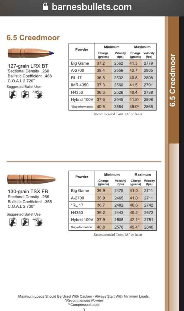

Questions: Any one ever try Hodgdon superformance powder? I have some and there's reloading data for it. I normally just use H4350. What bullet weights and charge amounts? Also, I see Varget data for 6.5CM, anyone use Varget? Thanks in advance.

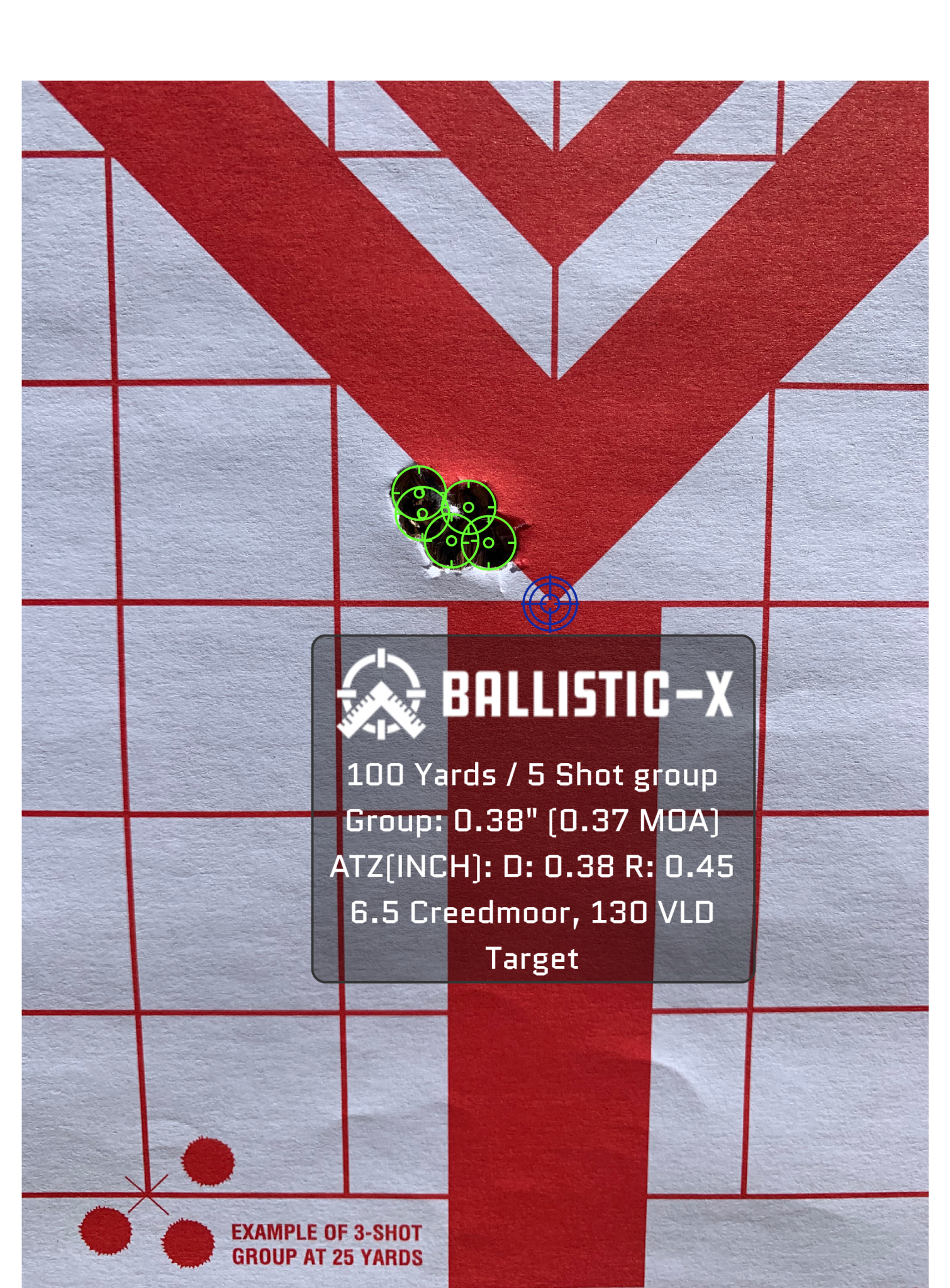

6.5 Creed load
26” MPA barrel, 1:8
Berger 130 VLD Target
35.1 gr H4895
CCI BR-2
Hornady brass
COAL 2.78
2670 FPS
View attachment 7519551View attachment 7519552
Two very nice groups sir!
Of course your muzzle velocity is quite slow for a 130 gn projectile from a 26” barrel, but if this is your widest node, be happy that your barrel life will be far higher than those that push their 130s to 2850 fps. 😊 [Like me!]
You will not lose that much in wind drift below 500 yards. Good practice load. For a 1,000 yard load, you will probably want to go with a heavier longer bullet with a higher BC.
Have used Superformance to develop a deer hunting load using the 127 gn Barnes LRX bullet in both 6.5 CM. Also made a very nice 180 gn hunting round for my 30-06 that i used to take an aoudad in the Texas Hill Country at 150 yards. Hit the top of the heart and penetrated both lungs, with a good exit wound. Muzzle velocity of about 2730 fps. The aoudad ran 15 yards and toppled over. Tough critters.
The extra 100-150 fps in speed helps to open up these copper bullets, giving devastating terminal performance below 350-400 yards. Typical hunting distances in Texas are 50-250 yards, but it is reassuring to know you can take a 350 yard shot when needed.
The Barnes web site list load data for Superformance. Of course start low and work your way up. Pressure shows up quite suddenly with these copper bullets.
Btw: Have used Superformance once before to develop target ammo for an accurate Savage 12 with a very long 30” Shilen (replacement) barrel with a fast 7.0 twist. H4350 gave disappointing results: White smoke, no red flash at all, and speed topped out at 2790 or so, so clearly the powder was fully burned out by the time the bullet left the muzzle. Switched to Superformance and it managed to push a 150 SMK (which requires a 7.5 twist) to well over 2,900 fps. Clearly it could exploit the long barrel and extra bullet dwell time. The load did not group that well so i stopped using Superformance in that barrel.
I only use it for hunting ammo now, where the extra 100-150 fps speed helps to extend the range where the bullet will mushroom properly. I also got the impression it was rather temperature sensitive, but others might know better.
Yes, I use it in my 147g ELD-M stuff now. I'm getting around 1550FPS at 1000 yards, which is about 125 fps faster than the factory ammo with an average MOA of low .4's to low mid .5's!

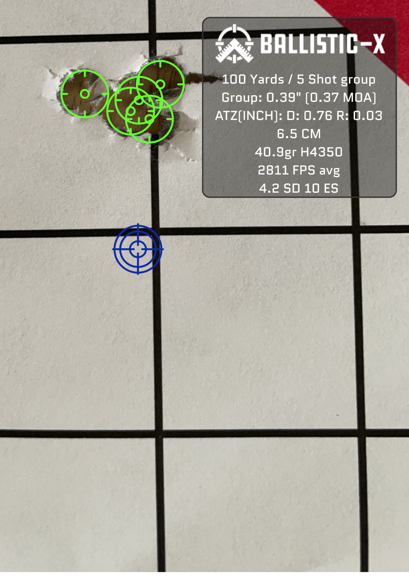

Is anyone else getting these speeds? I’m getting a slight ejector mark but nothing else. Worried that maybe they’re going to fast and should back down some.

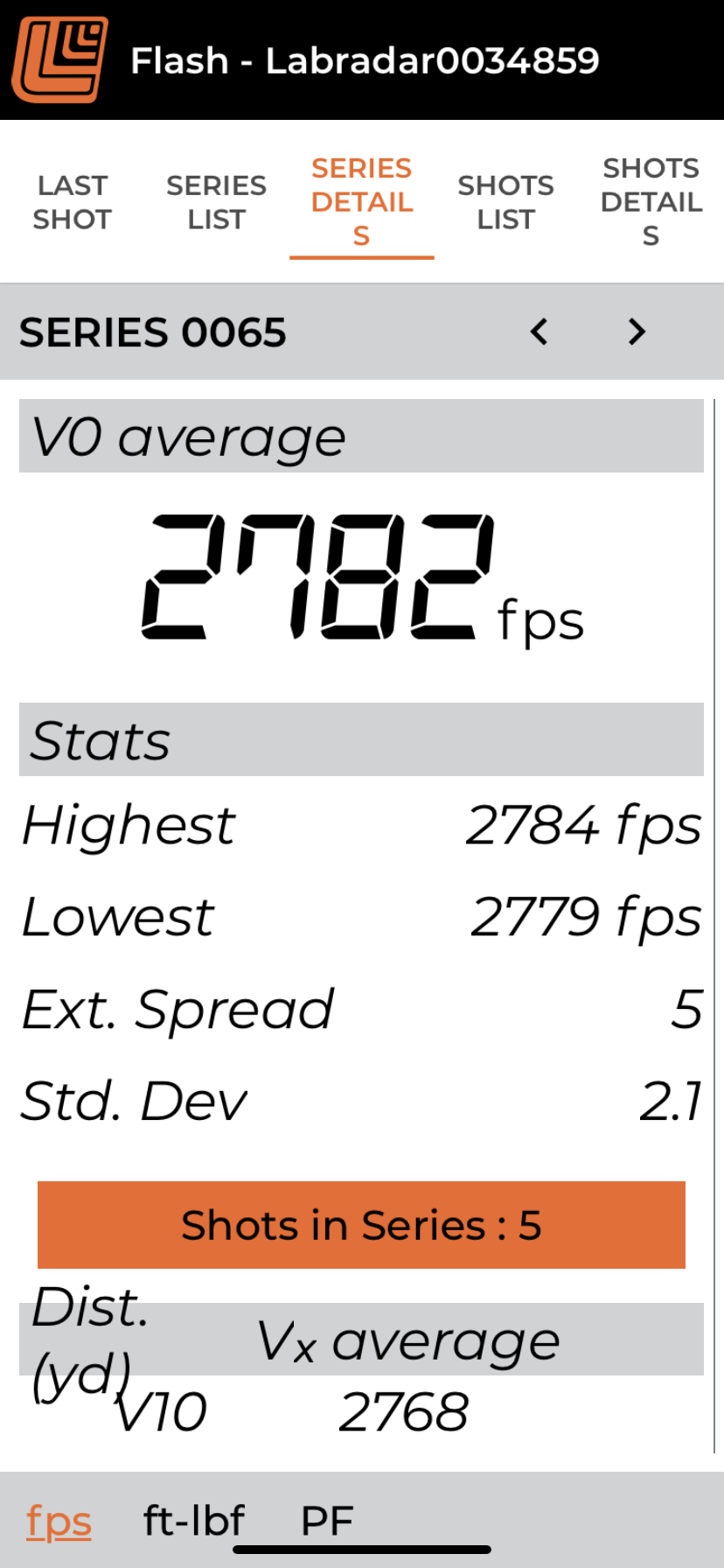

I think that’s pretty fast...I definitely saw pressure signs and heavy bolt lift over ~2820 but I’ve read where plenty of people in this forum run above that with no pressure signs.
Here’s the node I settled in at:
26” DesertTech
42.2gr H4350
140ELDM
Lapua brass
Remington 7 1/2
2780
26” DesertTech
42.2gr H4350
140ELDM
Lapua brass
Remington 7 1/2
2780

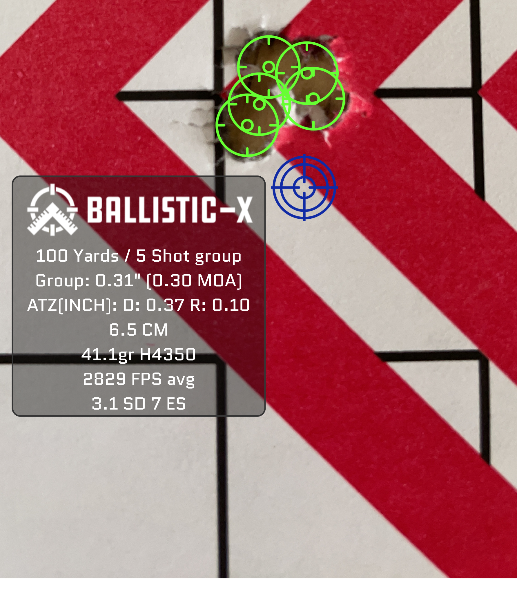

My barrel seems to be really fast. Testing with a Magnetospeed V3. I’m going to test at 41.0gr tomorrow and see how that goes. Seems like it could be on the edge of a velocity node but in the middle of an accuracy node, so unsure about it but going to test it anyways.
Reactions: Glassaholic

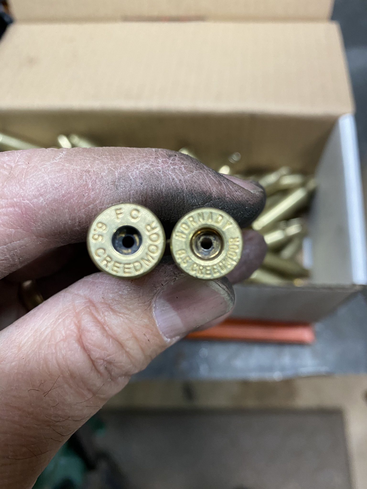

the other issue I have found in my 6.5 Creedmoor brass is federal appears to be using small rifle primers. Winchester and Hornady use large rifle primers.
Thank you for the response.
In better times, you could choose one and only work up loads for that size. At this point, it's probably good to have options for whatever size primers you can find.

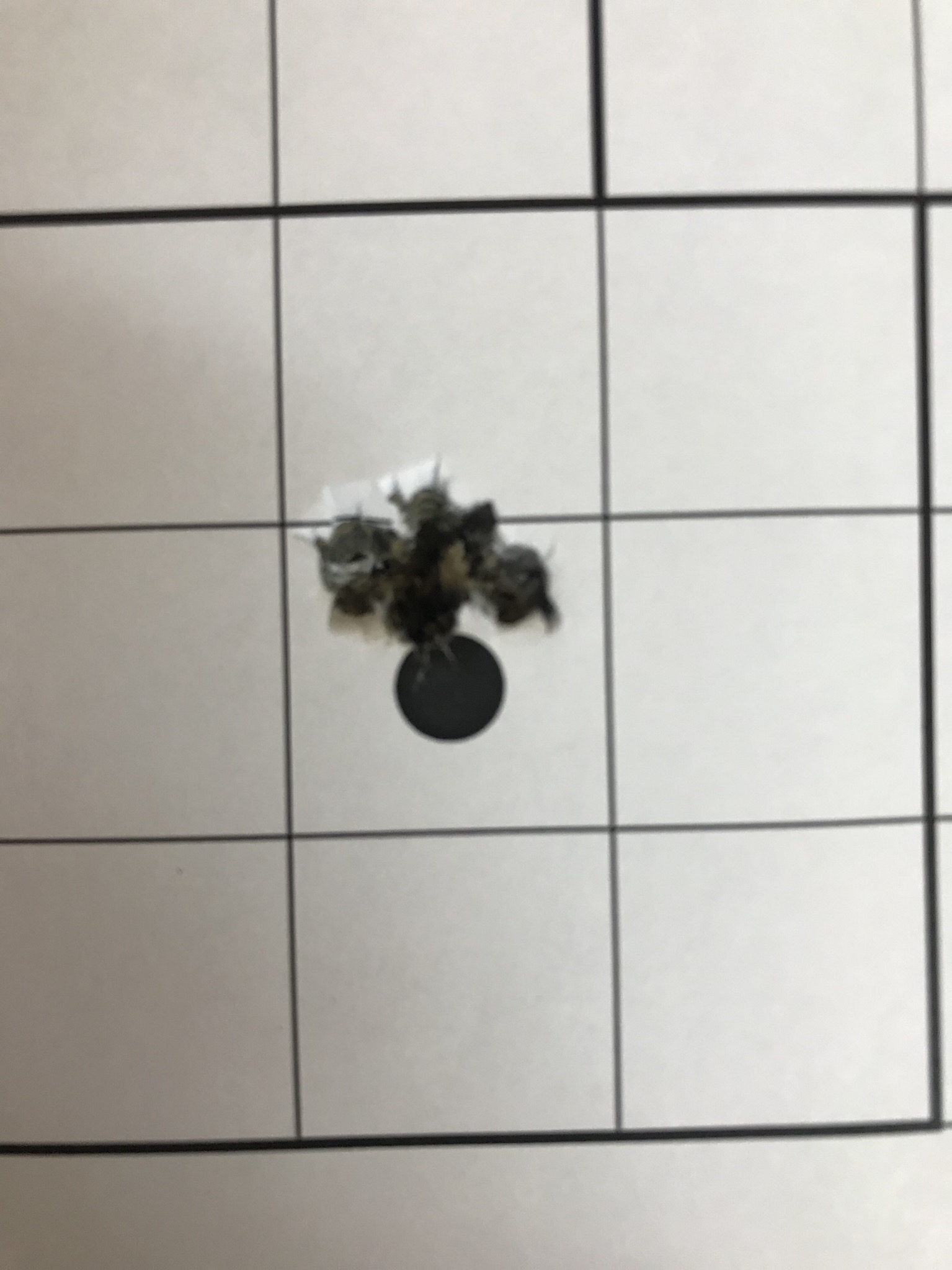

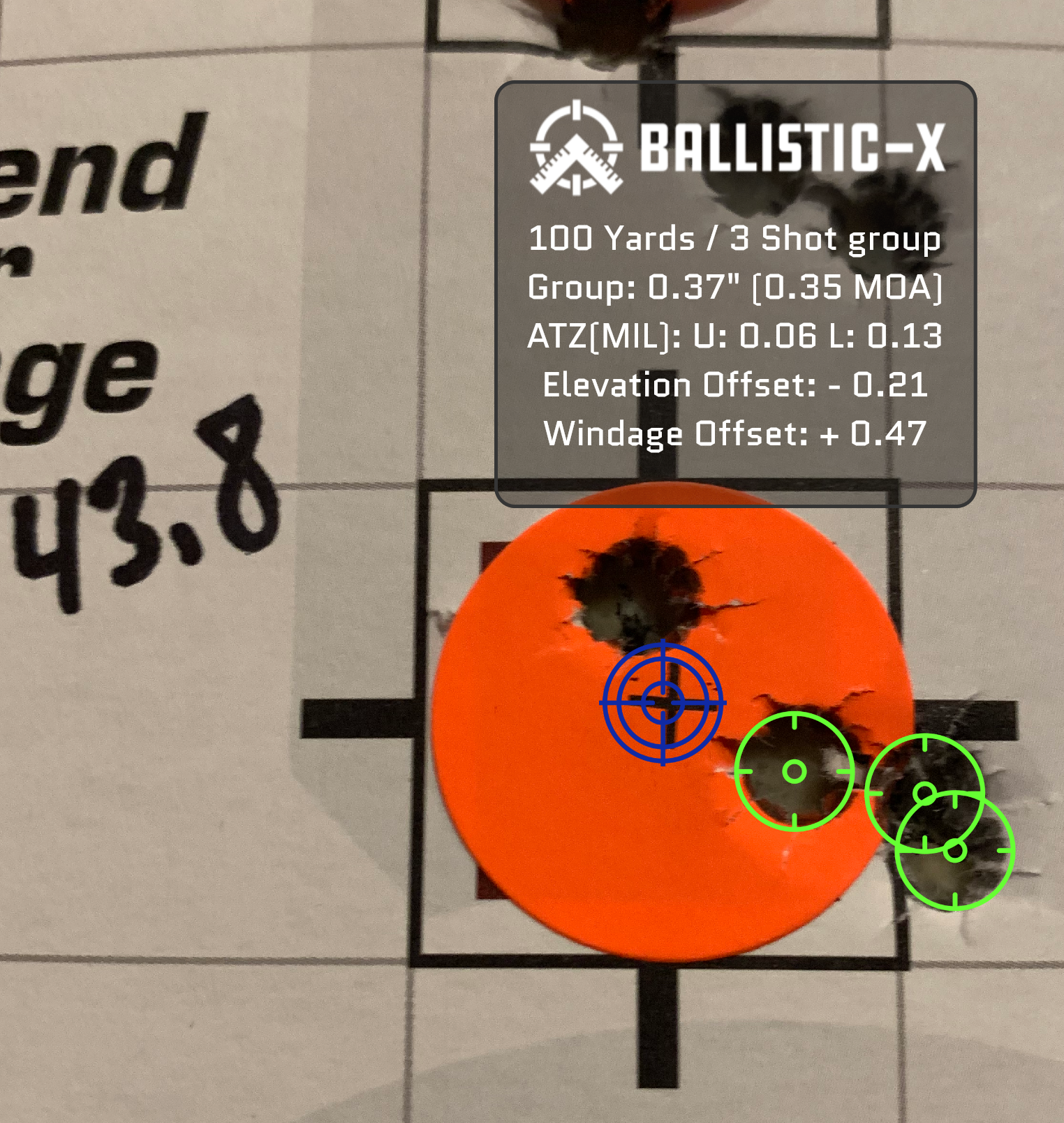

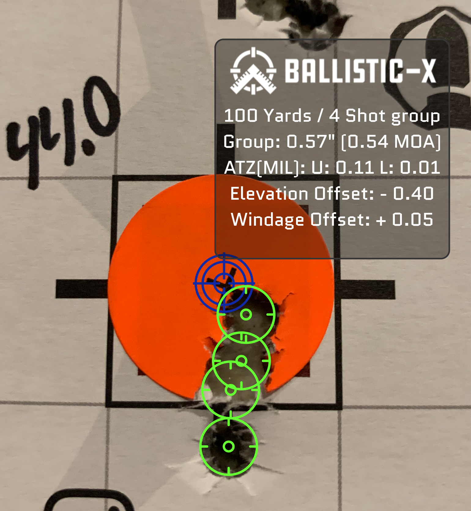

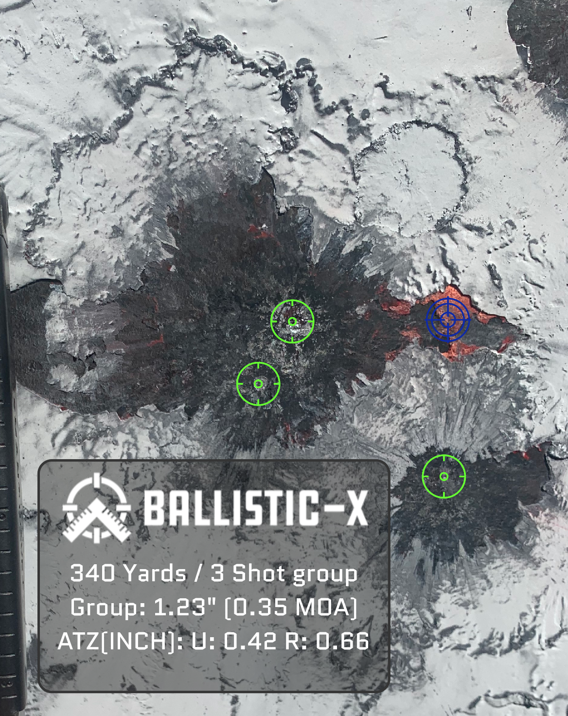

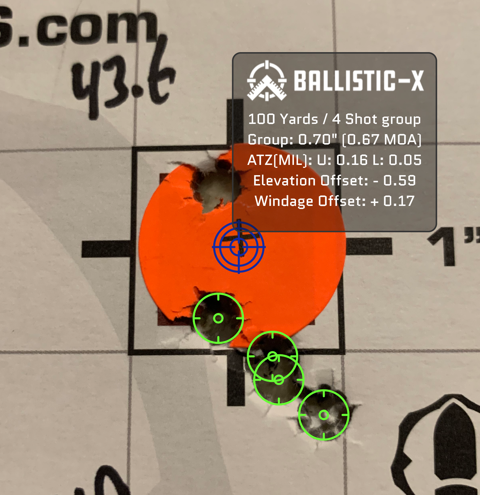

Tikka T3x CTR 6.5 creedmoor
Lapua SRP 2x fired brass
Fed205mAR
Berger 130gr AR hybrids
VV N555
CBTO 2.262 COAl 2.880ish
43.4 avg 2596 ES 13 s-d 5.2 first shot had lower pressure case fouling group 1 moa
43.6 avg 2624 ES 8 s-d 3.4 see group below
43.8 avg 2643 ES 8 s-d 4 see group below
44.0 avg 2658 ES 10 s-d 5.4 see group below
44.2 was a 3 shot group slightly over sub moa and something happened with my magneto. Also there may have been the slightest ejector swipe but primer looked fine no heavy bolt lift. Otherwise NO pressure signs. I pulled a shot at 43.6 and 43.8 so I would like to try those pods again and maybe a lid at 43.7

I just read 13 pages of loads and found very few shooters using something other than H4350.
Can those of you who are not loading with h4350, rl16, or rl26 post your loads? I am trying to see which alternate powders people are using with success.
Thanks...
Reactions: tyfoon
Thanks...
Shooters World Long Rifle 41.5gn, 140gn eldm/bthp Peterson SRP brass. SD/ES 15ish/30ish over a few hundred.
Reactions: stello1001
Thanks...
Have used H4350, RL-17, RL-16, Superformance, IMR4350, and Varget. Even surplus WC852.
They all have pros and cons:
1) IMR4350 performed almost identical to H4350 but needed 0.3-0.4 gn more for the batch i was using. Shot the 120s and 140s very well (did not try the 130s). Same group size. Slightly temp sensitive, but not terrible.
2) Superformance shot 120s, 130s, 140s and 150 well at very good speed (around 120 fps faster) but the loads are compressed (i used an ultrasonic toothbrush to settle the powder before seating, still crunchy). Temp sensitive.
3) RL-17 was fast and accurate but very temp sensitive. Need a winter and summer load. About 150 fps more speed. Good groups. Some concern that it eats barrels faster than other powders. Difficult to stay on the flat part of the speed vs powder charge graph.
4) RL-16 was remarkably accurate in my MPA rifle, gave adequate to good speed and shot tiny groups of around 0.10” at 100 with 135 gn weight sorted Atips. Amazing accuracy. Cannot find any!
5) Varget was accurate but speed was about 100 fps lower than H4350.
6) Surplus WC852 surprised me: It gave 1” groups at 400 while fire forming brass. Remarkably accurate with cheap Hornady 140 gn BTHP bullets. It was very cheap, but it is hard to find this powder now. No published load data. I loaded low and never looked for a max load, around 2500 fps with 140s. The seller wrote on the label “As IMR4831” so i loaded 1.0 grain above the starting data for this powder and it worked just fine. Will likely never get beyond 2600 fps as this powder was meant for military 30-06 machine guns, and these batches were apparently rejected for being too slow.
