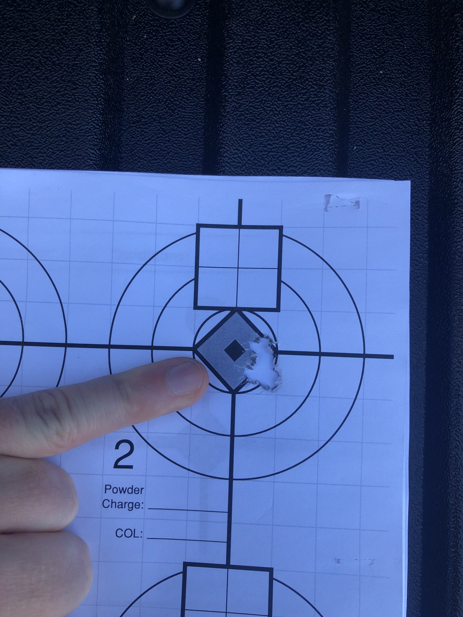

Alpha brass
CCI200
140g ELD
H4350
.060” jump
2.248” BTO
Initial work up with Alpha brass, cold shooter and cold bore 1st group. Nothing shot over .5”
I know only 3 rd groups but this many 3 rd groups without a significant flyer is good enough indication for me. Velocity at 40.2g was right at 2730

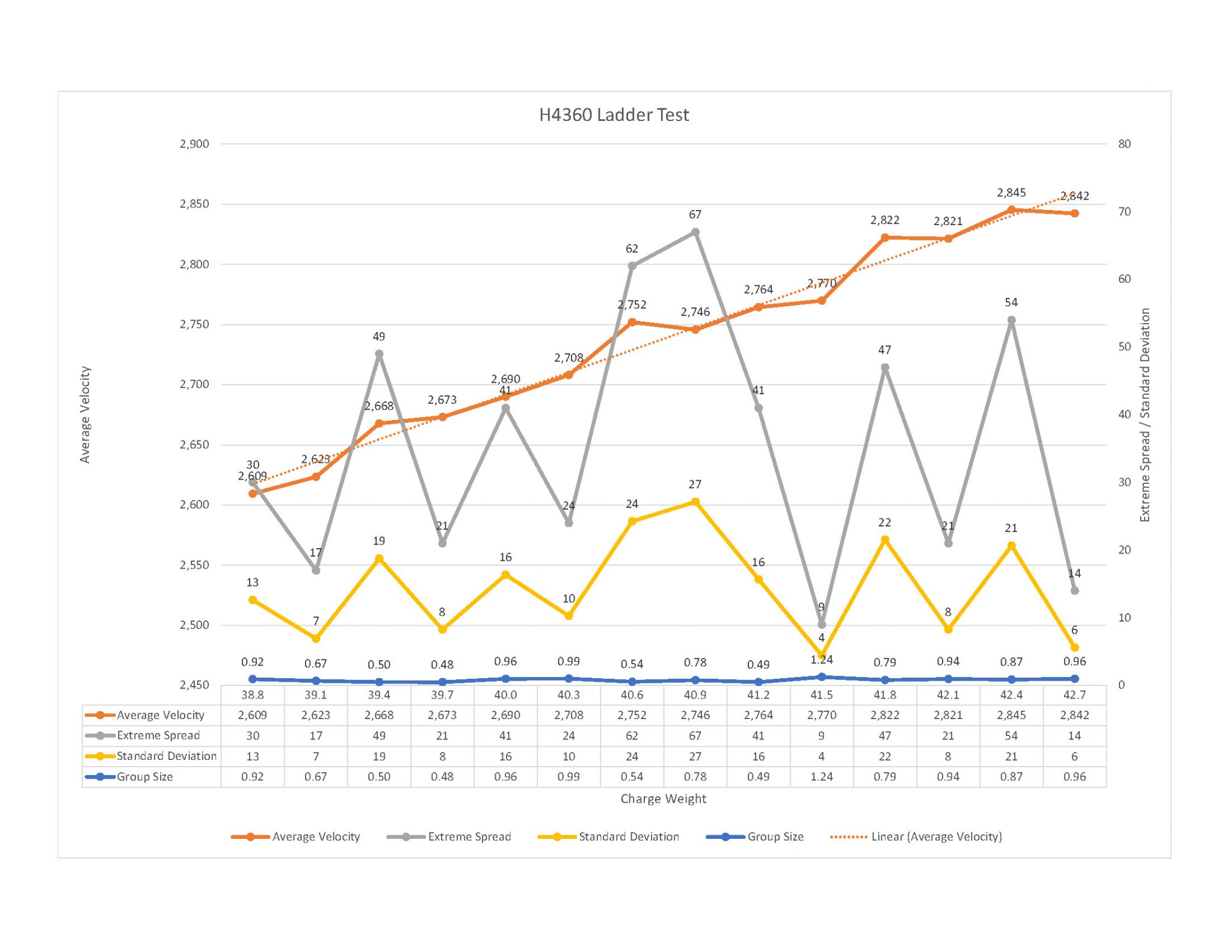

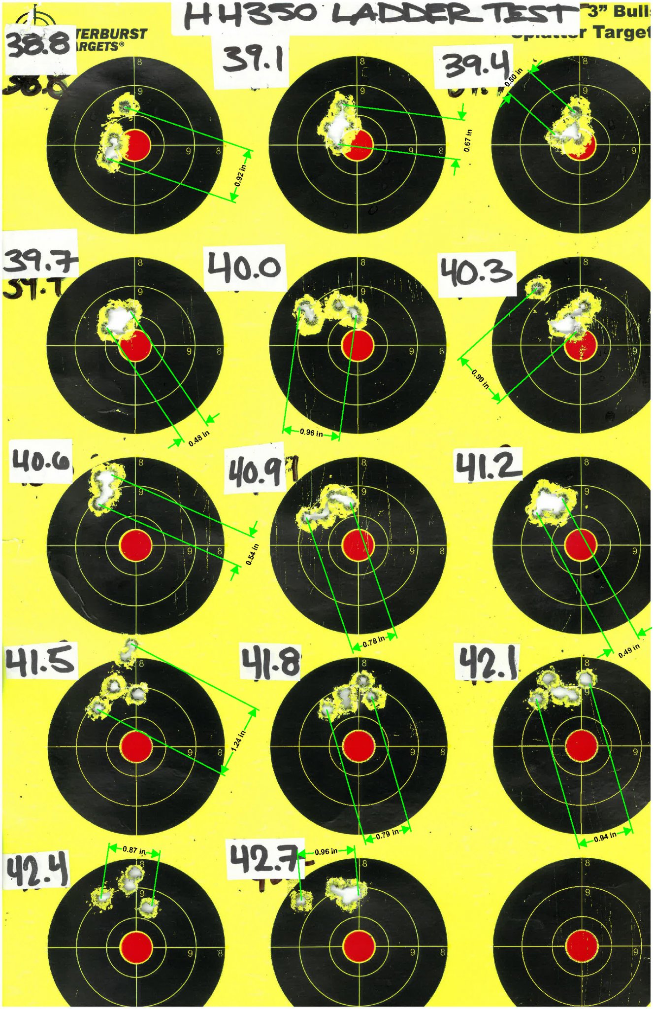

I am relatively new to hand loading and seeking some advice on choosing a load from my test data. The application is PRS-style shooting, 400-1,000 yards. I did a 70 round test (14 5-shot groups, 0.3 grain increments from 38.8 to 42.7).
Here is my rifle/environmental/load data:

I was thinking either 41.2 grains based on what I have read, but any advice would be appreciated.
Reactions: BigBlastin300win
Your 39.7 groups is the best! I'd load up several more groups of it and the 41.2 to see if they repeat the same results. Others may suggest increasing and decrease your charge by 1g on either side of those weights to see if you can further refine your groups.
Reading the graph 41.0g -41.3 looks good. Relatively flat. Velocity is right in a good zone at 2750-2765. With the groups it's important to focus on the amount of vertical you have and relative poi between them. The groups carry a similar poi @10-11 o'clock position. There certainly could be some you in there as well with the lateral spread. I'd load up 41.0-41.4 each tenth for five rds and see what that tells you, then refine the group on seating depth.
The low node looks good from 39.1-39.7 but it's a touch slow. Just my opinion. Hope it helps
Reactions: NamibHunter
Thank you. Yes that does help.

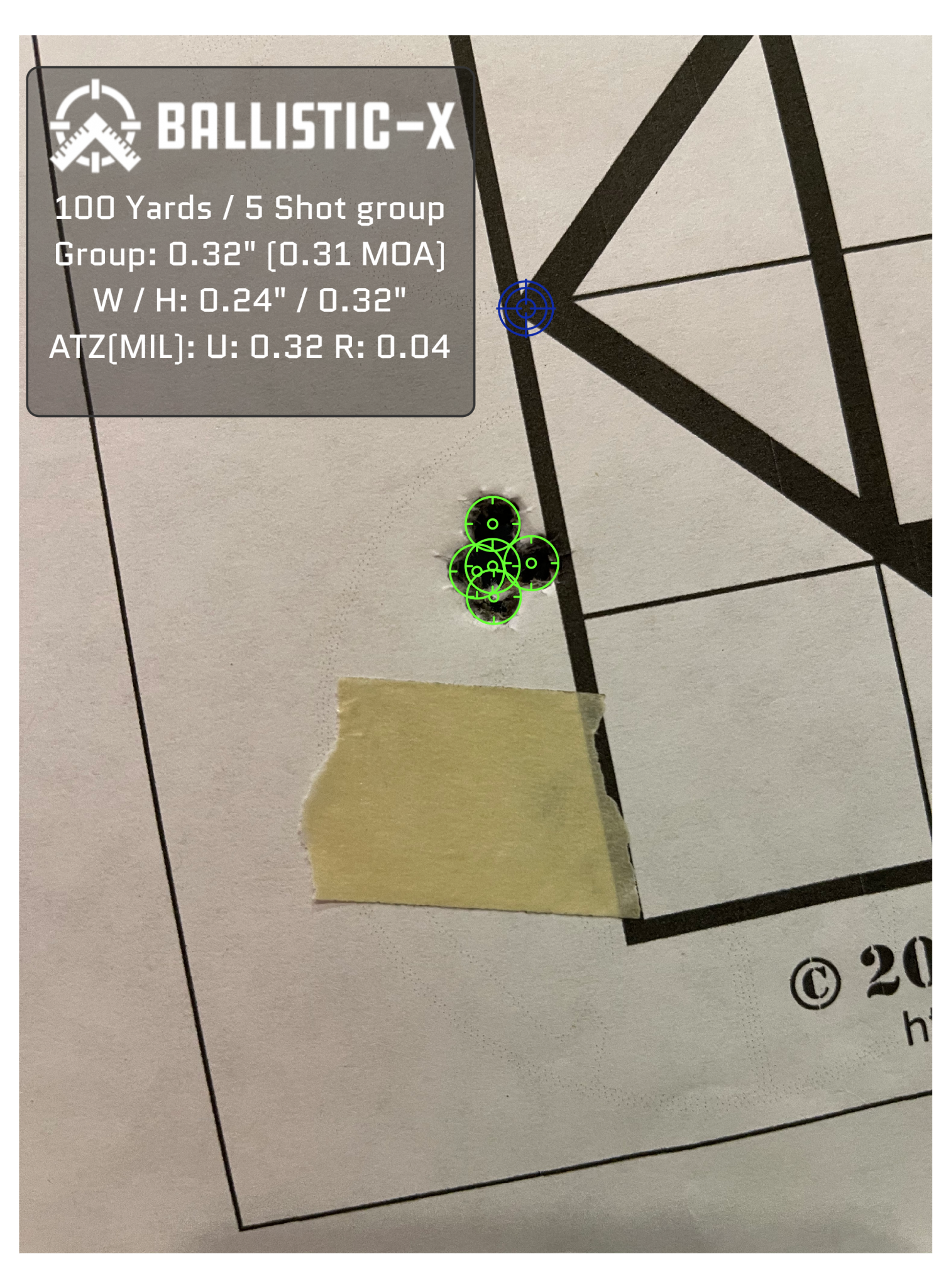

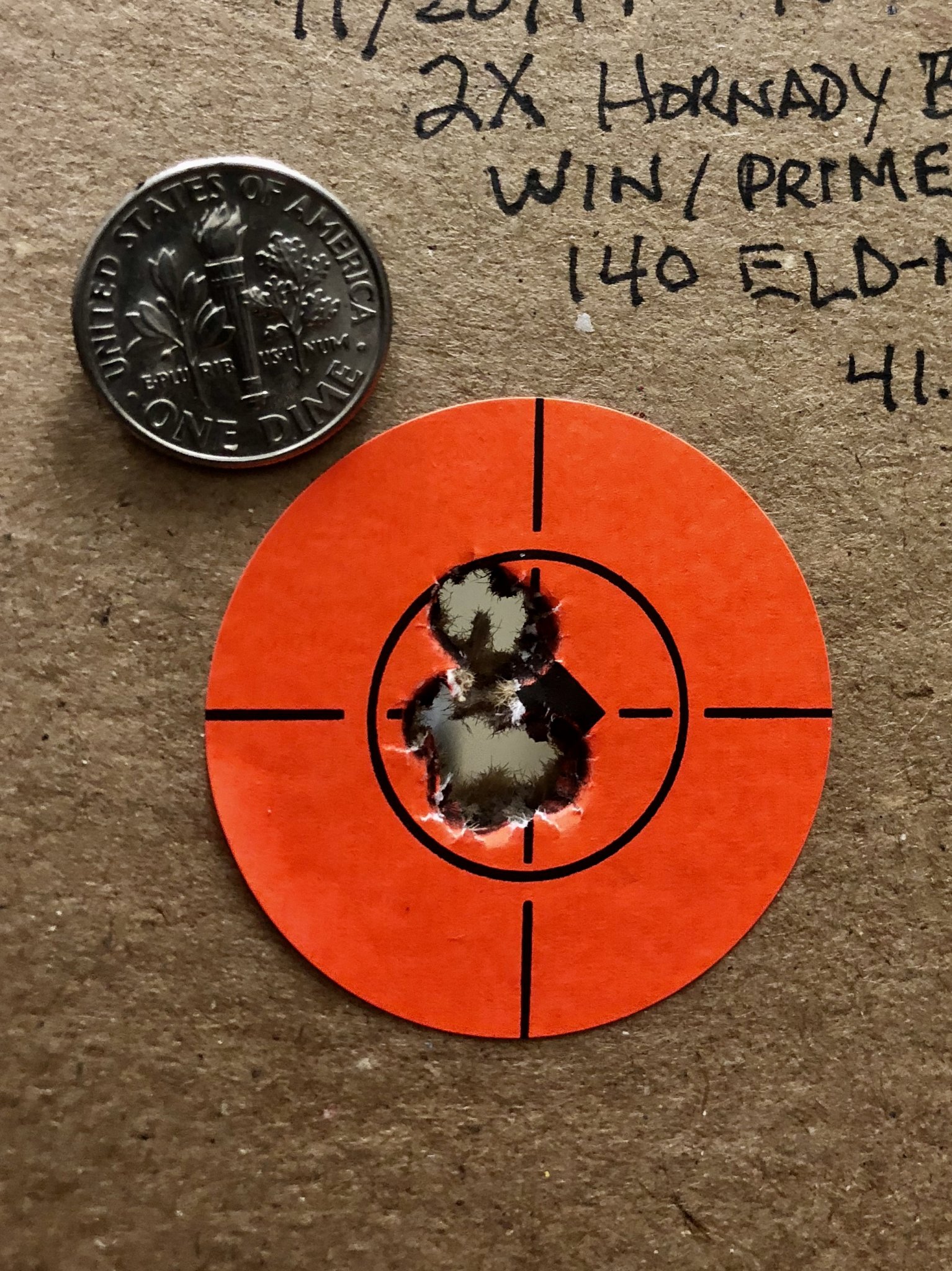

I don’t neck turn or weight sort bullets or brass. All rounds are seating within .001-.002” of each other and I consistently get .3-.4” groups. Chargemaster lite to powder and Redding non bushing fl sizer and micrometer seater.🤷🏼‍♂️
Here’s a five rd group for example. .364”
I get better sd’s and es with my alpha brass but this group and many others are with my hornady brass. It shoots well and is repeatable.
