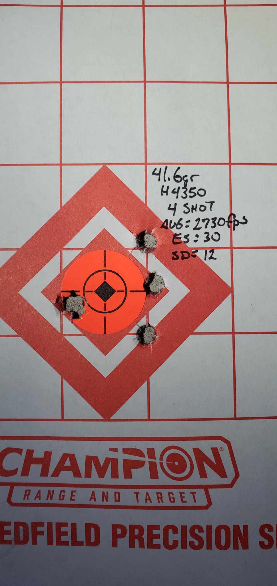

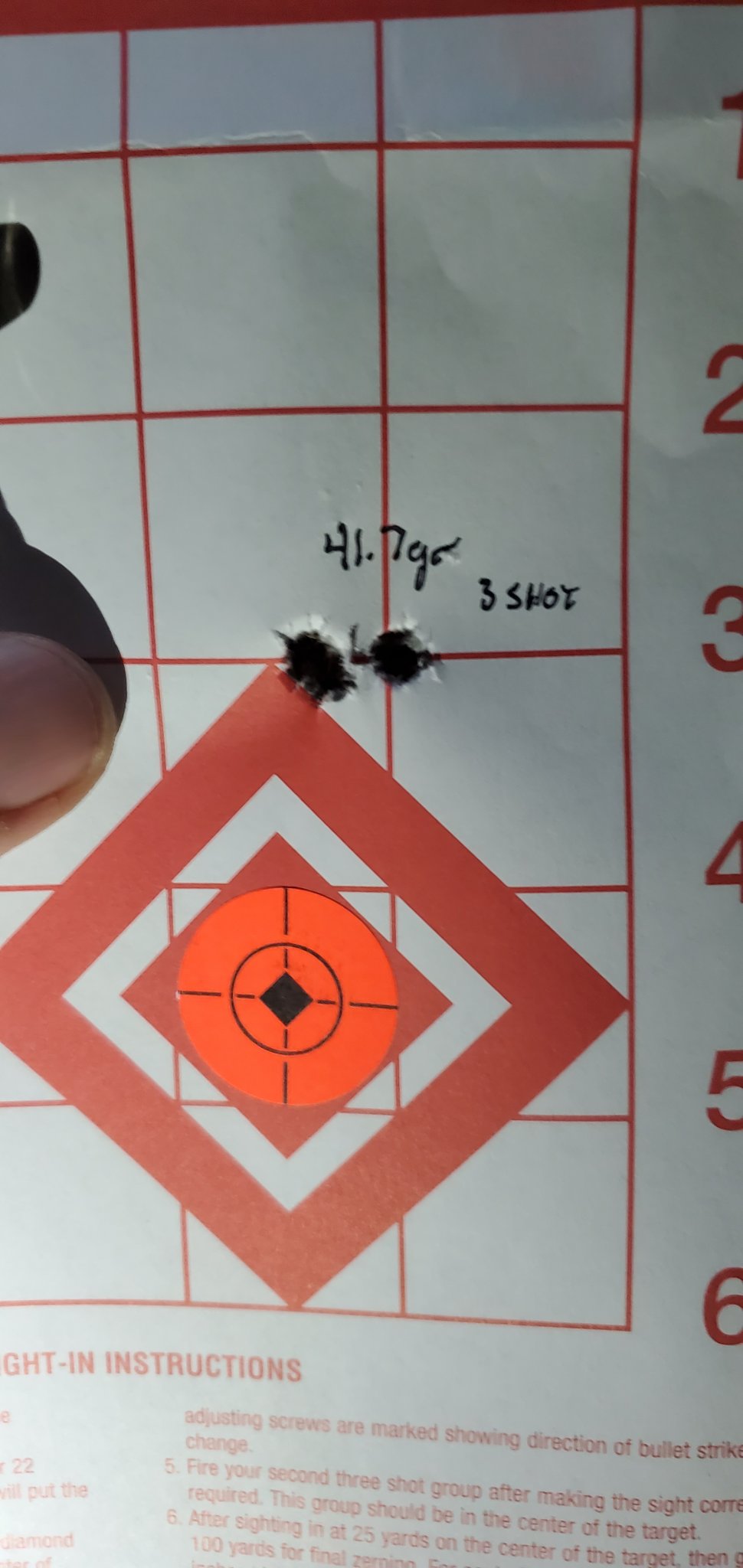

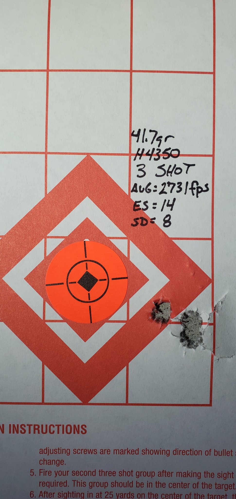

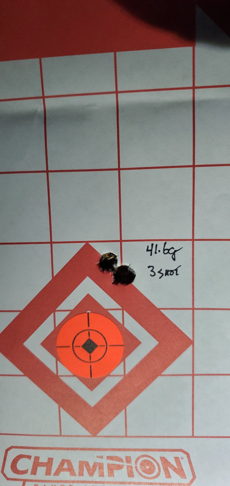

Need to find a good load for my 6.5 CM. The data is;
26" Krieger Barrel
Hornady Brass
Berger 140 Hybrid
H4350 Powder
Any suggestions? I understand the COAL is 2.800, and I will probably start at 40 and work up at .3 increments.
Most people converge on 41.3 to 41.6 gn. Unless your chamber is exceptionally tight or sloppy.

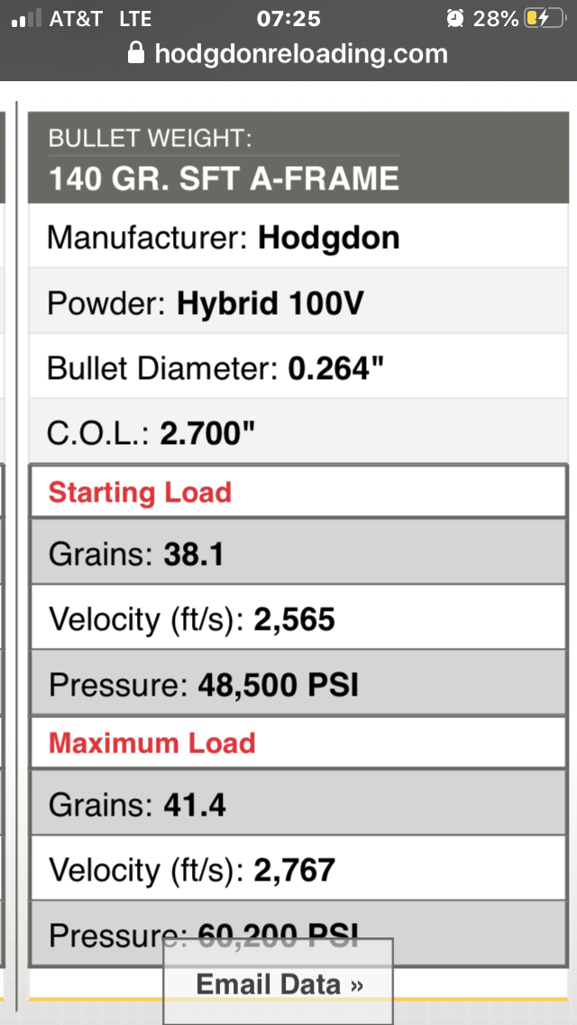

Hybrid 100V is in stock and cheaper than everything else where I go. Anybody have recent numbers on that? 140ELD's. 8T. 27" bart. The primers I have are winchester large magnum. That gonna hurt anything?
Pretty sure the new Berger LRP brass is standard flash hole size. Will check.
I tested one box of the 156 gn EOL hunting round, which is loaded in LRP brass, and that heavy bullet worked superbly well on large feral hogs.... And they are tough critters, also shot small groups on steel.
I use Hybrid in my RPR's in 6.5 Creedmoor with 140g ELD's. It works good and maintains tight groups out to 1000 yards, usually less than .5 MOA unless it's very windy. I also load with Superformance in 140g and 147g because it gives faster FPS all across the board while still maintaining accuracy. My reasoning is less bullet drop, thus less dial ups at longer ranges. But use what's available to you. Hybrid is a good power for the Creedmoor.Hybrid 100V is in stock and cheaper than everything else where I go. Anybody have recent numbers on that? 140ELD's. 8T. 27" bart. The primers I have are winchester large magnum. That gonna hurt anything?
