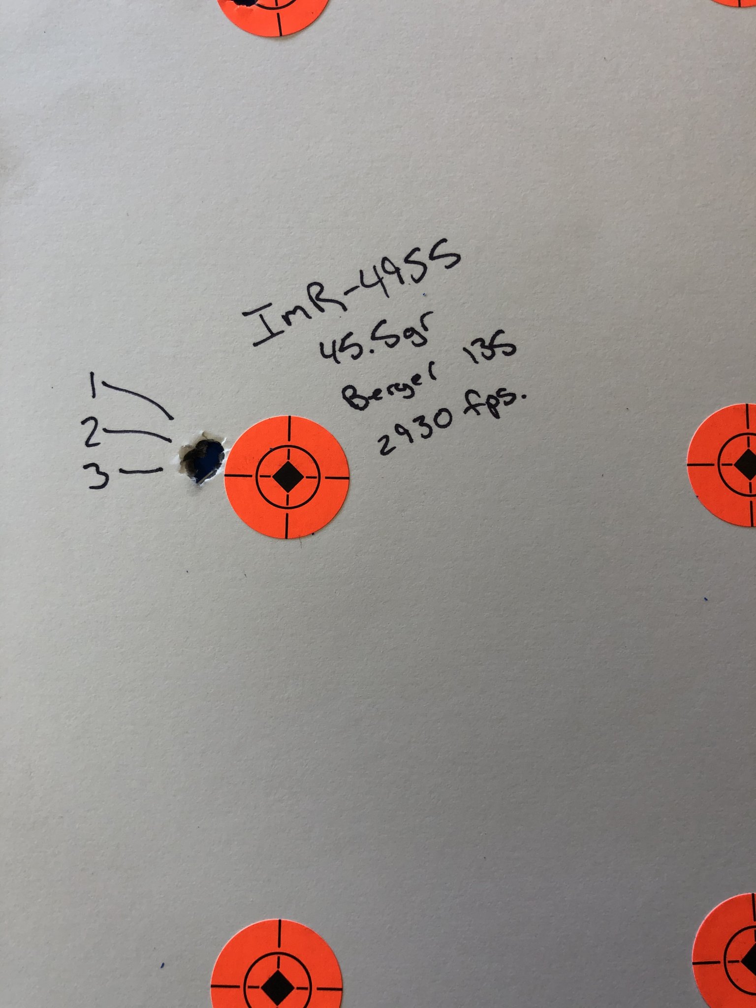

6.5-264 creedmoor
Lapua brass
Berger 135gr Classic hunters
IMR-4955 45.5gr
Federal 205m primers
.022 off lands
it dose this all year long no matter what the temperature is outside.
