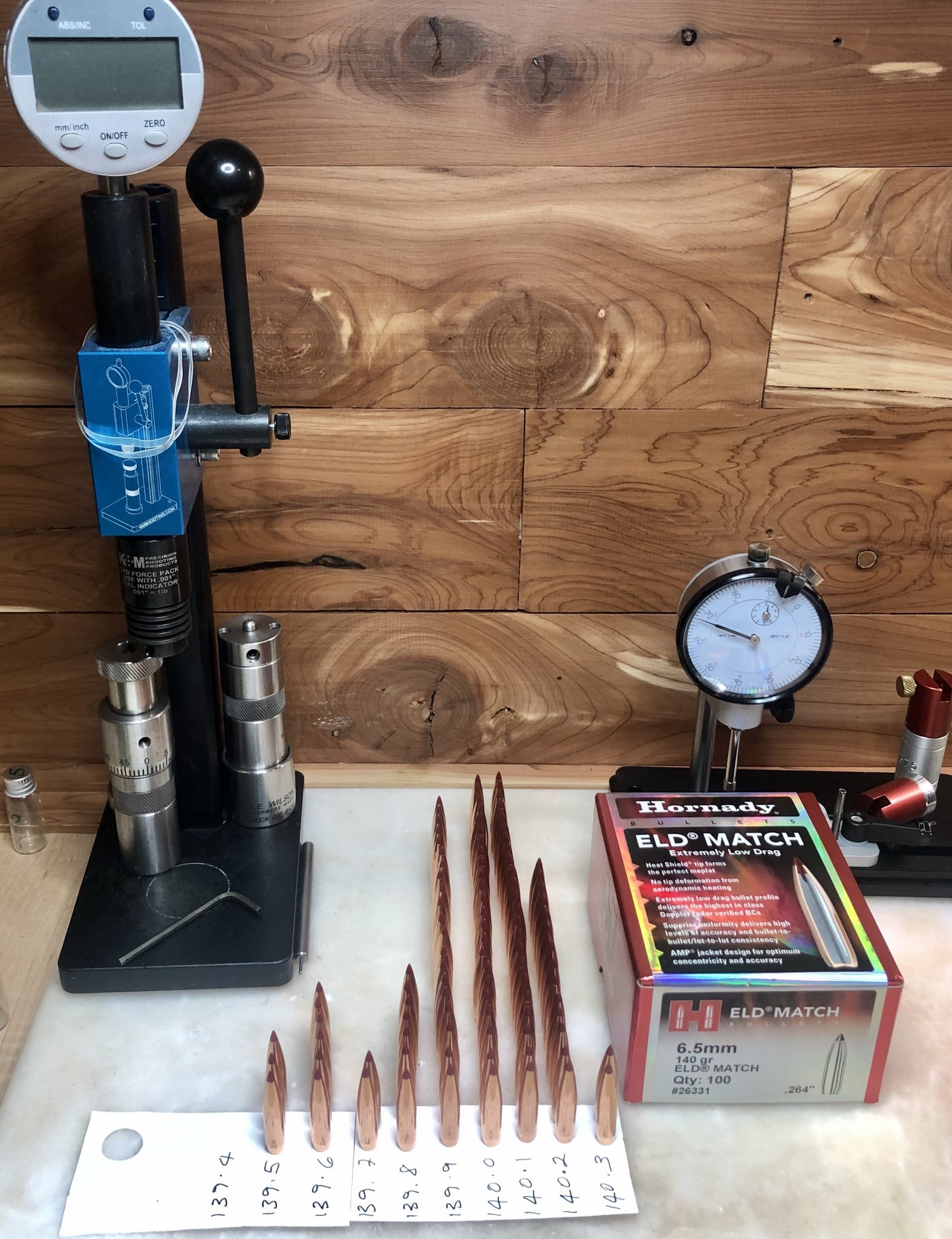

Interesting, the ELD-M both 130 and 140 shoot well in my rifles. I'll be interested to see how the A-Tips stack up. Where those are put up in order, maybe weigh in order to see if the variance is random or follows a pattern? I have wanted to try the 135gr but haven't seen enough terminal performance on game to be comfortable with them yet.
