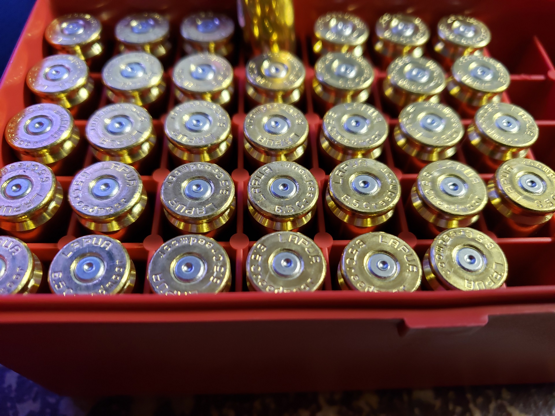

Brass still looks excellent. No sticky bolt, and primers are still rounded. Bullets were deformed pretty good to get 2.80 even at 46.5gr. I'm thinking working in the 47.7-48.3 range. ES/SD weren't the best but had very similar POI.
Brass goes 46.5 on left to 48.3 on right.

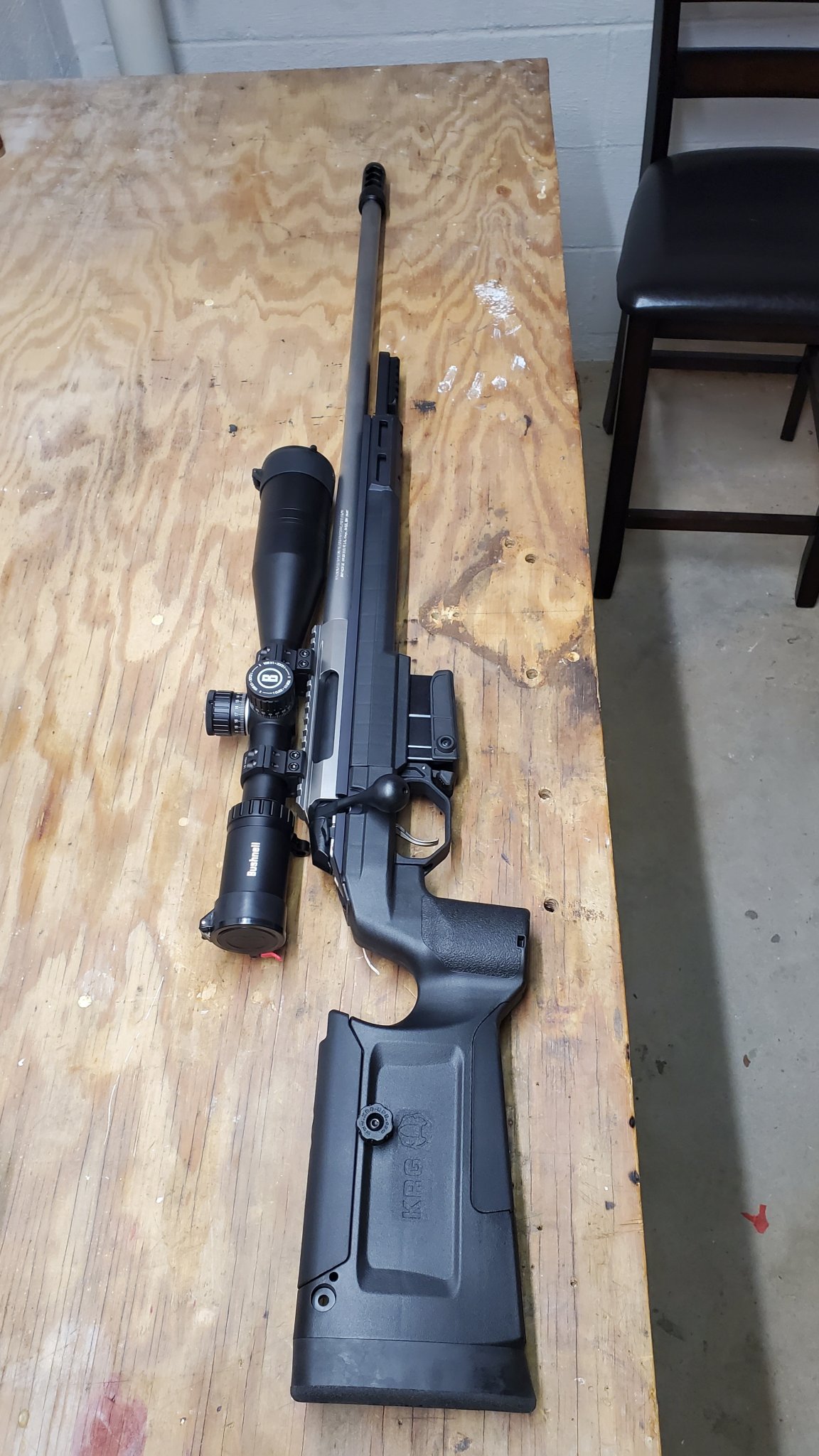

I have a 22" Lithgow LA102 in 6.5 Creedmoor, and I've gotten some components together for my first reloads. I haven't necessarily picked and chosen the components, they've more or less just fallen in place for me. So just looking for some advice and thoughts. Here's what I've got so far:
Brass: Once fired Hornady (out of my rifle).
Projectiles: Sierra Match King 120gn (I originally was only looking at 140-142 gns but my old man gave me these so gonna use 'em first).
Powder: H4350 / AR2209 (Was looking at this all along for a 140gn bullet but not sure how it'll perform with the lighter bullet).
I still need to get my primers, to which end I'm looking primarily at CCI. I'm just curious how you guys think the 4350 powder will run with the projectile, and how the 120gn pill will fare in the 22" barrel.
Also, big question here: if I do load development with these 120gn bullets and 4350, and I switch to a different projectile later will the nodes be similar projectile to projectile with the same barrel or powder or will it be completely different?
Cheers. Will keep updated on progress as I go.
EDIT: Forgot to mention barrel is 6 grooves, 1:8" twist.
