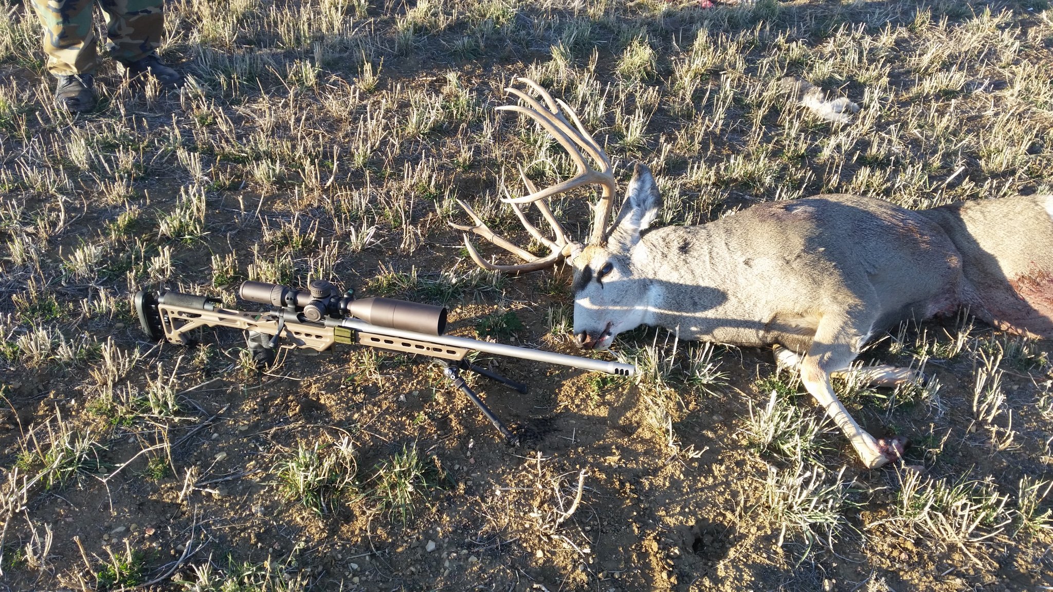

The 140 ELD has put down two mule deer each with one shot apiece for me.
553 yards
And this one at 300 something.
Plus another four or five mulies if you count the old 140 a-max.
Very nice mule deer Mr. Niles!
Did the ELD-M exit the animal? Presume it would.
In my experience, all hollow point and polymer tipped bullets open up and expand when they hit the animal at adequate speed. Differences between modern target and hunting bullets are not that significant, and have to do with things like the thickness of the copper jacket, if the jacket is fused to the lead core (most target bullets are), how much the bullet will penetrate before it mushrooms and opens up, if the jacket will separate, and how it will handle thick bones. I would be happy to use ELD-M bullets on deer and elk. ELD-X is probably a little better optimized for terminal ballistics.
But I would not use thin jacket target bullets on Cape Buffalo or hippo. ?

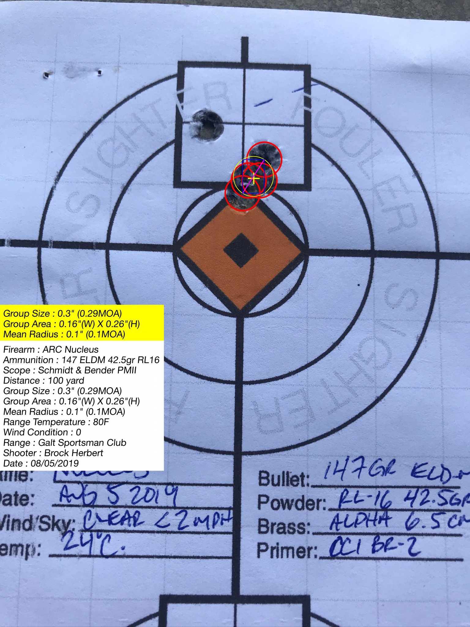

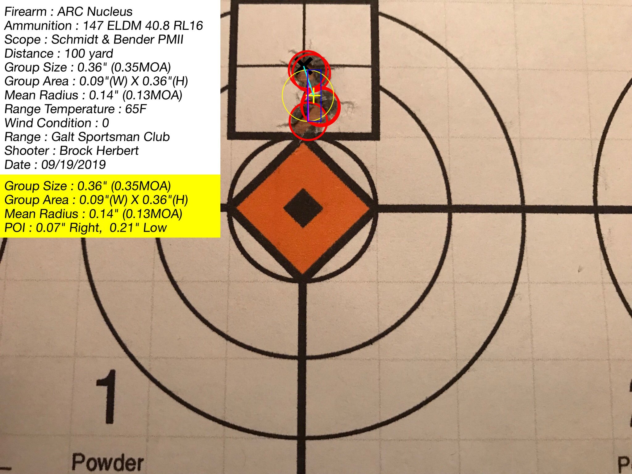

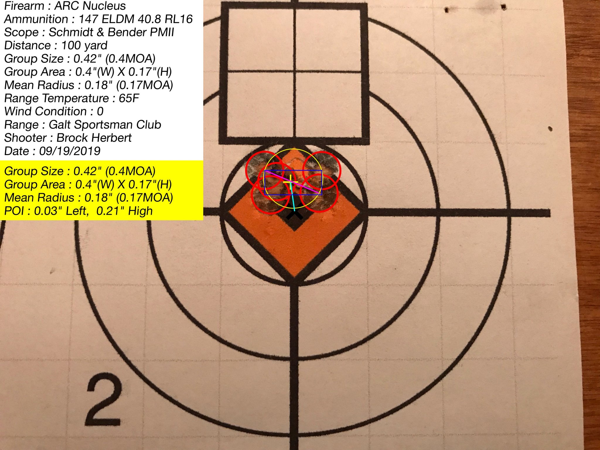

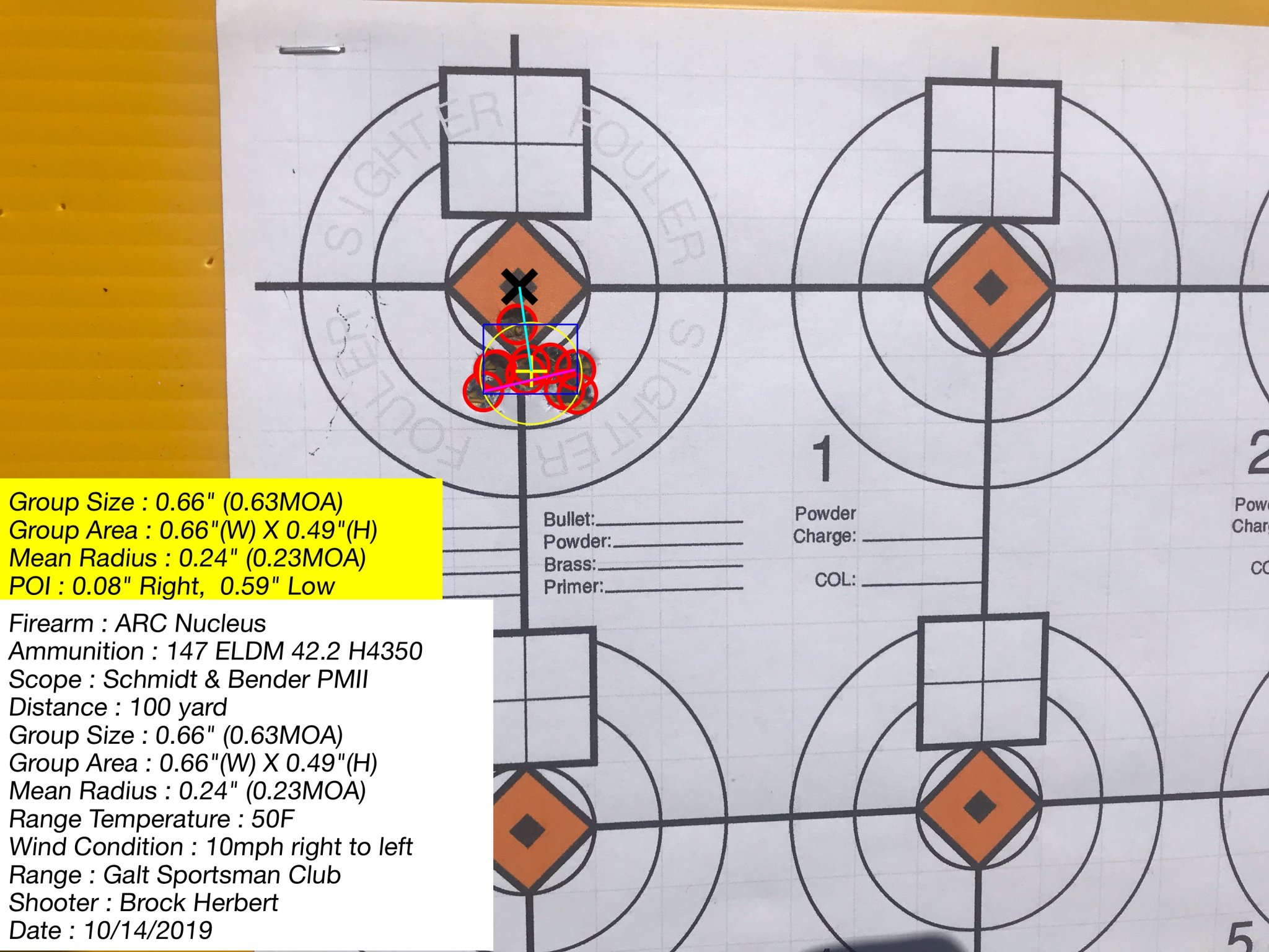

24” Rockcreek button rifled PVA Nucleus pre-fit.
1:8 twist.
147gr ELD-M over 42.2gr H4350 @ 2810ish in 50* temps.
Alpha LRP brass loaded to 2.210” CBTO @ .020” off the lands.
I’m super new to shooting in general and even newer to loading my own ammo.
This was a 10 shot group from this morning at 100 yards.
I can get some .3 and .4 five shot groups fairly frequently, but something usually opens them up. I’ve never had a string of 3 or more 5 shot groups that tight. Obviously I’m proceeding as though I’m the weakest link in the chain, but I am cycling through two boxes of the lot 218 ELD-Ms that have been blowing up mid air. While that hasn’t happened to me yet, if it’s happening to others, perhaps it’s contributing to some inconsistencies.

These are my best groups, but it’s not as consistent as I’d like them.
Again, I’m under no assumption that it isn’t me messing up behind the gun.
The gun certainly has the potential.
I just wish I could pinpoint definitively what allows me shoot on 5 shot group sub half, then the very next group over 5/8-3/4. Am I expecting too much?
Obviously there’s hundreds of variables, but if I load up 3 carriages at the same time, with the same process and then shoot them on the same day under the same conditions, I have to assume it’s mostly me.

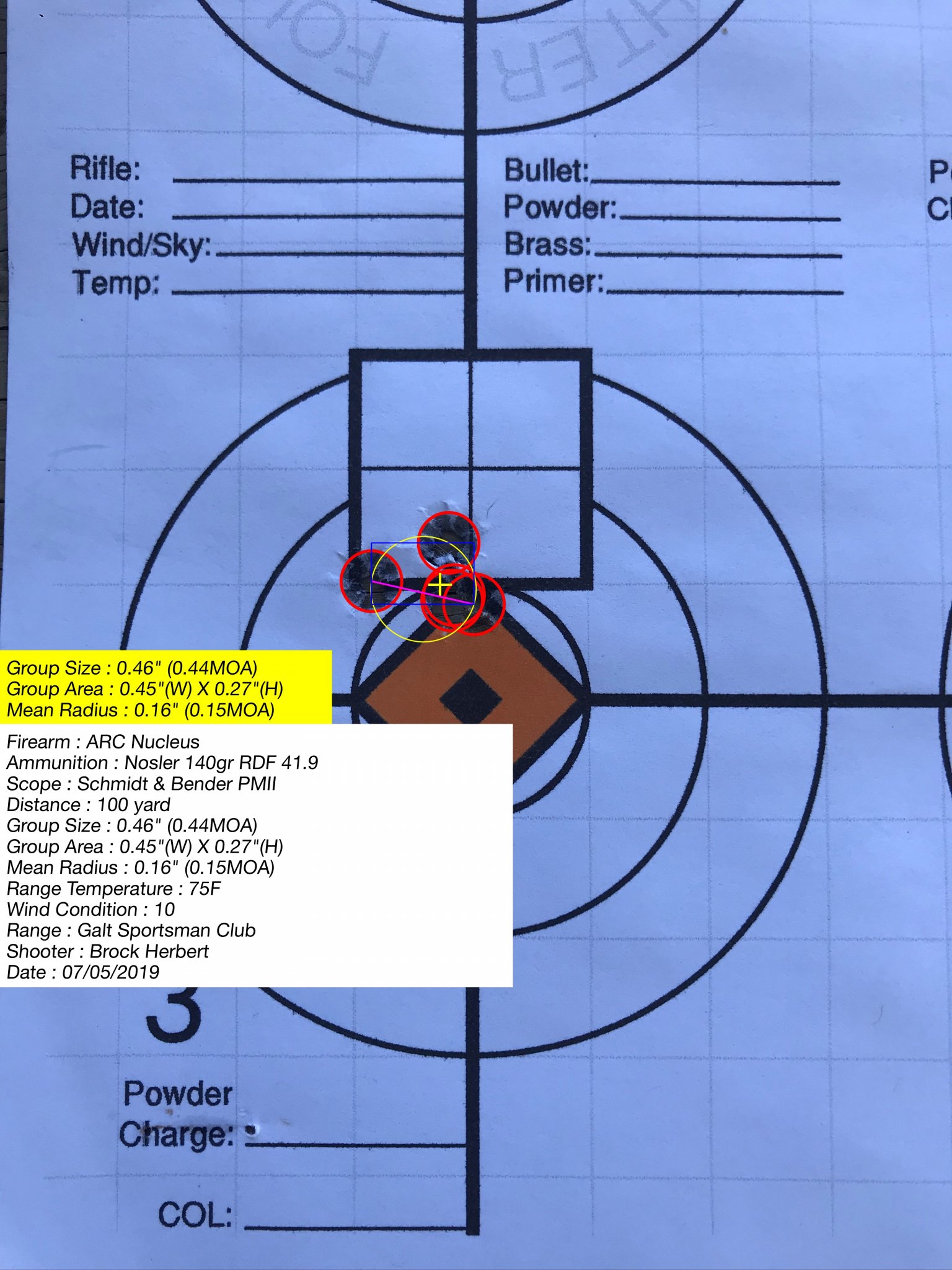

I use to think once I had a load that shot 1/4” , I could do it on the drop of a dime. Boy, was I wrong.
I consider myself a sub-moa shooter, mostly around the 5/8-3/4. Load development and shooting groups can be stressful, imo. All the time spent prepping, researching, begging the wife to get away ( truth ) and range time. Just to get there and have your previous “known load” turn to shit.
For me, I always keep a box of match ammo with me. When I am second guessing myself or losing confidence in my hand loads, I shoot half a box or a whole box and confirm. Lots of times, its told me the node I thought was good, wasn’t. This is what lead me to Dan Newberry’s OCW. I encourage you to check that out.
That said, those groups look good to me.

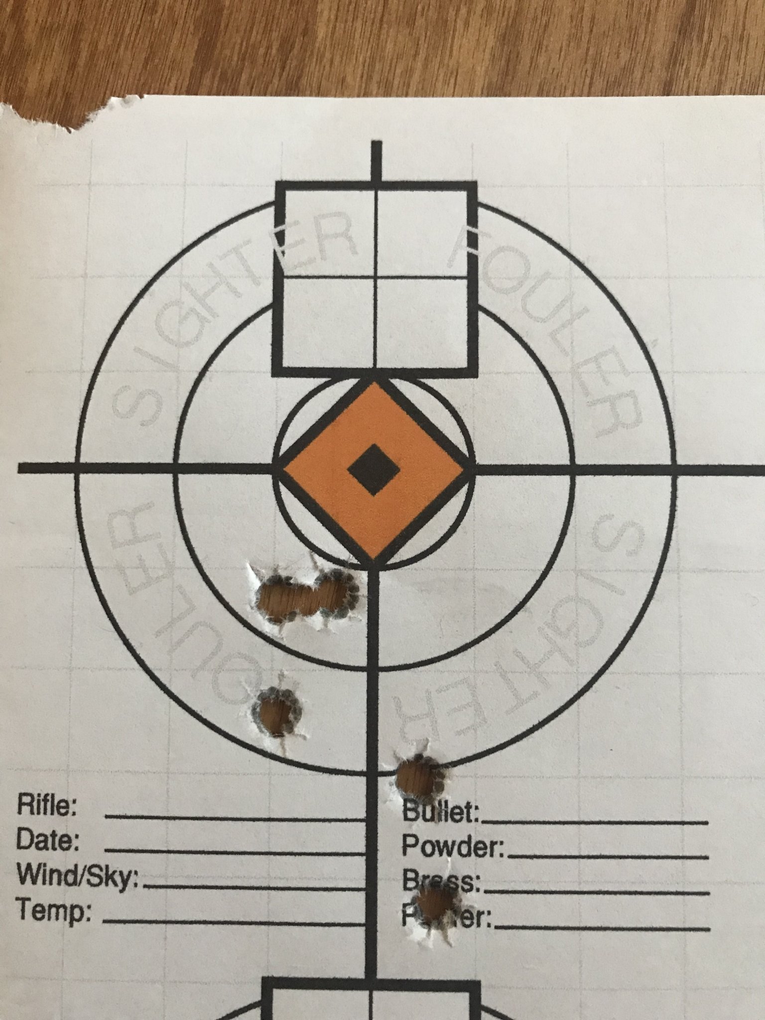

For comparison, this was the same load, this morning, at 200 yards.
Kinda falls to shit.
What I have been doing it 3 back to back 10 shot Satterlee load tests, and looking for plateaus in the graphs. Trying to find the ones that are comcistent over the 3 ten shot stings can be a challenge.
After that, I kinda do an OCW test I guess, where I vary the load inside those plateaus and shoot for the tightest groups. What I haven’t done however, is pay much attention to how the groups pattern around the point of aim. I have read that is what I’m ultimately supposed to look for.
Still .83MOA, but given how consisten my muzzle velocity is, and it only being 200 yards, I'd hoped for a lot less vertical spread.

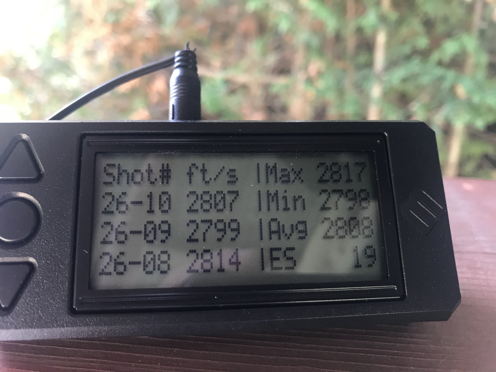

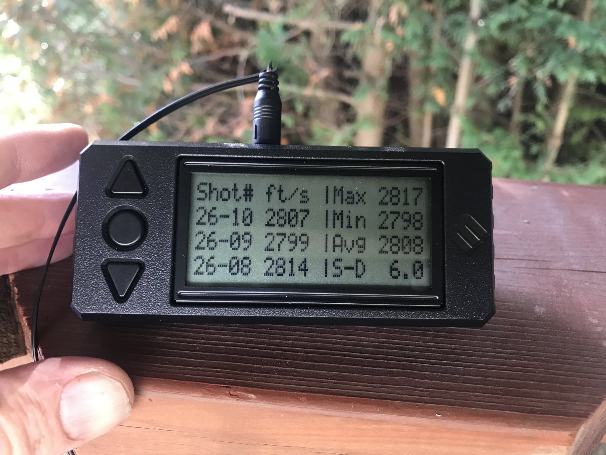

41.4 grains of H4350 with the 140ELD. Hornady brass, CCI200’s
Following 5 shots over chrono were
2814
2819
2820
2818
2815
2.3 SD
Left the chrono on and shot at 945 yards for 12 rounds. Avg was 2810 with SD of 8.7

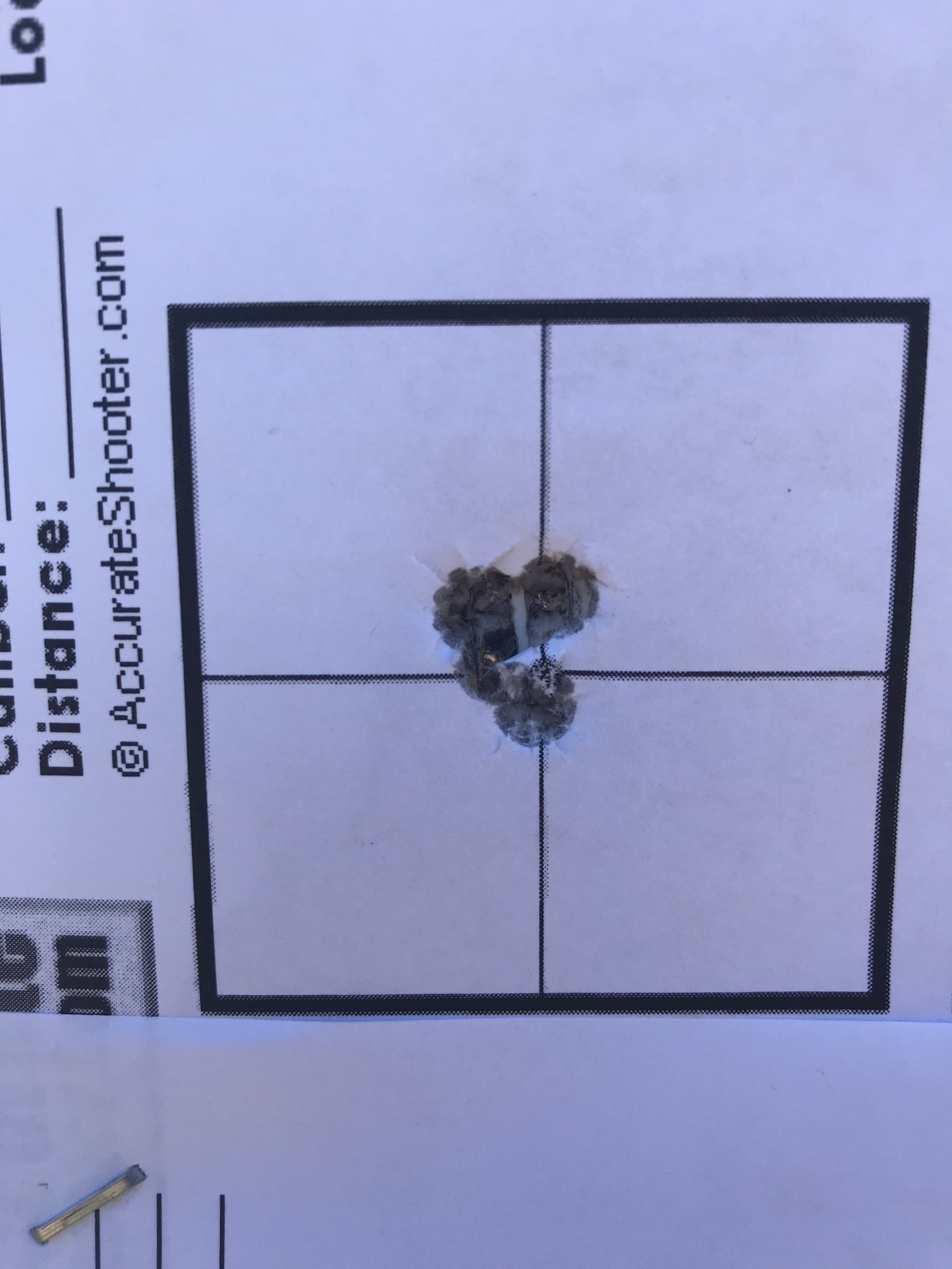

Curious man, did you chrono these 5 as well? It won’t make a giant difference at only 200 yards but if you’re chambering a round and trying to find your POA again, you may be letting them cook in the chamber a bit at the longer distance trying to dial in the perfect shot and it will change up muzzle velocity from one in a hot chamber for 10 seconds one time and 30 seconds the next.
Just a thought.
Just a thought.
I didn’t, but I am very conscientious of exactly that. Heating up a round in the chamber. So much in fact, I’ve actually pulled a couple out and thrown one from the box in instead, if I’ve chambered it and then taken more than a few seconds to set back up again, but very good point.
I don’t normally send my bolt forward until I’m really ready.

Started development with RL26 since I managed to score 2lbs from brunos. Shot with a 26" PVA built ARC nucleus BA, with a griffin 30 cal paladin can.
Virgin Lapua SRP
CCI#450
Hornady 147gr ELDM
Reloder 26
2.80" roughly .150 jump
46.5gr
AVG 2796
ES 23.73
SD 9.41
~.66"
46.8gr
AVG 2823
ES 24.23
SD 8.88
~.84"
47.1gr
AVG 2846
ES 20.1
SD 8.62
~.89"
47.4gr
AVG 2873
ES 16.5
SD 7.37
~.60 (4 shots, had one fail to go off)
47.7gr
AVG 2895
ES 32.12
SD 12.5
~.48"
48.0gr
AVG 2916
ES 30.87
SD 11.97
~.61"
48.3gr
AVG 2945
ES 29.9
SD 14.38
~.48"
Brass still looks excellent. No sticky bolt, and primers are still rounded. Bullets were deformed pretty good to get 2.80 even at 46.5gr. I'm thinking working in the 47.7-48.3 range. ES/SD weren't the best but had very similar POI.
Brass goes 46.5 on left to 48.3 on right.
