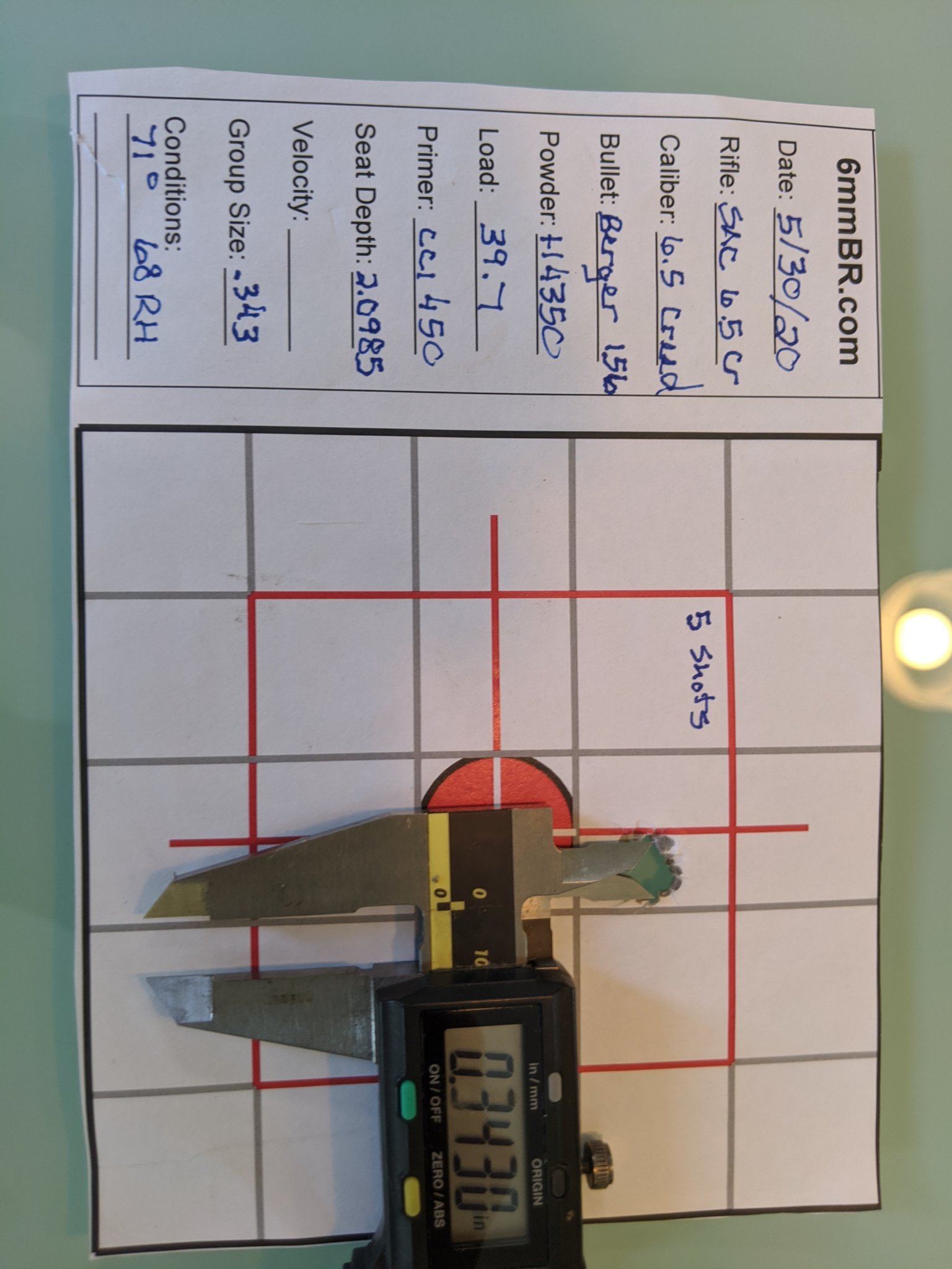

Borrowed some of my buddy’s 140gr ELDM’s, loaded up my standard load and boom, .8” group. I’ve burned about 80 of these Bergers and feel like I’m chasing a load that isn’t there. Just frustrating. Think I’ll just stick with what works.
I was gonna ask (how many rounds through the barrel), but seems like you already found a solution.
If you are really wanting to run Bergers, I would try going up while watching for pressure, or go down ( 40.5 range )
Maybe i just got lucky, but I got good results with both bullets. Managed to get 0.5” five shot groups with the 140 Berger Hybrids with a very long jump, around 0.120”. Groups were only slightly better at a jump of 0.015”, perhaps 0.4”, but those rounds had to be single feed. [Needed more powder to stay at the same node with the bullet seated that long.]
I have three rifles that shoot well with bullets loaded to a very long jump, eye popping numbers. I also have one rifle that will not shoot anything well that is loaded into the lands. My impression is that the way the lands erode is not always perfectly symmetrical, and loading to a jam in such a situation can push the bullet skew.
But there is a second problem too: I don’t use high neck tension and i have seen that with ammo loaded to a jam, if you close the bolt and then eject the unfired round, and measure COAL or base to ogive, that you get different numbers. Scratch marks on only one side of the bullet. The camming power of the bolt is quite high, and will almost certainly reseat the bullet deeper, unless neck tension is intentionally very high. Soft seating sounds like a good idea, but it is not always the case. My experience is that the amount of “soft seating” varies in a worn barrel, and is not necessary consistent.
Shoots what works. No point in wasting barrel life! Training time is more valuable than load development time. And barrels are consumables.

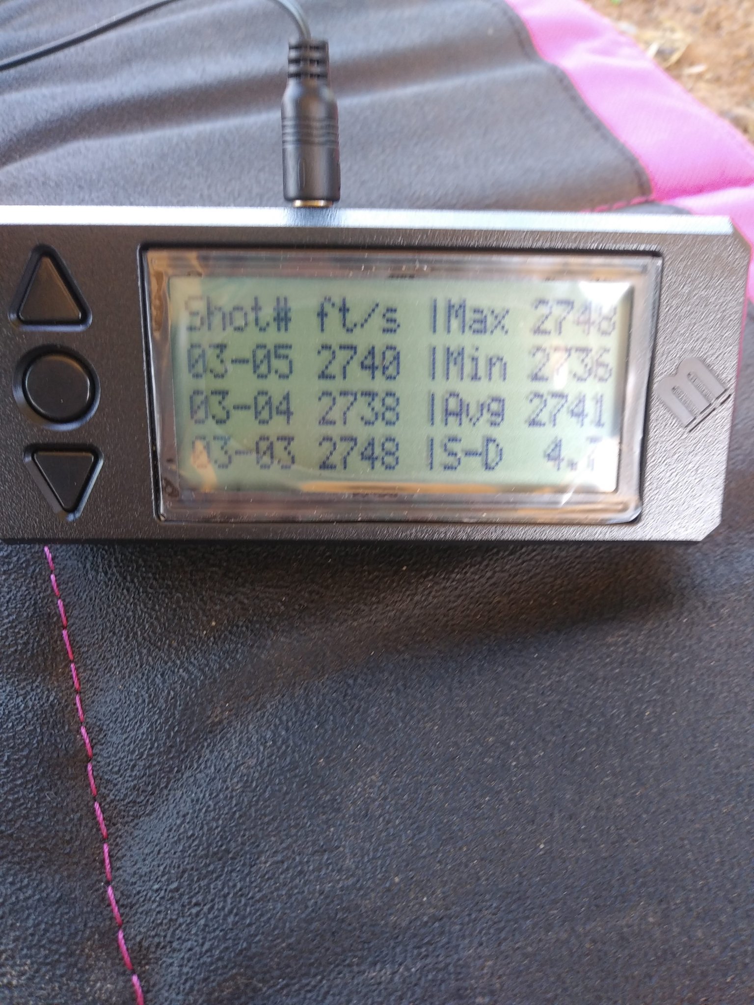

Yesterday i tried a different load in my MPA 6.5 BA, looking for a higher node. The chamber is throated for the 140 ELD-M bullet, and the user manual advised against using longer heavier bullets in this chamber, so decided to follow Masterpiece Arms’ bullet recommendation. [And they are cheap, compared to Berger and Hornady Atip, which is appreciated.]
Will refrain from publishing the load as the chamber appears to be min spec and freebore is short. I also picked a temperature sensitive powder, simply because i have it on hand. Not a powder i would recommend for any locality with large temperature changes between winter and summer. [I will have to vary powder charge as the Texas temps go up from 60 in early spring to 105 in late summer, and i realize this is not practical for most folks.]

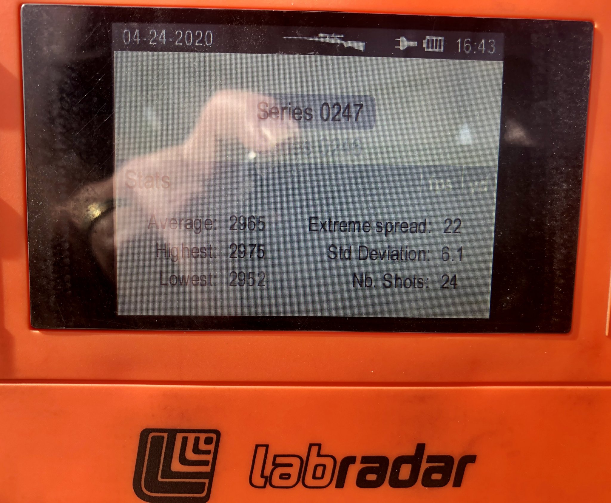

Did a pressure test at 61 degrees F with one of the progressive powders in the Reloder product line which is known for delivering high speed, and eventually found pressure signs about 150 fps higher than what H4350 will deliver in this rifle.
Repeated the load 0.3 grains below max, and shot it yesterday at 400 yards at steel targets. Best 5 shot group was eyeballed at about 2”, typical result was 2.5” to 3” groups in a 13-15 mph wind. Could hit the little 3” plate every time, and had great fun! Very happy with that result (given my limited wind reading abilities) for a load that has not seen any detailed load development (looking for flat spots in the speed graph), or any attempt at positive compensation (PC) where barrel whip is exploited to look for a speed/powder region faster shots hit slightly lower on target.
ES was 22 and SD was around 6 fps, which for me is a much better than average result. Maybe i just got lucky, but the point i am trying to make is that sometimes there is a node higher (or lower) in the speed range that will work better, producing smaller groups. It is not guaranteed that a better ES will be observed, but if you get both useful PC and low enough ES to show up at a different node, you are in business. [I also know this high speed node and the unfriendly double base powder is going to reduce my barrel life. Might offset the money saved from using cheaper bullets, oh well! As always pros and cons.]
I shot a total of 25 rounds yesterday, barrel was cleaned, so cold bore shot was slow and it was deleted, leaving a total of 24. No other shots were deleted. I usually get SD numbers between 8-11 fps (sort of OK, but not great), and ES between 28 and 35 fps (too high for comp work) at the lower node.
Who knows if the change in powder was the main reason for the improvement, or the change to a higher node, but some experimentation (without burning out your barrel!) can be beneficial. Go look for those “other” nodes and see what they are willing to do for you...

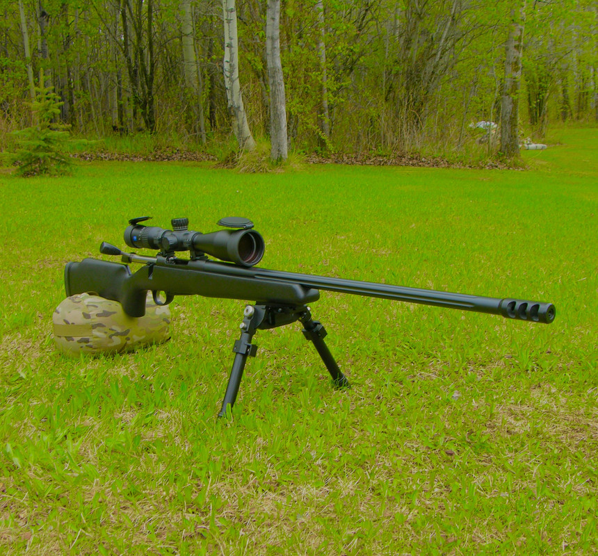

6.5 Creemoor
26" barrel
Lapua brass
CCI #450
47.8gr RL26
147gr ELDm at 2.860"
This is thrown on Chargemaster 1500. The brass is hand annealed every other firing.

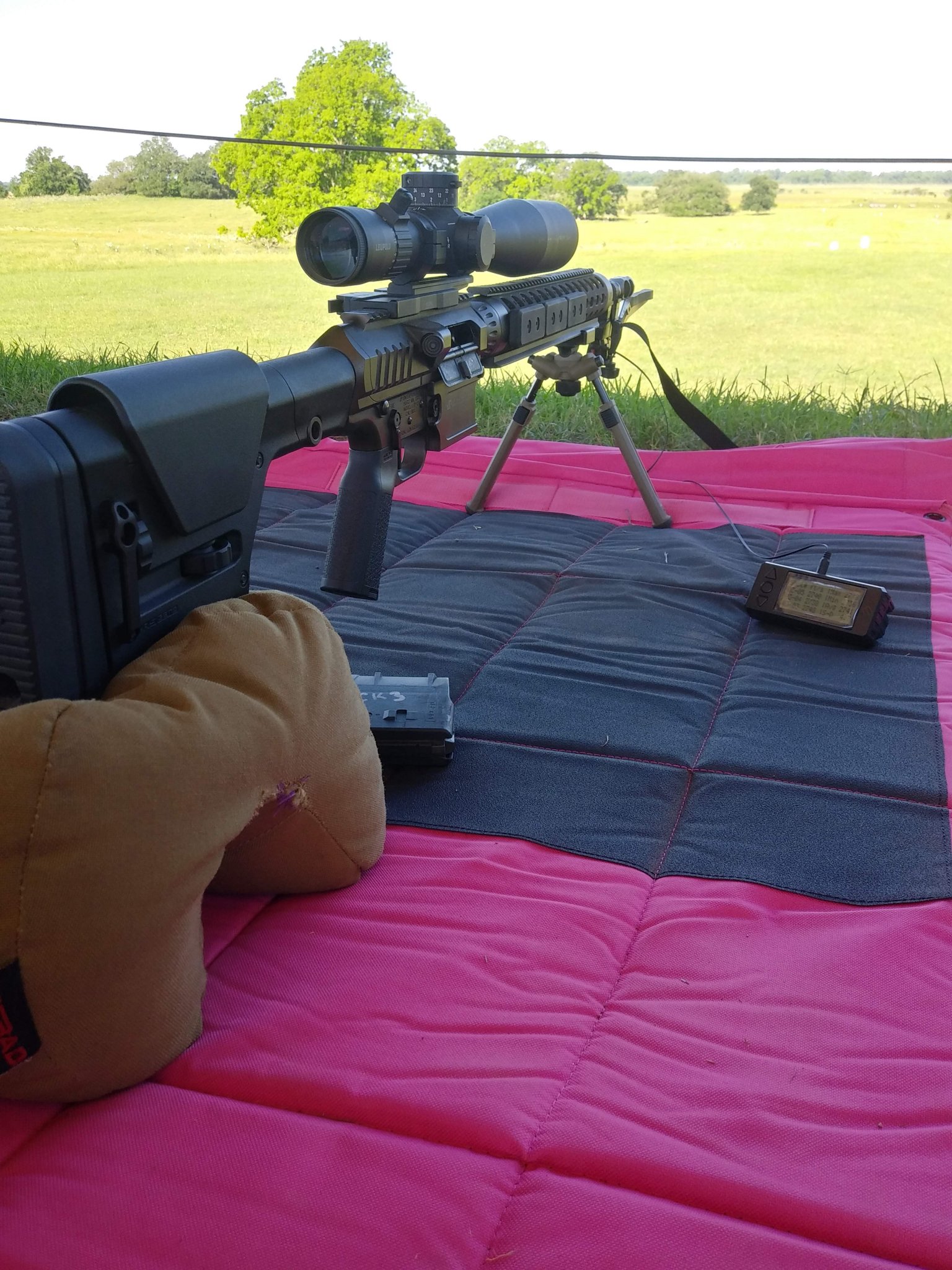

26" MPA (xcaliber) with "match chamber"
those numbers got me thinking too now that you mention it. the day I shot that string was 96* out. I shot a match over the weekend with that same load and the morning zero range sesh on a buddies lab radar showed 2808 so I ran that speed for the morning split....it was a balmy 45* that morning. I started to miss more during the day (as the temps got closer to 65) so I upped my speed a touch in my kestrel and but it didnt help much.

Between that length and that temp I can see that kind of speed. I too find the Magnetospeed to be accurate just wish it wasn't a tuning device. I'm running 41.8 gr H4350 140 ELDm 205m @2778 80* 1300 elevation. There was another node at 42.5 but it wasn't as accurate. This is a 24" barrel.
may magspeed is mounted off the barrel so I have that going for me for impact results. I was assumed H4350 was temp stable but a 50* swing with an elevation shift I suppose that sort of change can be expected... ?????
