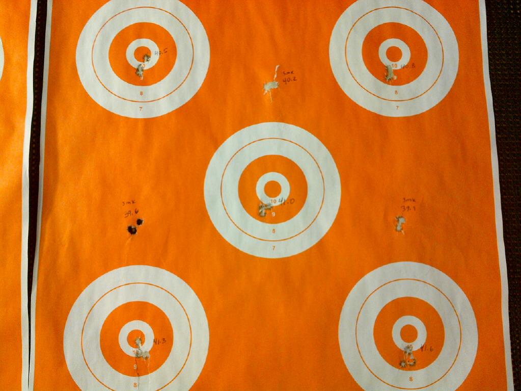

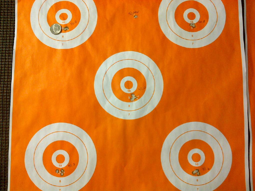

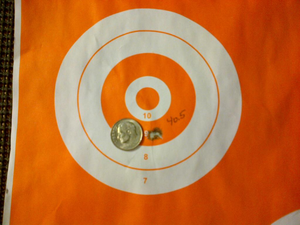

Tried some loads last night. Don't really have chrono data, the chrono kept giving me errors (the sun was low on the horizon at my 6, so i think it was casting shadows and having a hard time picking up the bullet). My question is, how much affect can neck bushing size have on a load?
I had 4 loads, with 2 powders. Once load each with new factory brass, and one load each with 1x fired FL re-sized brass using a 0.288 neck bushing. As shown in the picture below. So the two groups on the left were both with 40.4gr of RL17 top one was new brass bottom one re-sized. I felt like i pulled the third shot, so that's why I fired a fourth, but it was still only a .54" group counting shots 1,2,4. I have a .287 neck bushing as well, is it possible that with that powder, it just needs a little more neck tension to tighten the groups up? Does anyone know what the neck tension is on factory brass?
Note: the top group with H4350 included my CB shot. Also this load was just tossed from a powder drop and loaded, the other 3 groups/loads were trickle charged.
Measuring loaded cases the necks are .292, so a .288 bushing is .004 neck tension. I think once you get beyond .003 of neck tension, it really doesn't matter much anymore except that you are working the brass a little harder. FWIW, I use a .288 bushing also. I have a .289, but I have not tried it yet.
Not sure why the RL17 opened up on the once fired brass. Usually, that shoots better than new.

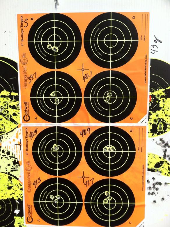

Here's one I started messing around with,
142smk
Hybrid 100V
New and fully prepped Hornady brass
COL 2.780"
CCI 200 primers
This was shot at 100 yards using the OCW method. I'm going to go with the 40.9 load and play around with the seating depths.

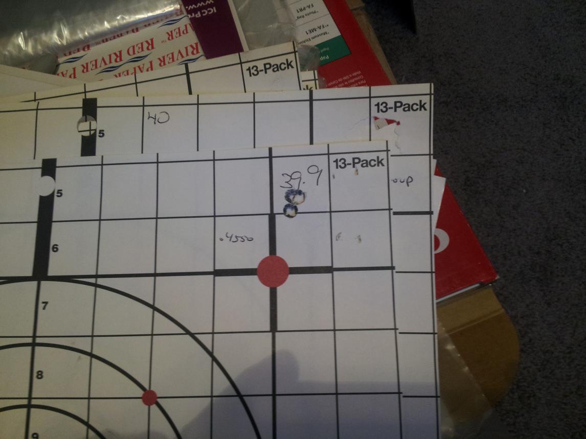

So I am still testing the IMR 4350. Rifle is stock Savage 12LRP in 6.5CM. All targets were at 100 yds.
I worked the load up a little higher with the 140 gr AMAX. 40 grains is really nice. This is a 5 shot group with 140 gr AMAX's. I found another node at 41.7. I'm going to try it again later when it is a little hotter here. Don't want to go too high until the temps get up so I can check stability or lack of it.
I loaded some 142 gr SMK with the IMR4350 as well. Same base to ogive as the AMAX. The second pic is 39.9gr with the SMK. This gun likes 40 grains of IMR4350 it appears.
