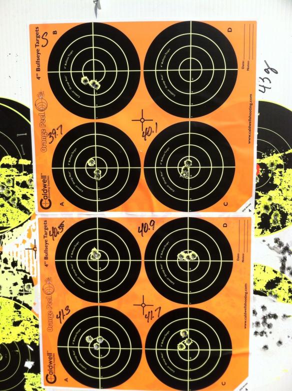

I have a badger M2008 action with Bartlein 26" barrel. My current load is 42.1gr H4350 pushing the 142gr SMK to 2765fps jammed into the lands. During testing the load it gave me a .30moa group at 500 Next thing I will likely mess with is the seat depth.
Wow. Finally found a load tonight.
I made some 130 VLD's last night. Took them out after work tonight. I just blew my own mind.
I'm kinda new at load development, and have previously made 4 other different loads with over 1 moa so I was really hoping to get something together because my factory ammo supply is gone and the online stores aren't in stock, and my previous loads had me doubting myself.
I used 3x fired brass. FL sized it and cut it back down to 1.910.
Berger 130 VLD Hunting
40 grains of V100
CCI 200lr primers
COAL: 2.850 ( I don't have ogive measurements )
3 Shots:
I couldn't believe myself, thought I had a flier somewhere....3 shots here too:
IM LOVING THIS V100 AND BERGER 130'S. I don't have a chrony so i don't know speed. Dunno how its gonna be at long range yet either.
