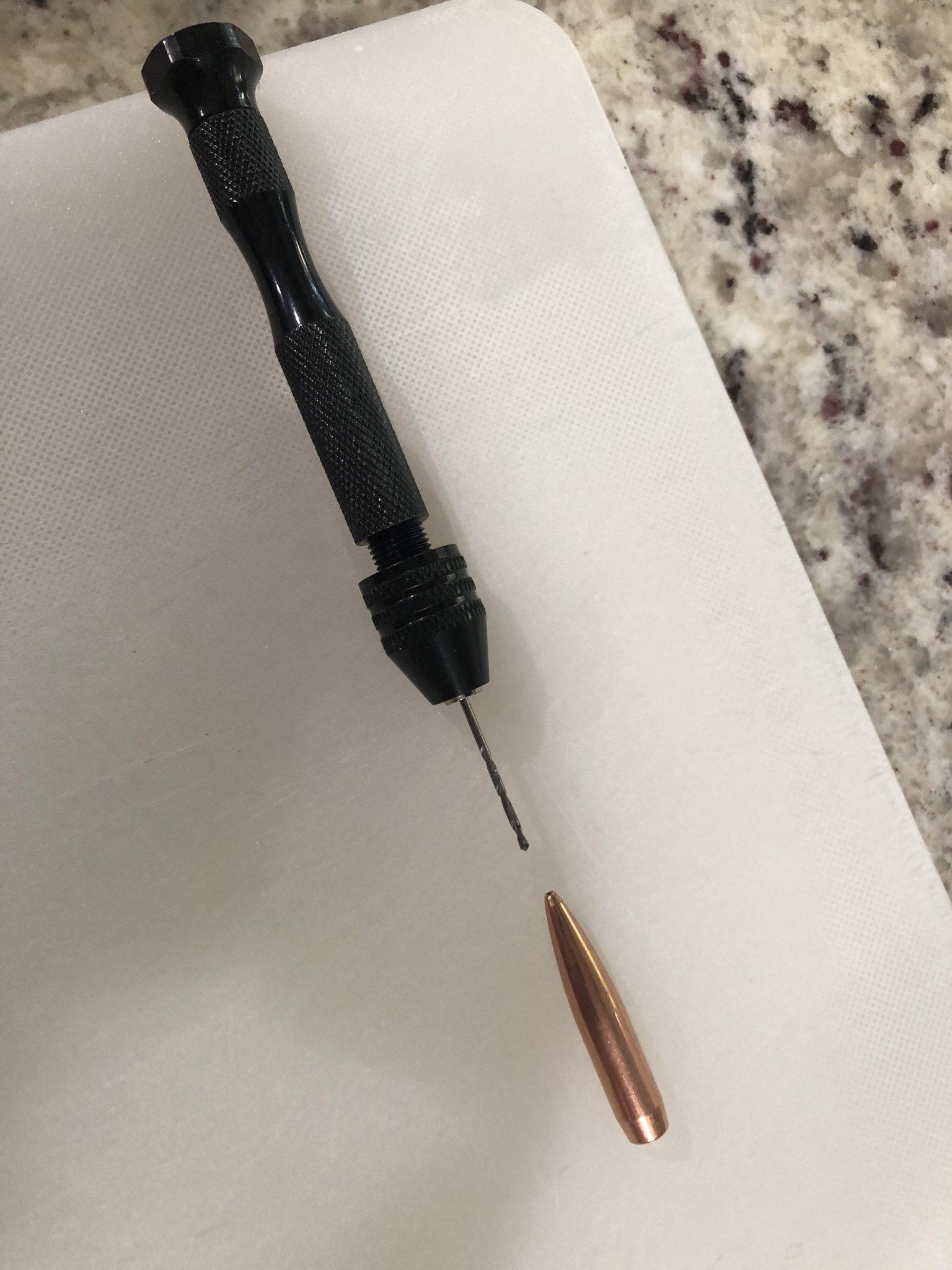

does anyone else “drill” out the hollow point tip? I use a very small bit that is just barely larger (a matter of thousandths) than the existing hole and hand drill (not powered) to open it up as well as true it up a tiny bit.
I don’t know what your manual drill set up is, but a bit that small will probably have enough deflection to be counter productive. Conventional meplat trimming would be more consistent.

Using wire drill bits to ensure Berger hybrib, vld and elite hunter tips(not lrht, as they're pointed shut) are open is nothing new and been going on for a long time. When the bullets are manufactured, one the final steps is polishing, and the media can plug the tips. When this happens expansion becomes very inconsistent. Opening the tip back up and removing the media, ensuring no blockage to the lead core, gives them all pretty consistent performance.
That's interesting, I've actually never heard of that. The wire bit isn't cutting the jacket at all, correct? E.g. it's all about expansion & not BC uniformity?
eta - & I'm guessing there is some sort of die to use this w/ a drill press or hand crank?
There are meplat trimmers that can be used if more uniformity in length is desired.
Wire gauge drill bits can be used with a pin vise.
Search on Amazon for pin vise and you can find sets that include dril bits for not much money or you can pay 10x the price for Starett

Started when guys started hunting at distance with match bullets. It will only open the tip to the same or a very small amount over what Berger sells them. This is just to confirm no plugged noses and open to lead core below. Pretty much just for consistency in expansion. Meplating dies will lower BC by a small percent but make more consistent, then there are guys who meplat then run through a tipping die to close the open nose back up, gaining bc back. All that is way too much work for me and unnecessary in my shooting disciplines.

I appreciate the replies. Just for clarity I am doing this to improve and provide consistency for the end results of the impact damage, with a question regarding accuracy as a side effect.
Yeah, not doing all that myself, just opening the hollow point up for consistency of end effect. They are quite effective, imo, along the lines of the Berger “tactical” bullets or the ones often used by PD’s but with better BC’s than that other brand, which I won’t mention.
I appreciate your reply, as I had not heard of anyone else doing this before your confirmation and others here. 👍

I use “wire gauge” bits with a small hand powered “hand drill” designed to use such tiny bits. The one I typically use is barely larger than the hollow point and mainly trues up the hole. Wasn’t looking for meplat trimmers or anything like that. It’s the end ballistics I am mainly interested in. A closed up meplat, to a degree, reduces the effect of a hollow point. I would love to see these tested in ballistic bell. However I currently live in Dallas Metro and have no access to the kind of area or freedom when, if I could get the gel, to test. Perhaps once I move to NC I will be in better environs to perform tests 😄

Essentially that is absolutely correct. The hole is expanded with a minimal, if any, amount of material removed and the cavity below the meplat is not touched. The hand drill is hand powered so one has a close and sensitive feel for the activity. It’s all about opening up the hole and making it consistent. Seems obvious that the manufacturing process, shipping etc would ding the heck out of the points, occasionally all but closing the holes up entirely in the more extreme cases. I am including a pic of the drill and bit. They are available in Amaz_n for example. The pic includes a Hornady 140grain 6.5 mm HPBT for scales
FYI: we are not drilling high speed into stainless steel so there is no deflection or such 😄. There is just a very tiny amount of soft material removed to increase and true up the hole.

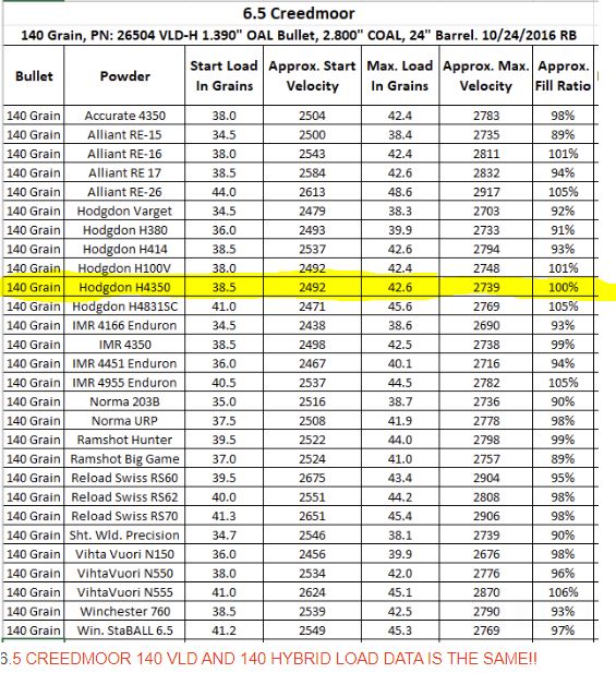

If I may ask, what is berger’s stated max for the 140 and H4350? It is rather higher than Hornady s listed max for a 140 gn. They show 41.5 for 2700 fps as I remember.
Interesting, for a similar style bullet Sierra shows 42.6 as a max. I just love the consistency lol
Sure, this is direct from Berger. They'll email any load data you want if you request on their site.
