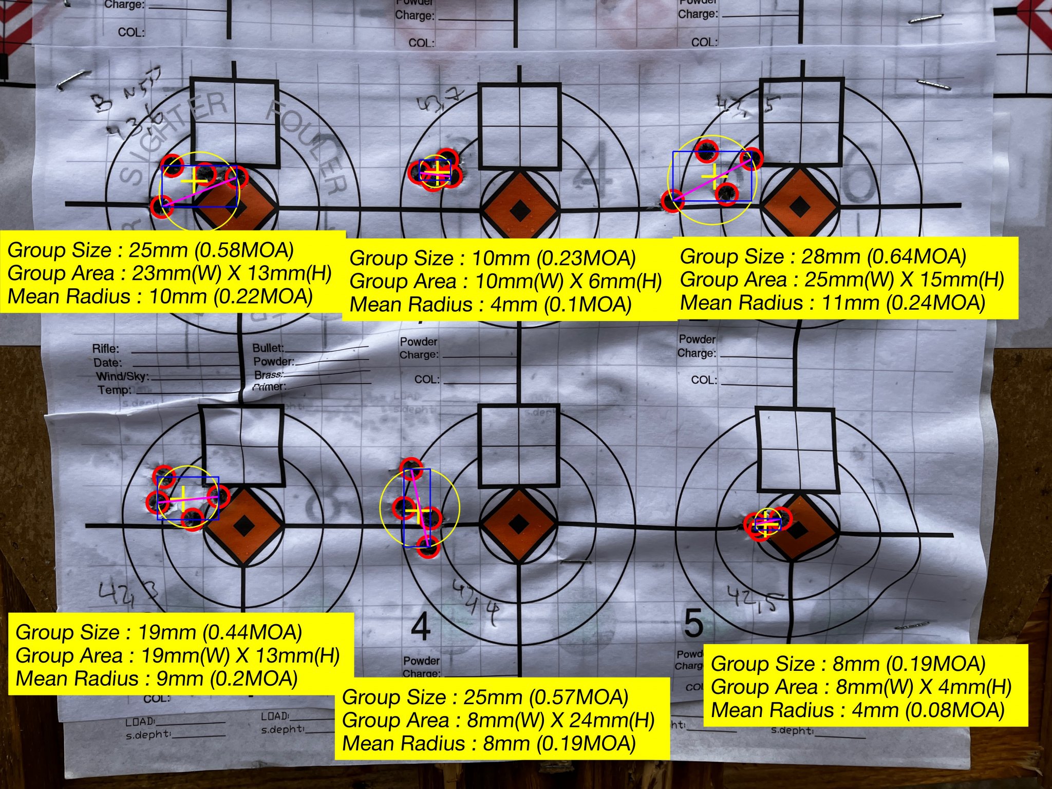

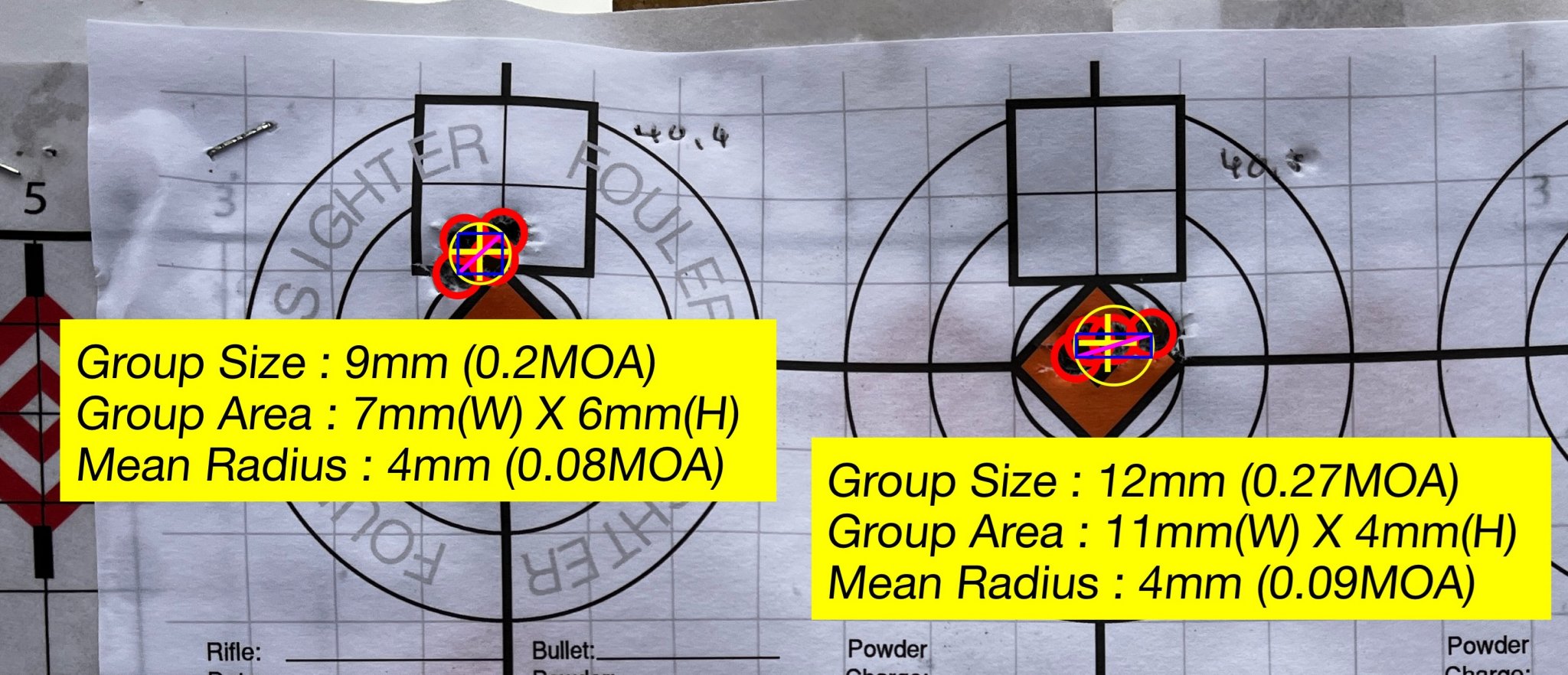

NRL Hunter load development:
Proof 24" Carbon Bighorn Origin pre-fit 1:8 twist Sendero contour
Previous load: Hornady 6.5 CM brass, Hornady 140gr ELD-M, H4350, Remington 9 1/2 LRP
Case length: 1.92", Headspace 1.553", CBTO 2.224"
42.0gr = 2735 fps, sd 12, es 40 (power factor = 382,900)
New load: Lapua 6.5 CM LRP brass, Hornady 140gr ELD-M, H4350, Remington 9 1/2 LRP
40.4gr = 2733 fps, sd 10, es 31 (power factor = 382,620)
Notes:
I should have followed the old adage "work up your new load starting at 10% below you current load."
I thought I'd be around 2600 with 40.4gr but I'm guessing the smaller case volume of the Lapua brass allows for more pressure and speed.
The Lapua brass is smoother when full length sizing and the shoulder and length doesn't deform nearly as much as the Hornady.
I'll be making the switch to Lapua LRP brass as I didn't like the SRP brass getting stuck on my hand-deprimer.
YMMV, happy shooting.

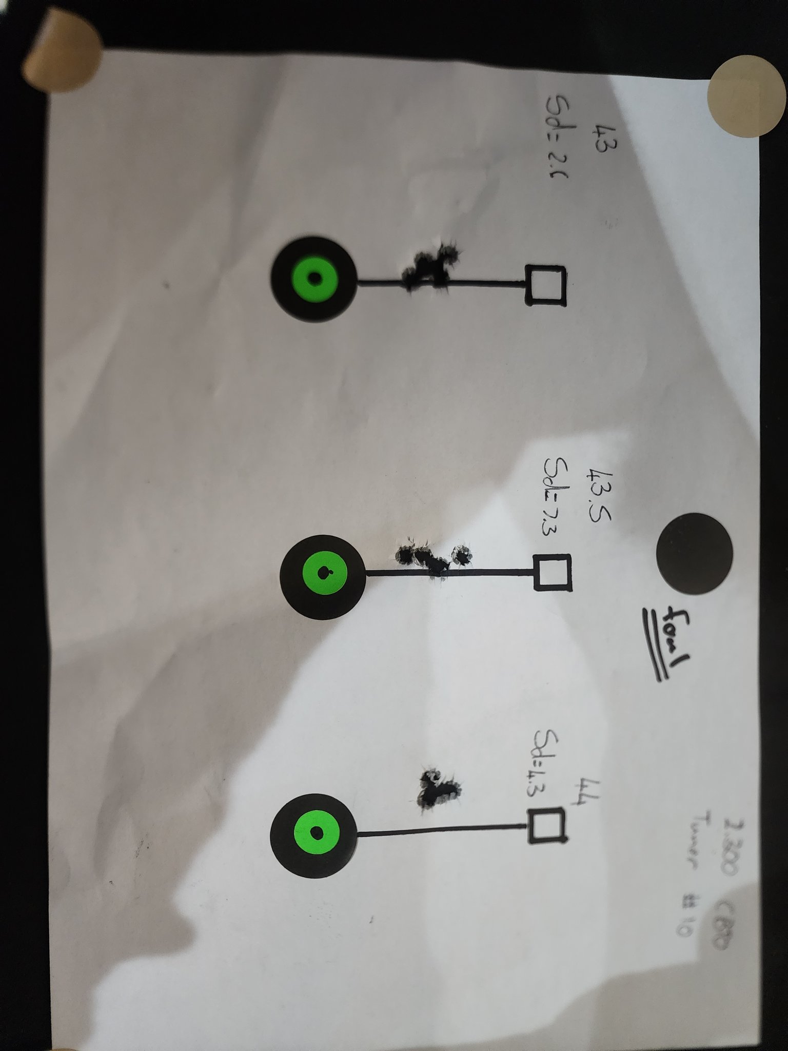

View attachment 8278391I did not find N555 super sensitive all these groups are under .55 moa
If I'd repeat the test I assume that groups will print different
I tested at 43.8 and it shot pretty well too
This is with Lapua scenars
My old 142 smk load was at 43gr
