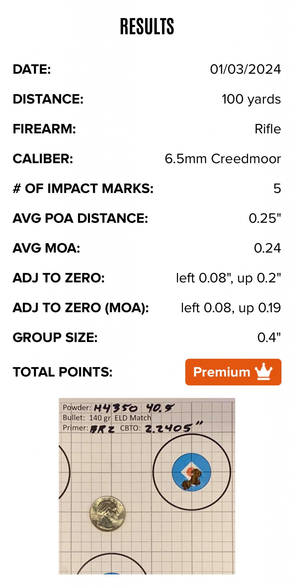

I'm presently using 40.5 grains of H4350 with CCI BR2 primers, and Hornady140 ELD-M bullets seated to 2.2405" CBTO. Here is an a group from 12/23 -- probably my best 100 yard group ever. The statistics were generated using a free smartphone app called RangeTime. It uses the US quarter to calibrate the dimensions in the photograph. You define the distance, caliber, point of aim and the impacts. It does all the rest.
Remember that everyone's comparator tool is going to be slightly different. The CBTO I measure with my caliper might be slightly different than you get measuring one of my cartridges with your comparator. I have also found significant bullet ogive dimension differences even within the same box of 100 bullets. Every once in a while I'd seat one and it would be much deeper or much shallower than the last dozen I seated. (RCBS MatchMaster micrometer seating die) I sort my Hornady 140 ELD-M bullets by weight to the 0.1 grain. But even using bullets with the same weight to the tenth of a grain, I will have outliers that are up to 0.003" taller or shorter than the others. I usually use those for foulers or sighters. If I had more time, I'd initially sort all the bullets by "bullet base to ogive dimension". The scale is just SO much faster and I can have my GF sort them while I'm dropping powder or seating bullets. Over the last past ≈1000 bullets, I've seen them as high as 140.5 grains and as low as 139.7. When reloading, I only make groups of five from the same weight bin.

Converting COAL to CBTO
It's rather difficult to precisely measure the COAL of a 6.5 Creedmoor Hornady 140 grain ELD-M bullet with the pointy plastic tip. Here is some research I did that may help you convert back and forth (or at least translate someone else's dimensions) to the measurement you're using.
Hornady claims their 140 ELD-M bullets have a manufacturing tolerance of 0.003" base to ogive and 0.005" base to tip.
I sorted my 140 ELD-M bullets by weight, randomly pulled out 12 from the 140.0 bin and measured their Base To Ogive.
  • Minimum: 0.7635"
  • Average: 0.7645"
  • Maximum: 0.7650"
  • Extreme Spread: 0.0015"
The published overall length of the Hornady 140 ELD-M is 1.374"
If I subtract my average base to ogive dimension (0.7645") from the bullet's overall length, we can get the average Ogive To Tip dimension.
1.374" - 0.7645" = 0.6095" Hornady 140 ELD-M Ogive to Tip
This means my CBTO measurement of 2.2405" represents a COAL of 2.8500".
When I first started reloading, the node for my H4350 load was a COAL of 2.8240", which works out to a CBTO of 2.059". Over the past ≈600 rounds, my node has shifted 0.026" down the barrel.
Summary: When seating Hornady 140 ELD-M bullets, COAL = CBTO + 0.6095"

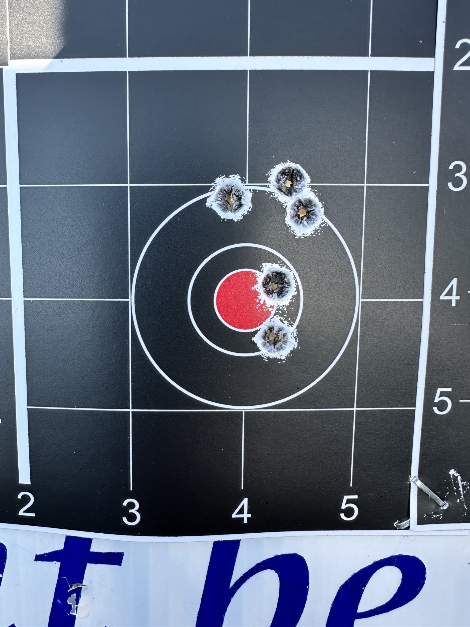

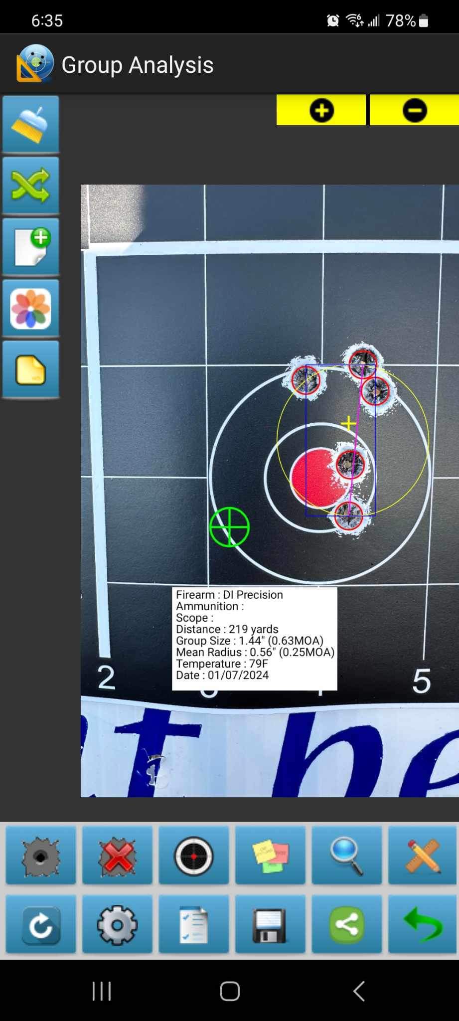

I finished my 2 year load development this weekend. I got side tracked by shiny new things in the Rimfire and Airgun world.
20" Osprey spun by PVA ( Heavy Palma?? )
Origin Action
Grayboe Phoenix
Hornady Brass, 41.2g H4350, Berger 135 Elite Hunter
Target was at 219y

The question is: how often can you duplicate those results?
That is also the challenge.
I understand that.
The load was repeatable for group on the next 5 I had loaded. I loaded 10 of each charge. If the numbers looked good I would shoot the second 5 to verify data. 41.2 was the one that was good. 41.1, SD 12.3, ES 42.6, MV Average 2497. 41.0 was close at SD 7.4, ES 19.4 and MV Average 2497.7. It was right at a 2" overall group where the 41.2 held tighter on paper. Waiting on weather and I'll see what they do at 400. Thats my max at the gun club. For a hunting round that the max I'll also have available to take a shot on game.
