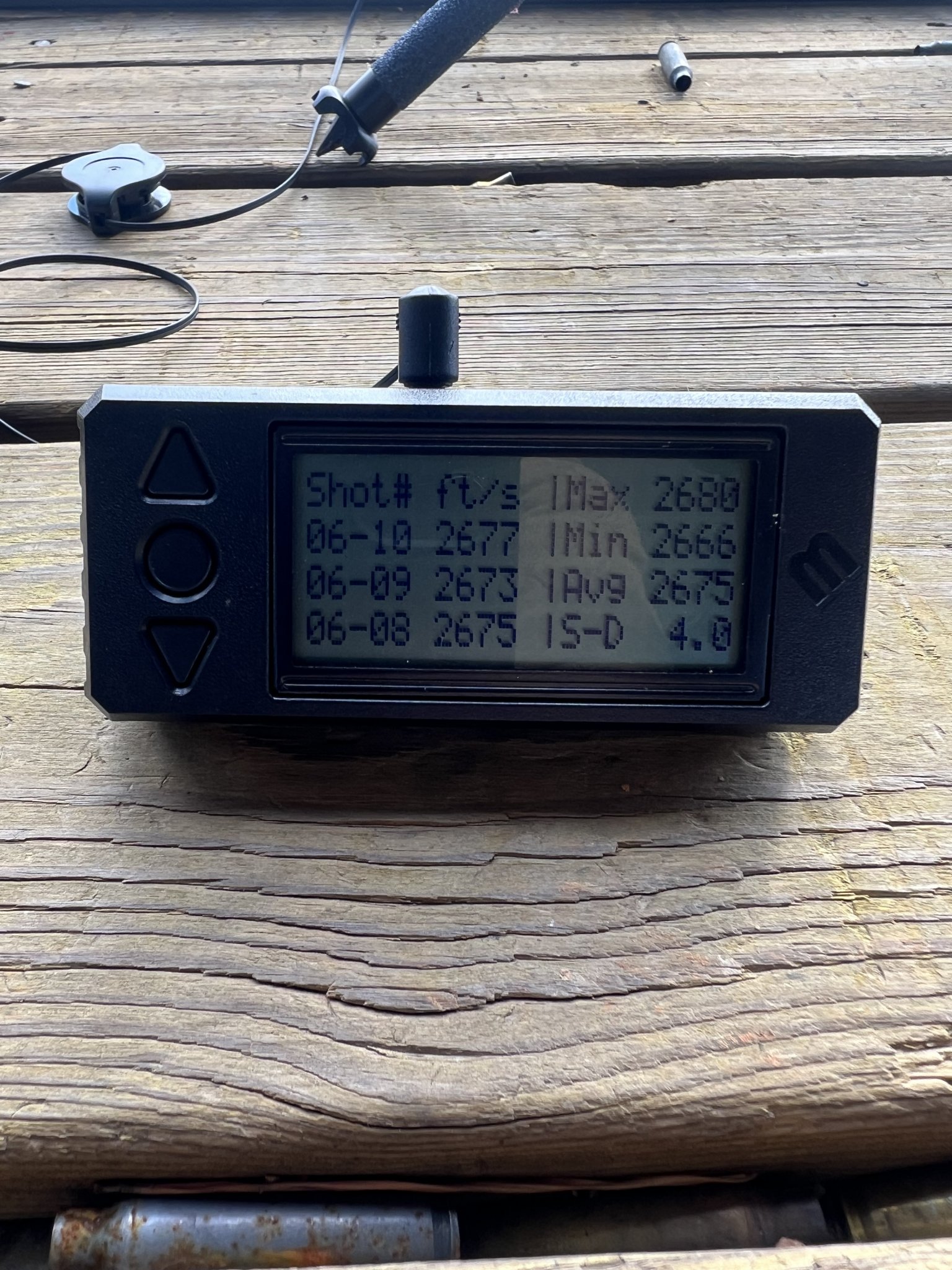

I’m getting 2675avg with Berger 156gr EOL, Lapua brass, 40.5gr H4350 and CCI 450’s. I’d say you have a ways you can still go.

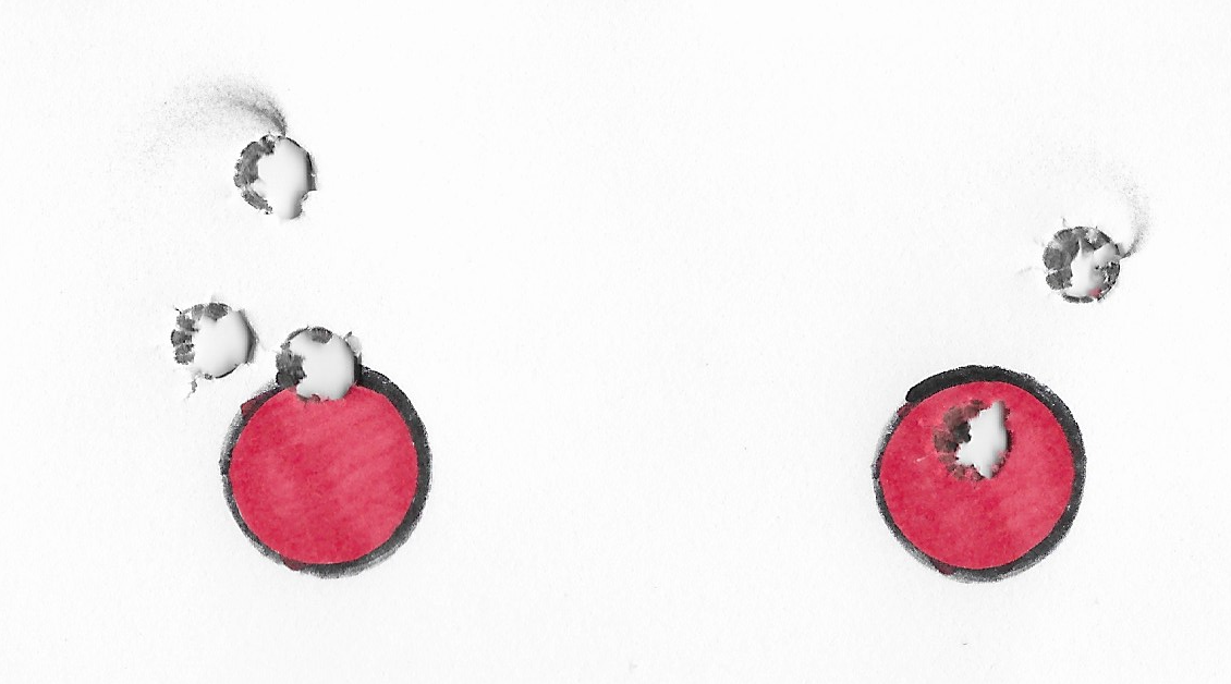

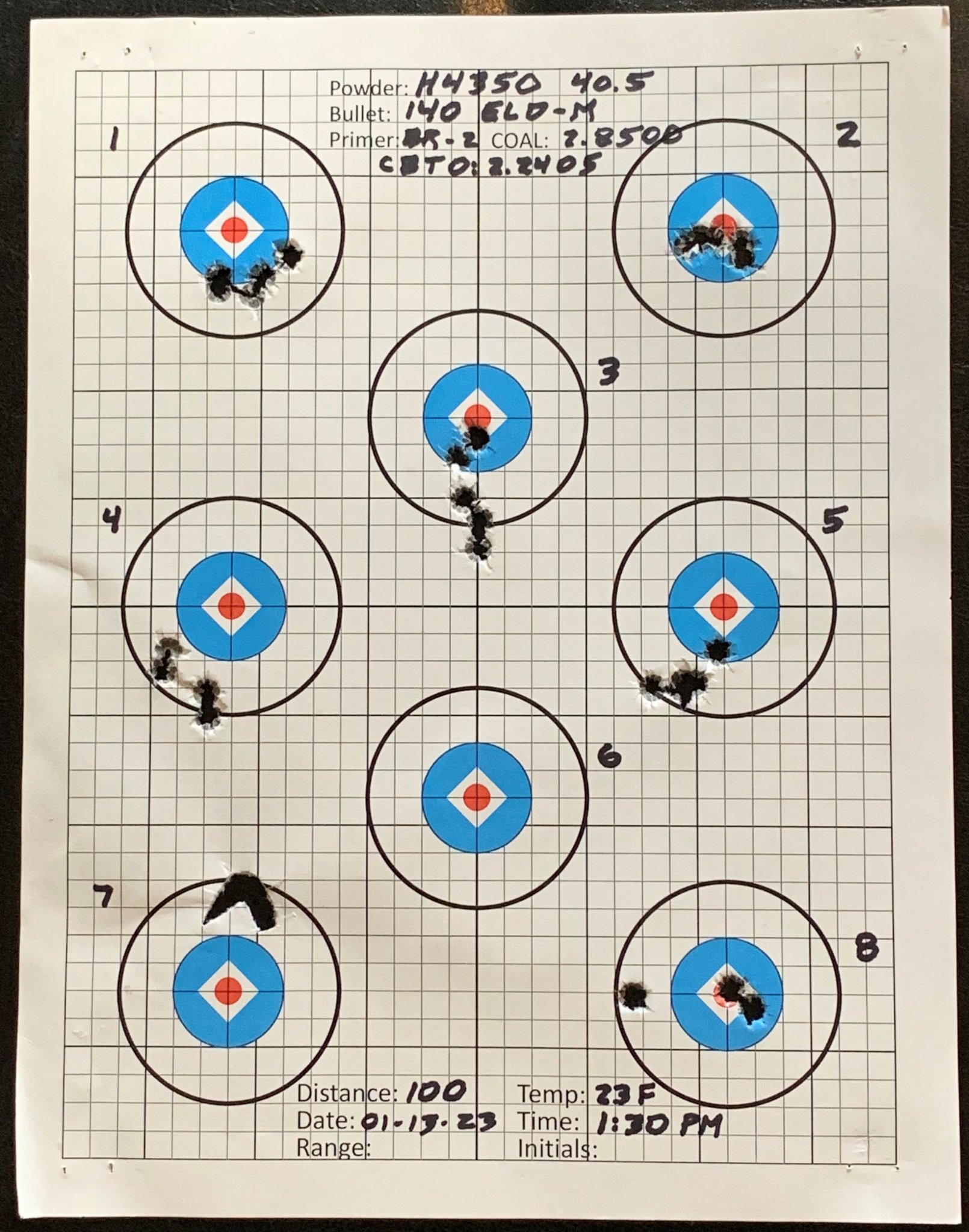

Attached is a target from my last trip to the range. (sorry, I wrote the year as 2023 out of habit) I'm looking for comments/feedback on what might have caused the bizarre hole on circle #7. I was aiming at circle #4 and one of those five shots ended up making a boomerang shaped hole in circle #7. There was another large hole above my target as shown in the second photo. I experienced a similar impact back in last November. The hole was nearly identical, perhaps slightly larger and shaped more like a block letter 'C' than a boomerang.

Notes:
  1. Rifle details: Savage Ashbury Precision Ordinance bolt action, 24" barrel, no muzzle brake, Magnetospeed chronograph attached to the chassis with an MK Machining mount. (ample clearance from the path of the bullet)
  2. H4350, 40.5 grains, Hornady 140 ELD-Match bullets seated to a CBTO of 2.2405". This works out to be a COAL of 2.850".
  3. Hornady once fired brass. Cleaned, trimmed, chamfered, deburred, and polished. Primed with CCI BR-2 primers.
  4. Bullets are seated with an RCBS MatchMaster micrometer seating die.
  5. These were not "factory second" bullets. These were part of six 100-round boxes purchased from a well known online reloading store in Texas.
  6. No visible deviations were observed in the bullet ahead of time. I weigh and sort the bullets to the 0.1 grain. Each bullet is handled multiple times, during sorting, during seating, then when measuring the CBTO dimension with my calipers.
  7. Muzzle velocities are in the range of 2640 ft/sec.
  8. It was 23 F outside, but I was shooting from an indoor shooting bench with the barrel sticking out a small window. Ammo went from my home to a car in a heated garage to the semi-heated shooting room at the range.
  9. The range's course of fire is to shoot for 23 minutes then take a 7 minute break to clear the firearms and allow people to walk out and check/replace their targets. During any one of these shooting intervals, I never fired more than about 12 shots at a reasonably slow pace.
  10. After a shooting break I would fire at least one round at a different target to warm the barrel back up.
  11. Circles #1 thru #5 are all 5-shot groups. The blue circles are 1" diameter.
  12. The five rounds aimed at circle #4 ranged from 2659 to 2621. Assuming the boomerang was one of the last two rounds, it was either 2659 or 2621.
  13. I think circle #4 was shot during the same shooting interval as circle 3. No more than 12 rounds during that 23 minute period.
  14. There is zero chance the boomerang hole was caused by a different shooter, ricochet or splatter from a steel target.
  15. The target backing was virgin when I hung my target -- no holes in it whatsoever. Notice large hole above where the paper target was.
  16. The vertical stacking on circle #3 had velocities of 2631, 2640, 2622, 2617 and 2615. At 100 yards those velocities shouldn't explain the vertical dispersion. Circle 3 was shot after one of the breaks. There was at least one warm-up round fired at a separate target prior to this group.
  17. Circle #8 was a 3-shot group with cartridges where the neck tension was so low I pulled the bullets out really far (prior to loading) so I was basically shooting with the bullet on the lands. (jam?)
  18. My rifle's cold bore shot tends to shoot .75 MOA left. The 9 o'clock round on circle #8 was my warm-up round. The next two rounds make me want to consider "jam" for all my future reload seating depths.
I welcome any feedback regarding this target and my results.

My first thought was an endcap strike. Since you said no muzzle brake, grab a flashlight and double check your magneto bayonet, just to totally rule it out.
I'm assuming the red outlined photo is the backer- If you zoom in, the hole in the backer looks like it has lead powder around it. I've seen similar traces around bullet holes on paper when they start coming apart mid-flight. Mine were distinct 'comet tails,' but yours looks like a lot more powdered lead around the hole, which could happen if the core sheds the jacket.
How many rounds on the barrel, and how clean was it when you started?
  • I will recheck the Magnetospeed the next time I have the rifle set up at the range. After the boomerang round I pulled the bolt and looked down the barrel. I didn't see any signs of the Magnetospeed's bayonet, but then again, I didn't shine a light down the barrel or perform any other clearance dimension type testing.
  • I did check and made sure the thread-protector cap was on tight.
  • Yes the red outline photo is the backer. I included that photo because you can see lead marks on all the impacts, including the two boomerang shaped holes. Or are the black rings around bullet holes just powder marks?
  • I've got around 1100 rounds through the rifle. Last cleaned about 100 rounds ago.
How common is it for Hornady 140 ELD-Match bullets to break apart in flight? I searched online earlier this week but did not find anything meaningful.
Check the magneto now and see if you have any skip marks.
I'm talking about the lead 'dusting' around the boomerang hole specifically, not the rings around the regular bullet holes that are nice and round.
I'm not sure how common on the 140s, but I've seen 147s go poof. There used to be video here.
Have shot thousands of 140 elds in multiple rifles and never had one come apart. It must have hit something mid flight to do that. Were you aiming at that target when you saw it go in like that?

That entire 5-shot group was aimed at the red dot in the center of circle #4. The range has a clear path with no obstructions between the shooting bench and the targets.

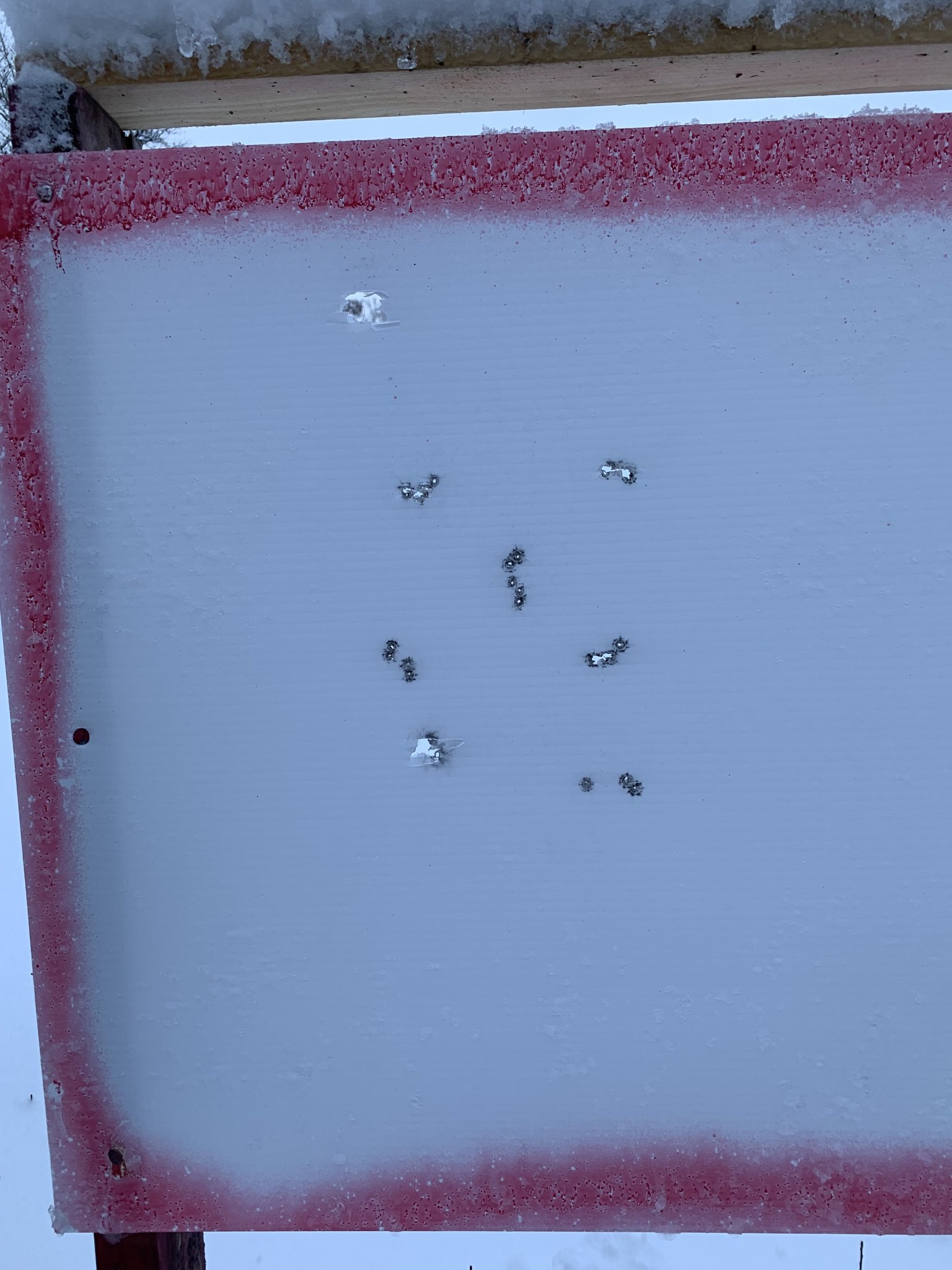

The two extra large backer holes are curious. Here's a target snip from one of my old 6CM barrels - the lead comet tails made me suspect it was damaging jackets and I pulled it- the throat looked pretty nasty on the borescope. Your bottom hole in the backer made me think of it since it appears to also have the lead dusting.
I was asking as I was wondering if that hole is from a round that went through the target and ricocheted off the backstop and went back through the target from the back. Just never saw a bent round hit a target before. Sideways yes but bent in half no.

Never happened to me, although I do remember something about that happening (not sure Hornady though) with high spin rates and fast MV’s
There is an earthen berm several feet behind the target frame. No steel or other flat surface to cause a ricochet. Whatever made the boomerang shaped holes definitely went through the target from the front. The torn corrugated material was bent/folded backwards.
No rocks in that earthen berm? If not, no clue then. Very odd as bullets don't bend mid flight. If it came apart as people talk about then you will see a poof and it disintegrates. Doesn't bend in half.

Thanks guys. Using IMR 40.8g, Fed primers, Hornady brass and getting 2711 FPS out of my Bergara LRP with Dead Air 30 on the tip. Like you said, every lot of powder has its own deal. I have not seen an issue with temp issues and living in AZ. But we are now doing a lot more chrono so maybe this summer we will detect an issue.
