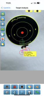

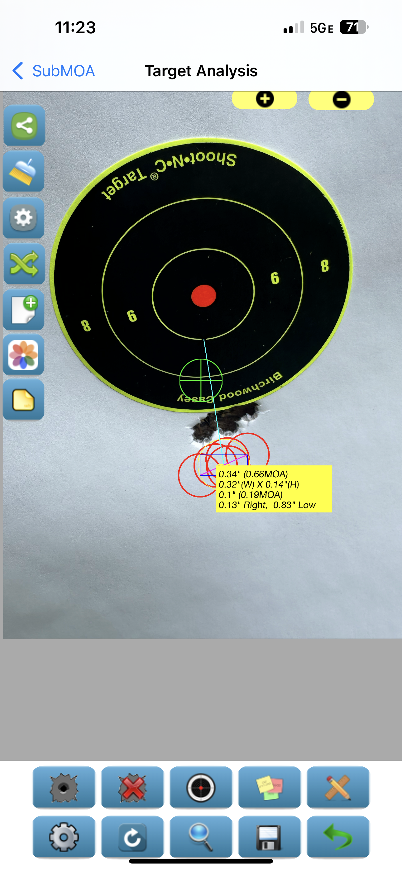

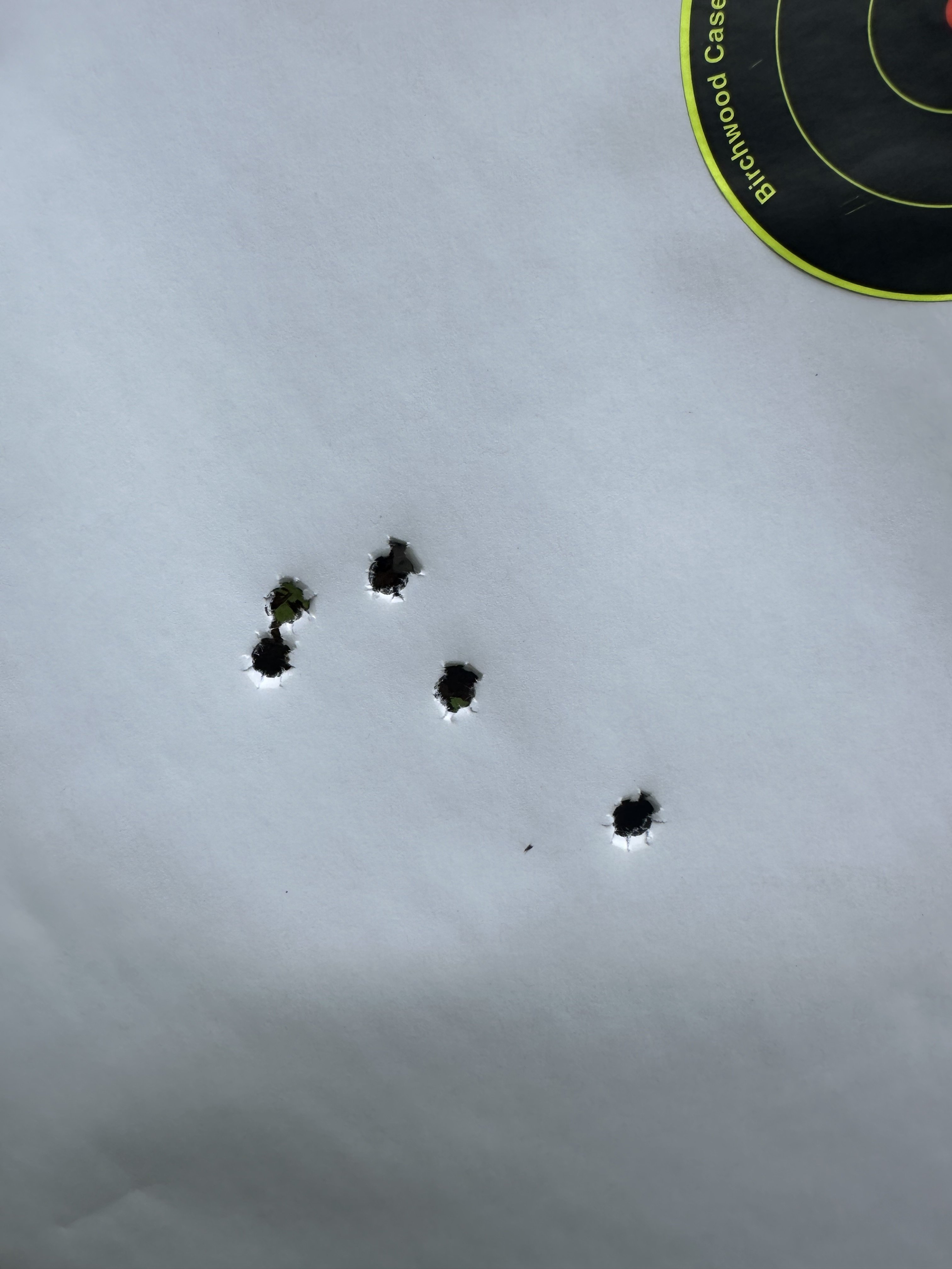

The first is the virgin brass, the second with the same load but with 2 firings on the brass. The rifle is a 700 action with a criterion barrel. I don’t have the headspace measurement, but I ran Pacific tool and dies headspace gauges through it when I was putting it together. I’m running the bullets at magazine depth, which is 2.83 and I do not anneil.

Question on Brass. I picked up some Norma Brass for my new 6.5 Rig, Running 34.2 of Stabol 6.5 with the 147ELD Match. Virgin Brass is incredibly tight groups, I get 2860 from a 26 inch. I then FL resize the brass and the groups open up a lot. IS this indicative of Norma brass or of 6.5. The reason I ask, I have Alpha on my 6 Dasher and im on the 6th or 7 reload and not a change in group sizes. Any thoughts?
What was the velocity difference between the batches?
I would look at:
Headspace on virgin vs fireformed vs sized
Neck tension on virgin vs sized
Same lot powder and bullets?
Humidity your powder is stored at? I prepped a bunch of hornady brass for my 6.5 for the first match this season and had some left over so I loaded up enough for the second batch and shot 3 of each batch. First was at 2615 with a es of 4 and the second batch was 2650 with an es of 8. Only thing that could have been different is humidity in my reloading room my powder is stored in. This was staball 6.5.

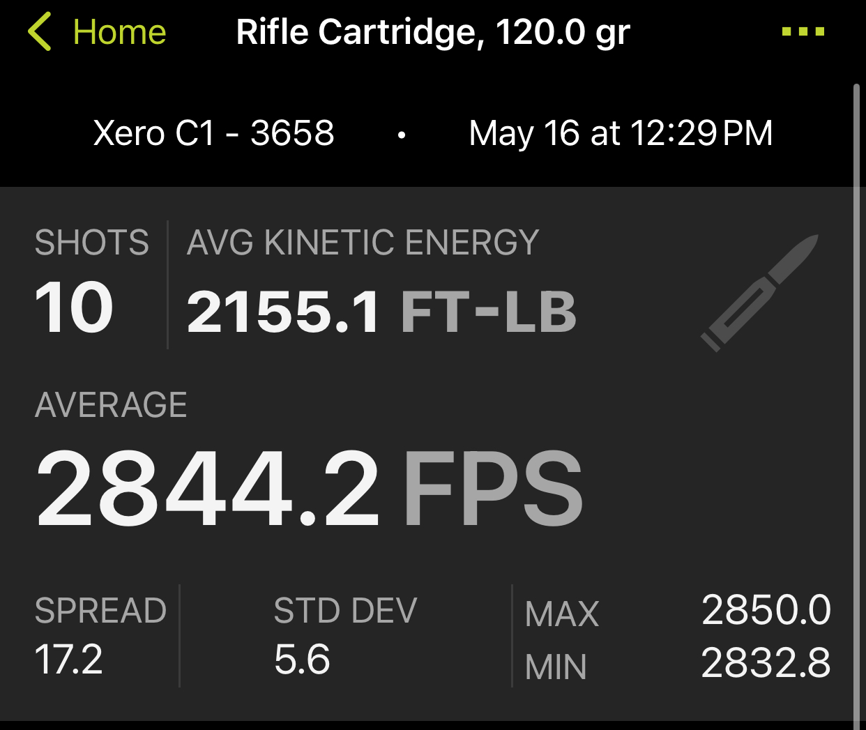

The hornady book max load of 120 ELDM with H4350 is the best shooting load out of every 6.5 factory rifle. 10 shots into a dime at 100 yards out of my delta 5 pro. Seat them to whatever it says in the book and you’re good to go. I use SRP starline with CCI 450.

What does 44.0gr. of H4350 and a 120 ELD clock on your Rifles ?. I don't use 4350 for 6.5 CM , so just curious as to Fps. ?.
I've been sticking with N540 & N560 ,so was hoping to compare velocity .

Yea seems a touch hot but may be lot dependent. I just did 42.8 of H4350 with 120 ELDs, 2913 out of Tikka 24" which are known to be slow barrels.
With a brake had some significant snap/blast to it. With CCI 250s brass and primers look good though, might just barely be starting to flatten but nothing super noticeable.
Either way these bullets aren't great out passed about 1k yards anyway so I don't see the need to run them on the ragged edge. Similar wind holds to a 308.
