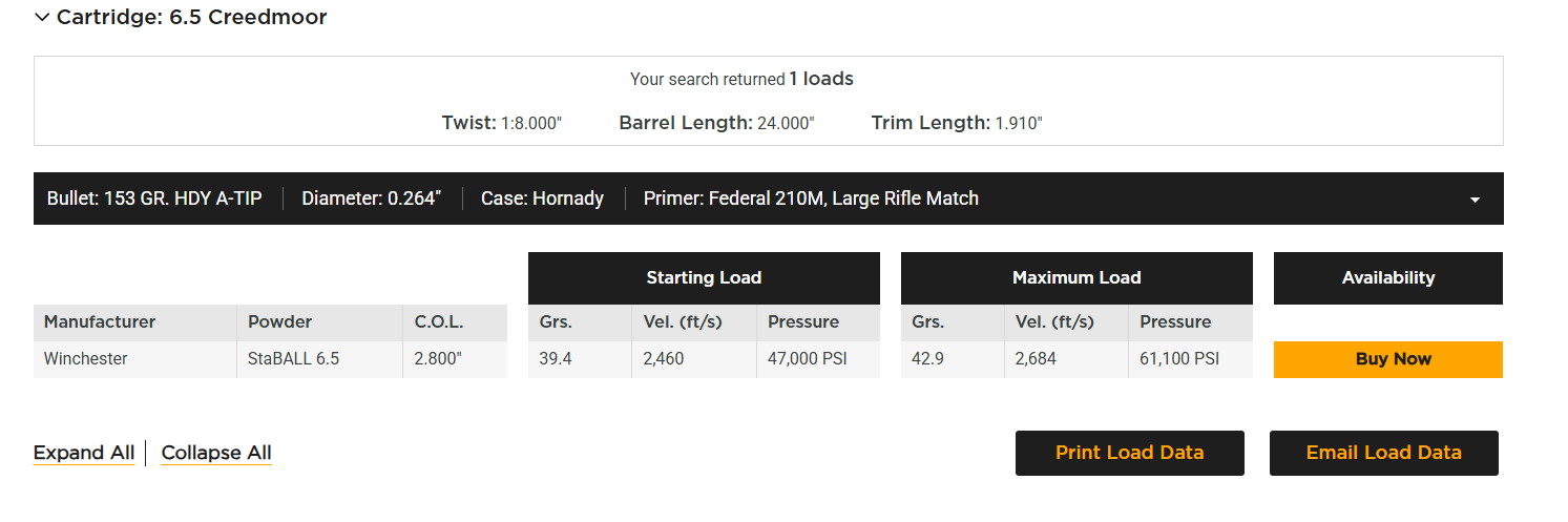

Seeking load data with Staball 6.5 and 153.5 Bergers in Starline brass.
If you were to workup a ladder load in .5gn increments for 6.5CM what would your window be?
Start at 38.0gn and go up to ???
I just did this with a new barrel using:
H4350 and Berger 140s and got heavy bolt lift around 41.5
I will try to get speeds this time around as well.
Question regarding the Hodgdon loading data. I entered 140g bullet and it gives a max load of 40.0gr. I'm using 1x fired Hornady brass for the time being as I had over 1500 pieces. Most of the load data I found was using over 41 grains, I have been using 41.2 for the last couple hundred rounds. The data Hodgdon gives seems low or am I most likely using too much powder. I'm averaging about 2805fps with a suppressor (less without) and nice grouping so pretty happy with the results. But, I'm new to reloading so lots to learn. Using H4350 and Berger 140g hybrid target.
So most reloading data from a manufacturer is going to be conservative for legal reasons.
Hodgdon's listed max 40.0gr load is also listed 59.2K PSI, or about 3K less than max SAAMI pressure (and many people will go over that by a bit and still not see pressure).
As long as you aren't seeing ejector marks, smears and otherwise damage to your brass, I think that 41.2 is fine.
