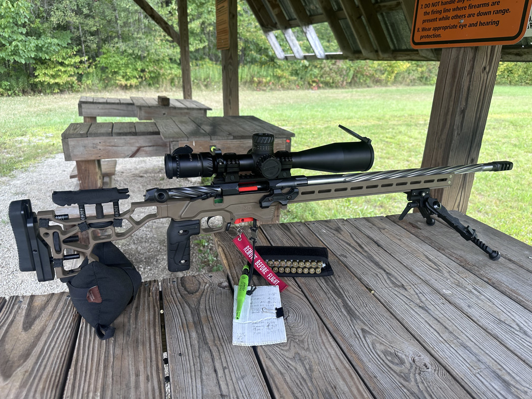

Hello all, i have an mpa pmr in 6.5 cm 26" and was wondering what the pet loads are out there using h4350 and 147 eldms? Oh, i also have staball 6.5

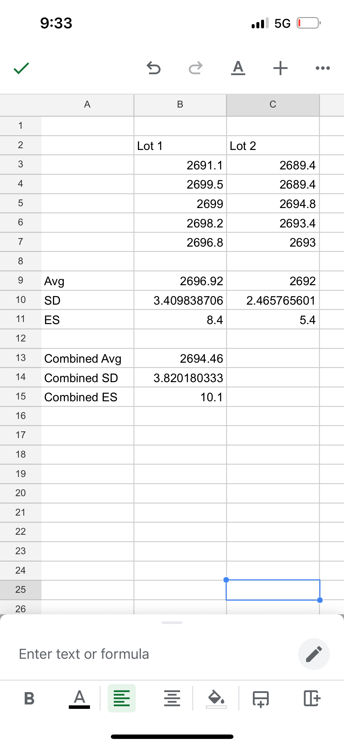

Just for fun since I tried looking it up and didn’t see any data on if mixing lots of Lapua Brass matters. I have 400 Lapua srp, 2 different lots that has all been fireformed and was trying to determine if it was worth the pain of keeping it separated. Lot 1 is about .5gr lighter than the lot 2 brass. So I took 5 of each and loaded them up with the exact same load and round robin’d them. Not a huge sample size, was just curious.
40.0gr H4350
140gr eld-m
CCI 450
Group size was slightly better on Lot 2. I will probably end up mixing them after the next firing.

I just made a thread about this maybe a month ago. I didn't count, but I think I had about an even split on replies.
I would say try 20 shot groups with each to determine.

Or 4x 5 shot groups. I just don't think one 5 shot group is indicative of how that brass/load will perform.
Remember, once he mixes those 2 lots, he'll never be able to tell them apart.
If his groups start to open up or have random fliers, he might be questioning his decision to mix them. At least I would lol. It would drive me crazy knowing I mixed them without doing a bit more extensive testing other than one 5 shot group with each brass.
That's the point of view I have. Though he already mentioned that for his needs, mixing them won't matter.
With the difference in his shots I wouldn’t sweat it at all. I’d load some and shoot them at longer ranges, at least 300 yards, and see how the groups are and how they waterline.

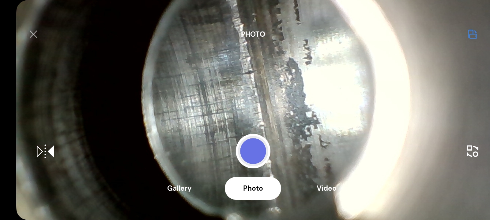

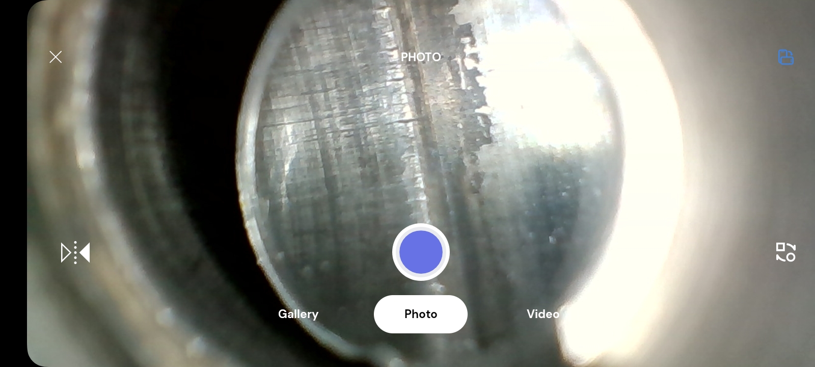

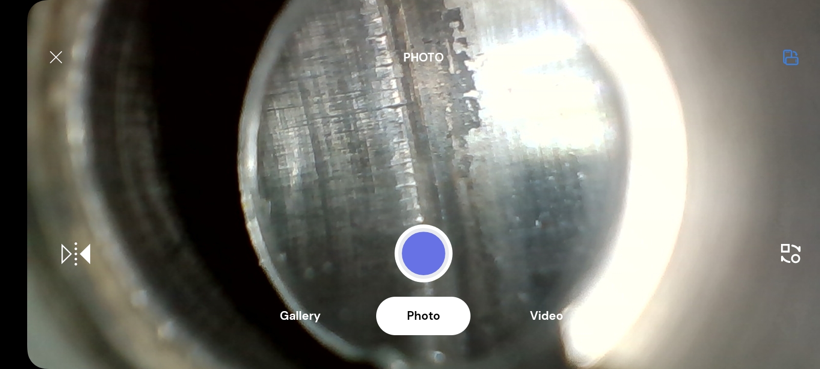

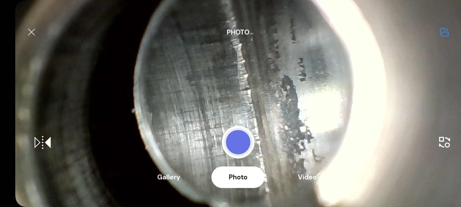

Anybody have any tips on getting this carbon ring off. Rifle is right at 399 rounds with one cleaning in between. I don't remember how many rounds when I first cleaned it. I've left a patch soaking overnight multiple times already and no luck. I've been using boretech eliminator.
View attachment 8766936View attachment 8766937View attachment 8766938View attachment 8766939
I just went through this.
What issues are they causing? They don’t look too bad. Do you use a bronze brush when cleaning after a soak with a good bore solvent?
I do use a bronze brush. I think this last soak from last night until right now helped getting some of it off.
I've been having clickers and poor accuracy. After speaking to a few members here, one very knowledgeable member has advised me it might be a pressure issue. So just to eliminate one thing at a time, as a process of elimination, I wanted to rid my barrel of this carbon ring.
I was not successful doing so, and since I'm only in town until tomorrow, I will go try some new loads tomorrow and see what happens. The carbon ring, coupled with a potentially dirty chamber, may have been the root cause. I know if the chamber is dirty, it'll cause the case to want to stick due to friction. My suppressor has become pretty dirty. As a result, some small chunks sometimes end up making their way to my chamber and bolt face. My idea was to get everything as clean as possible and start a new load workup. If my issue persists, I now know I can look somewhere else.

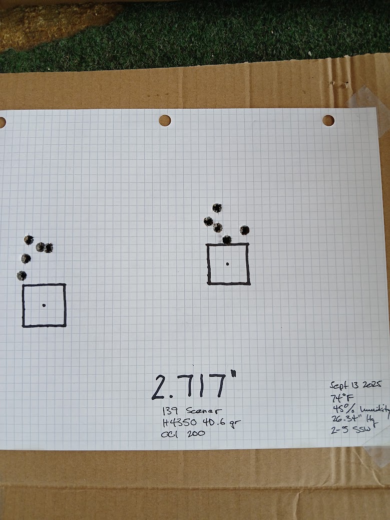

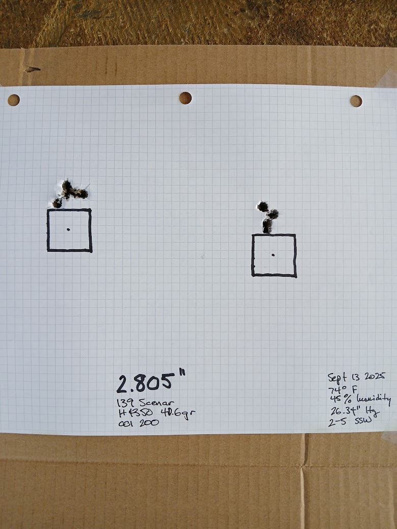

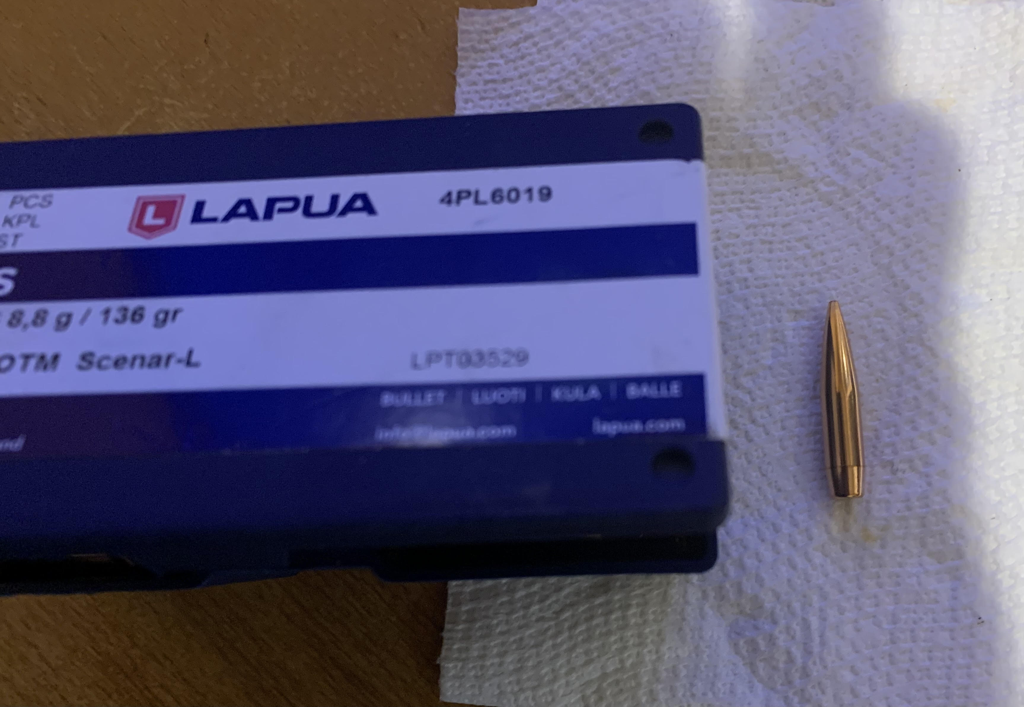

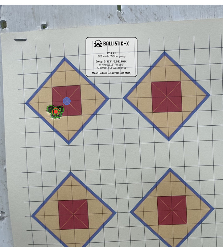

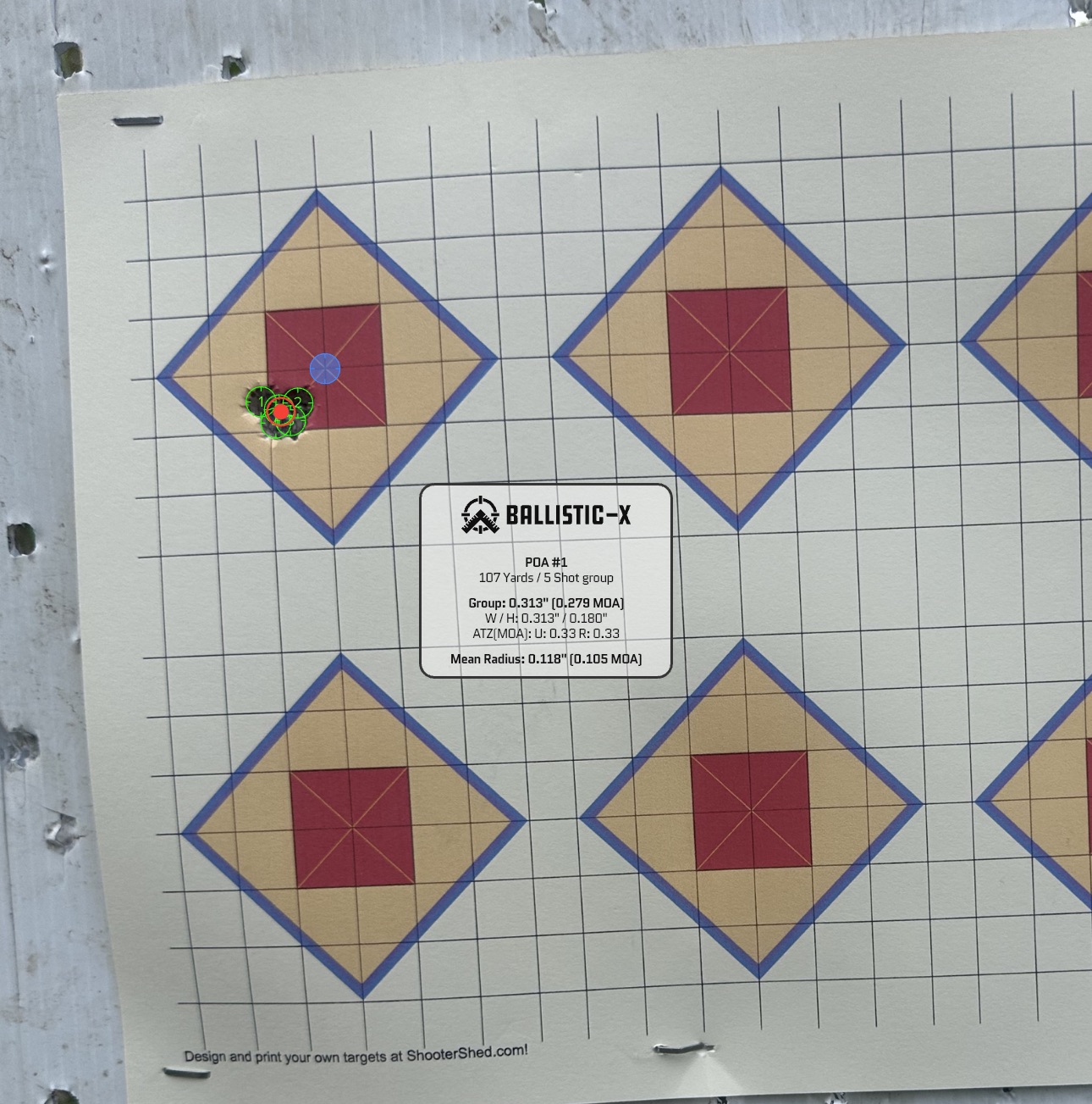

More on Scenar 139 and H4350.
Colder slower node at 40.7 identified in GRT, so I loaded some at 40.7 gr and 2.805" COAL. These turned out nicely but my trigger and rear bag work were lazy on 2 of the 3 sets of 5. The better set produced this:
For the full 15 rds with this 40.7gr load, velocity was 2709.2 fps AVG and SD was 7.0 fps.
I plugged that result into GRT for OBT truing and was suggested 40.6gr. So today I tested 40.6 gr in 20 rds. 10 were loaded at the same 2.805" COAL already underway. The other 10 I tested at the Lapua web site's suggested 2.717" COAL. The seating depth differences were pretty big on paper.
For these 10 rd sets, the 2.805" COAL went 2671.8 fps AVG with 12.4 fps SD. The 2.717" COAL went 2662.1 fps AVG and SD was 13.9 fps.

Bronze or brass chamber brush ,ISN'T going to harm anything . Best chemical cleaner and recommended is ;
ARMAKLEEN™ M-100 BCR (Baked on Carbon Remover) is a specially formulated low pH cleaner that performs like a caustic cleaner without the use of free caustics. M -100 BCR is a safer aqueous cleaner designed to attack and remove baked on carbon and other heavy soils from steel and soft metals like cast aluminum engine blocks and other aluminum alloy components.
Also : C4 Carbon cleaner . Either product works really well by doing two things .
A : make yourself a rack to hold your rifle or rifles with muzzle down . B : Buy a Viton ,Neoprene or EPDM either tapered or as I prefer pull plug . Stop muzzle end ,add cleaner via chamber end slowly and carefully ,so as NOT to spill it on your rifles finish . Use a flashlight or strong light and stop at chamber lede . When finished drain from muzzle end ONLY ,into a large enough container . You can reuse cleaner over and over ,simply via a small funnel return it to it's container . You can even filter using paper towel or coffee filter ,ceramic if you have one . I recommend wearing Nitrile or rubber gloves ,when draining as it avoids hand contact which is inevitable given how one has to pull the plug inside a bowl or container .
Either type work ,I simply prefer a pull plug ,so muzzle crown remains protected and sets down onto the plug .
Below strictly illustration purposes only . Various supply houses sell normally #25-1K packages ,you can check other sources
Pull plug ,if you're not familiar : https://viadon.com/products/caps-plugs-and-corks/epdm-pull-plugs
https://store.mocap.com/mocap_en/mep.html?Item=MEP.250/437
Once a Year I clean ALL MY fired Rifles chemically and then neutralize solutions before proceeding to use bore solvent a mop and nylon brush ,along with patches to dry and ensure cleanliness . IF I'm not using a particular rifle for awhile ,I'll swab with a 50% mixture of Hoppe's and BoeShield T9 . Fyi : I've some safe queens which I've swabbed the bores and applied Boeshield T9 too outer metal and 2-58 years not a spot of rust on any of those . Before Boeshield became available , I used to use Mil bore solvent and Weapons oil and the Safes wreaked of foul smelling concoctions .

Thanks for the recommendation. I have ordered some c4 to try out.
