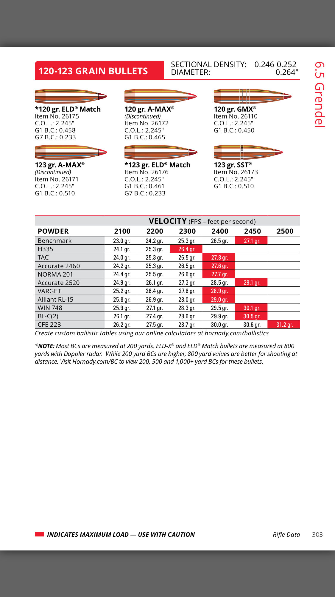

I loaded up some death pills last night, 27.8 grains - 28.2 grains of varget on my 65grendel. Only issue is I am using the longer 120 gmx bullet. I loaded to an overall length of 2.244.. all of the above per the Hornady reloading manual. When pressing everything there is some crunchyness going on. Is this normal? Thx AOG
Looking at hodgdon’s data site, they don’t list Varget in any of their loads. They’re in the h322/benchmark/h335 range with the 120’s, and they’re compressed or nearly so with those powders. I’m not surprised that Varget is crunching. Where’d you get the data from?
Good question straight from the Hornady book.. it lumps it in with the shorter length 123 gr sst.. see attached

It's possible the cases they used had higher capacity than yours. Still, you're well under their published max. I wouldn't worry about being slightly compressed. You still have .015" of seating depth to play with before you hit the maximum coal for an AR mag. You could always reseat the bullets to a coal of 2.260" if you're worried about it.

Varget is a poor choice for Grendel powder. You'll run out of case capacity long before you get close to the max charge weight for pressure. Expect to be 200fps under the full potential for the cartridge.

Good input.. yes I have heard this.. 20 inch barrel and 28 gr of varget got me 2400 FPS. What would you recommend instead? Would love xbr8208 but it’s sold out everywhere.
