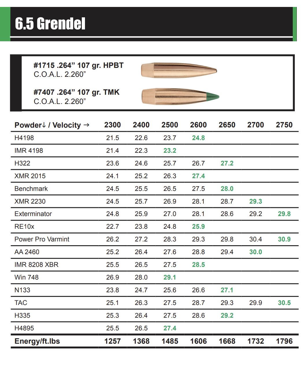

anyone shooting the 107 SMK's?
I tried them with Ramshot Tac, couldn't get them to shoot well and gave up on it. I was looking to use it as a gas gun for PRS matches but built a bolt gun instead so I didn't put too much time into it. Sierra lists the highest velocities with Tac and a couple other powders I haven't ever seen.
107 SMK
29.0 gr. of Reloader 15
CCI 450 primer
OAL=2.27
Typically turns in 3/4 MOA. I'm running a 24" barrel with rifle length gas. Reloads done on Hornady New Dimension dies.
Thanks .. I'll give this a try. I just picked up 1,000 and only have about 75 123 scenars left.
I have about 1/2 -5/8 of a pound of Tac left.... I'll try it ... I'm a bit nervous it works out and I won't have any left!
