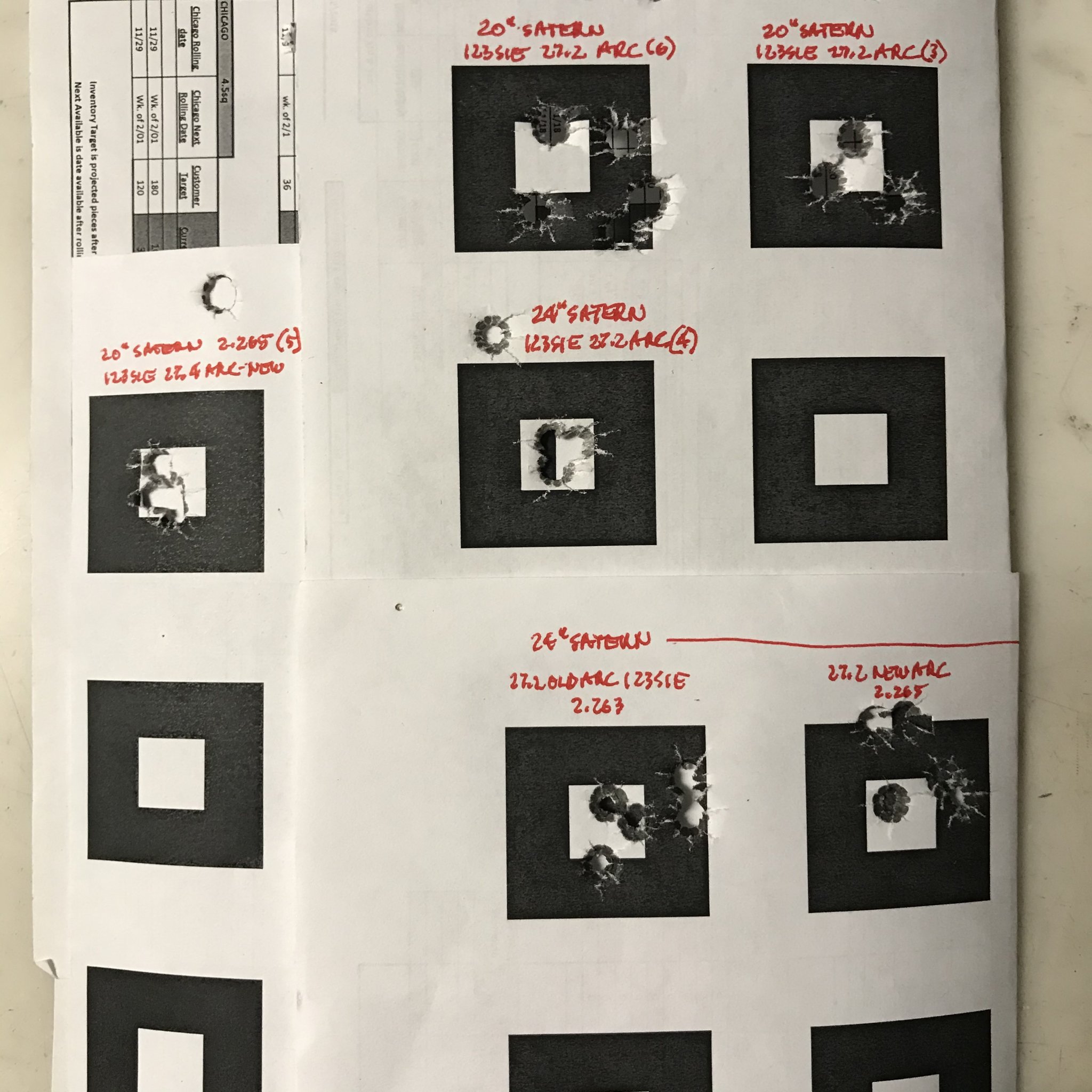

I am just beginning my 6.5 grendel load development journey, and experienced something odd.
I started testing with 123gr sst's over cfe223, hornady brass, and cci 41's. First 4 shots grouped around 1.5 inches. Not great, but for a new barrel, not concerning. The longer I shot, and the hotter the barrel got, the worse it shot. The fifth, sixth, seventh, and eighth 4-shot groups were six inch+.
Gun specs:
24" ss fluted 1:8t BCA barrel
home built lower with aero precision lpk
Larue mbt-2s trigger
After my terrible first outing with the rifle, took it home. Disassembled the upper(thought the gas block was contacting inner handgaurd), lapped the receiver, bedded the barrel extension, replaced gas block with a superlative arms agb, and changed muzzle device to a dead air qd brake.
Took rifle back to the range this past friday. Shot the same 123 sst/cfe223 load. same result. now I'm thinking my scope is shot. I figure, hell, I'm already here, let me try a different load. I had some 123 eldm's over IMR8208. Shot them. DAMN. It was like a different gun. Out of 8, 4-shot groups, none were larger than 2 inches, with a couple just slightly over 1 inch, something I can work with.
It is just amazing to me, that with so many people having great success with cfe223, that it would be THAT bad in mine. I even shot some 130 eldm's over AA2520 that did much better than the first bunch.
Has anyone else experienced anything like this?

Yes sir, you are correct. That's why I develop loads for EVERY weapon I shoot. I've been hand loading for about 26 years now, but I've never had a powder exhibit this to this extent.
As far as the charge, started at 29.2, up to 31.3. Seated at 2.250". New hornady brass.
I may try the bullets with another powder, but I think I'll not waste the primers trying cfe223 with anything involving MY grendel.
I was trying that exact load, cfe223 / hornady brass / hornady 123sst at 2.245 coal .
My gun was grossly over gassed.
I also had too much neck tension.
None of those groups up to book max were over 2 inches or under 1 3/8.
Got a new agb and forgot to torque scope. (Now those groups really sucked)
I experimented with light weight fill in my front and rear bag. (Sucked)
Anyway cfe223 does not like to be compressed.
I had to use +2 buffer and flat wire spring, was getting false pressure signs.
New set of ocw loads comming soon. Lol

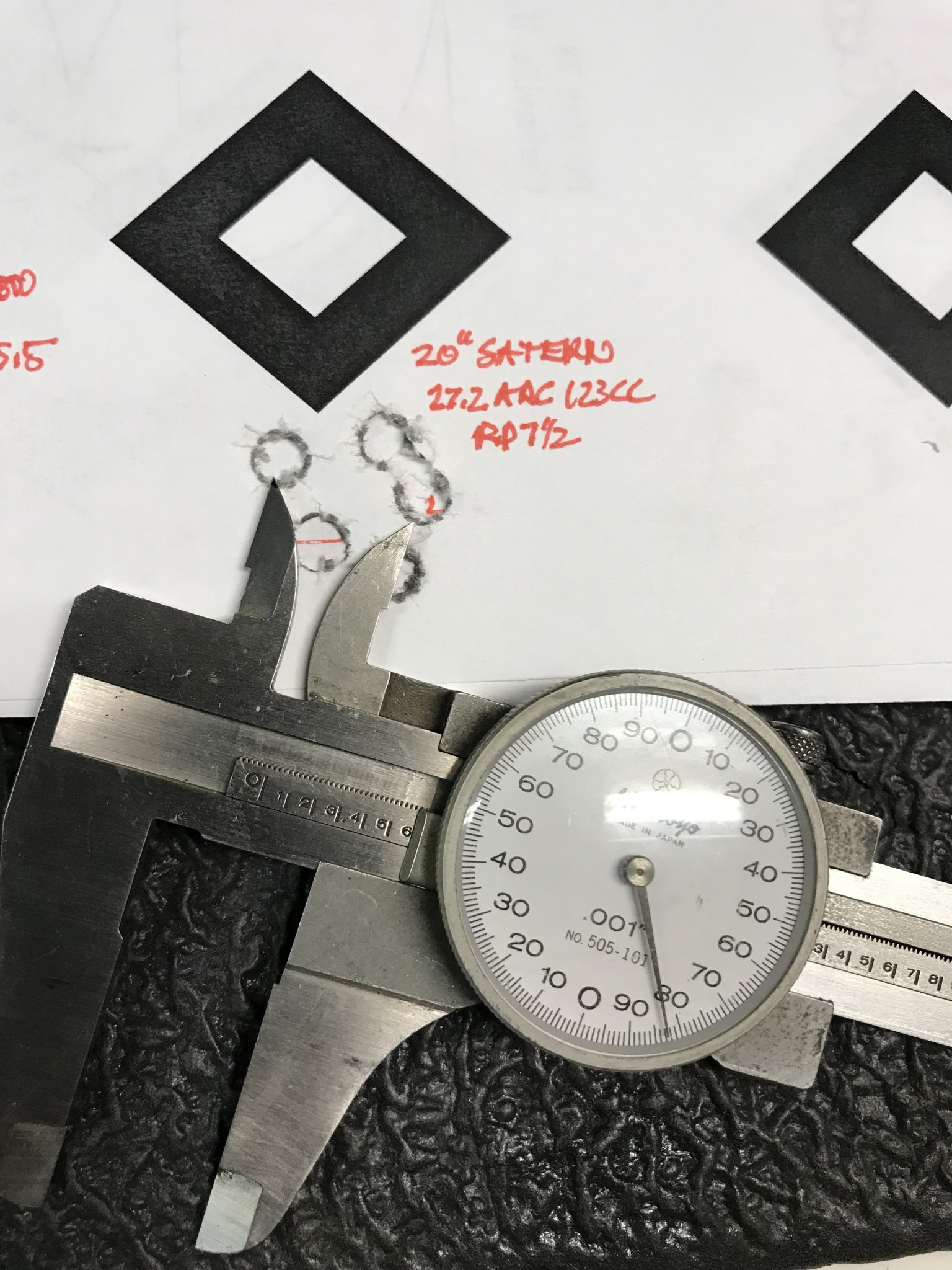

What i found with IMR 8208. A chrono is your friend.
I’m using CFE223 for my 6.5G and it is grouping at .51 MOA. I load 31gr, with a Hornady 123gr SST in Hornady brass. Use CCI primer #41 with a O.A.L of 2.27.fits in my mags with no problem and this is out of a 20” BCA stainless barrel. Tried XBR8208 and it just wouldn’t group small then 2”. Wanting to try AR Comp now that I have a pound of it.
I use 32,0 gr of CFE223 with the 123 SST out of a 20" barrel. Yes its definitely pushing it, but need the speed and it provides decent accuracy. Likely throttle it back a bit when this batch runs out. Maybe find a better accuracy node in the process.
When using CFE in the past, was easily getting 2550 in 20” Satern cut rifled barrel and 2650 in 24” Satern cut rifled barrel with 123 CC’s, 31.7 CFE and CCI 41 primers in Hornady brass. And is a compressed load-tough on brass, throat and gas port, but accurate. Backed down to 31.4 and once more to 31.2….and then started working with 8208 and AR Comp. No real issue with 8208, as it’s VG in 223 and lighter bullets in 308. That said, now almost exclusively AR Comp based on its flexibility and accuracy. Five shots fired in rapid succession with 123 CC’s is very representative of results-maybe a bit better with 120/123 Lapua or Sierras. About 2525 at 85-90d.
View attachment 7671678View attachment 7671690
