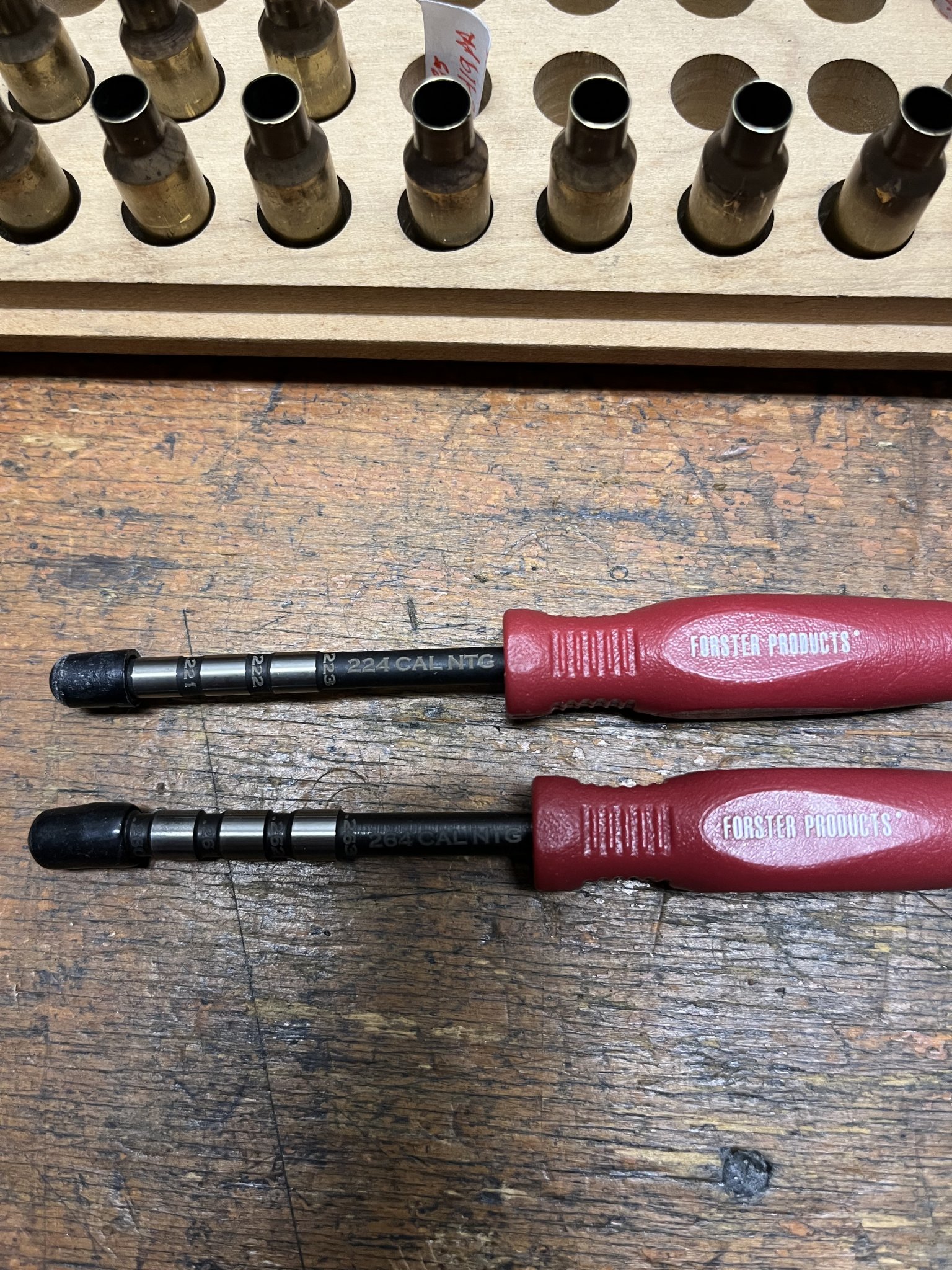

I tumble, anneal every firing cycle, use Redding lube on exterior, Redding Imperial dry neck lube on interior, and have migrated to Forster FL sizing dies and Redding carbide mandrels for case prep, and Redding Comp seating dies. Very low runout, .002 neck tension, excellent SD’s and accuracy. Shoot a lot of 120gr Scenars and no bullet marking.
One more thing-I feel pretty confident with my process, but as a double check on neck tension, even after annealing, I use a Forster neck gauge, and have found in some instances, another pass on mandrel required to assure even neck tension. If you’re not annealing, neck spring back could be yielding more grip than you might expect.

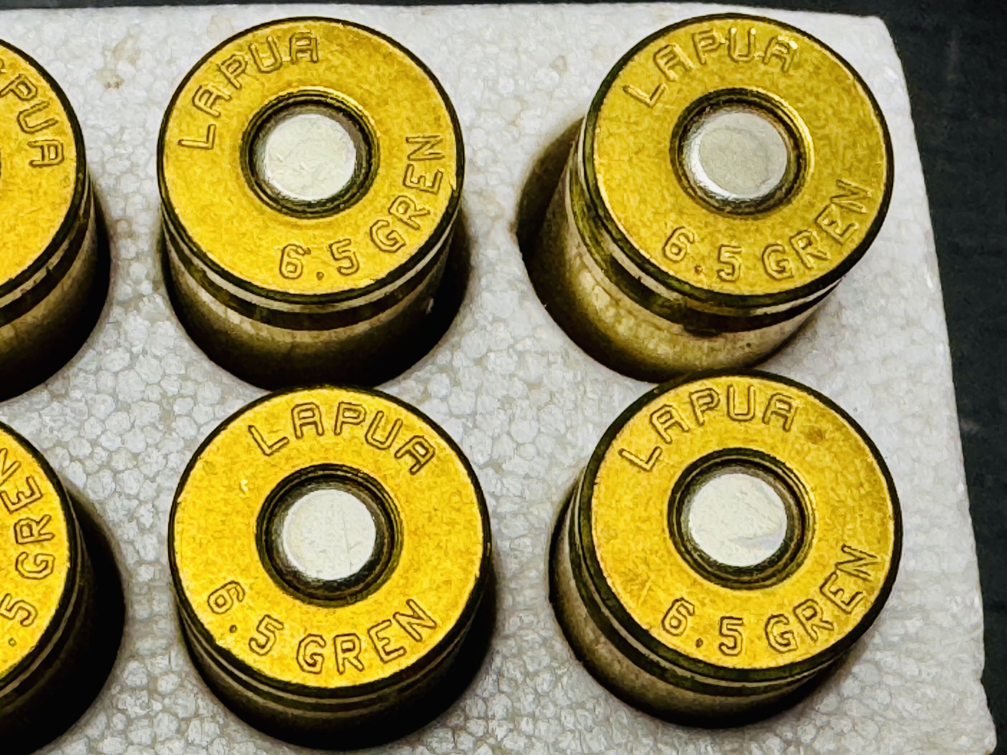

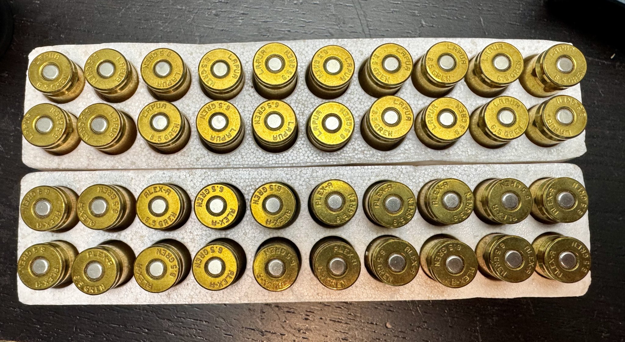

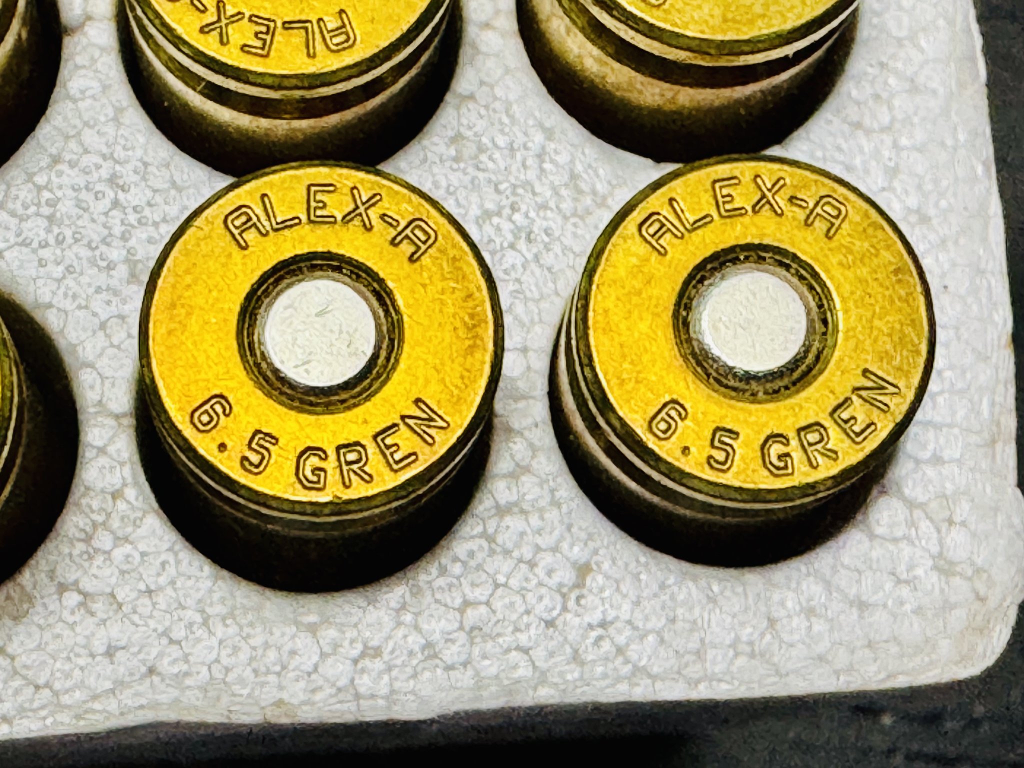

Was digging through a box of brass and found 100 of these, anyone know if Alexander was using Lapua Brass?
I have 500 or slightly more pieces of AA brass. As I also have hundreds of Lapua 6.5 Grendel brass to compare it to and I can say the older AA brass is Lapua. I've weighed it, annealed it, sized it, sectioned it, shot it, converted it to 6mm ARC (I'm a glutton for punishment), and loved it.
I do not have any knowledge if AA changed who make their brass. Hell, I don't even know if there is currently any new head stamped AA brass.

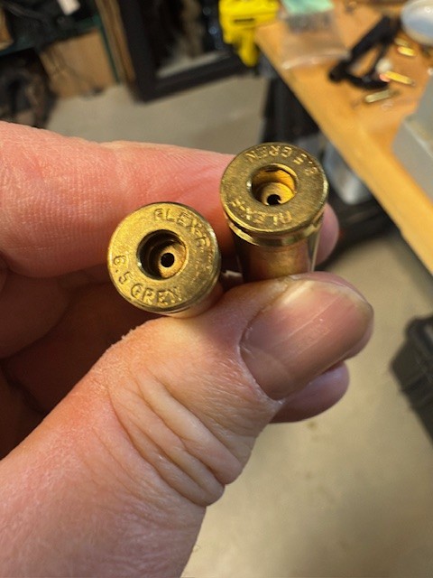

If you have any Lapua head stamped 6.5 Grendel brass, compare the flash hole between the two. All of my AA brass has the .062"ish flash hole just like Lapua head stamped stuff.
Not that you asked, but AA brass was what I started with in 2010ish. I lost a few pieces over the years to enlarged primer pockets but more to split necks. Those pieces were fired many many times.
I had AA brass on back order a few years back. The first 100 came as the AA stamped Lapua that it always was. The other 400 came about 2 months later and was Starline in an AA bag. A little disappointed but is what it is. I haven't ordered any from AA since so I dont know if they were using that to fill the gap or not.
