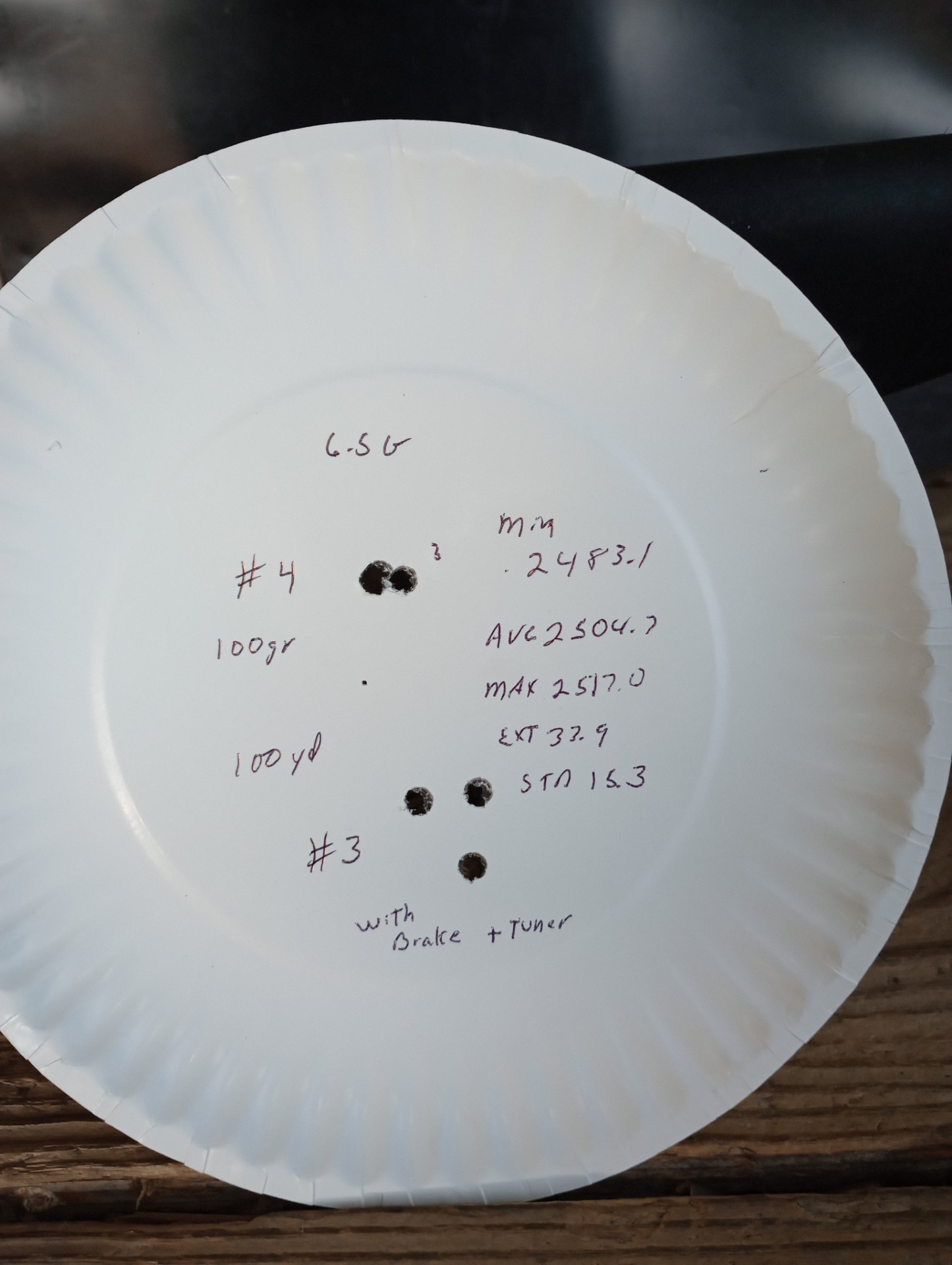

What was the wind doing during this series ?
very light wind . from the left shooting north.( note the shot placement on paper) when I went to the 400yd bong ,aiming center ,it was hitting center .
I don't want to hit the pin when shooting for grouping , that's why the paper group is off to the side of the pin.
ya but I have to try. it could be how deep the bullet is set , it could be 1/10 more or less powder it could be a new mark setting on the tuner could be the use of a different primer
Could just be me but 0.3g increments till I get a group, not a string iether direction as fast as is necessary.
Then I bracket the best one in 0.1g incraments .
Shoot them on one sheet each session and you can see the string go clover / round.
Then you can go to seating depth in 0.003 thousands or jump to tuning if you're in a hurry.
The tuner will fix the string to a degree but it will be a narrow node.
If you find a round node and tune it there will be a more stable group.
If you can do a seating depth test before you tune it will be even better .

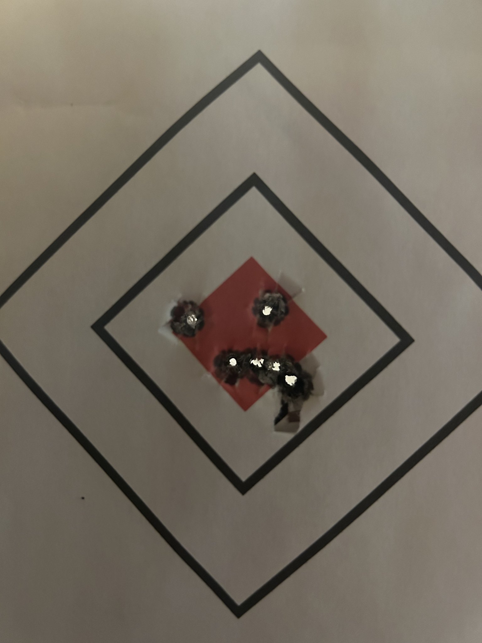

123gr SST loaded in hornady brass, CCI primers, TAC powder. I’m pretty happy with how this performs on this shorter barrel. I want to try it out of my 20” here soon to see what kind of speed I can get.

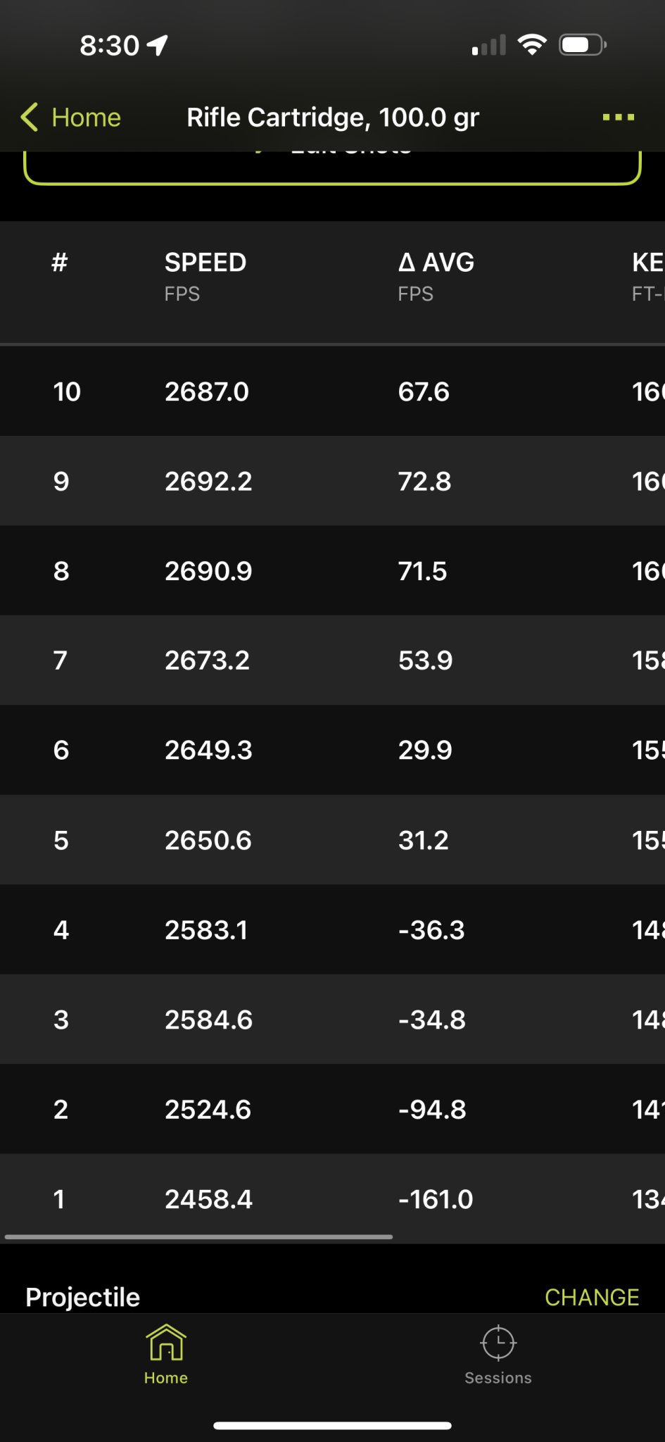

My next load I’m trying to develop is using the 100grain VT from hornady. Same rifle, loaded the same brass and all, except I used LT-30 powder. I did a ladder test working past the “max” according to hornady published data. When I punch this data into GRT it says the max load is hardly reaching recommended pressure at hornady’s max and basically is saying I can run up to ~29.5 gr before reaching max pressure but I’m not so sure. Take a look at the velocity’s. I shot them in order from least to greatest. Started at 24.9 and finished at 27.6. What do yall think about the head of this brass? I’m not interested in conserving brass life, trying to get the most I can from this rifle in this cartridge. I’m also holding the brass in order, lowest grains starting in my left hand.

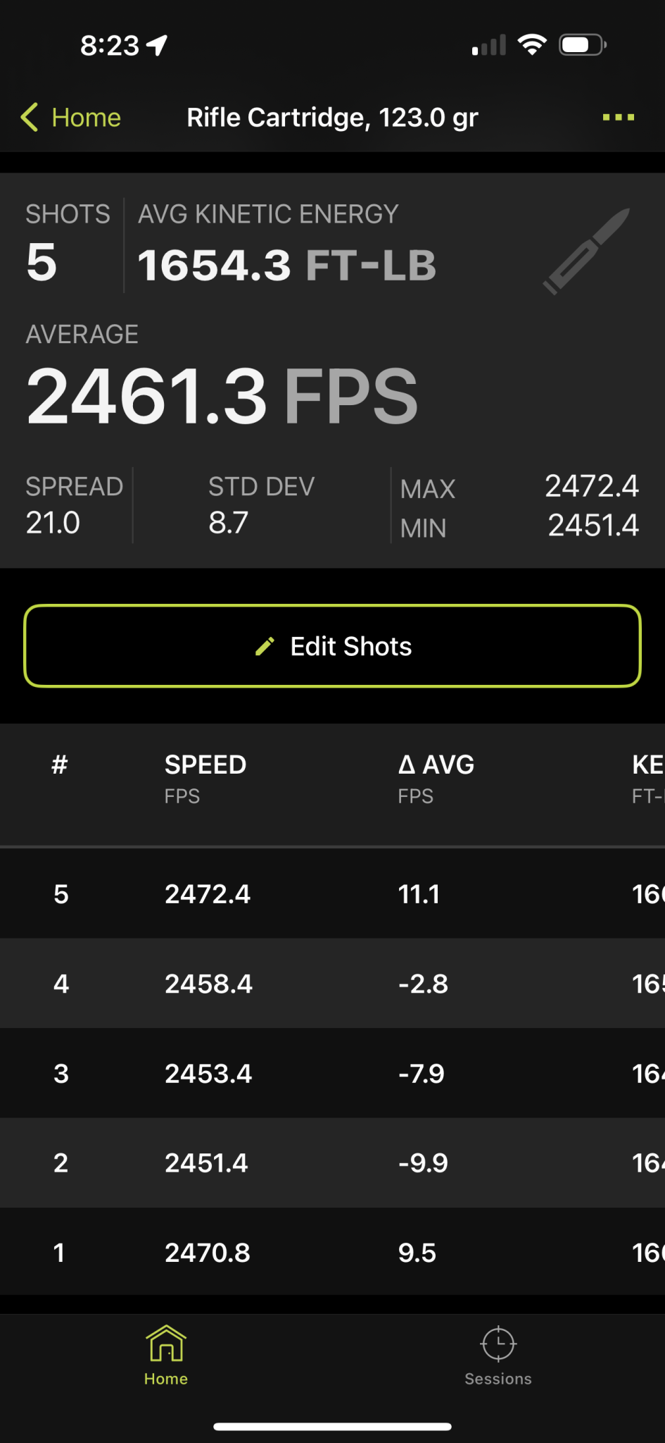

I’d figure about 20 fps per inch of barrel, so would expect 2570ish in a 20” barrel. You above 28gr of TAC to get 2467 in a 14.5? I have a handful of 20” barrels of various manufacturers and get 2550 +\- 25fps depending on chamber and load specs, without stepping too hard on primer pockets. High 25’s to near 2600 starts getting hard on brass, bolts, etc. Doable, but consumable cost may bump as well.
Right it is pretty darn fast and I feel like that SD is excellent for a gas gun!?!
Yea 29.5 grains of TAC on the 123 SST.

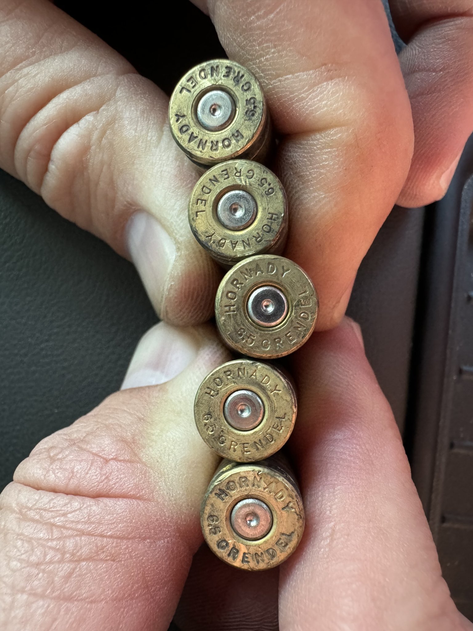

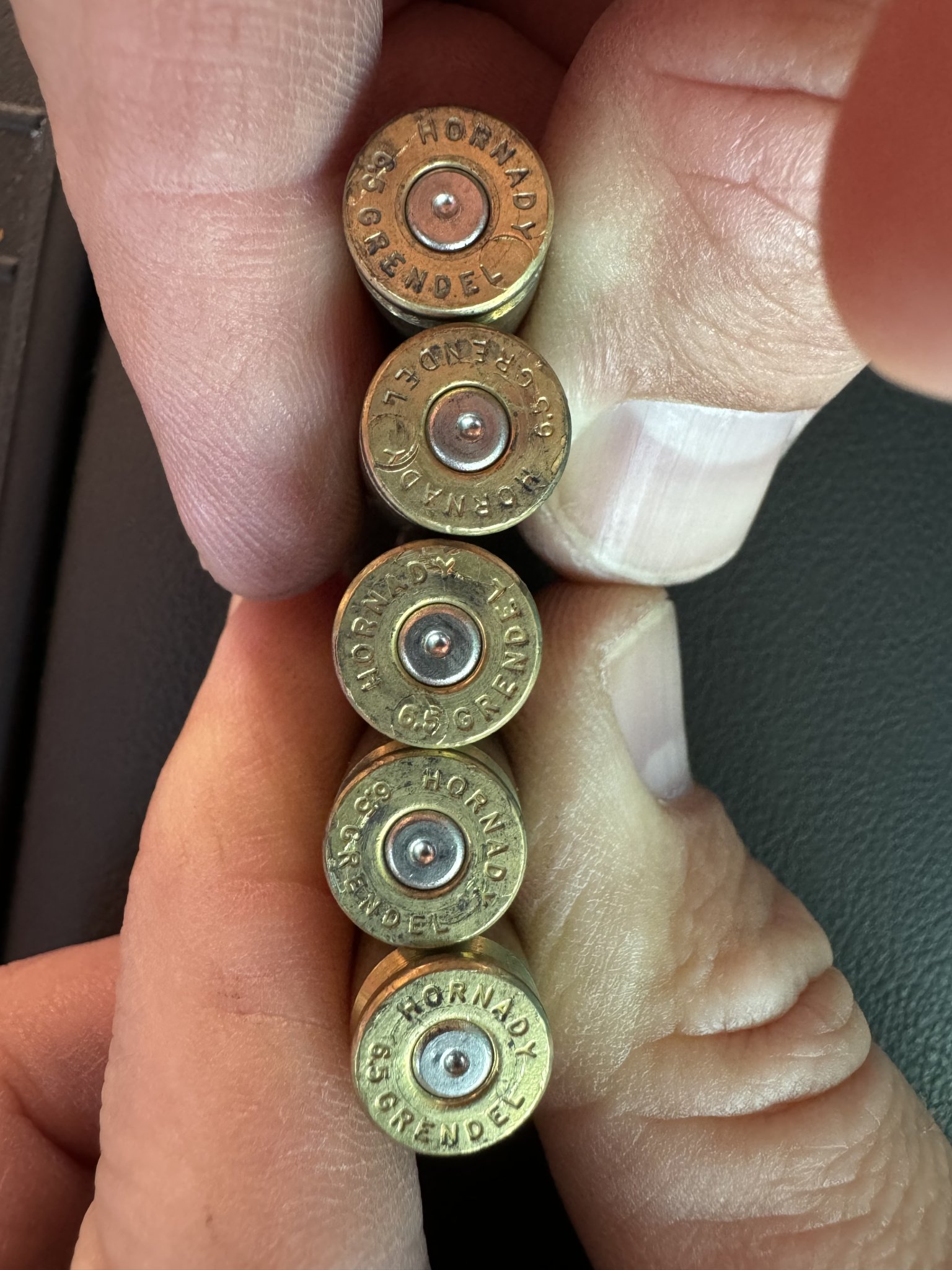

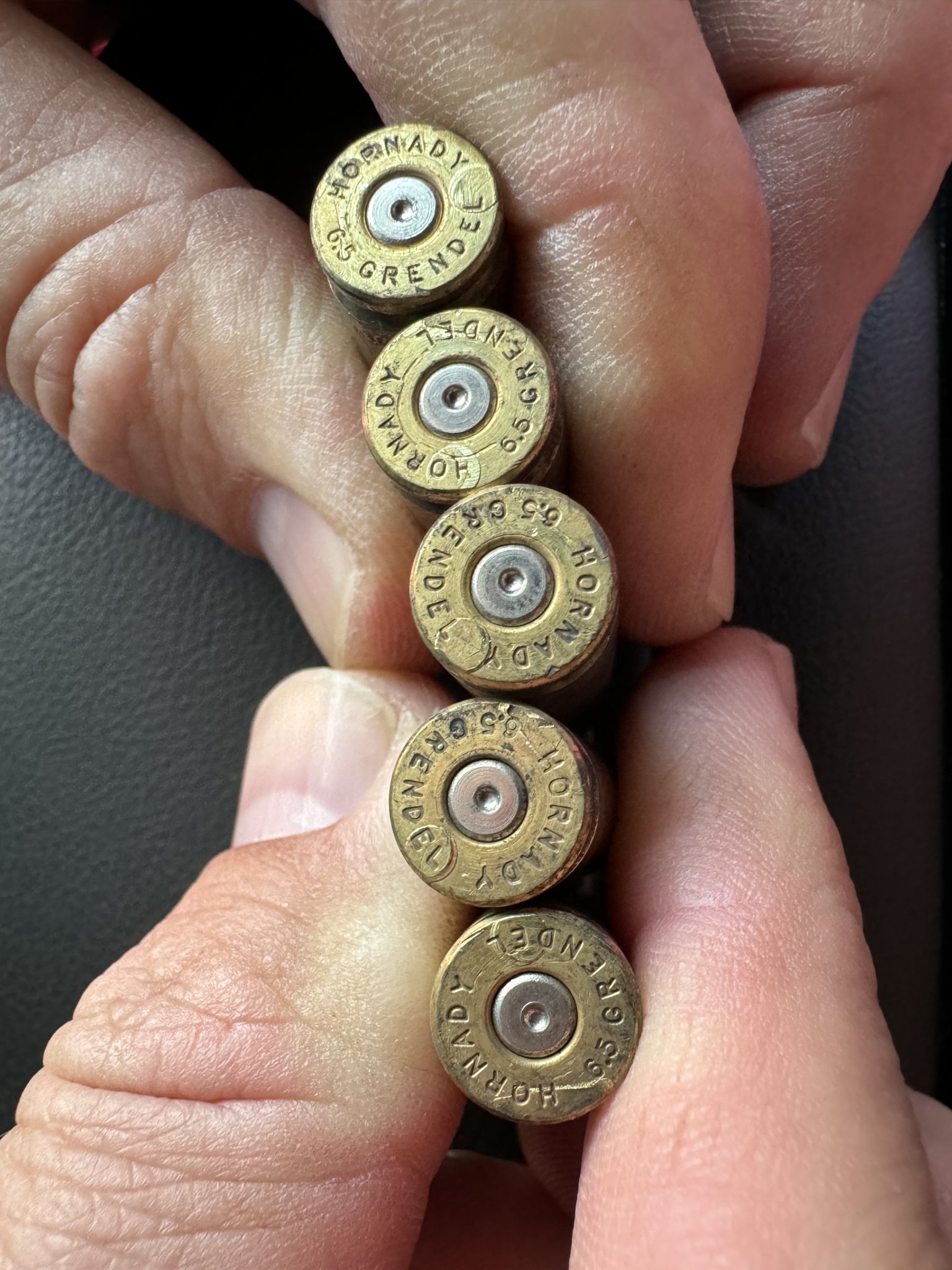

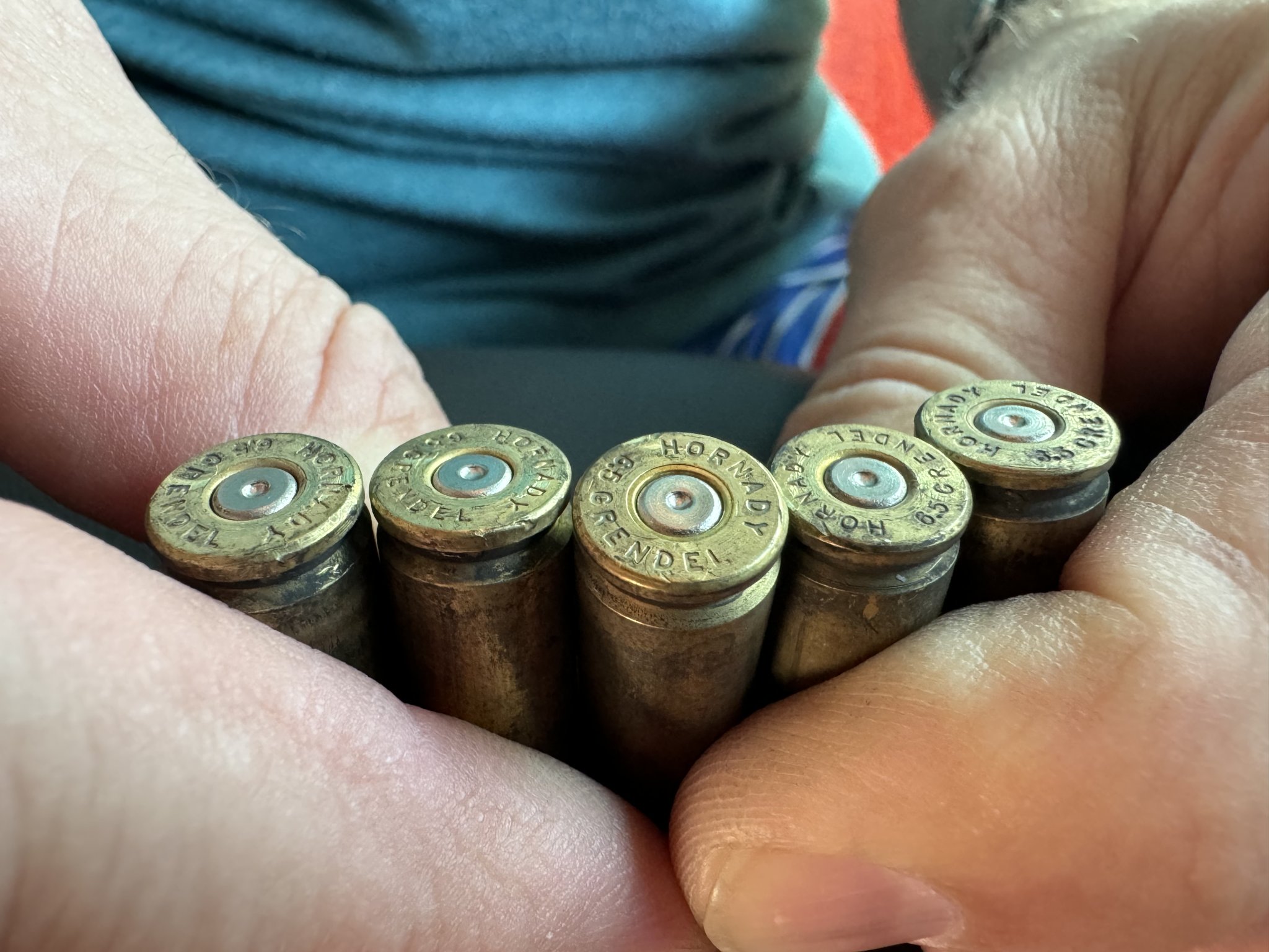

What do y’all think of the brass as far as signs of pressure? I want to push this 100 grain harder with the LT-30 also.

Some of your brass has ejector and extractor channel marks as well as firing pin rings. Grendel is a low pressure round. By the time you see things like this you are well past what is a normal operating pressure.
While you may get away with it for a while a broken bolt or worse is in your future. GRT and QL are both predictive tools and both of them require some tweaking to line up with reality on Grendel.
LT30/32 are both on the very fast side for Grendel, regardless of bullet weight. Your brass and/or primer pockets have been pushed pretty hard based on ejector marks, and ill advised use of very fast powders purely in the hunt for velocity has a predictable result. Stay in or above Benchmark or H335 burn rate for lightest bullet weights. TAC may be workable there as well as for 123’s, though I’d counsel sensible work ups in your barrel. You’re working near/above peak pressures, as has been noted.

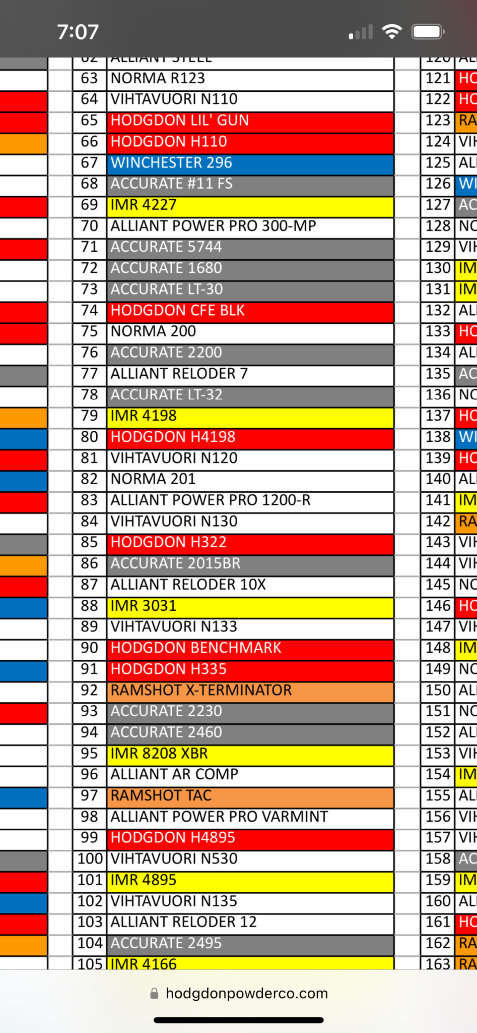

VV recommends N130, N133, and N530 for 100 gr projectiles. XBR8208, when available, is like magic for 6.5 Grendel loads.
Isn’t 8208 similar to BL-C2? I tried loading with BL-C2 and got pretty slow results.
I haven’t tried any VV yet. Maybe I’ll add that to the wheelhouse. Which one would you say is the best to try out of those three?
My pet load is with 8208, but I’ve been hoarding what little of that powder I have left, as it is unobtanium. I haven’t tried the VV powders, but 130 and 133 are on my short list to try for light bullets from a short barrel.

Keep in mind, too, that Grendel brass doesn’t usually exhibit pressure until you’re well beyond the suggested 52k max mark for AR’s.
