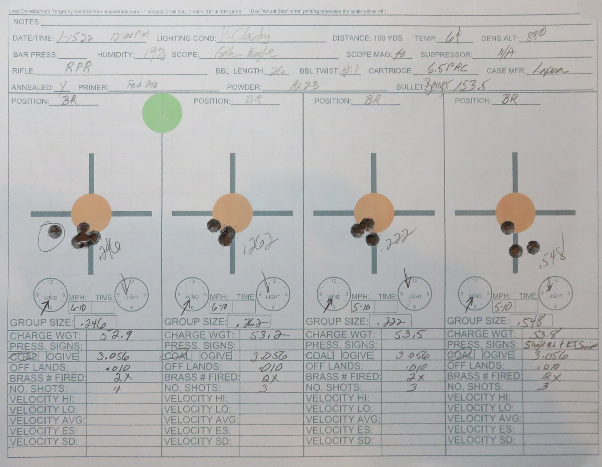

I haven't shot any 156's, but have shot 5 other projectiles and they all see to do well somewhere between 2920 and 3020 (though somewhat hot loads) and mostly seated long for the extra case capacity. Retumbo and RL-23 have worked best for me.

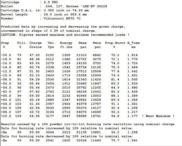

Anyone running 127gr LRX in this cartridge at short action mag length (say 2.950” max) with any of the following three powders? Thoughts on these powders for the bullet?
VV N570
H1000
Retumbo
I'm your huckleberry...
N570 looks a bit slow
H1000 also a bit slow
Retumbo definitely too slow
Might I suggest some N560?

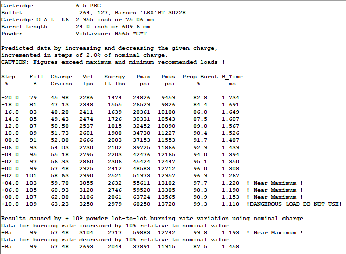

I'm using N565 with the 124 Hammer Hunter (actual weight is 126). It hits 3190 pretty easily. I would expect 560 to be even better.
Reactions: KnowNothing256

What have folks seen on temp stability for N560/565/570? Internet reports vary.
…so let’s get some more internet reports lol
Oh, and if it changes what I should run, this’ll be a 20” barrel with an Ultra 7 on it.

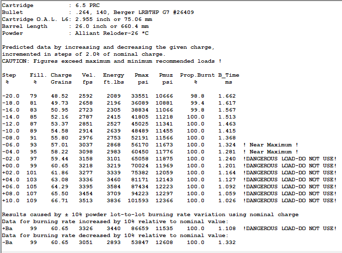

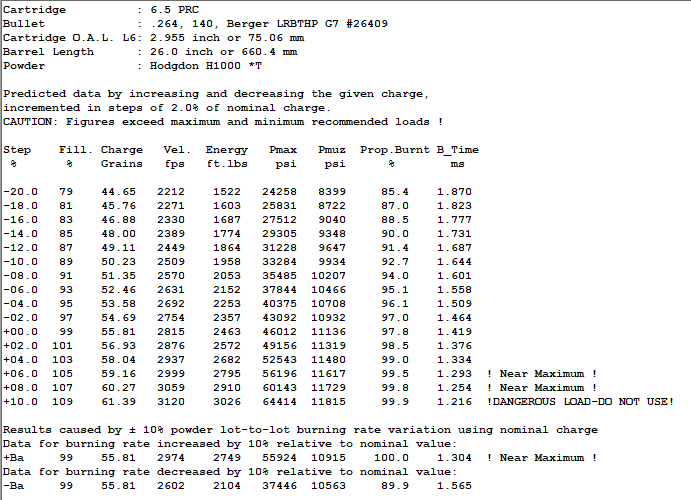

Have h1000 and rl26
Berger 140’s
Any starting advice? Charge weight or seating/jump preferences

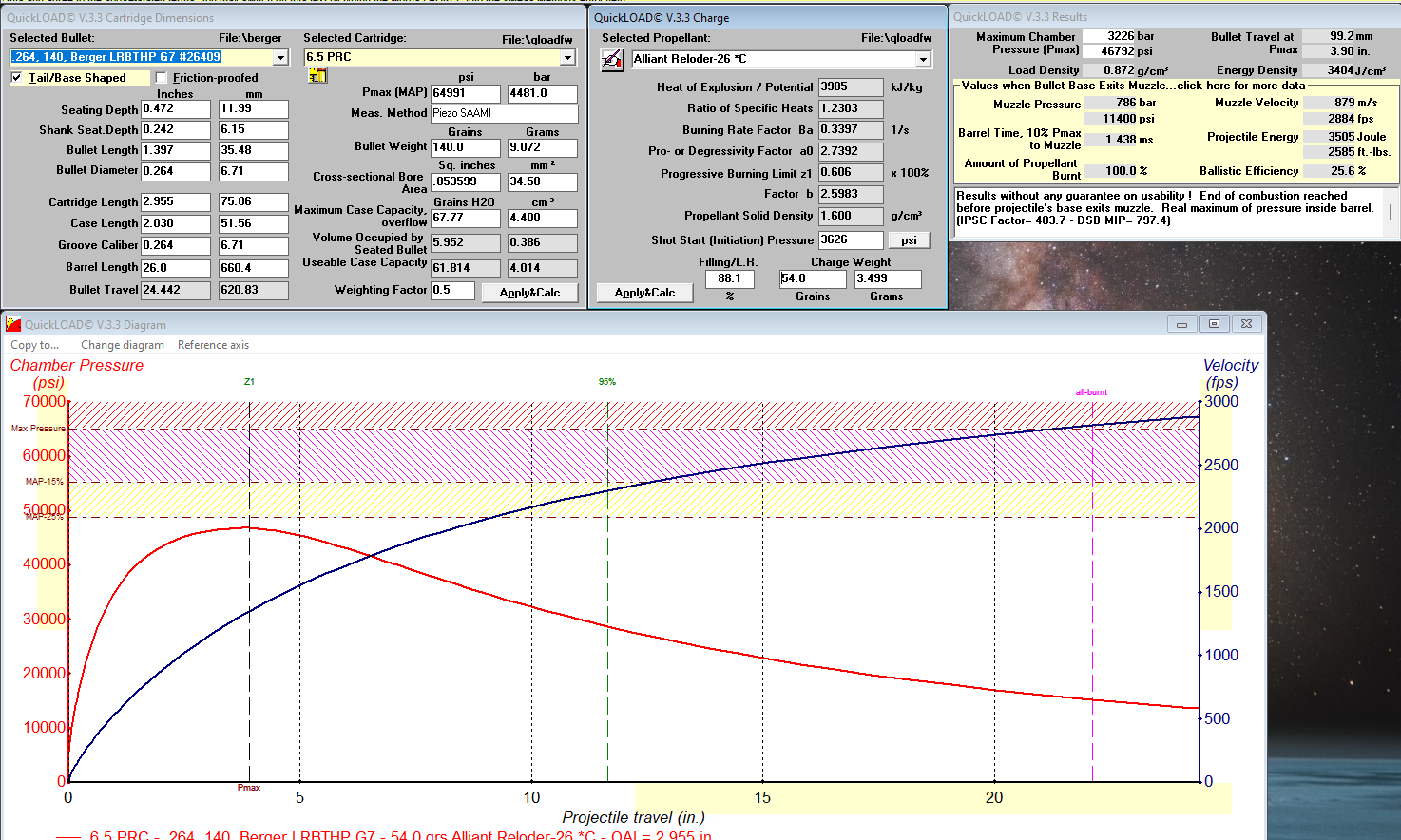

You're going to hit pressure long before you get the case filled.
It looks like starting around 54gr of RL26 would be a safe starting point.
You probably won't hit pressure with H1000, so you could start at 55gr and still be safe, but you're already almost at full case fill % at that starting point.

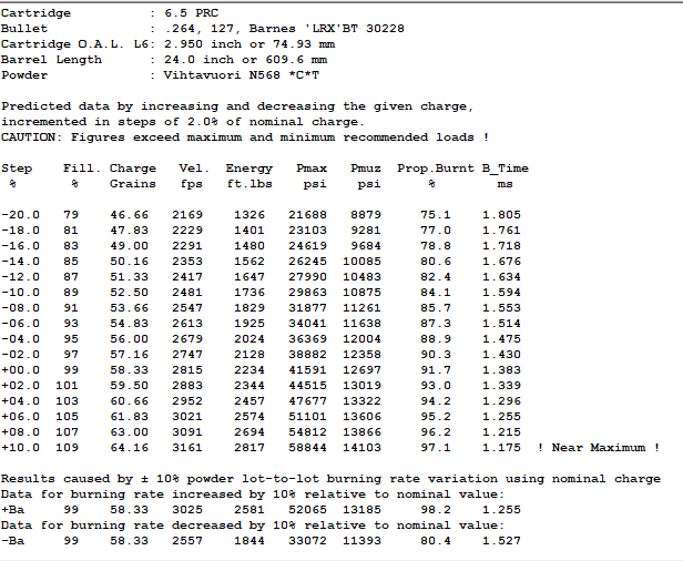

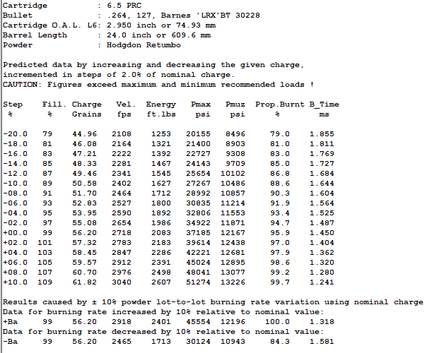

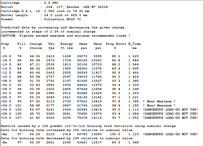

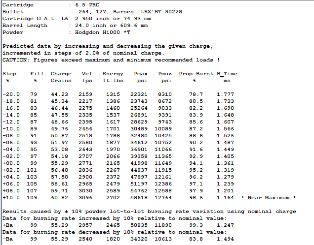

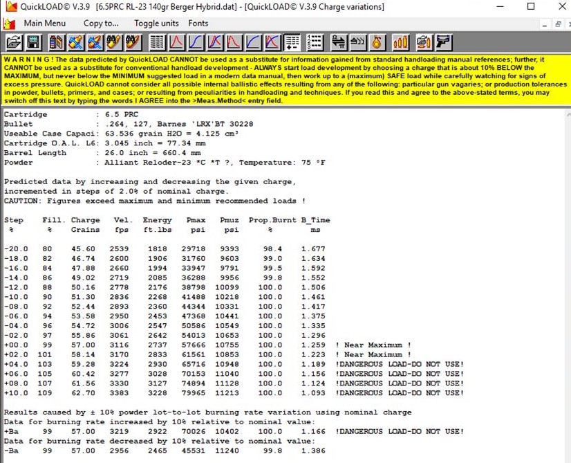

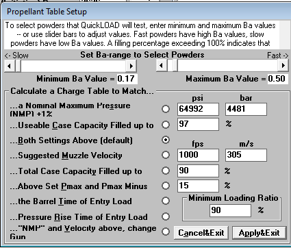

It's an outdated application, but the program still works very well and the component data is updated regularly (ie different bullets, cartridges, powders, etc). I've been using it for about 16 years and it's been an essential tool in my reloading kit, helping to test and experiment with combinations of components long before buying/shooting. BUT, its only a predictive tool, not ground truth. You can tune it to match real world results, but it's best taken as only a ballpark guide.
It has some really handy features, like say "hey, I want to see how this bullet will shoot across a range of powders with a 97% fill ratio and pressure limit"
Whoa, check out Norma MRP powder!
Hmm, interesting, didn't realize that N560 would be partially unburnt in a 24 26-inch barrel, I wonder if it's the right choice for my 20" barrel with can setup...
ETA: Haha love to see Reloder 16 up there, talk about an across-the-board powder. It's already my powder for 22BR and 6.5CM lol
