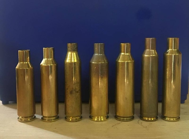

See the picture (from the left): 6.5x47, 6.5CM, 243, 6.5 GAP 4S, 6.5PRC, 6.5x55, 6.5x55AI
This picture was posted on the FB site for 6.5 PRC. I really like it because it shows 6.5 cases next to each other.

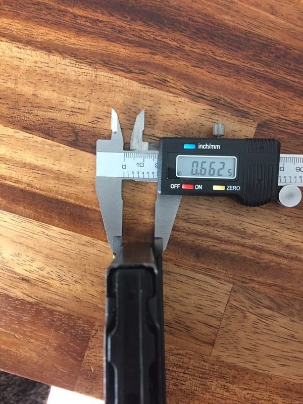

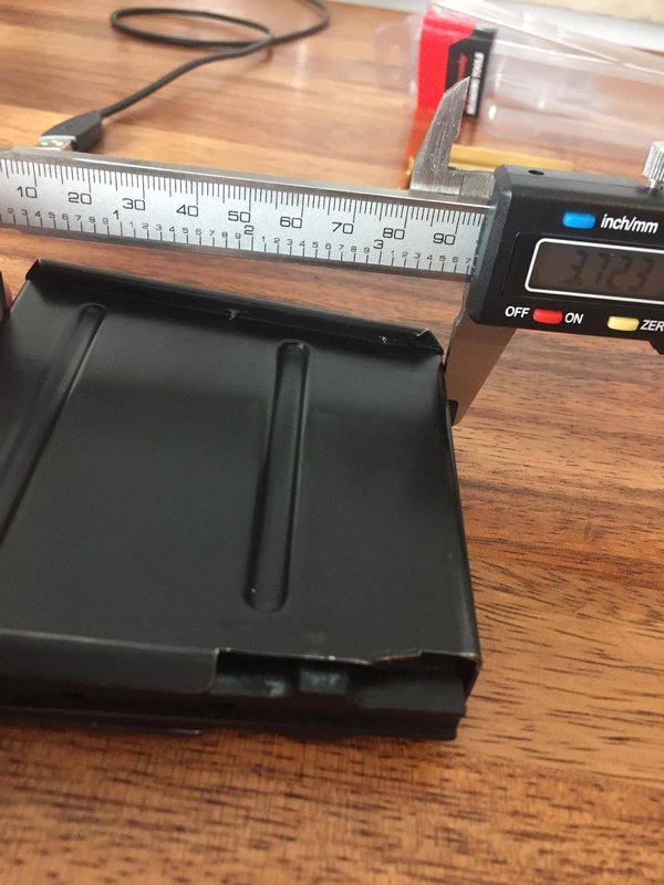

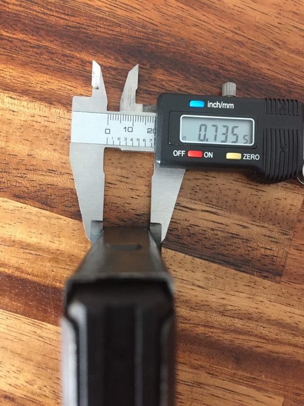

Hi,
I have set my mind to transforming my 300WM to a 6.5 PRC so it will happen, but I am a bit concerned regarding feeding in my AIAW. I have tried using a 300WM and 338LM AI, Accuracy International, mag to feed a 6,5 Creedmoor (the only similar brass I have... still awaiting shipment of the 6.5 PRC brass) and the feeding is not great in the 300WM AI mag.
Please see attached.
What Mags would you recommend with these specifications?

Hi,
I can't be of much help there. I have no experience with 6.5PRC in an AI.
