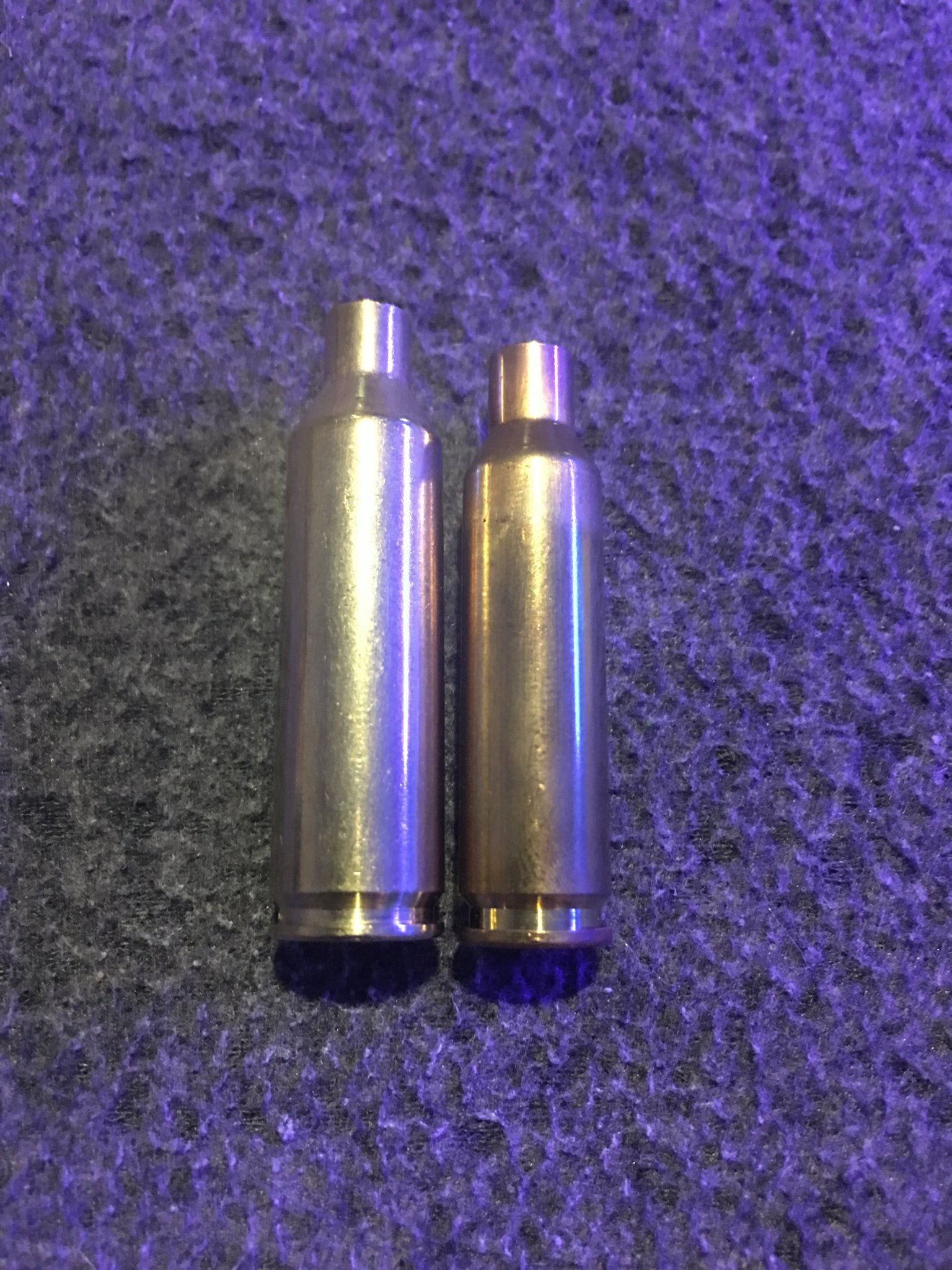

The case is the same length as a 260 rem.
There were just older threads/posts on various boards complaining about the 2.9 COAL not fitting in AI style mags. I've done some digging but my eyes are almost hurting trying to find current threads/info on this and I wasn't sure if this was still an issue. For me, it would be an issue if I could not get these to feed out of a detachable mag box.

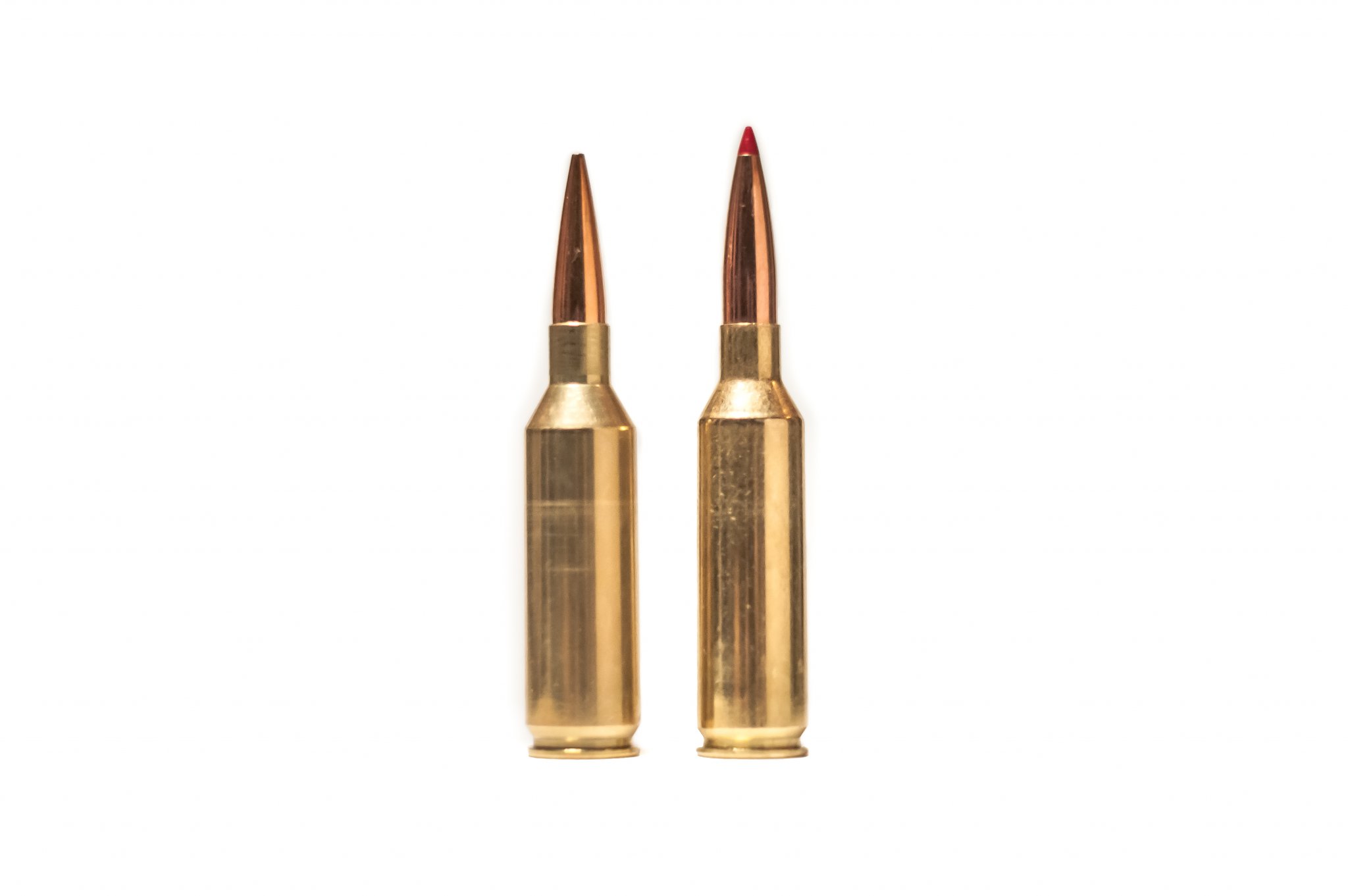

Left: 6.5mm SAUM Right: 6.5 PRC. When I was running 6.5 SAUM 3,050 fps with 21” barrel and suppressor was no sweat. My 24” barrel ran 3,150 fps easy.

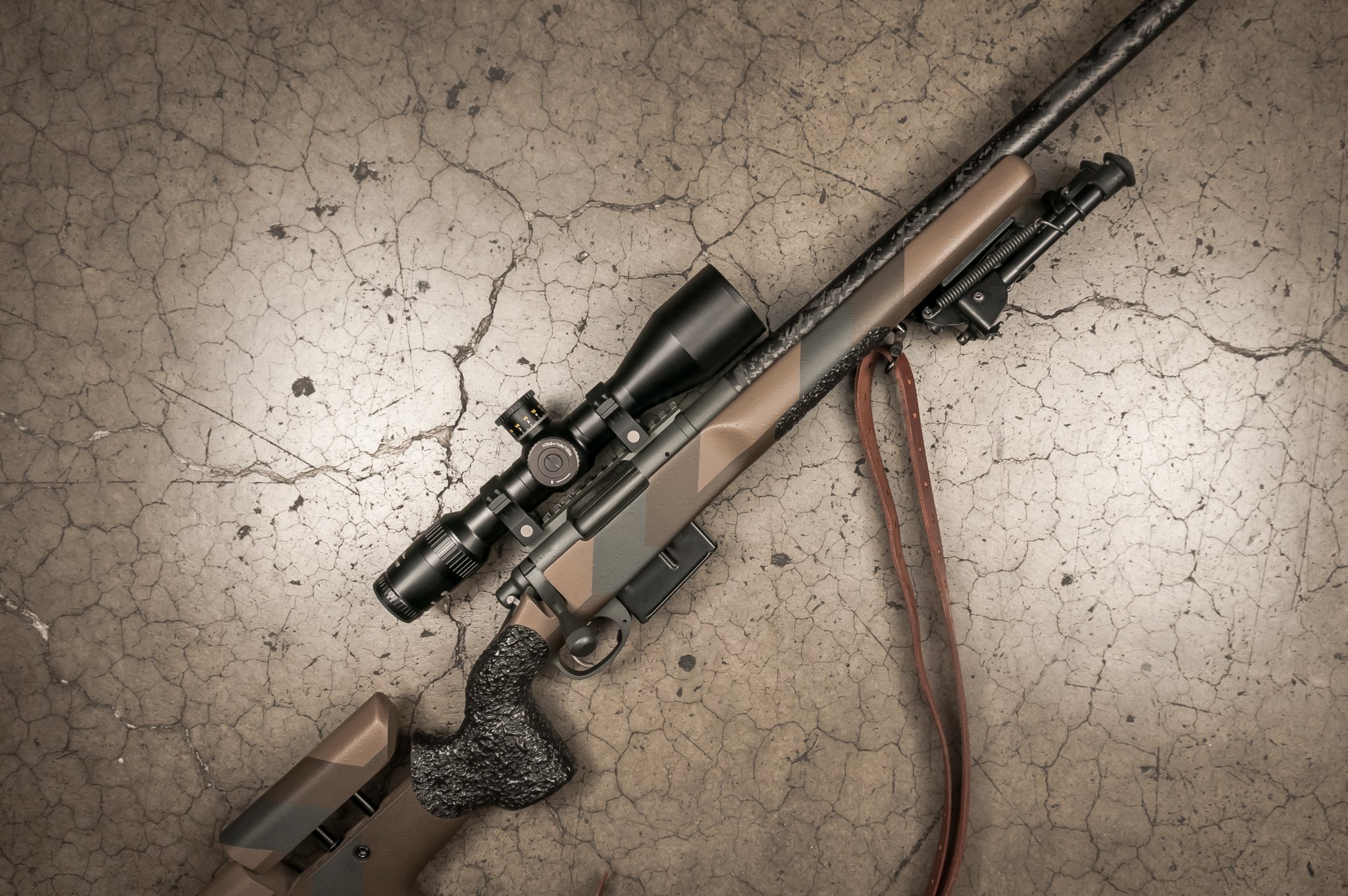

I didn’t realize how long the PRC was for a short action round. We tested the Hornady Precision Hunter ammunition loaded with 143 ELD-X. We’ll be putting together our findings in a video soon. We have two up and running, a Tikka build and R700 build.
View attachment 6903523View attachment 6903524
JFC....will be watching for the video.

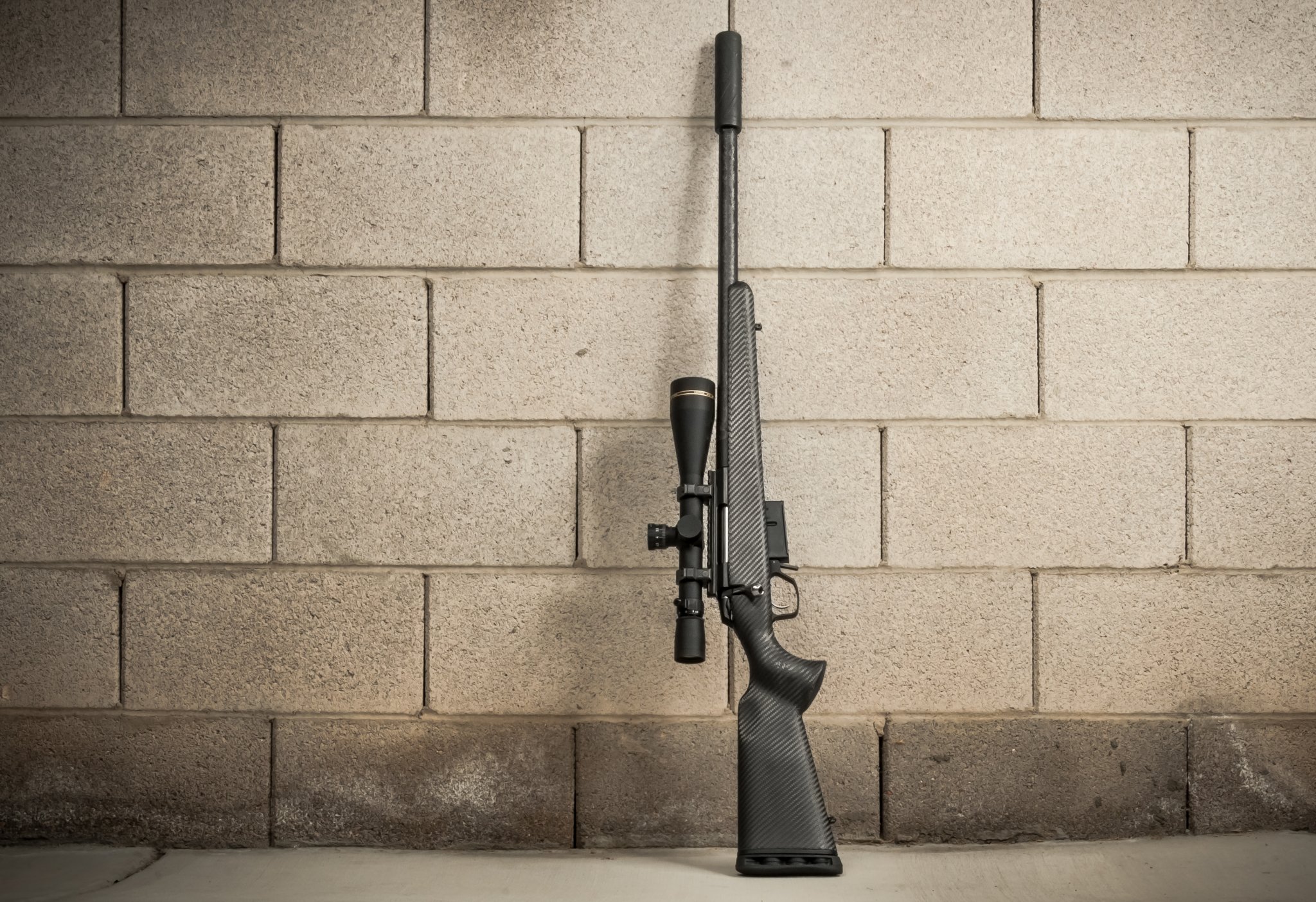

This summer I bought a 6.5 PRC Browning X-Bolt Pro. At 6 lbs. 3 oz. it is mountain rifle weight and this geezer needs to carry less weight. (I live in Nevada - lots of mountains.)
The X-Bolt Pro is Browning's top-of-the-line hunting rifle and has "semi-custom' features like: stainless barreled action, fluted barrel, bolt and bolt handle, factory lapped barrel, carbon fiber stock and burnt bronze Cerakote on everything including the stock.
The trigger is just less than 3 lbs. (2.8) and is a crisp single stage unit but I may get a Timney for it as 2,8 is the lowest I can adjust it.
Yeah the skinny, fluted barrel heats up after 5 fast rounds and groups open from 1/2 MOA to 1.25 MOA. But hey, it's a hunting rifle and I should never need more than 2 shots.
