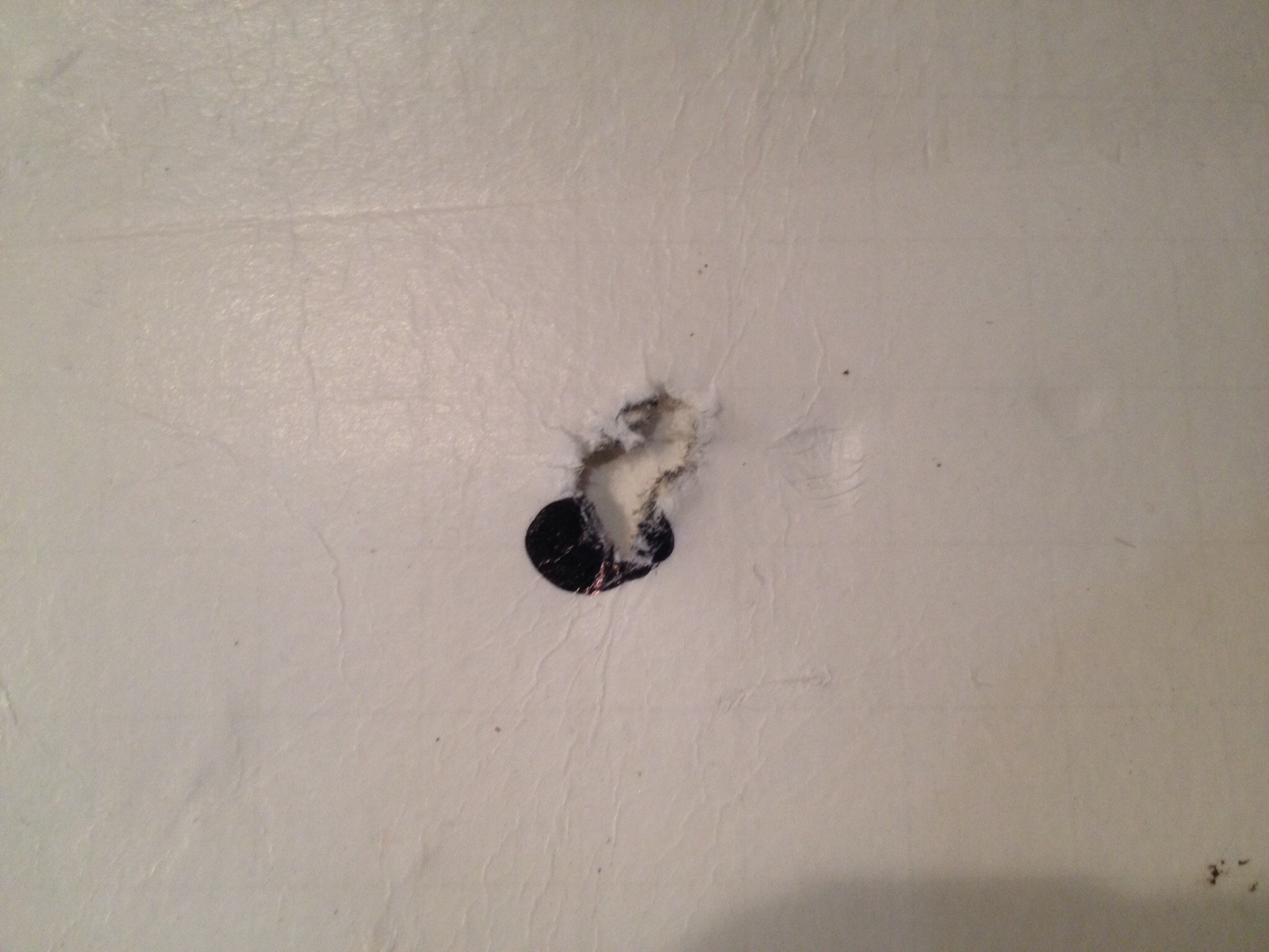

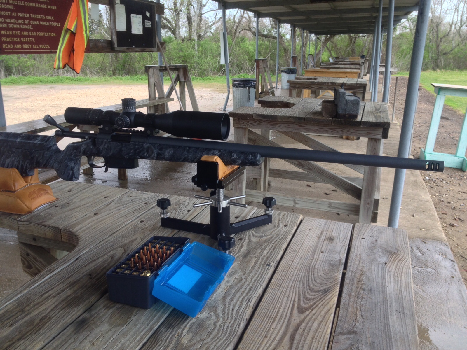

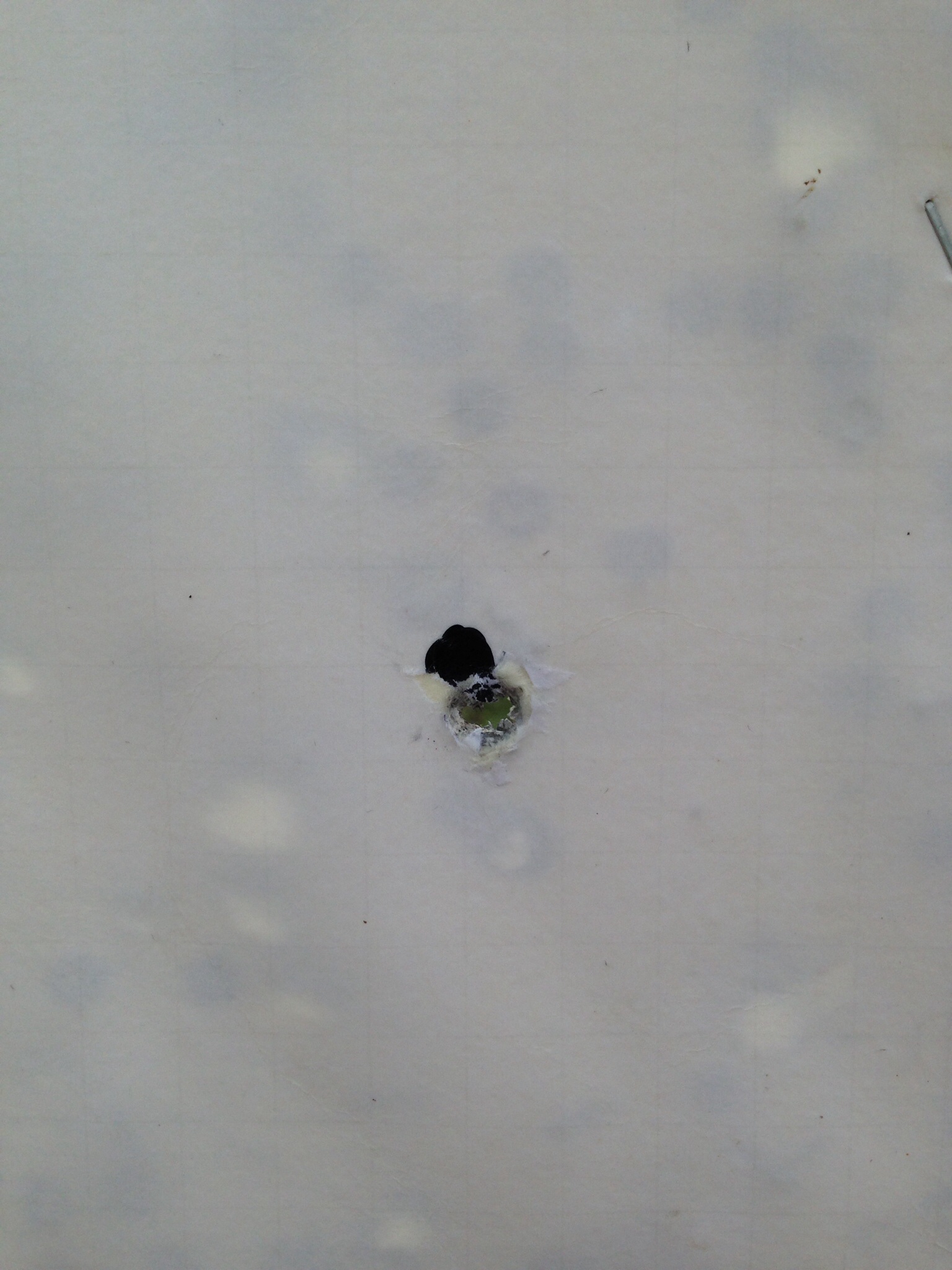

Another endorsement for Omar. Have several he built me and all are stupid accurate. He and I did some load development today on my 6.5 SAUM. Think we found a couple good loads.
View attachment 33028View attachment 33029View attachment 33030
Ummm... OK.. Fantastic results! How about some rifle specs & load data?![]()

Rem 700 action
Krieger m24 8.5 twist @26
Brake made by Omar(works damn good)
Jewell trigger
McMillan A5
M5 dbm w/accurate mag
Cerakoted sniper grey
Nightforce 5.5-22x50, nightforce rings,base
Load
Rem case prepped by me
H1000-61.3 & 61.6
Cci 250
Berger 130 hunting vld
Coal 2.870 .010 jump
Omar and I are going to shoot again on Wednesday and will get speeds
10 shot avg was 3170 @ 61.6gr H1000 with an ES 13Any updates, 6.5fool?
