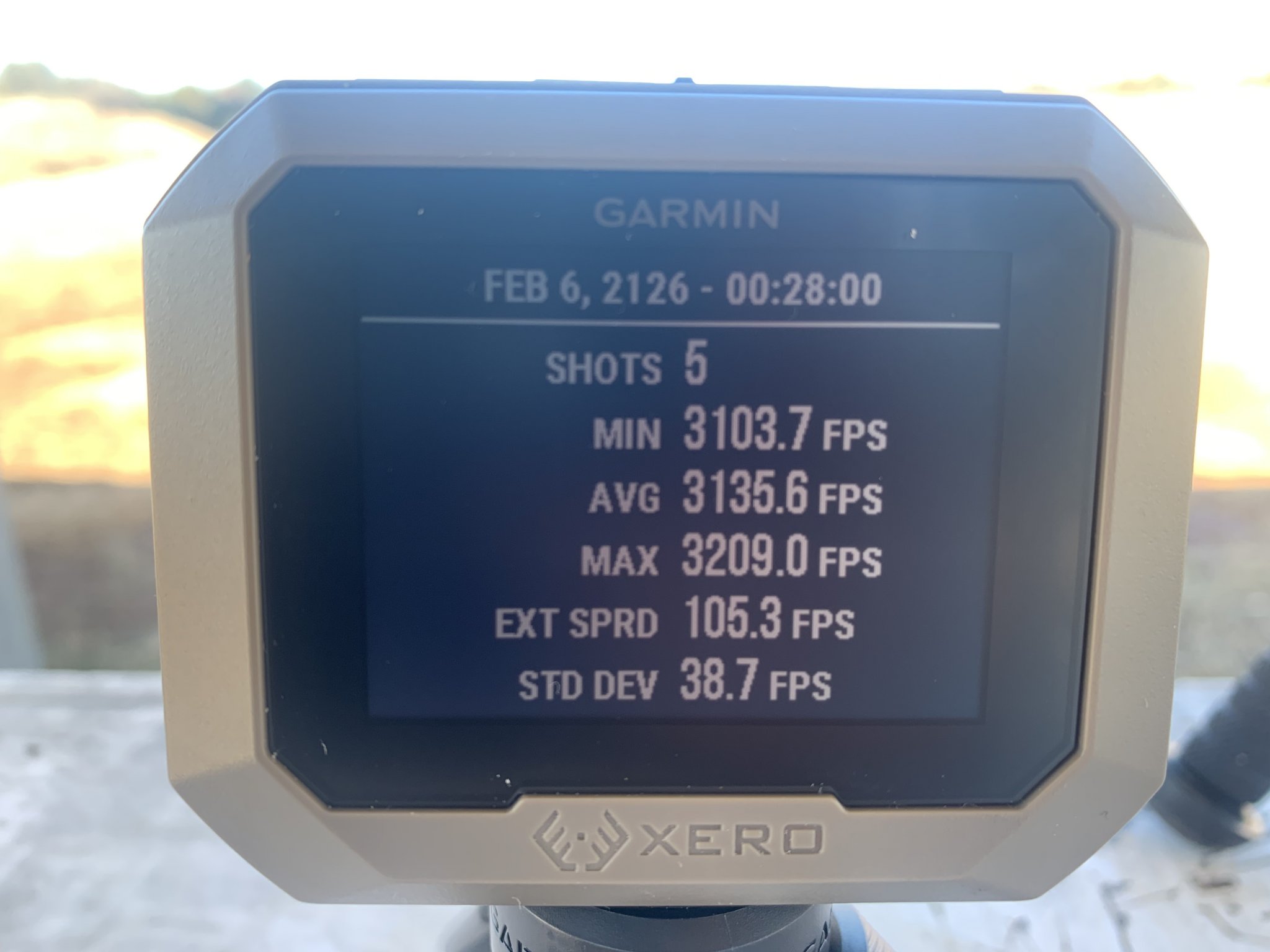

Superformance. with the 6.5 always gave really good results, good velocities, good SD’s and great accuracy. No, it’s not a super all temp powder but shooting in every condition I have experienced, velocity and accuracy never seemed to waver enough cause problems. (considering how well it shot in both of my CM’s with multiple bullets. And in my limited tests, it always topped h4350 in velocity, SD’s and accuracy.

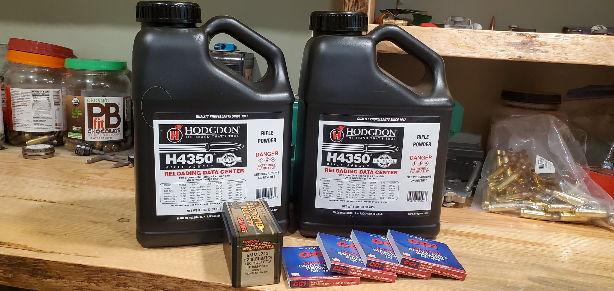

I found some 8lbers of H4350 that I'm thinking about trying out, really I want a powder with the best chances of working in the 6 with 112- 115s and the 6.5 with 147s
Then get H4350. It will work with both very well

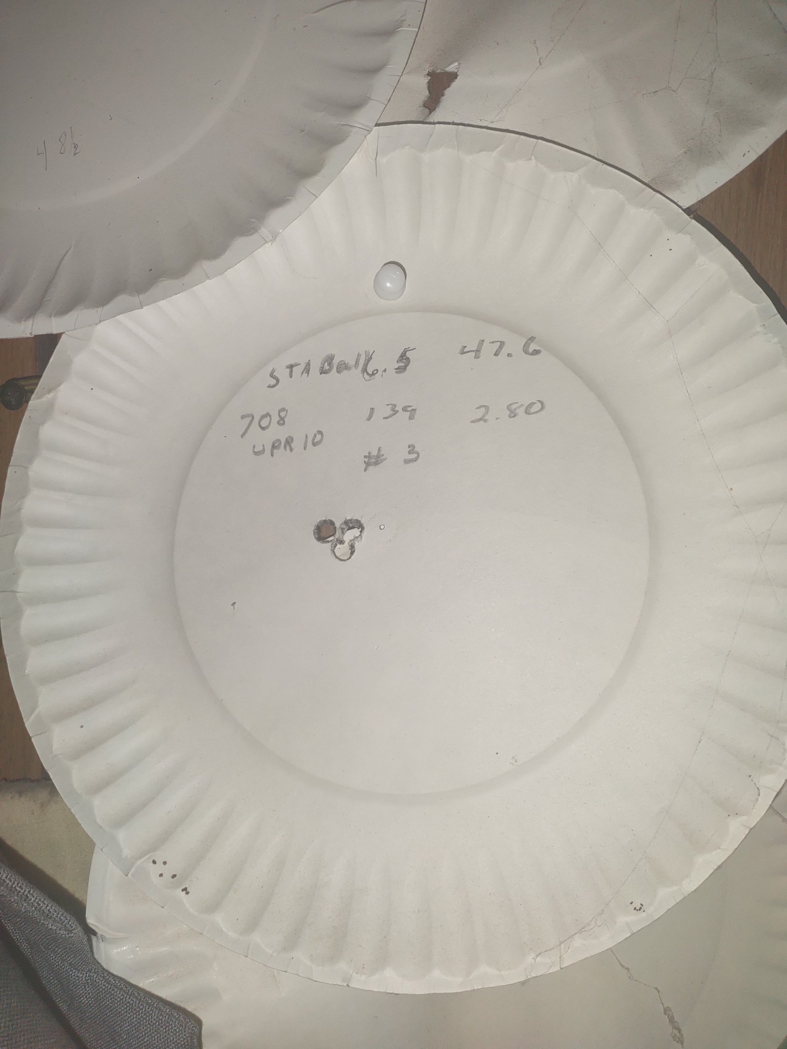

I did work a load up with 45 grain of 6.5 Staball with a 139 Lapua and it did shoot well.... until the bolt locked up in a match after 15 record shots.
Carbon galore - It took 2 broze chamber bore brushes, wrapped in cotton, and a lot of Iosso carbon remover cleaner.
The bore was a coal mine....

Yes, yes, it is a "hot load" according to the published loads.
I did work up to this load (incrementally) and was also using SRP Lapua brass with a good amount of jump.
I didn't see pressure signs but don't recommend the load as this powder is not worth anyones time.

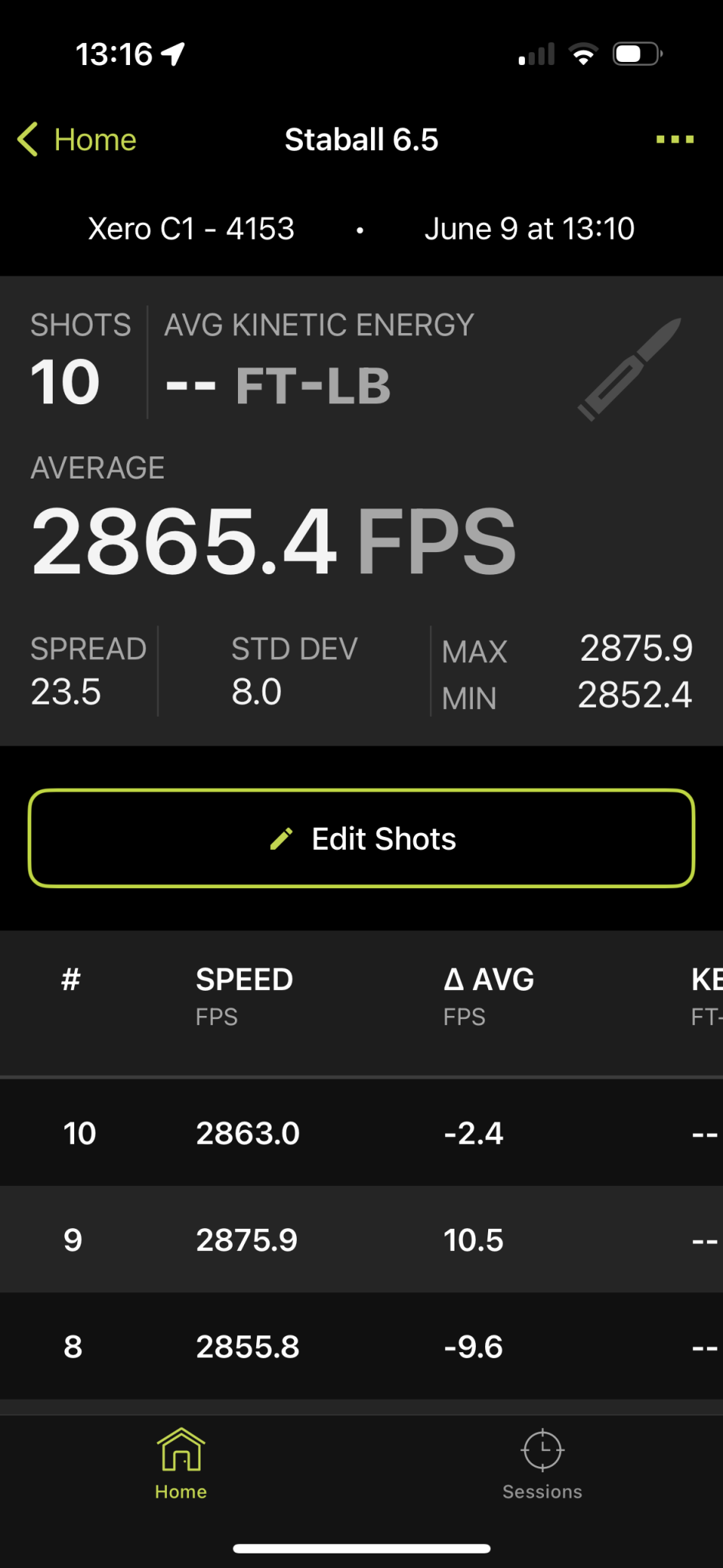

I'm liking it for 6.5C in an AR10. Using virgin full length resized Staline SRP brass I can load it on my Dillon XL650 since it meters within a tenth of a grain from the Dillon PM. I'll probably try it in 6.5x47L when I need to load some more up in order to save the H4350 for cartridges/rifles that don't like the StaBall6.5.
Here are two 20rd strings I collected on a LabRadar in November at a local belly flop match. The match has a shooting rotation in it, so you fire two rounds at a target and then wait 30-90sec before shooting at the next target. I loaded up a 20rd mag and went to work, so rounds 3, 5, 7, etc would soak in the chamber for a bit before it was my turn to fire two more rounds.
22” 6.5C AR-10 suppressed w/ SDN-6/R7
130gr Berger AR Hybrid
Rem 7.5 SR primer
Virgin Starline brass FLR’d
StaBall 6.5 45.6gr
OAL 2.750”
20rd group
Lo: 2820
Hi: 2879
Avg: 2853
ES: 59
SD: 14.2
20rd group
Lo: 2833
Hi: 2888
Avg: 2865
ES: 55
SD: 18.8

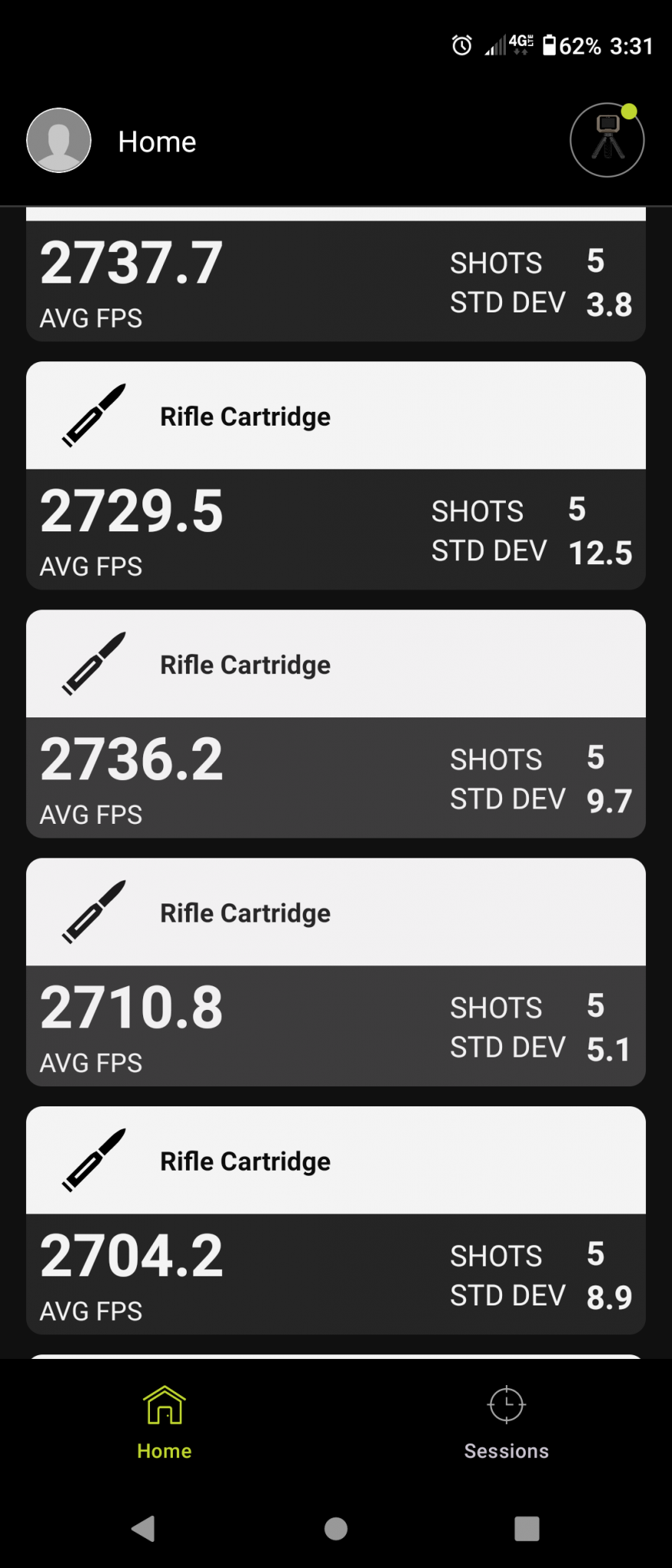

Finally got some 6.5CM/6.5Stball rounds down range with the Garmin. I screwed up, because I was rotating rifles, I kept turning the Garmin off to not get shots from the other one, but kept forgetting to turn it back on, so I only got one string of H4350/140 loads.
But the two 10 round strings with 6.5Staball (w/ Mag primer) and 140gr surprised me.
First one was:
2730 Ave
33.7 ES
10.4 SD
Two outliers, both mid string at -19 and -20 below ave opened the numbers up.
Next string with a slightly shorter OAL was:
2704 Ave
26.4 ES
8.2 SD
This was 5 shots, a few minute pause and 5 more. Both times the first shot was the outlier, -11.1 and -10.2 respectively.
Reactions: Bravo6

I get single digit numbers with 140g-147g anything using Superformance. It doesn't seem to be very temp sensitive, I've shot competitions from the high 20 degrees to mid 90's and it remains consistent throughout....

Staball 6.5
6.5CM
140ELDM
CCI #450
Federal brass
43.5 grains dropped from a Dillon powder measure
10 shot group measured .8
I did not do load development, just set OAL to 2.8 and loaded in .3 grain increments till I got pressure signs then backed off a bit.

Staball 6.5
6.5CM
140ELDM
CCI #450
Federal brass
Dang, that's pretty spicy for a 6.5 140, no..? Don't forget about sun/dust/rain, and Federal brass is suspect, bubba wouldn't wanna get blowed up lol.
I'm running my 6mm slower than that (so I can see impacts/splash inside 600 yards easier, 6GT at ~2800fps @ 80degF).

6 mm Dasher 110 gr at 3085 fps, or 107s at 3132 fps.
The 6 Dasher is an excellent accuracy cartridge for tiny groups and holds a bunch of 1000yd records.

Hybrid cases and RL 26 will get 3150 with 140 gr in the 6.5 CM.
But a standard load of 41.7 gr of H4350 works well in most 6.5 CMs, around 2700 to 2750 fps, with 24" barrels, very it slightly, for individual barrels.
