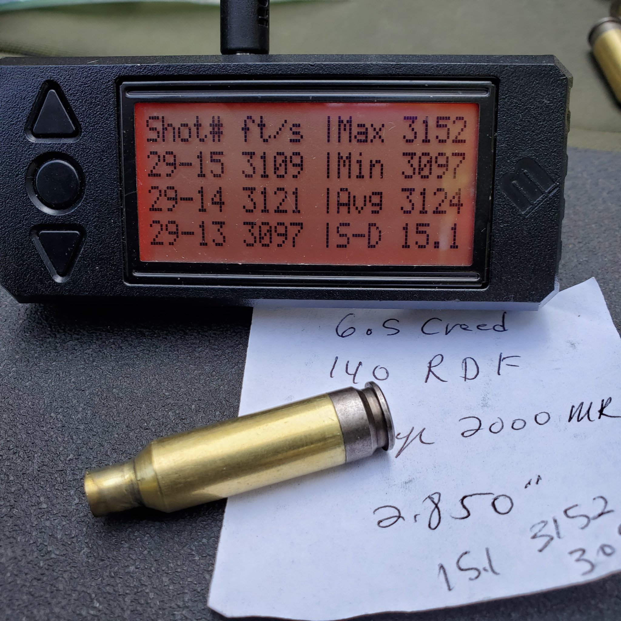

I've been shooting hybrid cases in a variety of calibers, since they first came available...but I do not own one in the original 277 Fury.
Like 6.5 CM, 308, 358, 8.6 Blkout.
In the 308 and 6.5 CM is where I pushed the actions to 80,000 psi and a bit beyond.
Cause it's easy to go to far with QL.
Over pressure signs are not readily noticeable...the case on the left has over 80k probably 90k the one on the right around 80k.
Nothing on the case head, but the primer teat flowing into the firing pin hole and heavy bolt lift are your main indicators....
The smaller primer teat is normal.
Heavy bolt lift means you stressed the action ...these hybrid cases will stand repeated loads at 80,000 psi.
Made a case puller to get the hybrid case out of the die when you do not lube your cases good enough, it presents an instant problem.
I use hybrid cases on very long bullets like this 350 gr Maker in 8.6 with a 6.5 twist running 1800 fps instead of 1000 fps, defeats the purpose of the sub load but much more energy delivered to the target.
Another common area is 6.5 CM and 308 Win with mostly heavy bullets for caliber.
6.5 CM 150 gr SMK or 153 Atips at 2960 to 3000 fps for accuracy. 308 200 gr SMK 2900 fps, 2952 fps max in my rifle, 225 gr eldm 2700 fps, 168 gr 3255 fps.
Depending on barrel length. Long barrels get the full advantage, but many like short barrels and one can get real velocity improvements with a few powders and hybrid cases.
