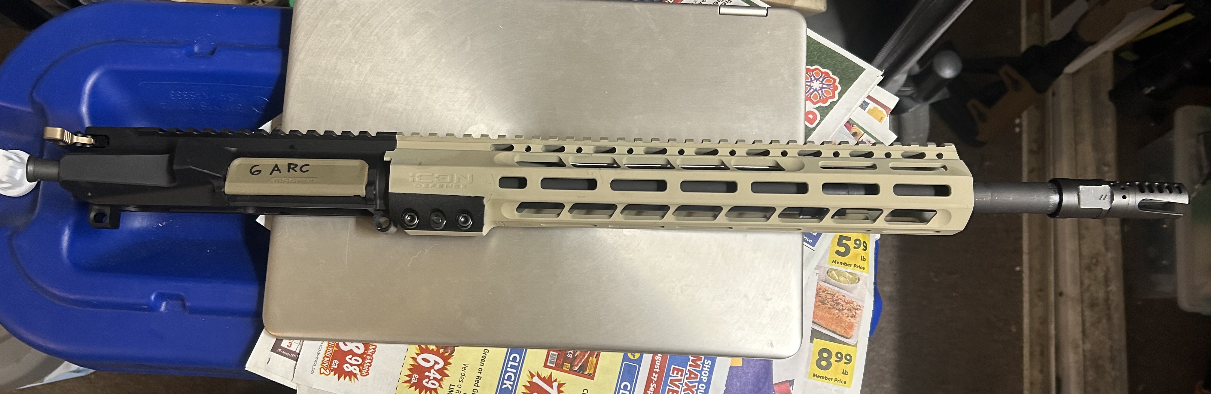

Working on another build....use case is a 16" 6 ARC SPR

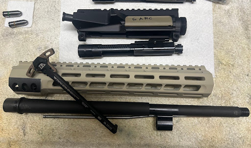

Barrel inspection notes:
  • Weight: 36.5oz
  • Gas system length: Mid-length
  • Gas port size: 0.086”
  • Gas block journal: .7505”
  • Barrel Extension: 0.9985”
  • Headspace gauge check (on fully stripped Radian bolt):
    • Go 1.1901”: closes
    • Field 1.201”: doesn’t close

After inspecting the barrel and seeing that it has a larger gas port than expected (.086”) for mid length 16” barrel it will likely be over gassed but we will see. It also had a pretty rough looking crown.

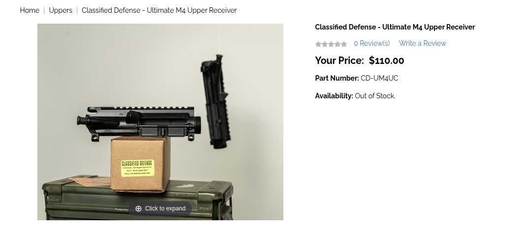

https://www.dwilsonmfg.com/Classified-Defense--Ultimate-M4-Upper-Receiver-_p_415.html - yall better not buy out my supply of cheap good uppers.

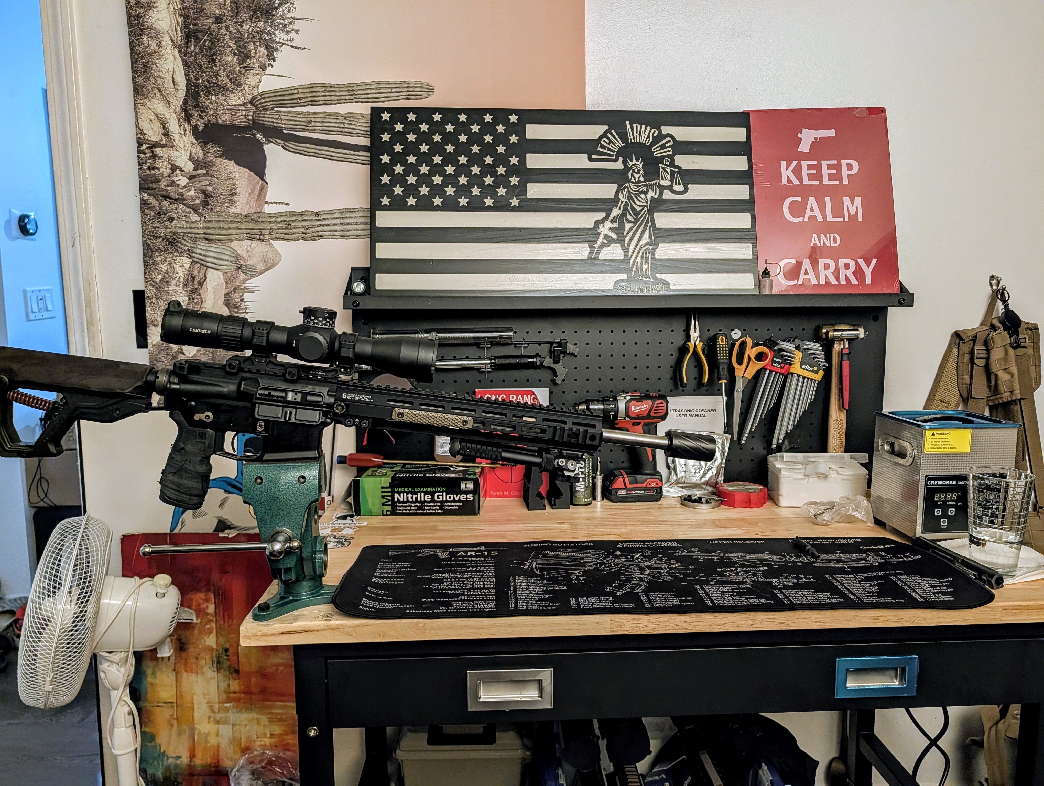

Finally put my build table together - Ready to crank out some work.
Reactions: WeR0206

Thanks for the link on the upper, it has all the specs I look for so I will probably get one, perhaps as a backup for 6 arc builds. I wish I knew about them ahead of time, it would be perfect for this blackhole 6 ARC upper build since they have enlarged ejection port, etc..

The Hide Strikes again... now all my (formerly) secret uppers are out of stock.
You jerks.
Damn! I didn't even have time to grab one yet. Seriously thinking of swapping out the San Tan Billet upper on my 18" PVA 6 ARC barrel with the Classified Defense one you linked. I noticed recently the ejection port size on the San Tan upper is slightly UNDER sized compared to mil spec so I wasn't happy to see that for a 6 ARC build. The one you linked me to has every feature I like (tight fit on barrel, has anti rotation hole, etc.) so I'm pretty bummed they are out of stock right now.
Edit: they are still in stock if you order direct from classified defense:

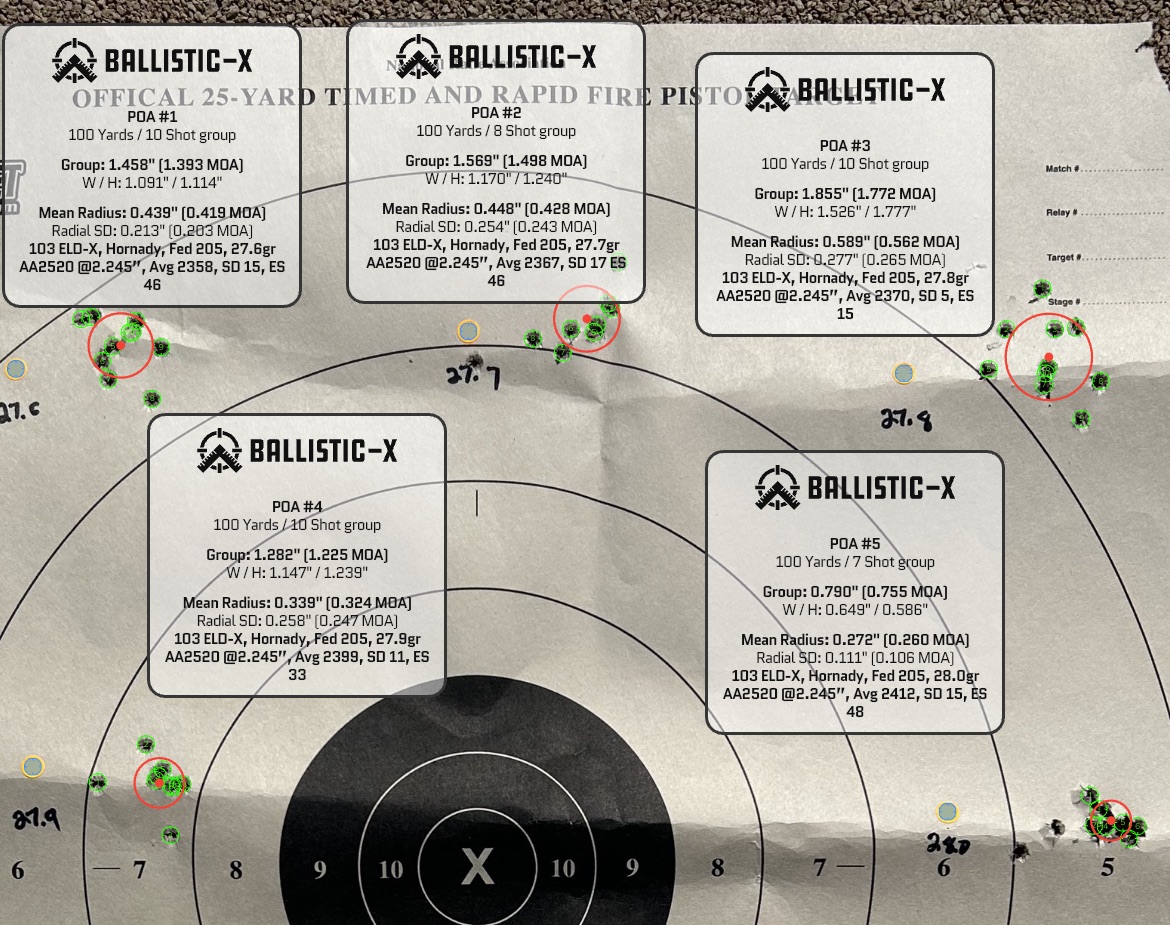

Also this upper build is complete, I hope to go to the range within the next few days to test fire 2-3 different recently assembled uppers (18" PVA 6 ARC, 16" Rosco K9, and 16" Blackhole 6 ARC). I will likely load up some 107 smk's with AA 2520 in hornady brass to do barrel break in along with test firing with some factory 108 eldm's as a benchmark.
Break in session #1 is done. Put 55 down the tube. No cycling issues at all but as expected this barrel is way over gassed and kicks like a mule compared to my 18” PVA osprey barrel. I just bought an RCA adjustable gas key that I will use to tame it a bit along with an h2 buffer and a possible switch to a5 buffer tube which I already have on hand.
Groups tightened up nicely after about 40 shots and a little more speed. In the 10 shot groups I ignored the shots I pulled. These polygonal rifled barrels seem to shoot with less speed than their counterparts. For example with factory 108 eld-m’s this barrel shoots avg of 2,447 while the 18” osprey shoots 2,626. I was expecting the 18” to shoot faster but not by that much.
