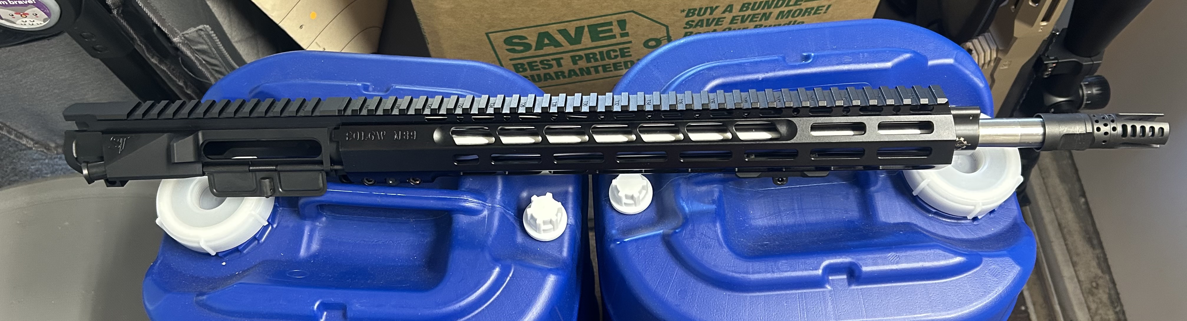

6 ARC Upper Build: 18” PVA Osprey (Rifle +2”) + San Tan Tactical Billet Upper + SOLGW M89 Rail
WeR0206
Gunny Sergeant
Feb 23, 2024
865
779
Northern Cal
www.youtube.com

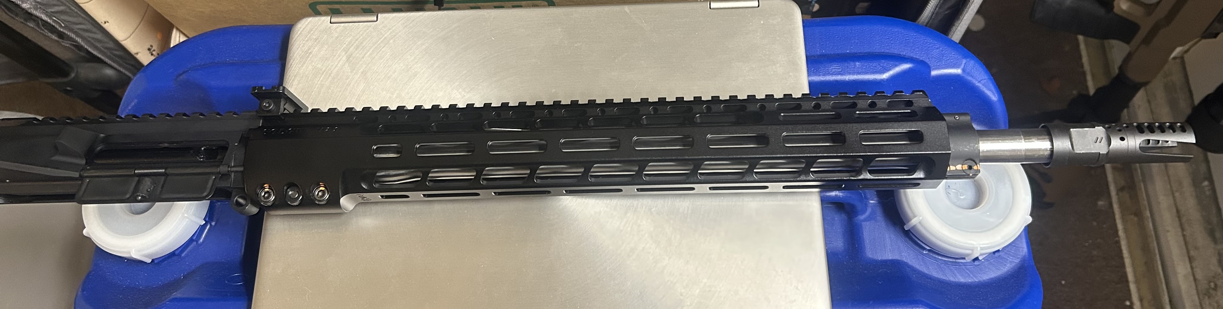

I previously had this barrel on a different upper during break in but wanted to switch to a San Tan upper for this build.
Barrel specs:
  • Weight: 42.8 oz
  • Gas port: 0.093”
  • Gas system: rifle +2”
Build notes:
I already have about 150 rounds through this barrel and shot a sub moa 10 shot group during break in (zero load development)

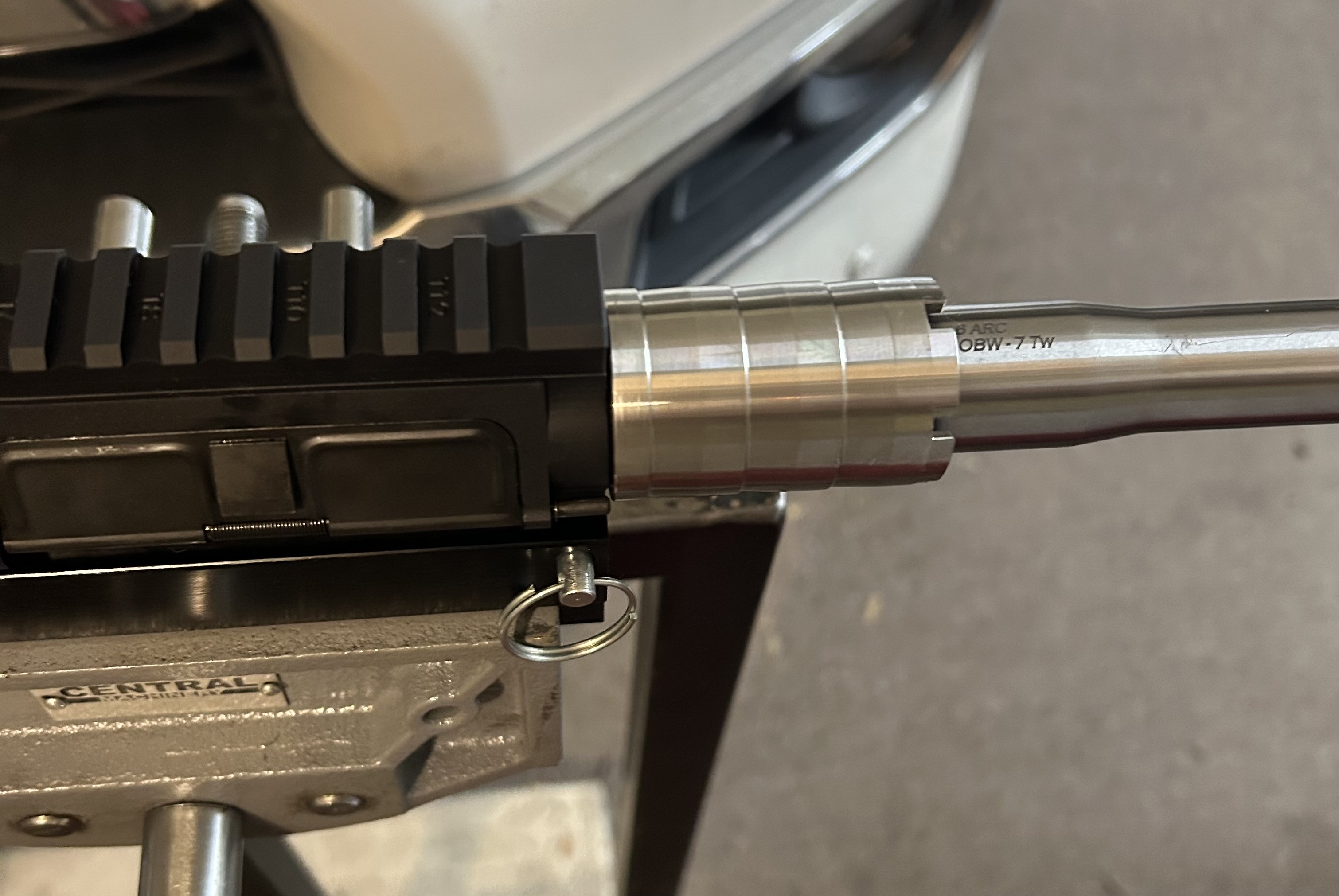

Barrel has been mounted in thermofit upper, I used a 1200 watt heat gun on high for 90 seconds to warm the upper threads up before sliding the barrel in. Still need to mount it on a URR & torque the barrel nut but I will be out of town until 8/5. The San Tan billet upper is too tight to fit my URR so instead I will use a magpul bev block

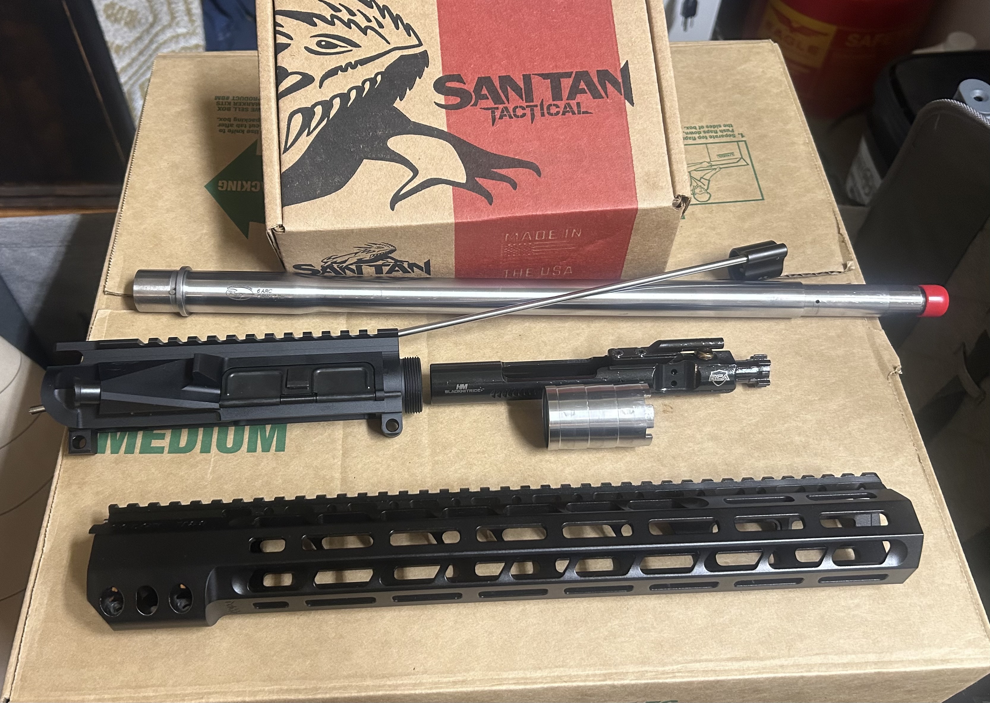

Barrel nut has been torqued to 60 ft-lbs per solgw specs, muzzle device torqued to 15 ft-lbs, and upper build is complete. Now I need to load up some handloads, do function check, etc.. I verfied gasport alignment with a borescope so hoping for no issues.
The M89 rail fit perfectly with the San Tan billet upper by utilizing the anti-rotation pin. The black finish doesn’t match but I don’t care bc eventually this upper will likely get spray painted.

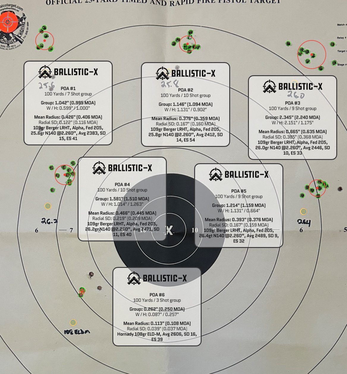

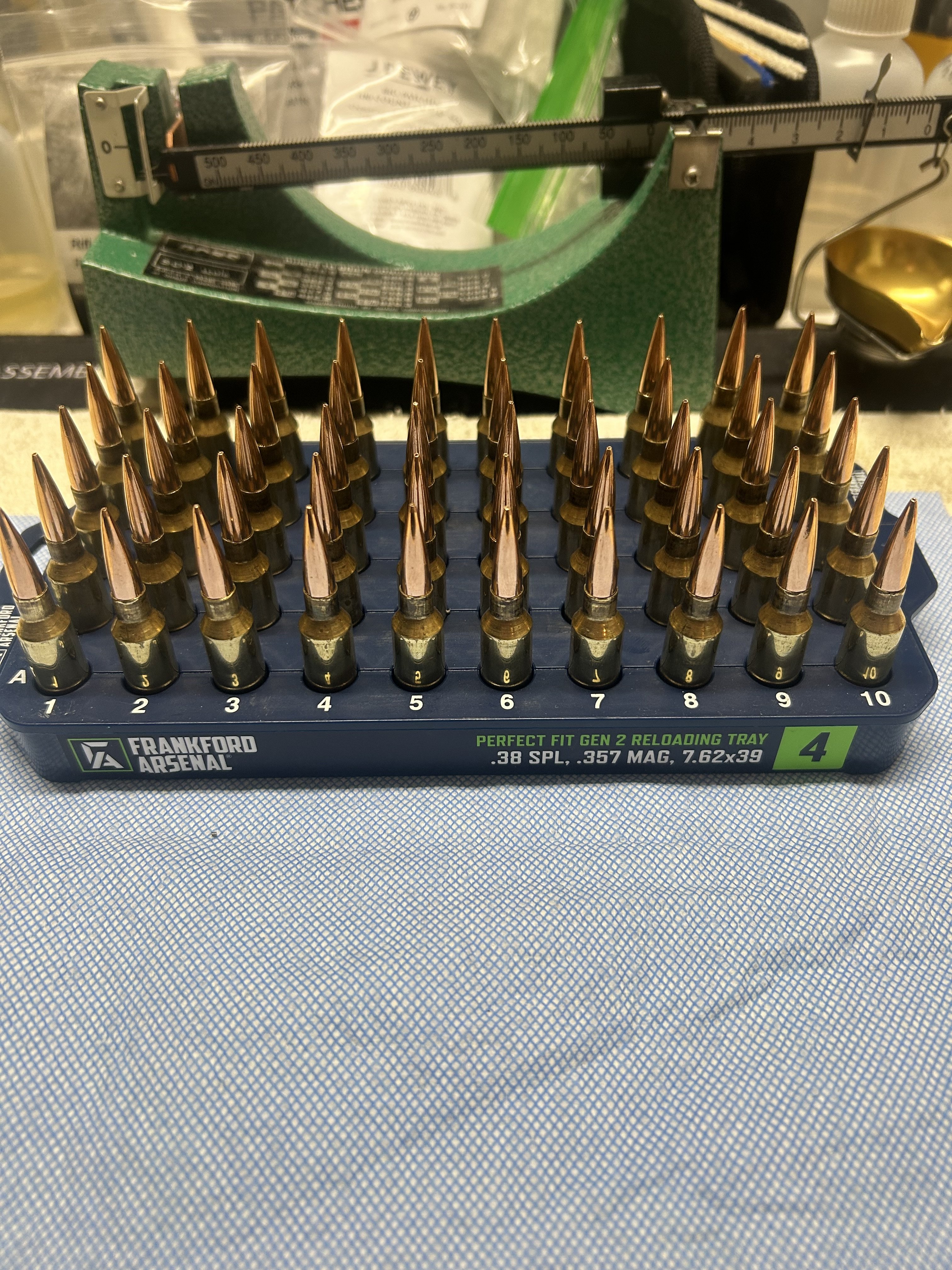

Handloads are done and heading to the range tomorrow:
Alpha brass, fed 205, N140 (25.6 to 26.4gr), and 109gr berger LRHT @2.260”
This range trip will be rounds 150-200 on the barrel so it should pretty much finish off the break in period.
Just got back from the range but it was a bit of a bust, only fired 10 shots. The barrel shoots great but I'm still dealing with short stroking (FTE, FTF, FTL) even when I switched to a buffer with 3 aluminum weights (using sprinco white spring) and I'd rather not use a reduced power spring.
I emailed @bohem to see what they recommend....I will likely drill out the gas port a bit from .093" to ~ 0.984" (using a 2.5mm bit), since this is 18" rifle +2 the dwell time is pretty short. I have tried pretty much everything else besides increasing the gas port size (set screw gas block, clamp on gas block, swapped BCG, swapped upper receivers, reduced buffer weights, etc.).

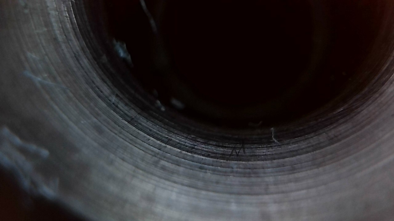

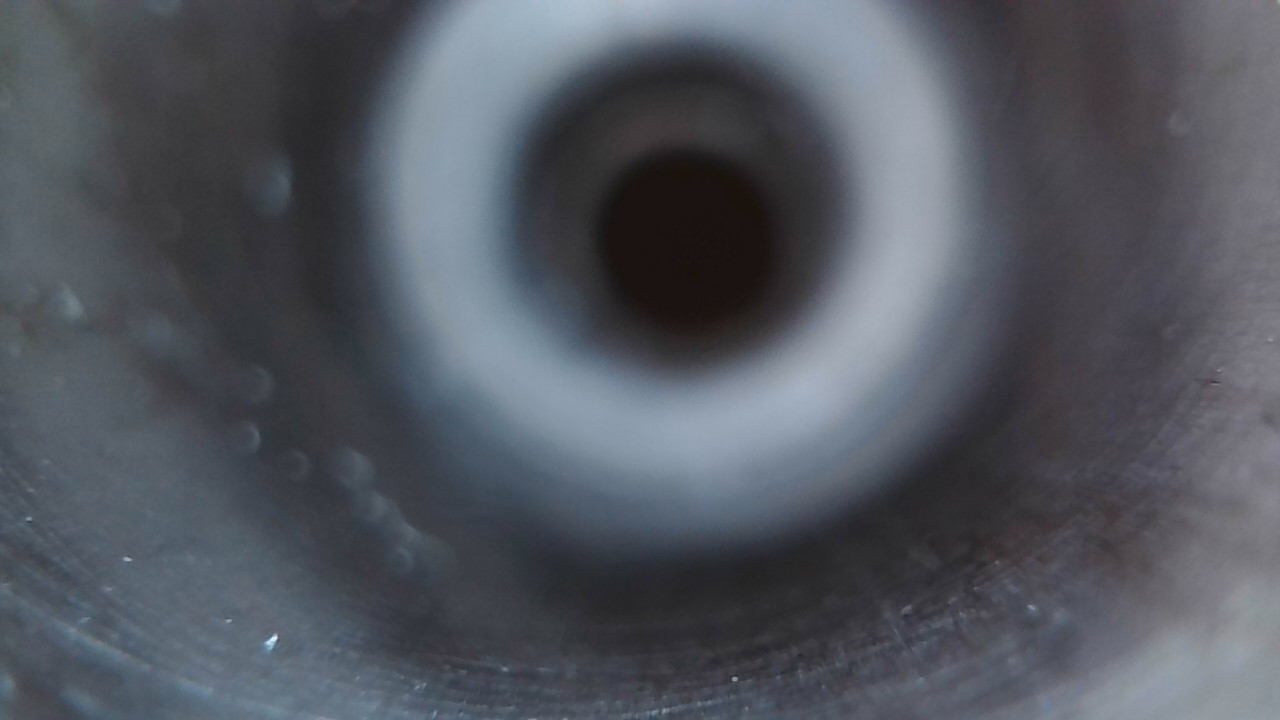

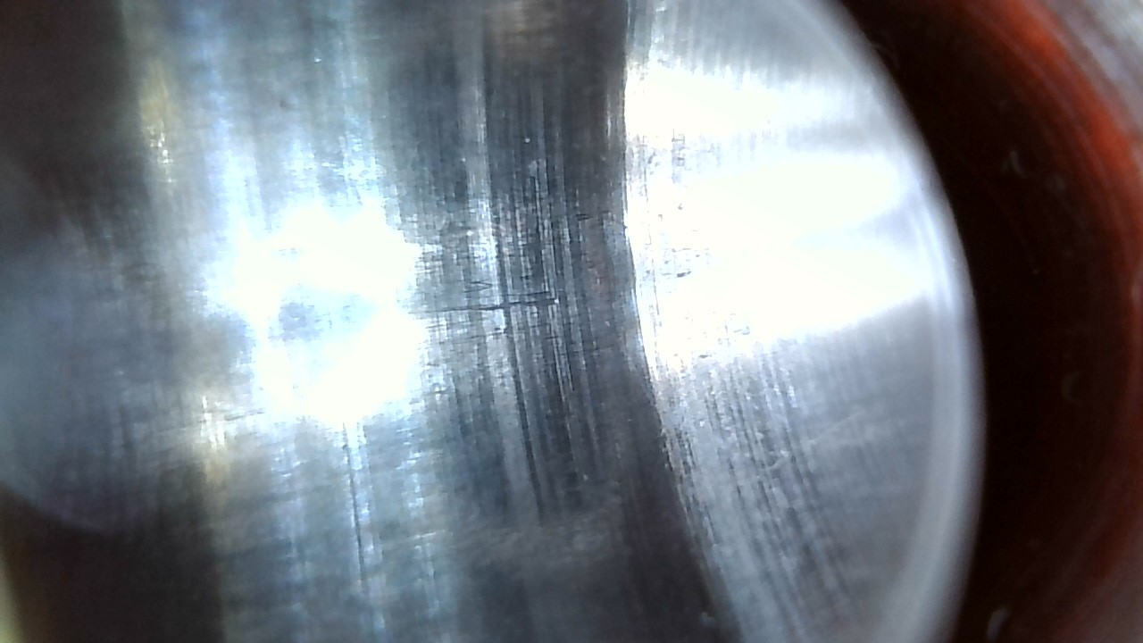

Im also going to clean the barrel and take another peak at the gas port alignment via bore scope.
*Edit: gas port alignment confirmed via scope
There is one more thing I can try, the clamp on gas block paired with the new BCG because I think the clamp on was tried with the other BCG but either way it seems to be on the bleeding edge and Id rather have a little wiggle room for colder temps, weak factory ammo, etc..
Re: my handloads, my velocities for the 10 shots were high 2300 low 2400 which is right around max pressure per Hornady load data for N140:

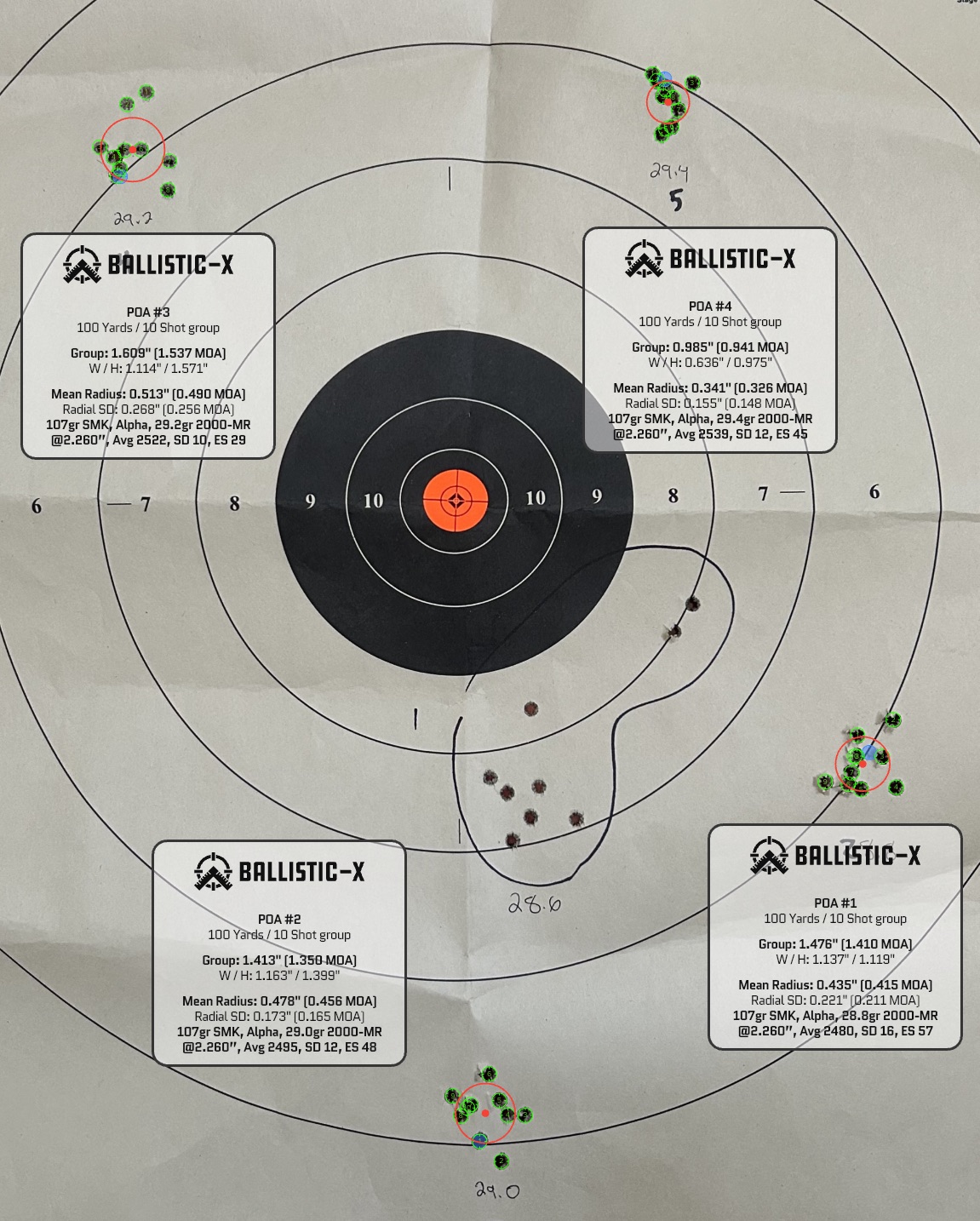

The first rounds I shot through this barrel (pic in OP) were with pretty spicy 2000-MR loads and still had short stroking. Figured I'd try some N140 at near max loads to see if there was any difference. I will definitely be running some factory hornady 108 ELD-M through as a benchmark and ensure a good gas system seal (by using clamp on gas block vs. set screw, etc.) before considering anything else.

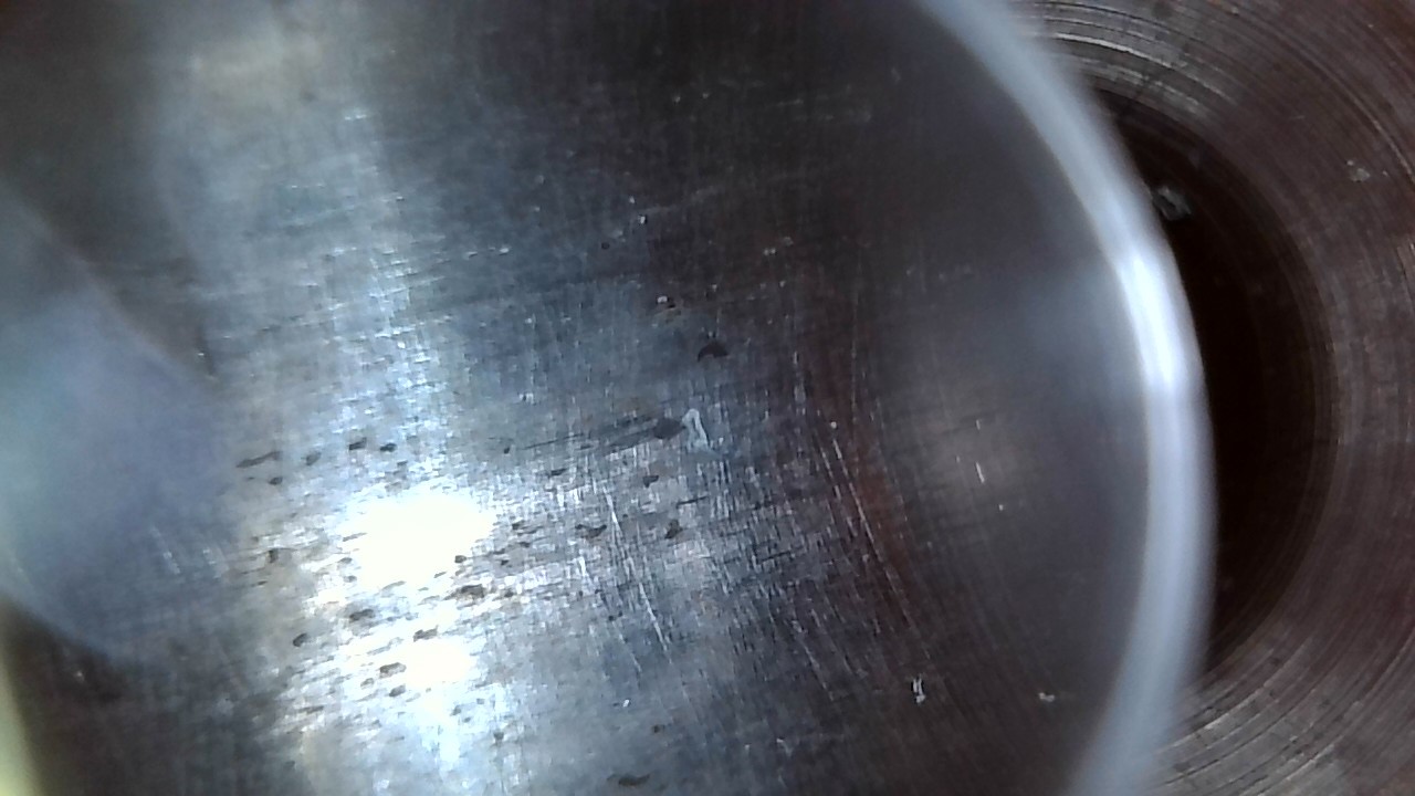

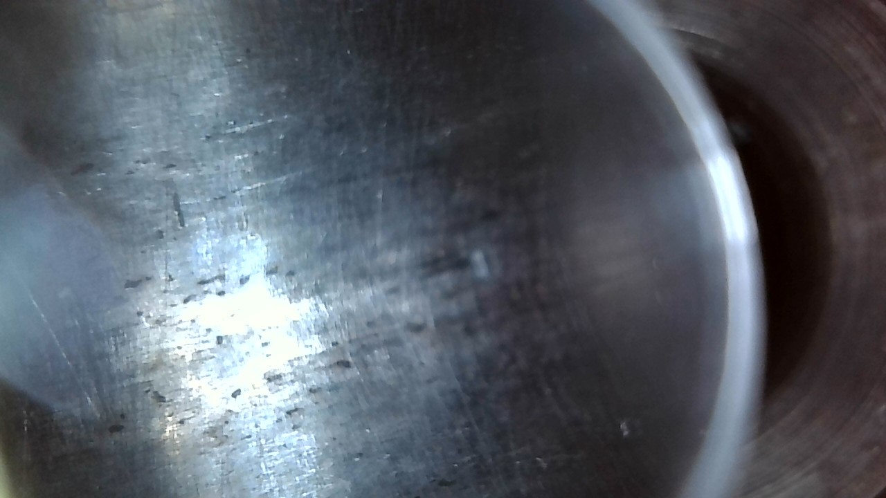

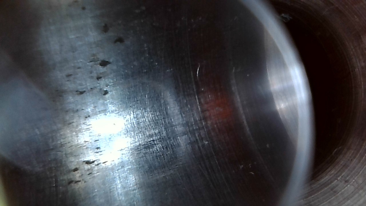

Yeah I looked for soot when I removed the gas block and it looked normal. Before removing the block I also checked alignment with a borescope and it was also good.
I do suspect the set screw gas block was bleeding off some gas bc I didn’t bed it with 620 or anything. This is why Im switching to a clamp on block to rule that out and Ill likely bed the tube into the block to seal it off there as well. Everything else I will keep the same except for switching to factory ammo instead of my handloads.

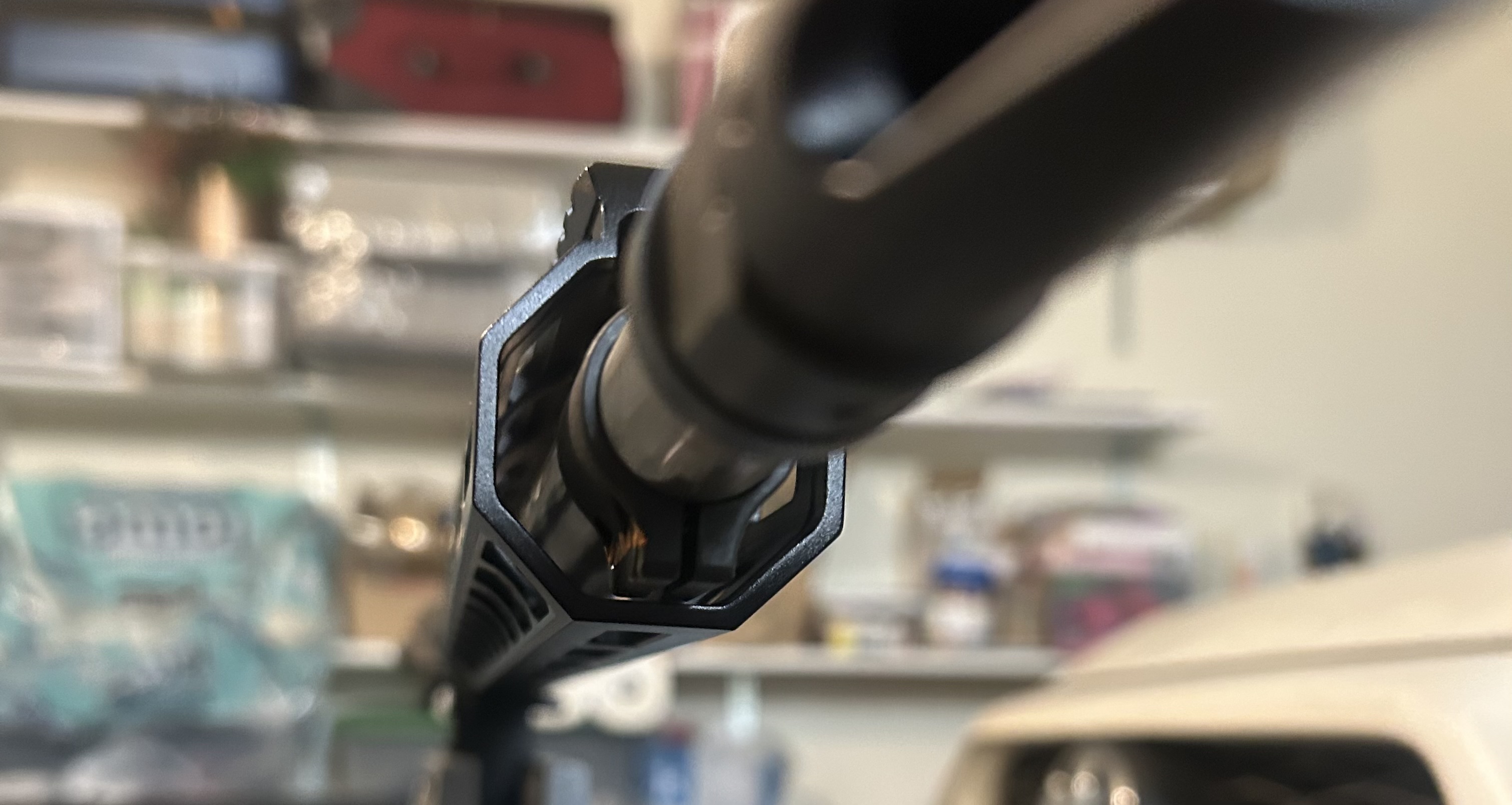

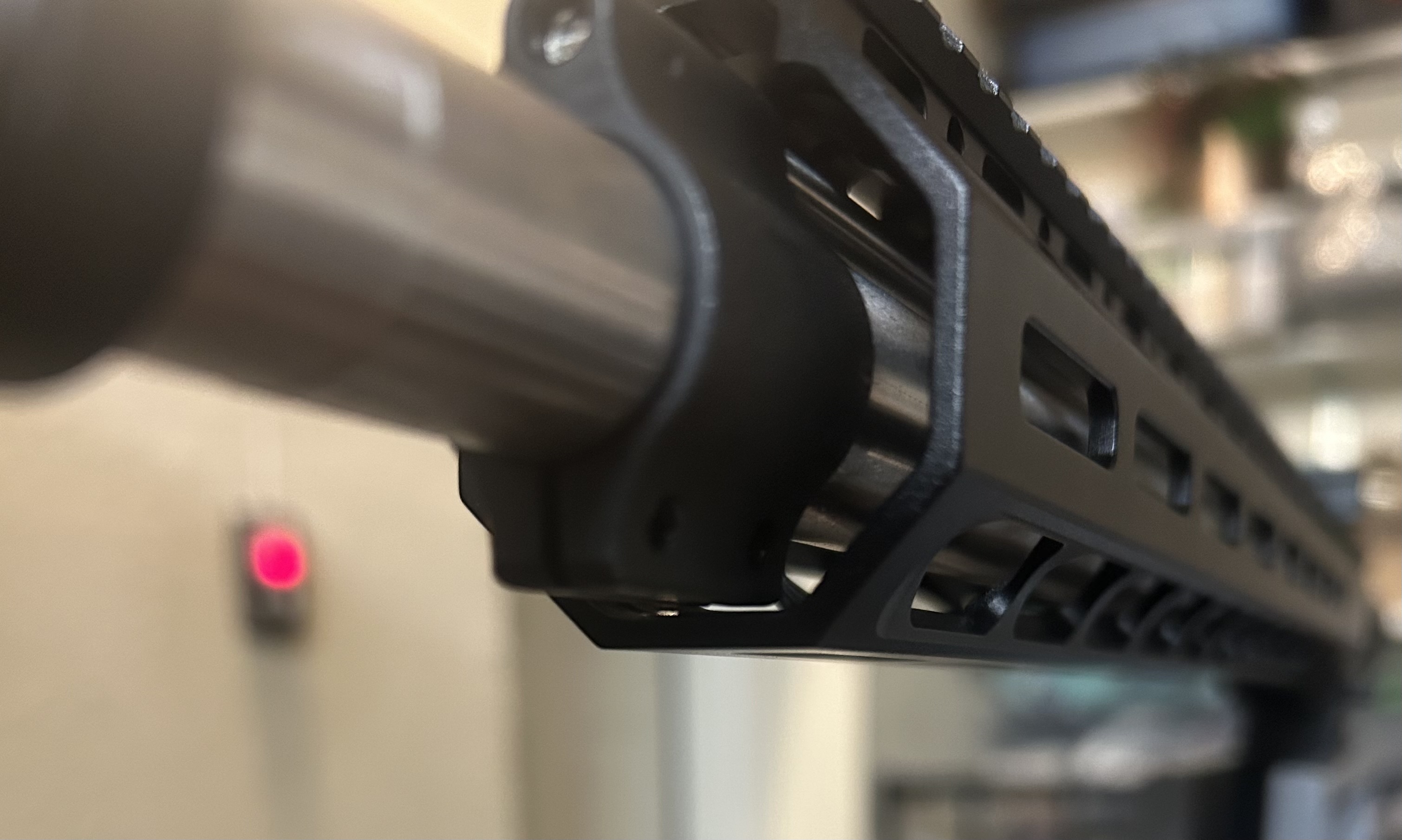

Just installed the DD clamp on and M89 rail. The clamp on just barely fits with a little bit of clearance on the bottom. On my bolt I also swapped the one piece JP ring for 3 piece sprinco rings and switched the extractor to one from Sanders Armory.

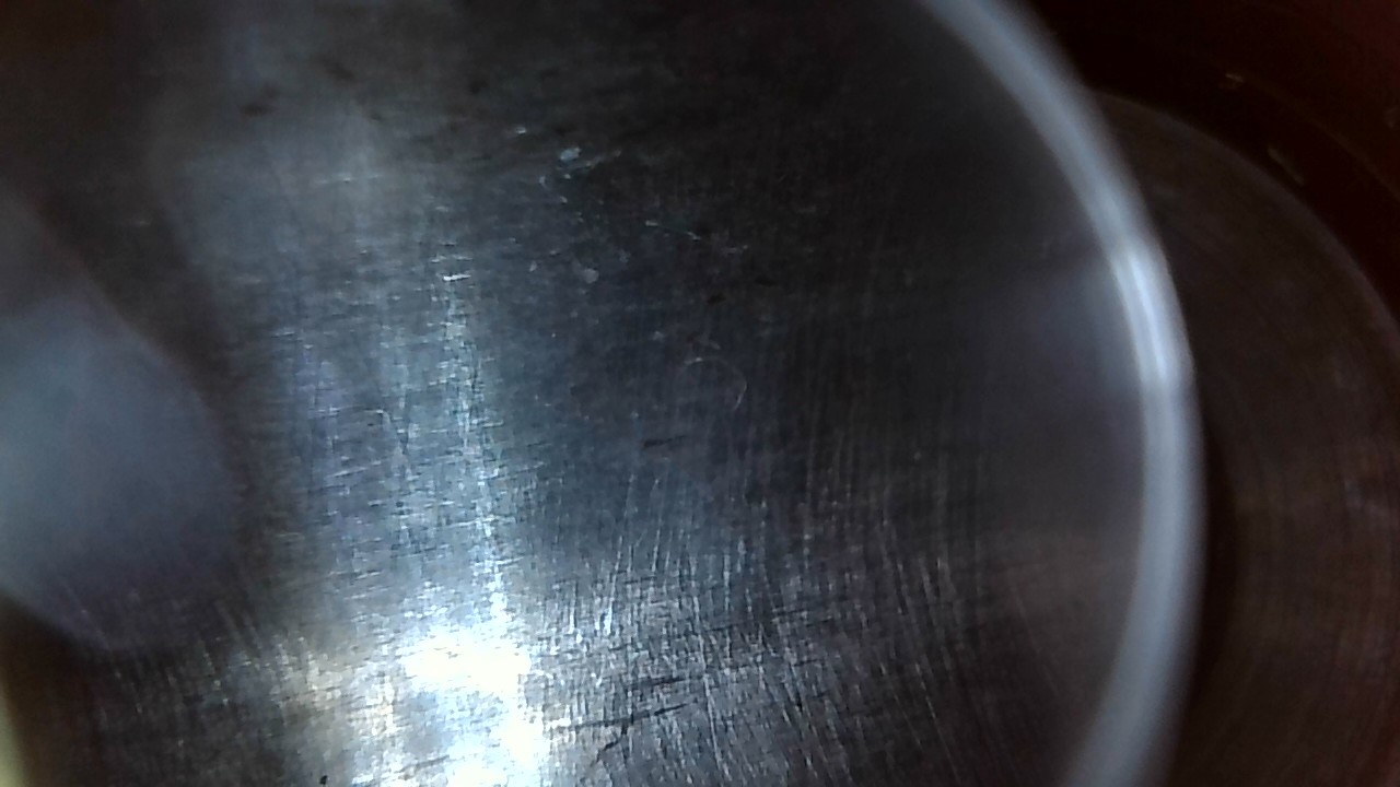

Gas port alignment confirmed with borescope. Tomorrow I will pickup my factory 108 eld-m ammo on the way to the range hopefully 🤞

Thread update:
I Haven’t been able to get to the range yet…still waiting to pick up the factory 108 eld-m that I ordered…fuckin basspro….I normally avoid them like the plague but there’s one just down the street from me. Once its ready for pickup I will head to range, hopefully on Monday
@bohem , I switched to a daniel defense clamp on gas block and grabbed some 108 eld-m factory loads. Just got back from the range and tagging you for visibility.

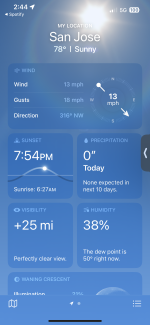

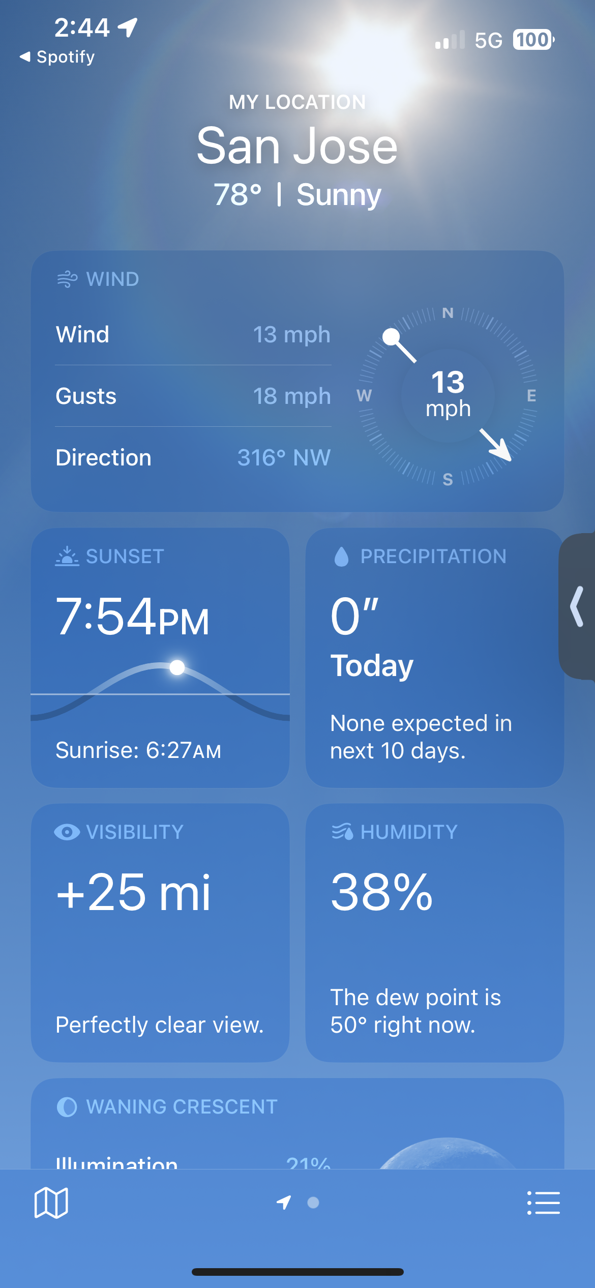

Results for Factory 108 eld-m (similar results to my 2000-mr hand loads):
  • Temp: 78
  • Wind: 14 mph @ about 10 o clock with 18 mph gusts
  • Avg speed (5 shots) 2606
  • Accuracy was great on these: 0.262” 3 shot group
  • Intermittent failure to eject
  • still getting failure to feed and failure to lock back
  • Tried with duramag and geissele mags
Still getting failure to cycle on the n140 hand loads which im not too worried about.
Re: the 0.093” port size for my particular setup it seems it would be perfect if I was running a can but im not gonna be running it with one. I could probably get it to cycle if I switched to a reduced power buffer spring (sprinco yellow) and low mass carrier but I’d rather avoid doing that if possible. Are there any other options besides enlarging the gas port (drill out the port to 2.5mm/0.098”)?
Factory 108 eld-m is POA #6 at the bottom (only did 2 foulers then 3 shot group):
@bohem hope you had a good vacation! I'm tagging you for visibility to the thread update
After seeing the factory 108 eld-m's still short stroking and thinking on it for a few days the only other thing I could think of besides the gas port size would be some sort of rough spot in the chamber making extraction difficult, etc. but with a mag loaded I am able to easily cycle ammo through the gun with the charging handle so it chambers fine without any heat/dirt/etc. in the mix. I've also tested chambering the brass after resizing it by using my finger in the back end of the carrier and can easily open and close the bolt. If the chamber was super rough or had some kind of burr I don't think I'd be able to manually chamber a round and remove it with ease.
Just to double check there were no rough spots in the chamber I cleaned it out (it def had tons of brass debris b/c of all the short stroking slamming the hot/expanded brass back into the chamber then I had to pull hard on CH to remove it) and took a look with the borescope with and without the mirror attached. Nothing jumped out to me, with the naked eye and with the scope the chamber looks nicely polished and smooth with the only slightly rough looking areas being near the shoulder which is normal in most chambers I've seen.
The only thing worth noting in the chamber were a few black spots that might be carbon deposits or something
CC: @TonyAngel and @TonyTheTiger I can't remember how familiar you guys are with 6 arc gassers but I'm open to any other ideas/suggestions on troubleshooting the short stroking, I seem to remember you weighing in on other short stroking threads and the more ideas the better as far as I'm concerned.
Hey man. I'm really going to need to go back through this thread and get caught up on what has changed, but am getting ready to start my weekly staff meeting.
Still, a good way to check to see if more gas will help would be to throw a good old fashioned baffle stack suppressor on it and see how it runs. A baffle stack suppressor will simulate more dwell time and increase back pressure. Just make sure you use one with an appropriate bore diameter. Not all 5.56 will do 6mm. Real gun guys are pretty helpful and most would be glad to let you take their can for a spin. If youre lucky, as I am, suppressors are pretty common at the range.
Although I have limited experience with + gas system lengths, I've never been a fan. I really dont get the market. Like with SBRs. 10.5s were all the rage, then 11.5s because of the increased dwell time and now manufacturers are going back toward less dwell time. Less dwell time really tends to make a system more finicky. Well, going from ideal to less dwell time, does anyway.
