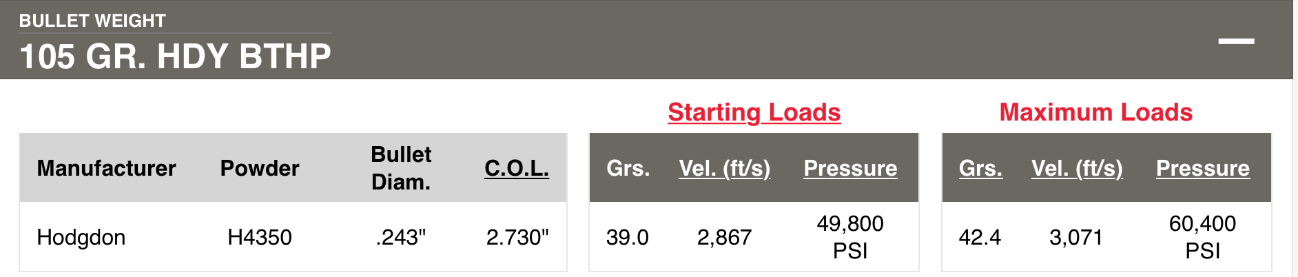

The Hodgdon data is a bit hotter than yours and they are getting a velocity of 3,071 with 42.4 grains.

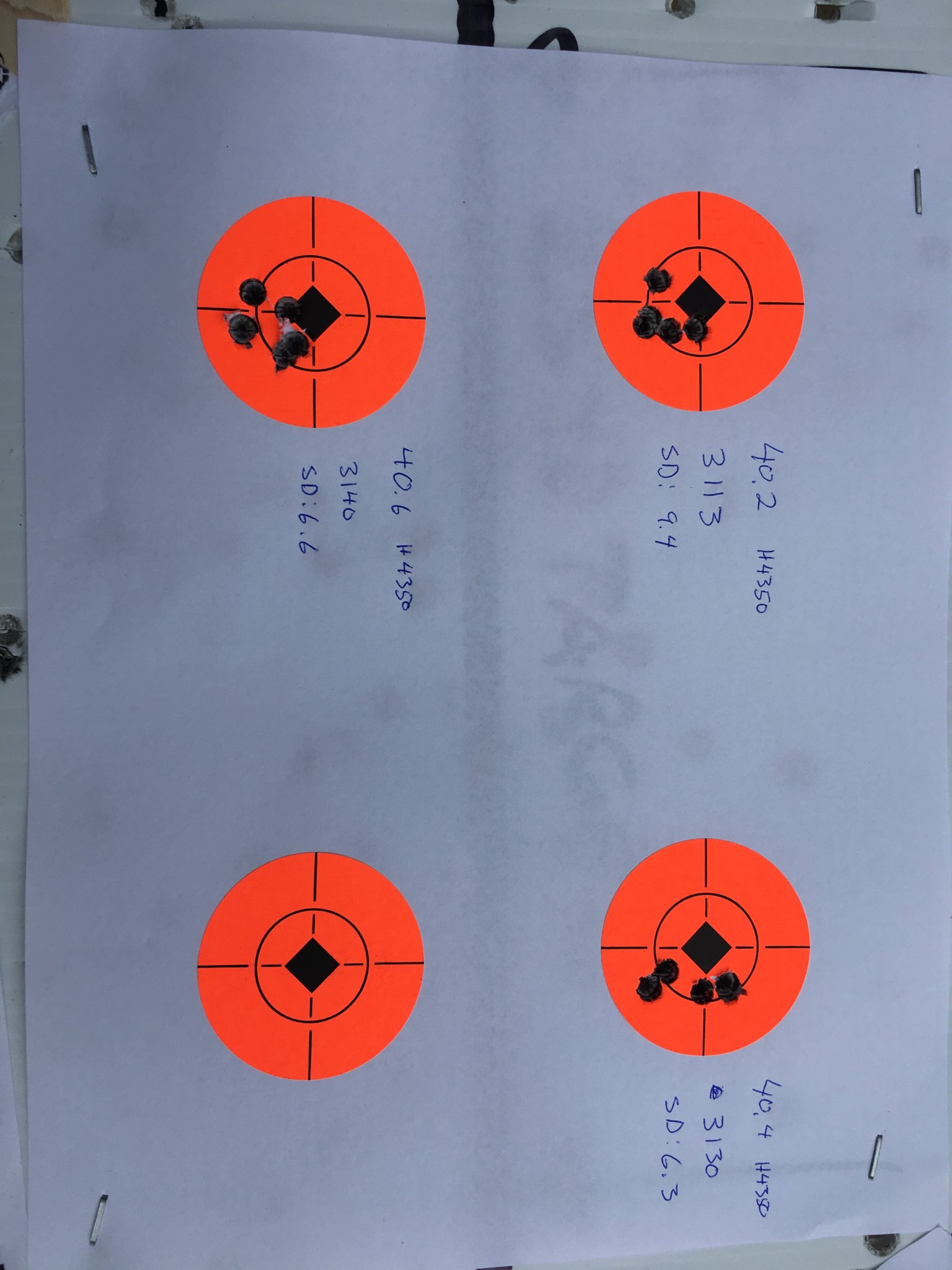

I cleaned the barrel about 100 rounds ago. I did clean the throat with boretech carbon cleaner and got rid of the ring that was starting to develop. Went to range and shot these today. Still a little fast so I may try 39.8 and 40.0. Accuracy is better but still no where near where the barrel started.
I settled on 40.52 which gets me 3140 and a little over 1/2 MOA. SD of 4.
Unfortunately that’s knocking on the door of one club series I shoot (3150) and well over the speed limit of another (3100). When I tried dropping to 40 grains to get closer to 3100, accuracy and SD was terrible.

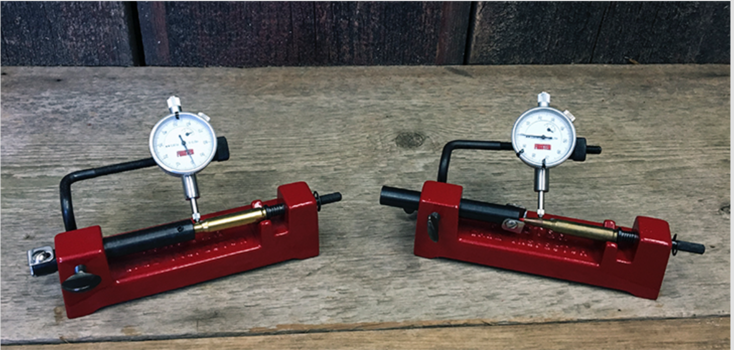

The next step may be to look over case and cartridge runout with something like a Forster Co-Ax Case and Cartridger Inspector. Hopefully a friend will loan you one. You can check:
Neck wall thickness
Case and cartridge runout
That way you remove some of the variables.
Read about what it is measuring and see if that is one of the issues.
